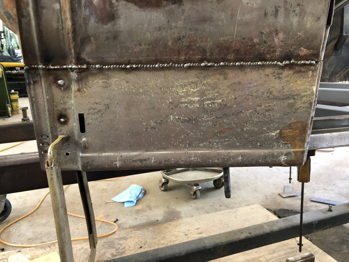

    After welding.

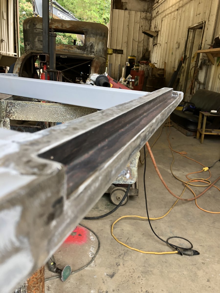

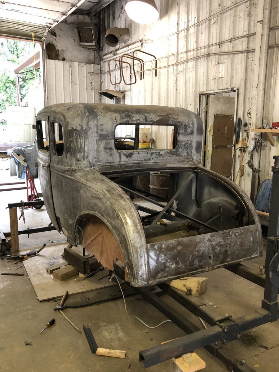

    Next we wanted something to place the body on after removing it from the ch***is, so we built our own rotisserie.
    Then removed the body and rolled the ch***is out of the way.
    66fora69er and roll of the dices like this.

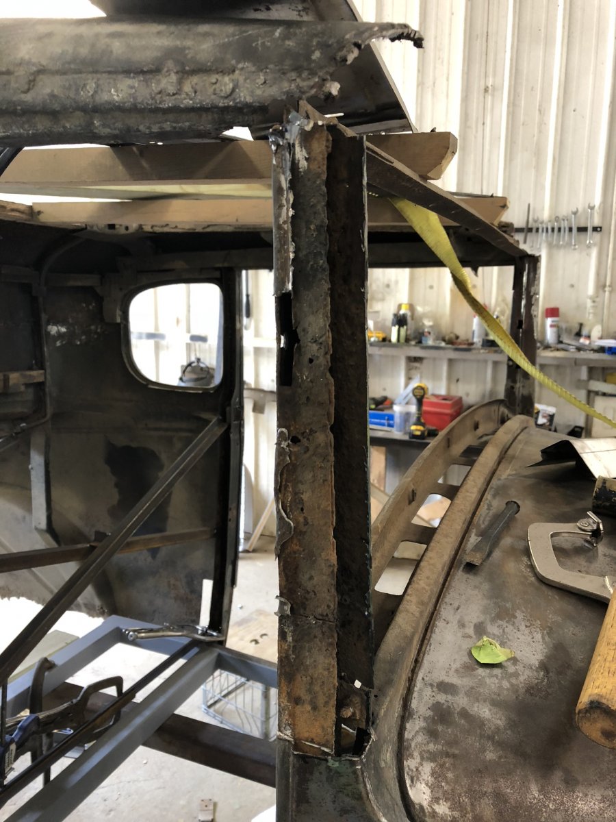

    Then we discovered just how bad of shape it was actually in.

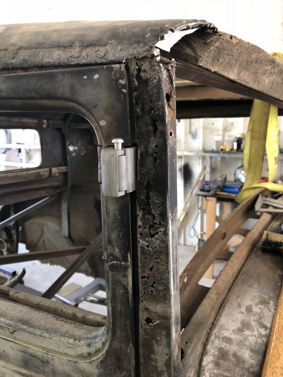

    Frame was solid, but the sub-frame was completely shot and someone got ahold of it with a welder after hitting the pipe. Several bolt were welded in to fill gaps and the welds in general looked like someone vomited molten metal all over them. bottom 3-6 inches of the body was rusted out all the way around, as usual. IMG_0464.JPEG

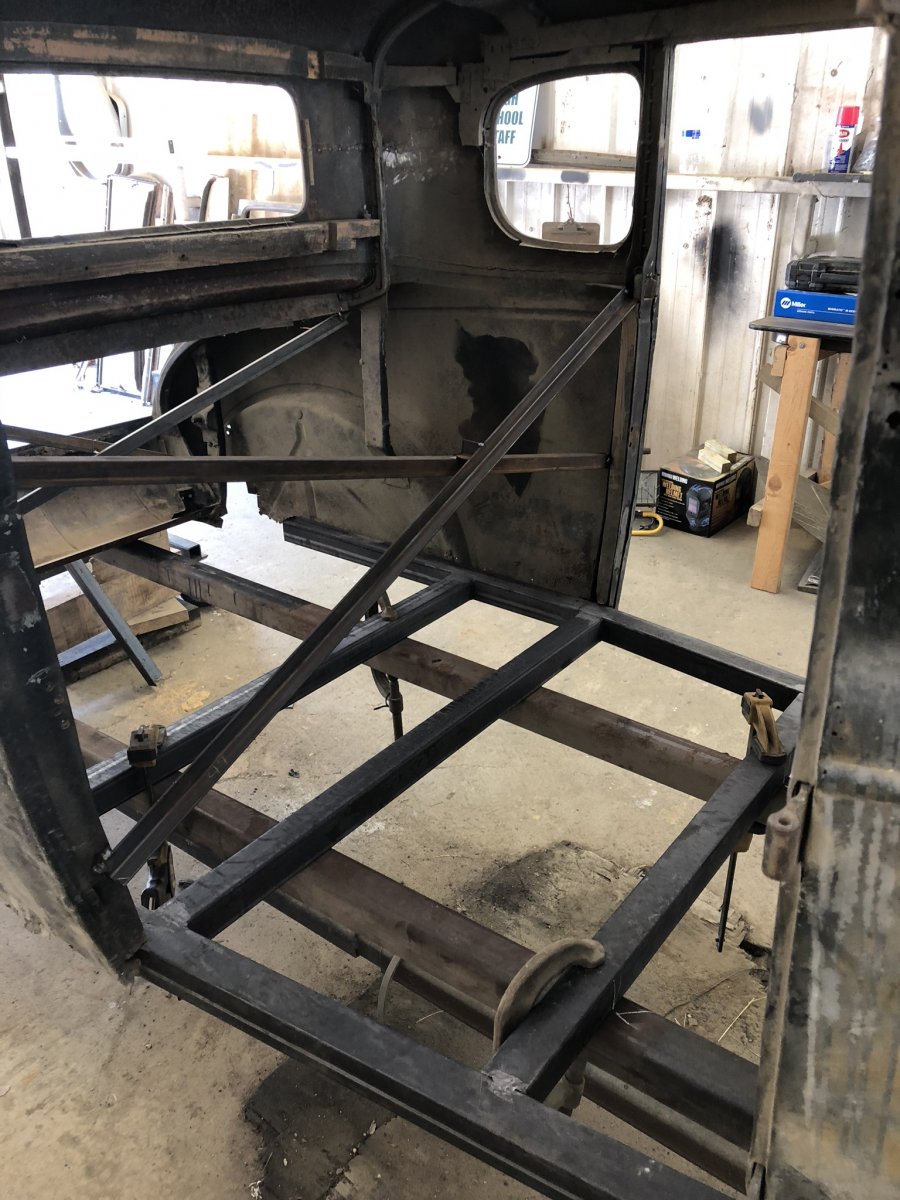

    Next step was to remove the body from the sub-frame and give it a look over to see if it was salvageable.
    It was too bent up rotted out and ruined by bad repairs to save it, so we decided to fabricate our own from tubing.
    Got it all painted up after test fitting it without the doors on. Then realized we forgot to notch out for the doors. So we went back and welded in some angle iron.
  10. manyolcars
    Joined: Mar 30, 2001
    Posts: 9,609
    manyolcars
    no automobile manufacturer ever thought the extra weight of square tubing was necessary

  12. LedSled97
    Joined: Aug 8, 2016
    Posts: 28
    LedSled97
    from Houlka, MS
    It’s thin gauge it’s not that heavy. Not too worried about what automobile manufacturers do. After all they are trying to build as cheap as they can get by with and still be reliable. The extra pounds won’t hurt it’s not a drag car.

  14. sloppy jalopies
    Joined: Jun 29, 2015
    Posts: 5,256
    sloppy jalopies
    IMO... manufacturers used channel as it used less steel, but it also flexes much more than tube...
    the 2 bolt under the cowl are tightened to adjust the rear of the door gap... [tighten them, check the gaps, then shim the bolts to get your rear gaps right]...

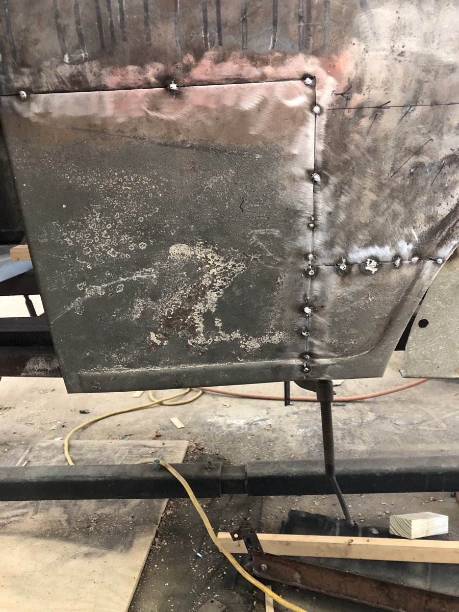

    Next we started cutting out all the rust and welding in the patch panels. All the lower quarter patch panels were purchased, but the rest we shaped ourselves.
    The nasty stuff on the metal is a rust preventative.

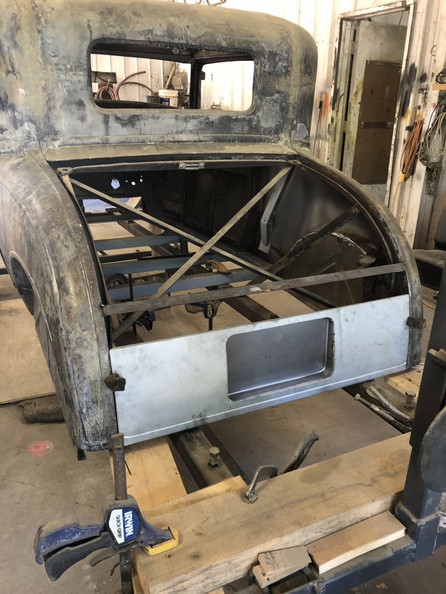

    Now onto some more patch panels and getting panels that don't wanna fit into shipshape. ****s when you buy a panel that's expected to fit and its nowhere close.
    Excuse the mess. Work in progress.
    Cut out the fender wells. They were all rusted out on the bottom.
    had to put more curve into the rear panel to make it fit correctly.

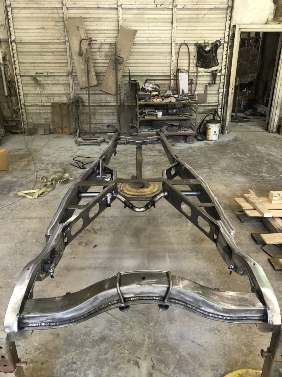

    It's Ch***is time!
    I might be jumping around a bit but it's hard to remember exactly what order everything was done in.
    Had a ch***is delivered to the shop from brookeville roadster. And man is she pretty.
    Awesome guys to work with.

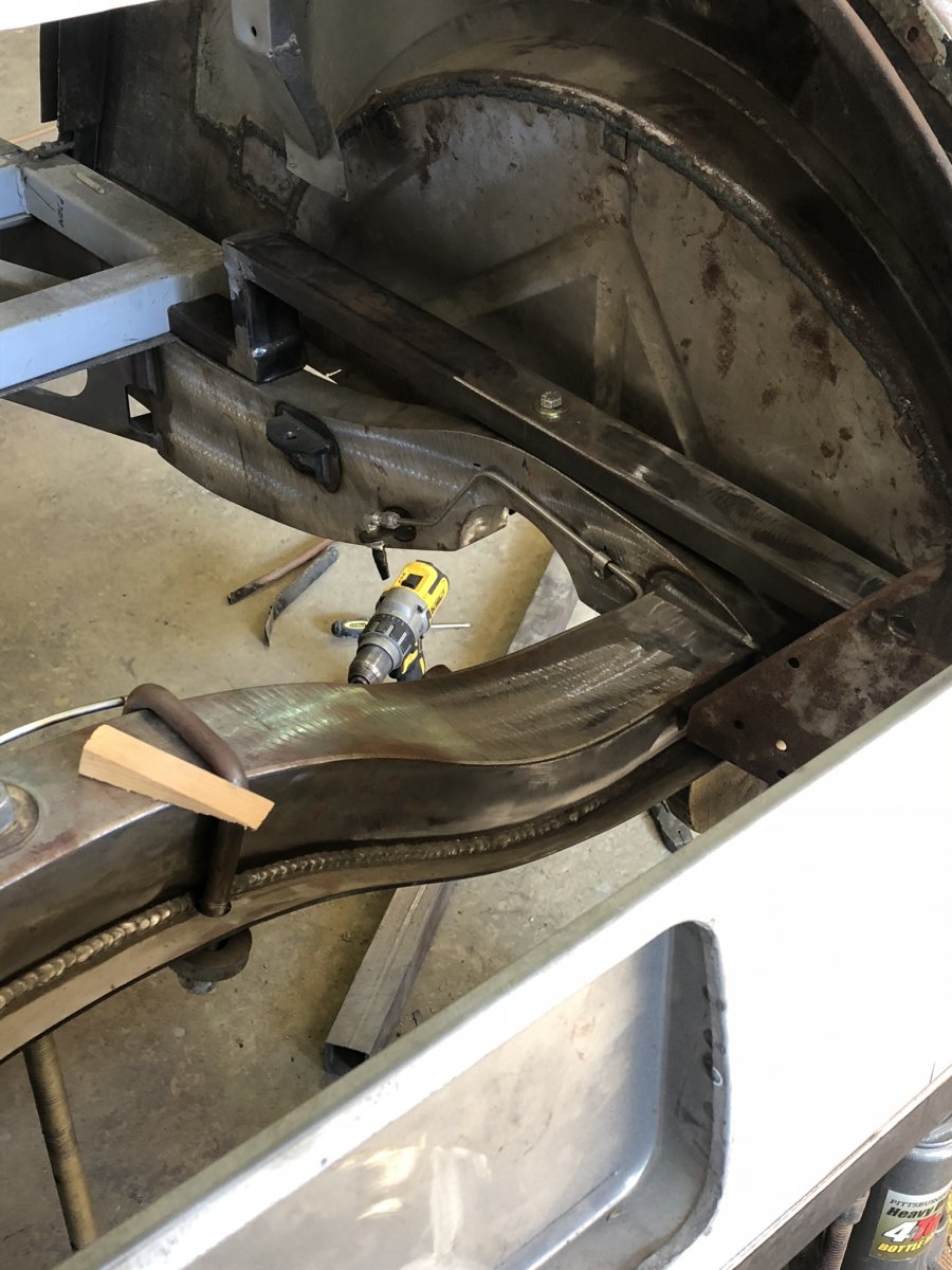

    Next step was setting the body on it to line up the frame holes with out body and fabricated sub-frame.
    Rebel the shop foreman.
    Had to slightly move one body mount about a half inch
    Then fabbed up the rear sub-frame now that we could see how the frame layed out.

    Two thumbs up for both of you to have the ambition and courage to take the plunge and the nice work so far. I noticed a lot of home engineered and built with "whatever happens to be handy" tooling in the backgrounds. The rotisserie is worthy of a thread of it's own!
