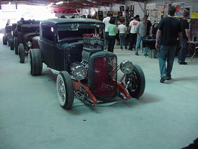

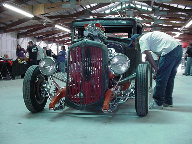

    What RatBone said. I think those early Chevy frames have loads of character built in. My dad's building a rod with a similar frame but running the leaf springs under the axle to drop it about 3 inches. Looks great. The frame might need to be notched a little though to keep the frame underside from hitting the axle during jounce. If you channel the cab, you can z the frame behind the firewall outta sight. Please keep us posted.
  7. keep the parallel leaf set up
  8. el chuco
    Joined: Feb 20, 2006
    Posts: 125
    el chuco
    Wow! That looks super. Any cons to running this front end setup?

    Looks like im definitly keeping the parallel leaf set up. with this info and a nudge in the back i've got a lot of ideas building up.
    evil1 thanks for the pics... that thing is wild.
