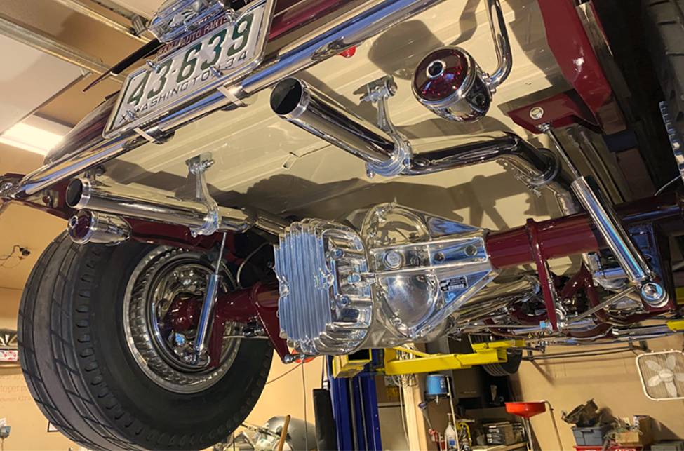

    My 34 is fenderless and parallel leafs...they are just abbreviated. Quarter elliptical springs from P&J. Rides nice, adjustable height and you can't see them.

    I would love to see a picture of your 34

    Here is the "some assembly required" stage
    I like the cleanness of the semi ellipticals, no coil overs or buggy spring. Hell, even standing under the car you can't hardly see them.
