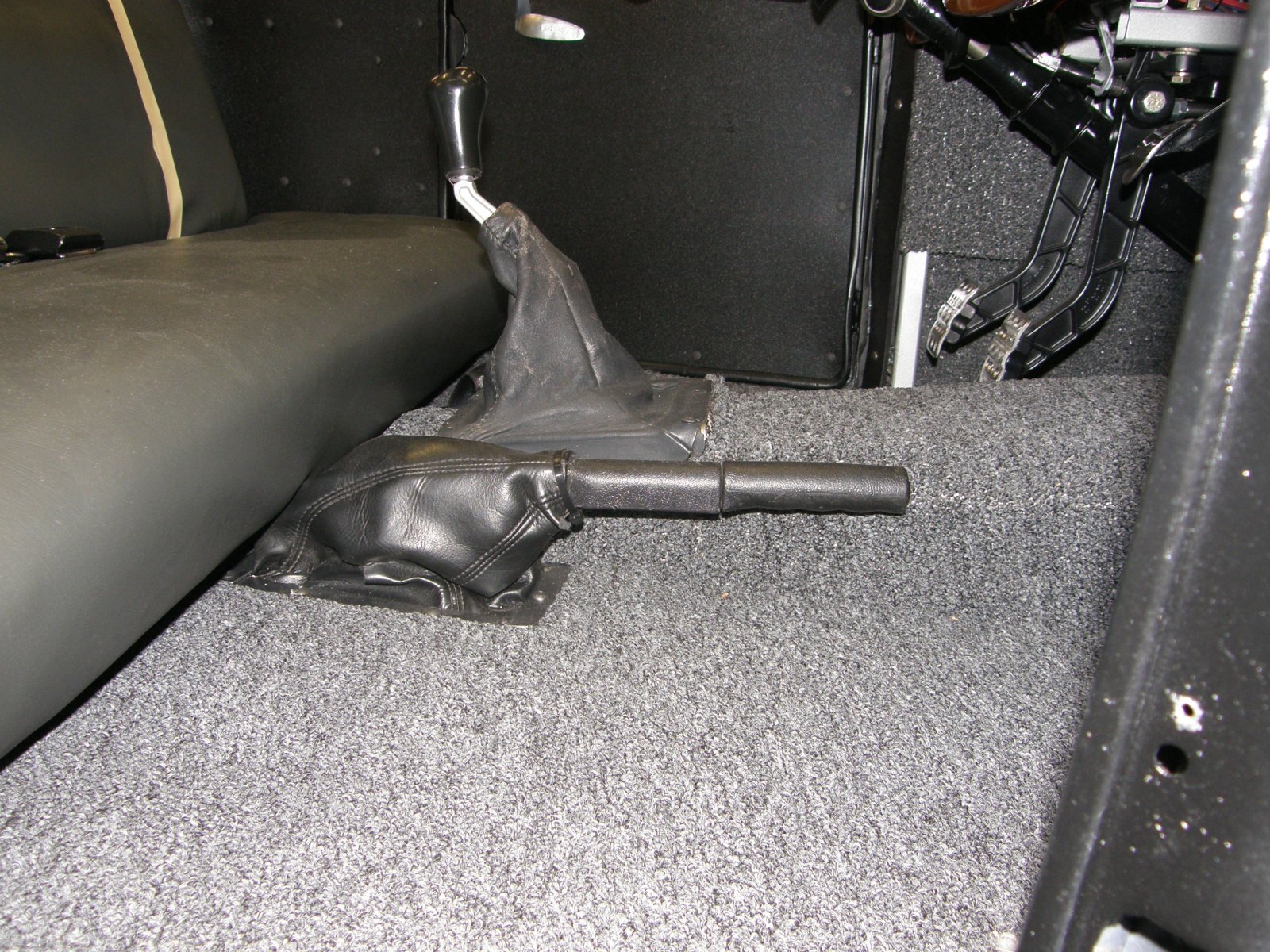

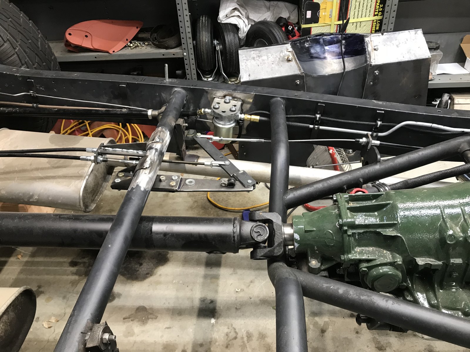

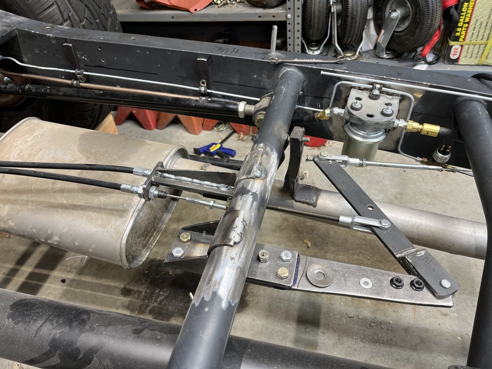

    Here’s mine 69905365219__2AF96384-A962-4217-A9EC-A1FB3DF9355C.jpeg IMG_5340.jpeg IMG_5510.jpeg IMG_5523.jpeg IMG_5512.jpeg IMG_5514.jpeg

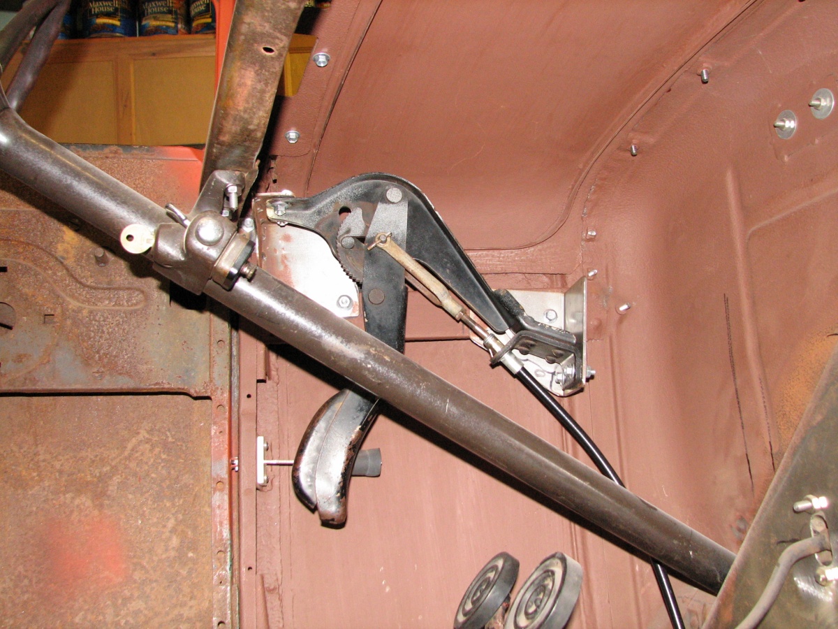

    Model A coupes are pretty small so I mounted a 48 to 52 F1 e-brake handle up under the dash. It works really well and doesn't need a bell crank on the frame. Looks very incon****uous and frees up non existant floor space. They show up on flee-bay all the time ebrake1.JPG ebrak2.jpg

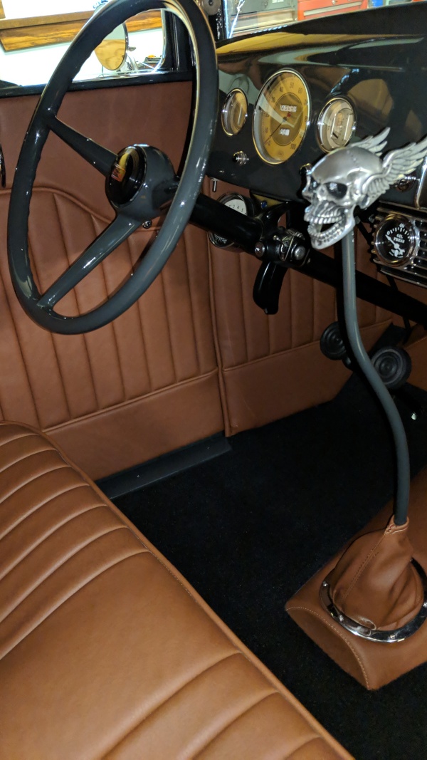

    from UK

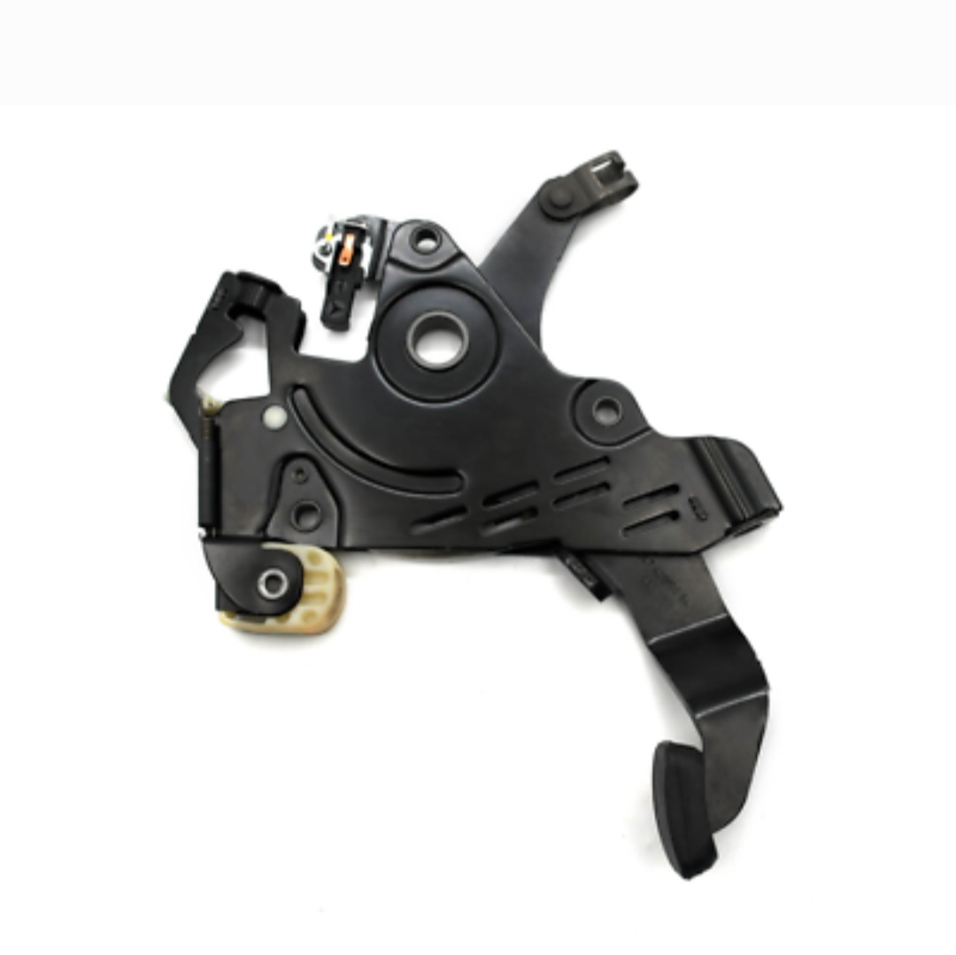

    Foot operated... put one of these on a 34 chev coupe.

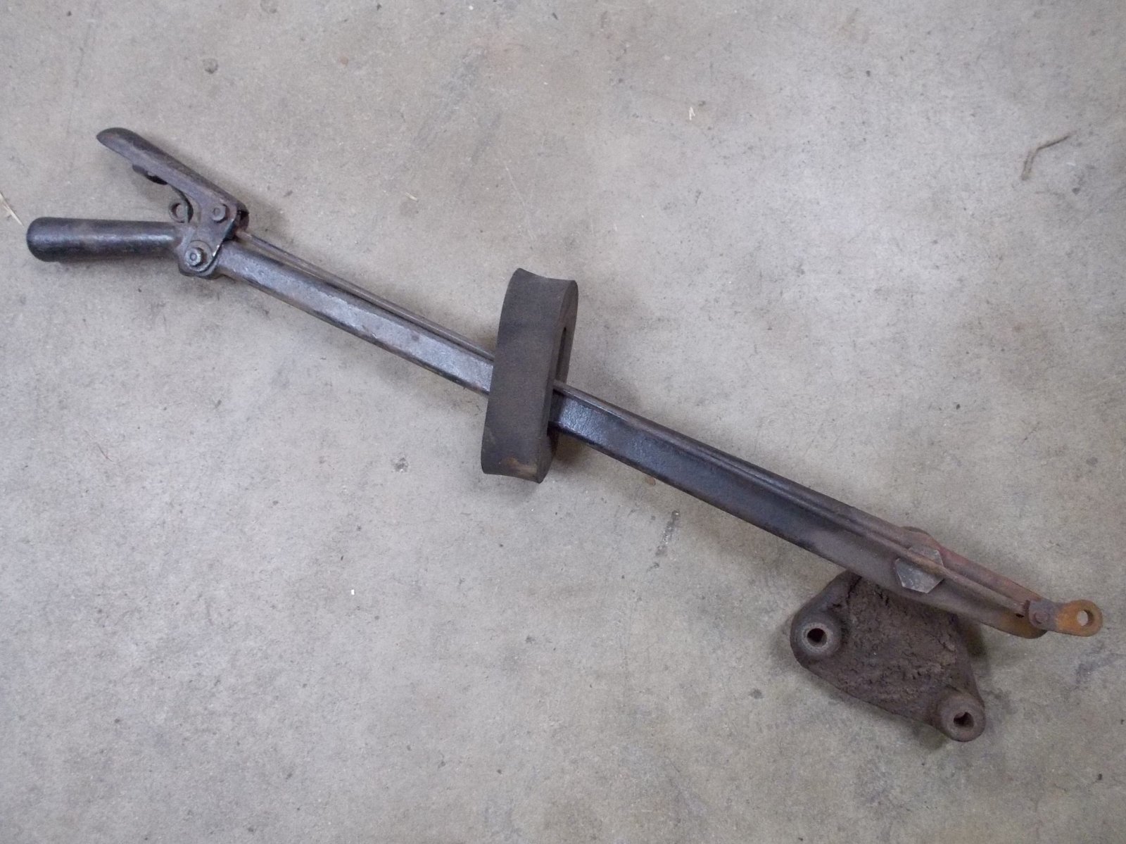

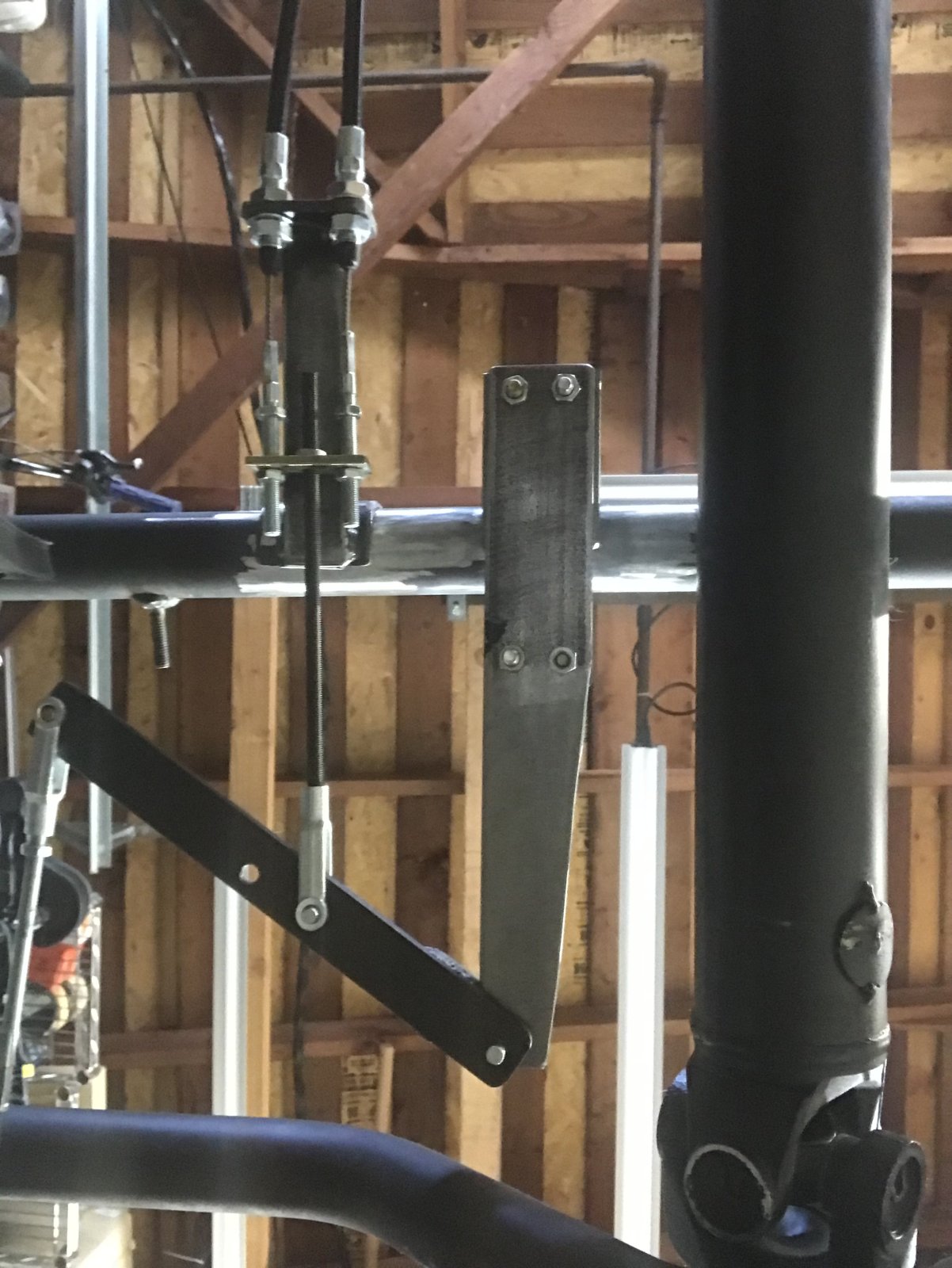

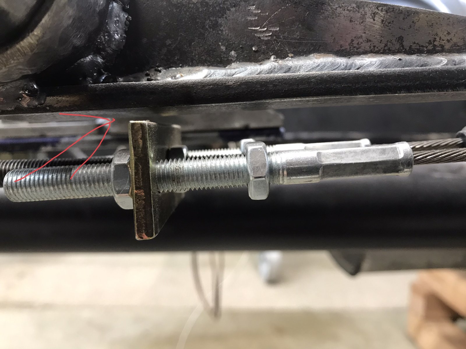

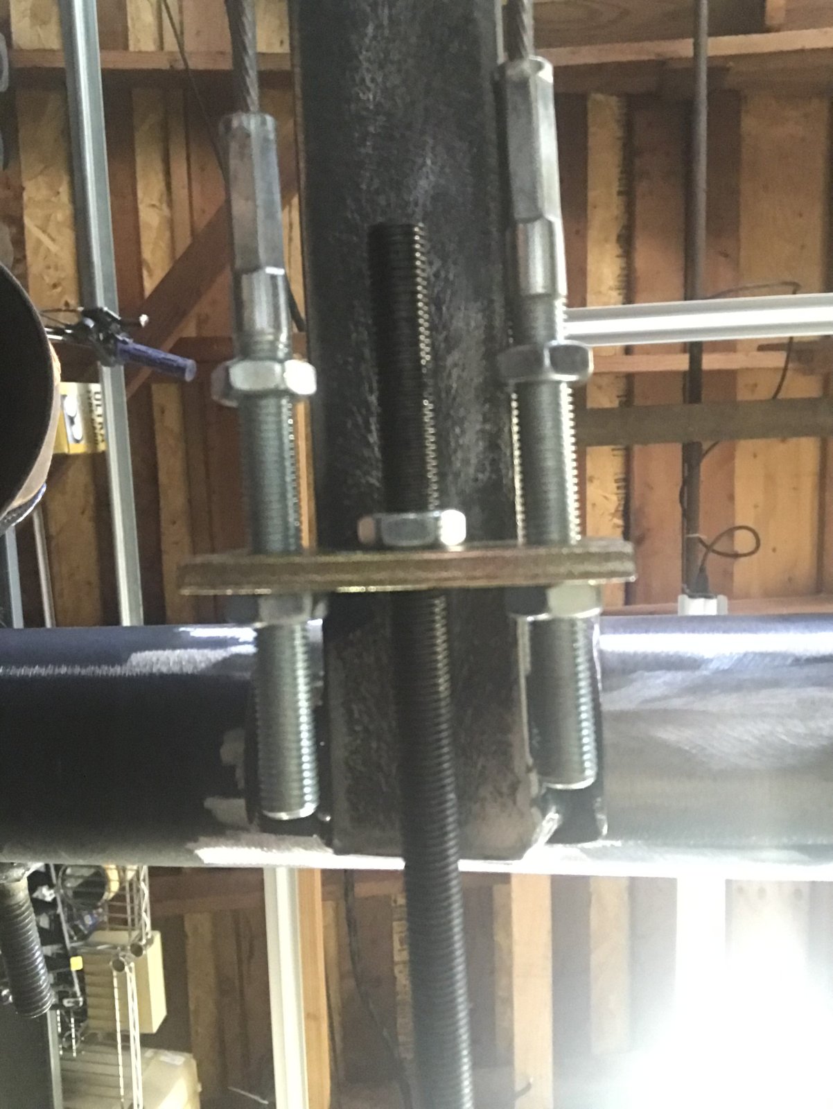

    I repurposed a '41 Chevy truck brake handle on to my champ car build to actuate the rear parking brake cables to set it into a drift in the corners. (The car also has 4-wheel hydraulic brakes - thanks Mr. Chrysler). Maybe something like this?
