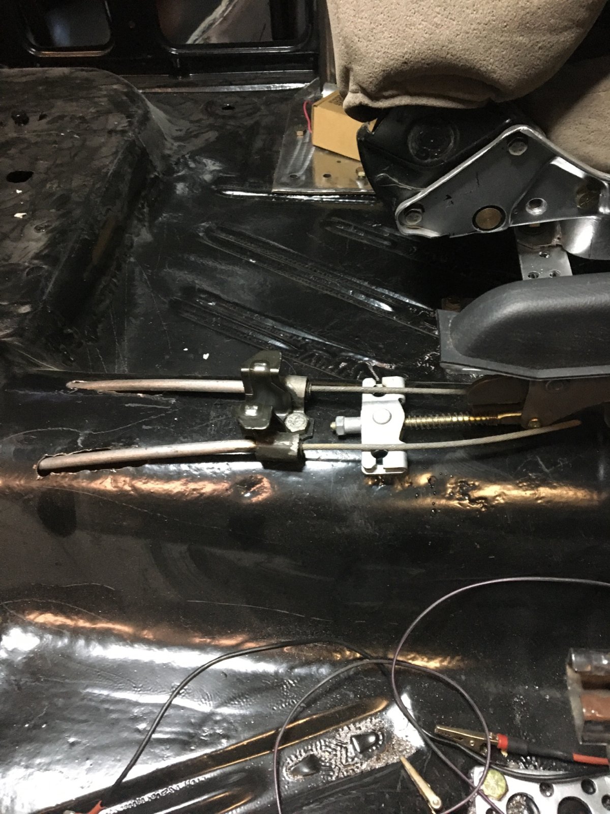

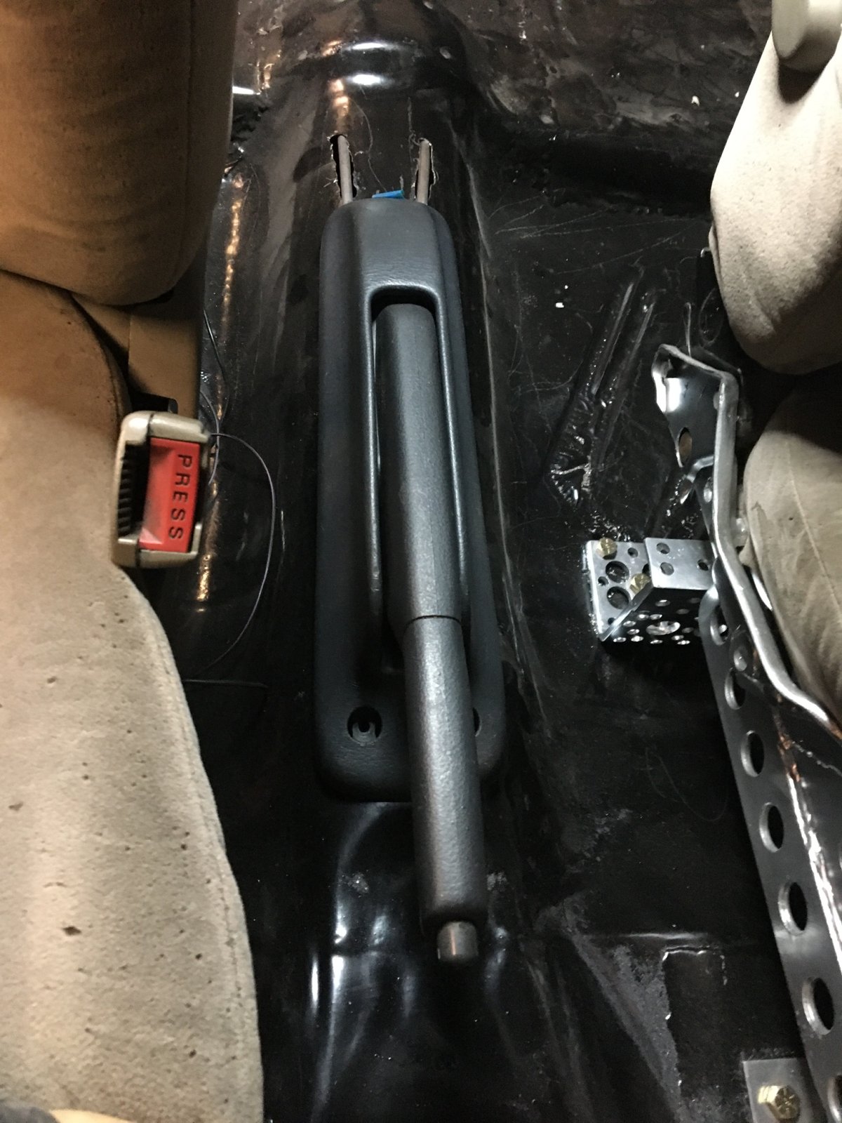

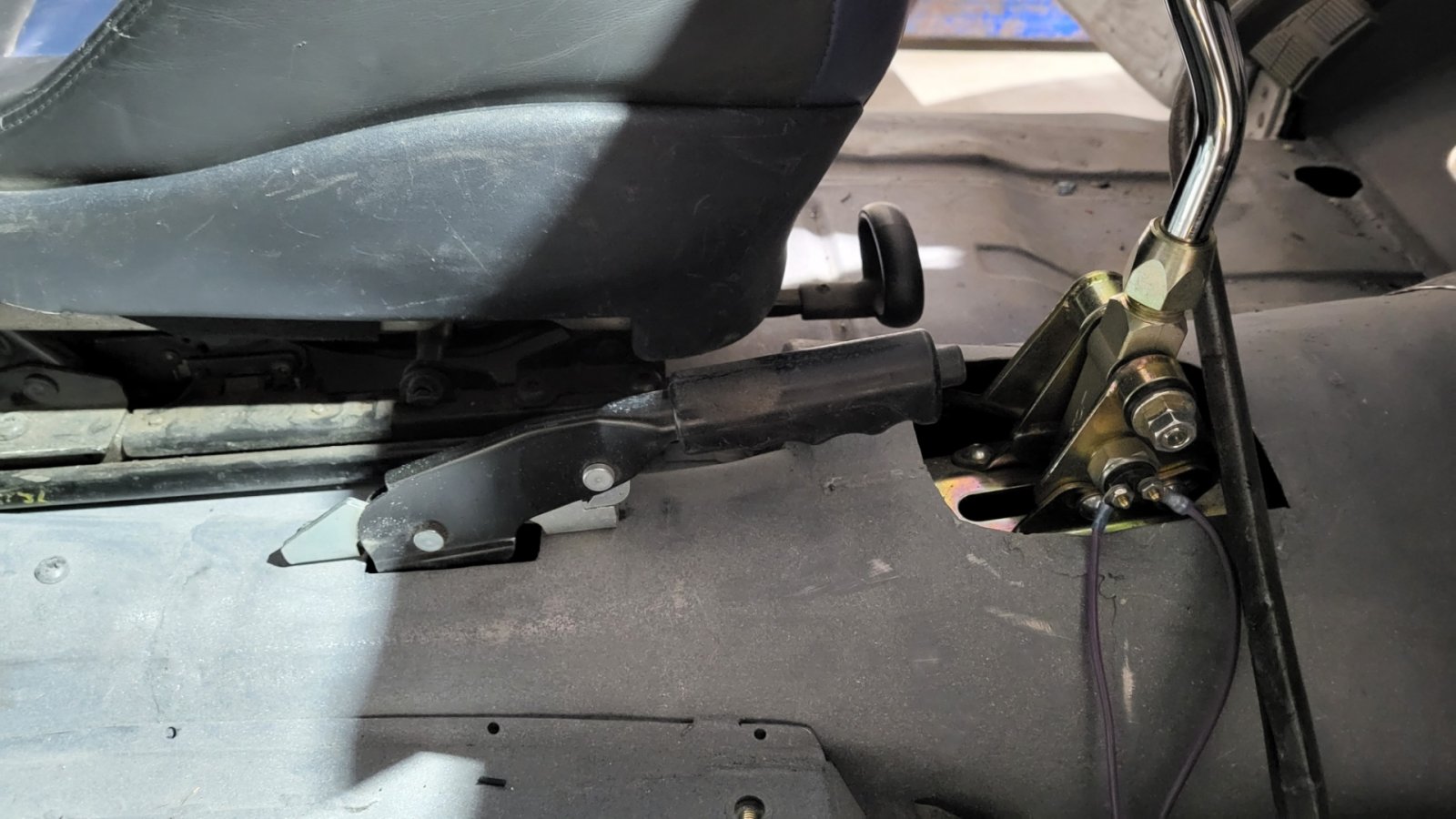

    C808877A-845F-4A7A-82D9-26E8A8DCE166.jpeg 8036F4DE-69F2-40E2-95A0-AF8D75C1F89E.jpeg I connected a “HONDA”-barffff-to a 9” Ford E-brake cables to a 53 Chevy Belair. The main thing is I have a working E-brake on the car. In my teen years I parked my 56 Chevy in the driveway. It kicked out of gear in the middle of the night, rolled down the driveway, wiping out the side of my brother’s Ranchero. The Old saying- “Opened a can of worms”- no, we opened many cans of BONDO!!!!!

  5. In_The_Pink
    Joined: Jan 9, 2010
    Posts: 978
    In_The_Pink
    Is the release the rear (well, forward, as mounted in your pic) half of the handle? As in, you squeeze the two sections of the handle/lever together and it releases?

  7. flthd31
    Joined: Aug 5, 2007
    Posts: 601
    flthd31
    The release is the part that's facing the driver. You just pull in the handle with your fingers to set the brake and squeeze to release. Beautiful smooth ratchet action with great leverage and totally out of the way.

  9. In_The_Pink
    Joined: Jan 9, 2010
    Posts: 978
    In_The_Pink
    Thanks for the clarification, it makes sense now that I look at it again. It's a great solution, and being era-appropriate makes it even more appealing IMHO. Nicely done.

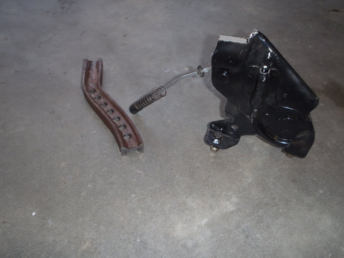

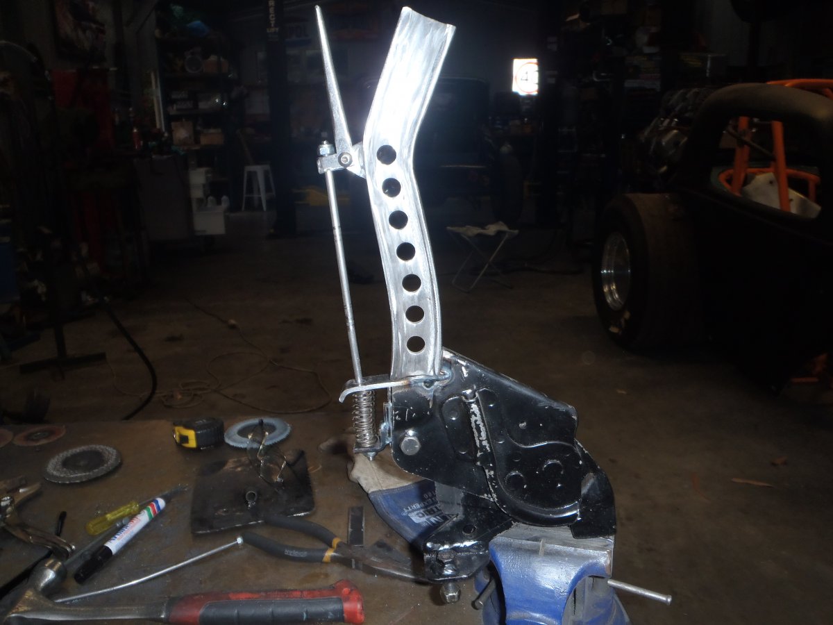

    I decided to fab my own using a standard floor type unit, a few pics. Glen P1010834.JPG P1010833.JPG P1010840.JPG 173.JPG P1010092.JPG

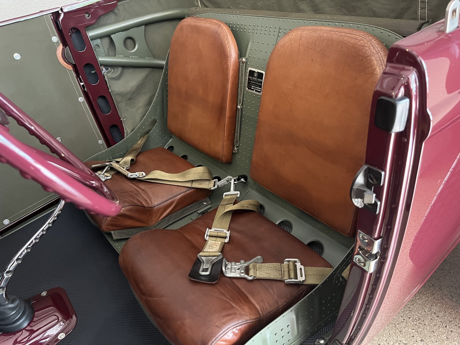

  16. Doug G
    Joined: Jul 30, 2015
    Posts: 134
    Doug G
    from Manheim Pa
    Picture of my 33 Chevy interior with console and lack of space shown for conventional parking brake lever.

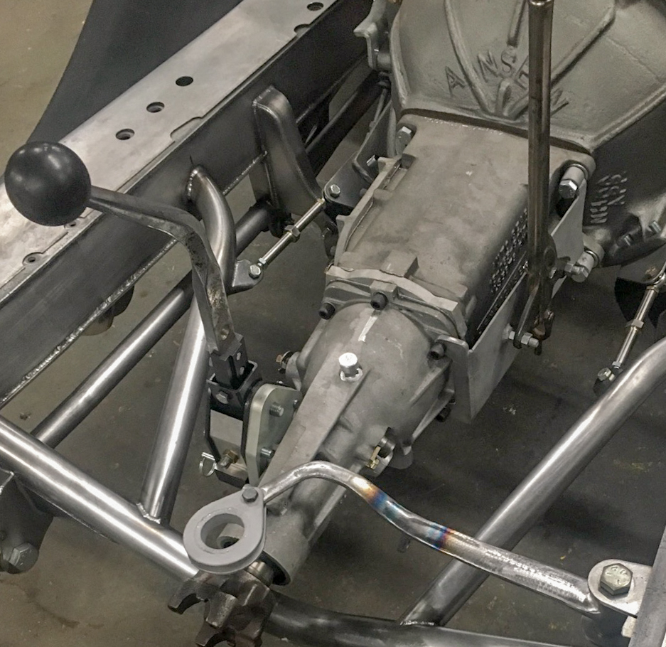

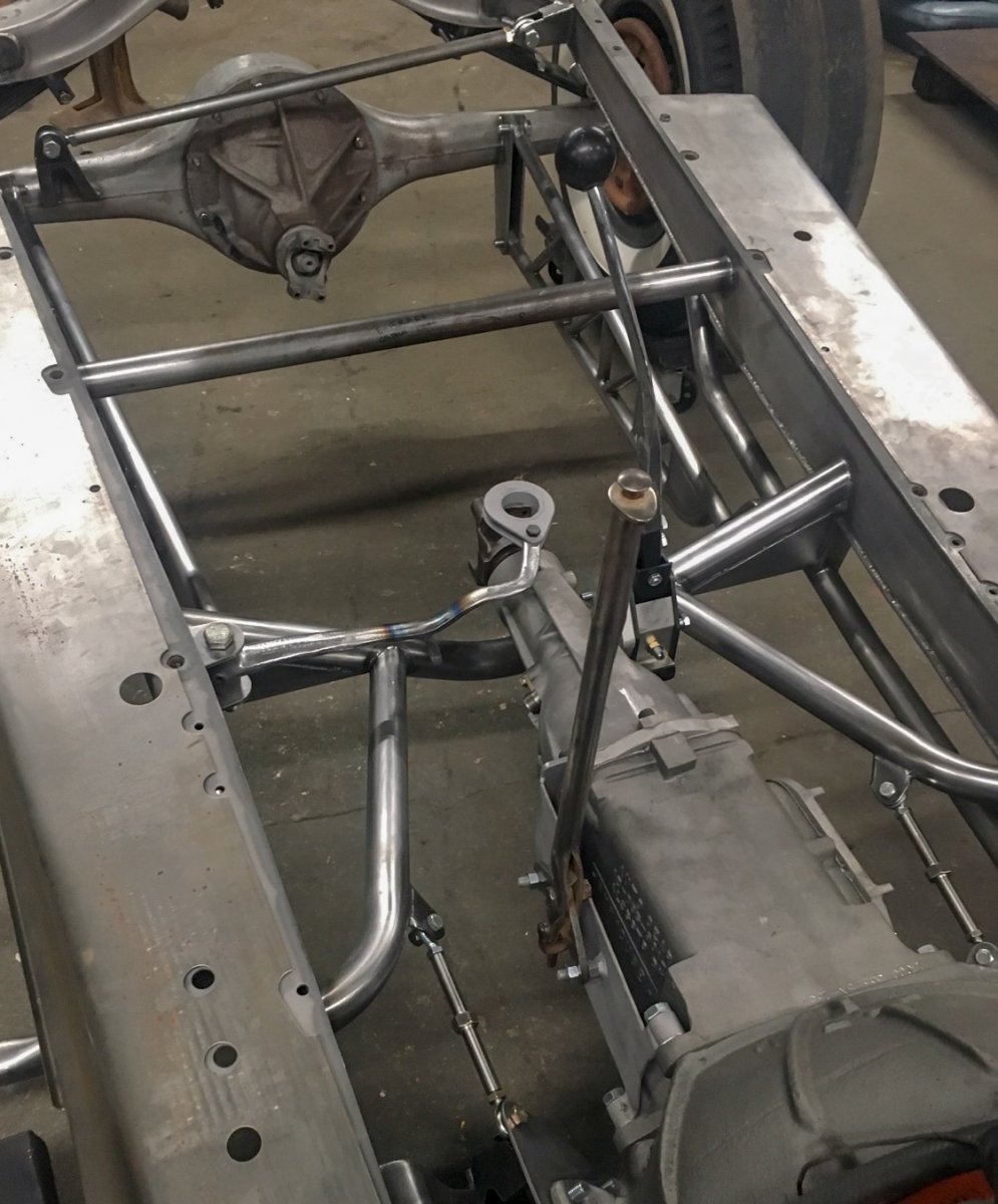

    Your car likely has a flat-ish floor like an early Ford, maybe running an A lever mounted off of a bracket on the trans could work for you? This is what I did in my car:
    Hand Brake Assembly Muncie in a Model A Ford.jpg Model A Hand Brake Adapted to a Muncie.jpg
