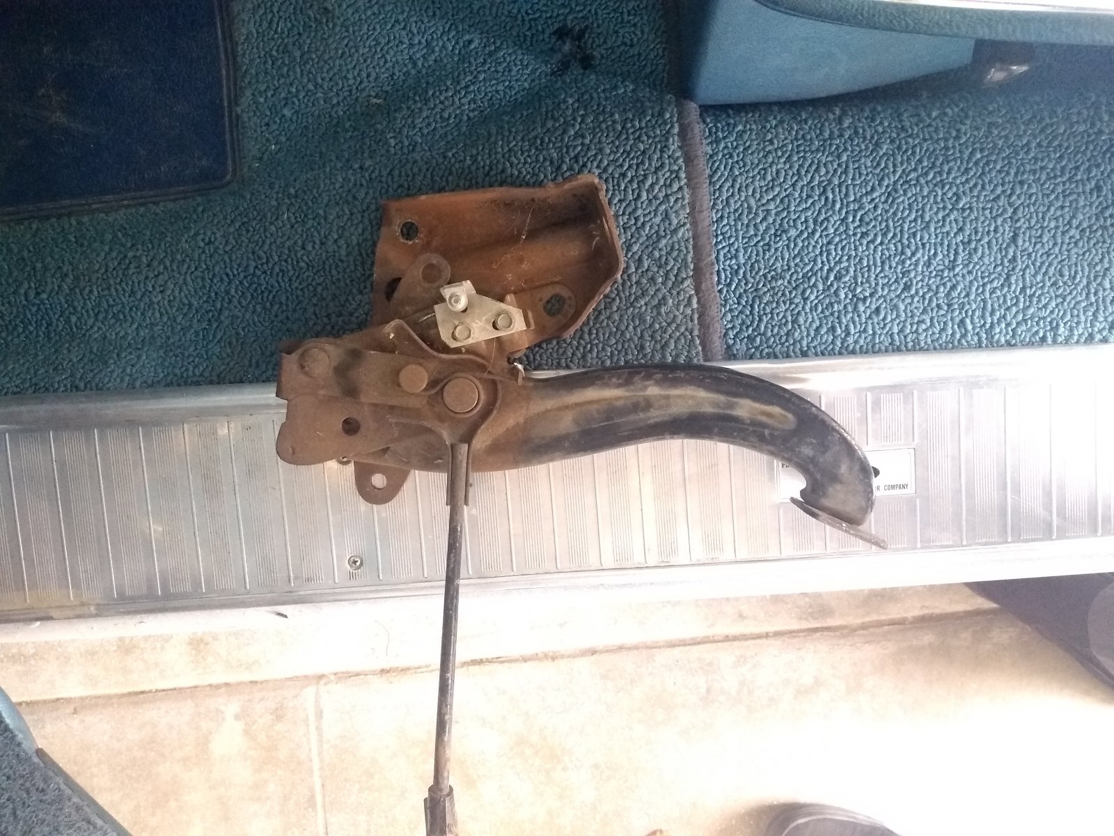

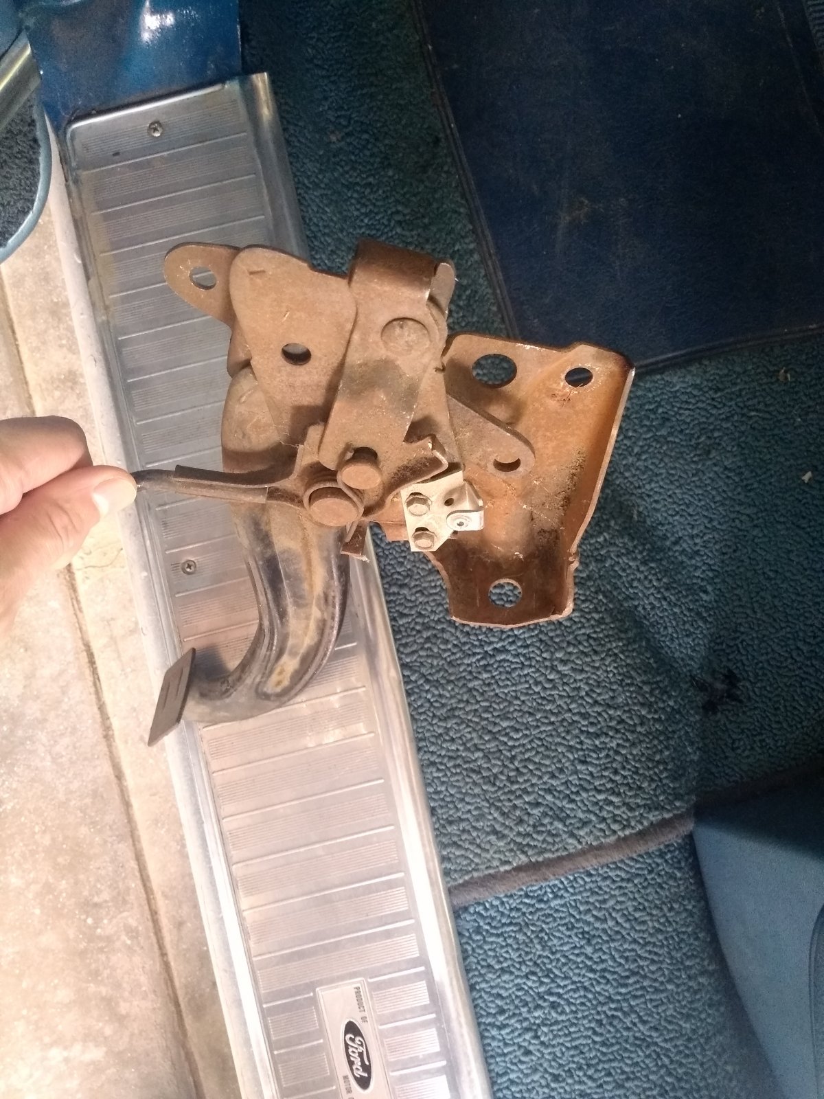

    I am reinstalling my parking brake on my 64 Galaxie but I seem to be missing parts and I don't have the book.
    I know I need a U-clip to hold the cable to the pedal ***embly, but what actually pulls the brake cable? Should there be a clevis like a Chevy? Please see the photos of my pedal ***embly.
    Thanks
    https://ibb.co/3cGRB2N[​IMG]
    https://ibb.co/vwY1ps8[​IMG]
    https://ibb.co/rHc01gV

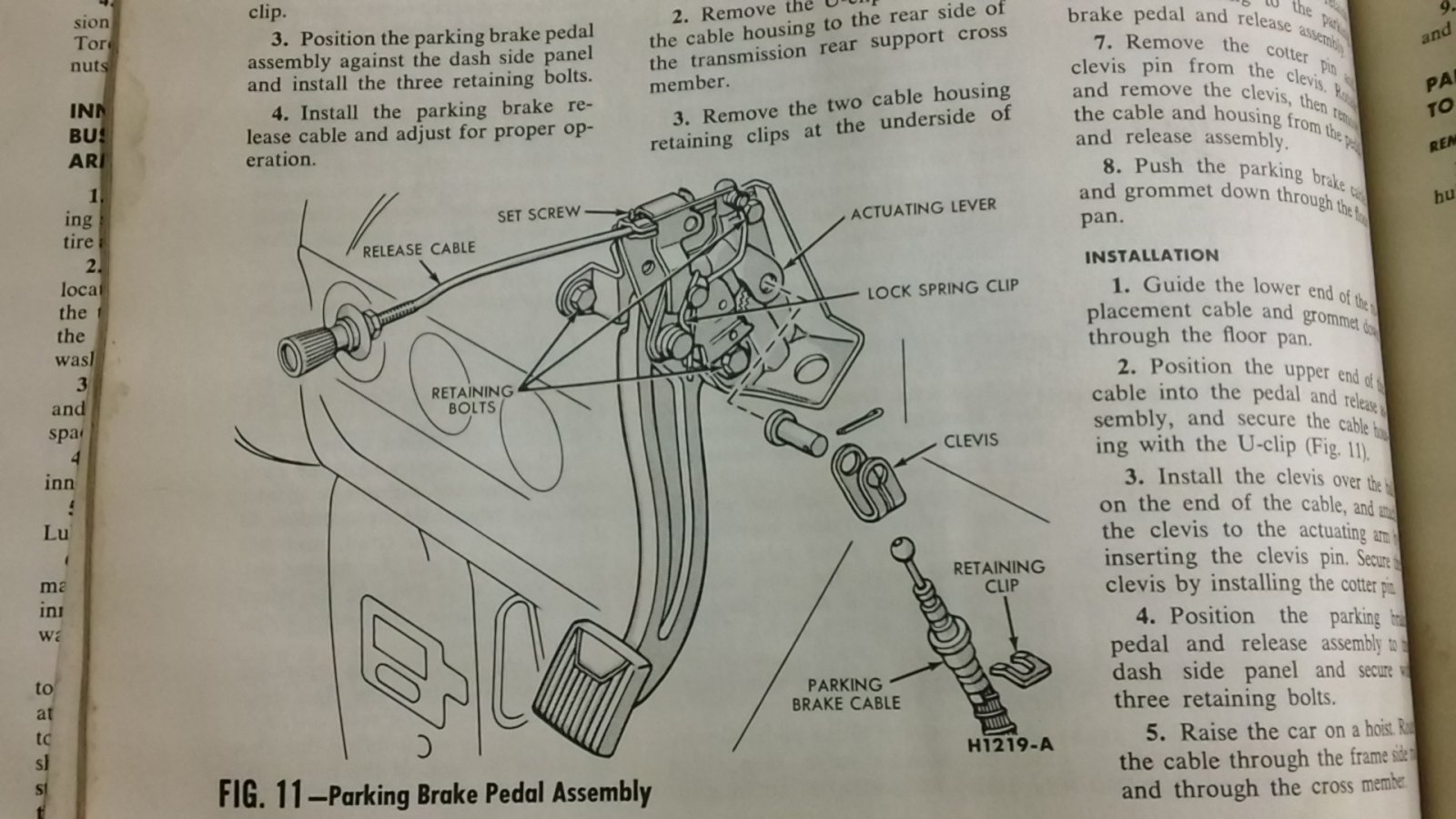

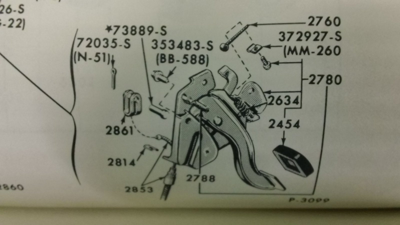

    Will these help, 1964 shop manual and parts books-- DSC00322.JPG DSC00324.JPG
    shoebirdgal, Bob Lowry and Budget36 like this.

  7. That's probably a 'generic' picture, Ford used a dash knob initially then moved the pull to under the dash later.

    Is the clevis part 2861 like the picture the other person posted?

    The pic is showing the 1962 setup but it is out of the 64 Galaxie manual. The ***embly is the same, but the release for the 64 comes out under the dash.
  10. egads
    Joined: Aug 23, 2011
    Posts: 1,431
    egads
    Yes.
