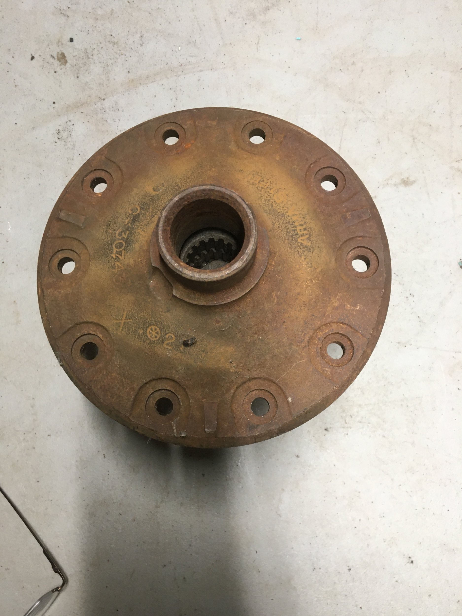

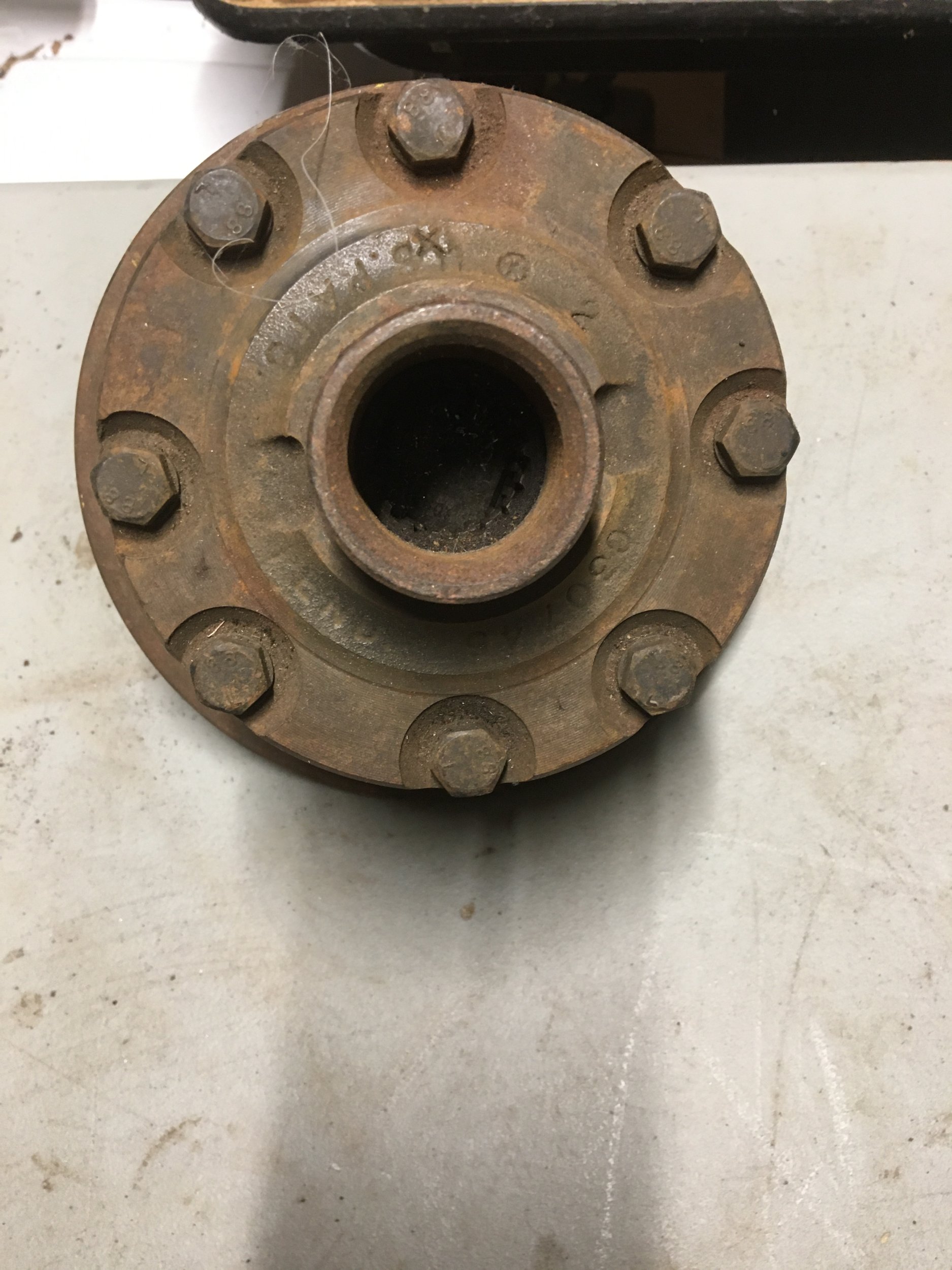

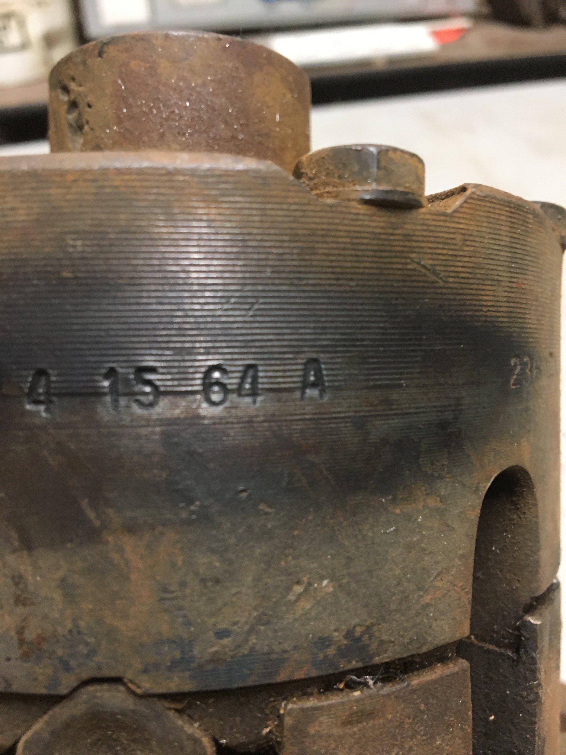

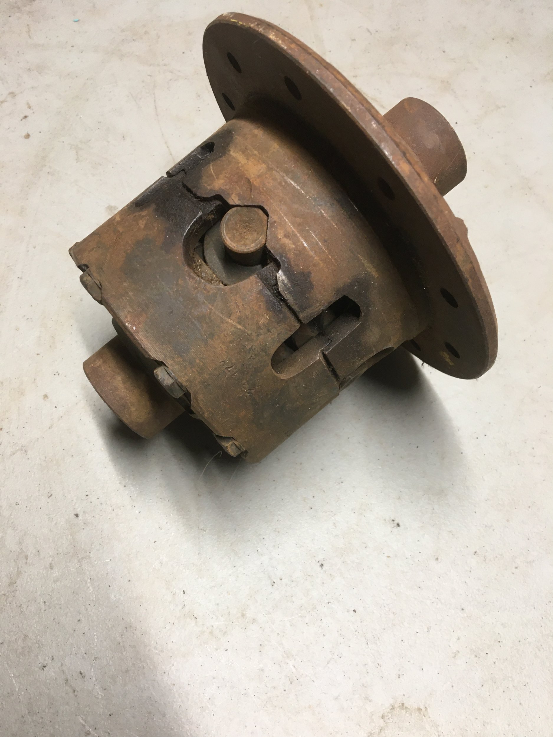

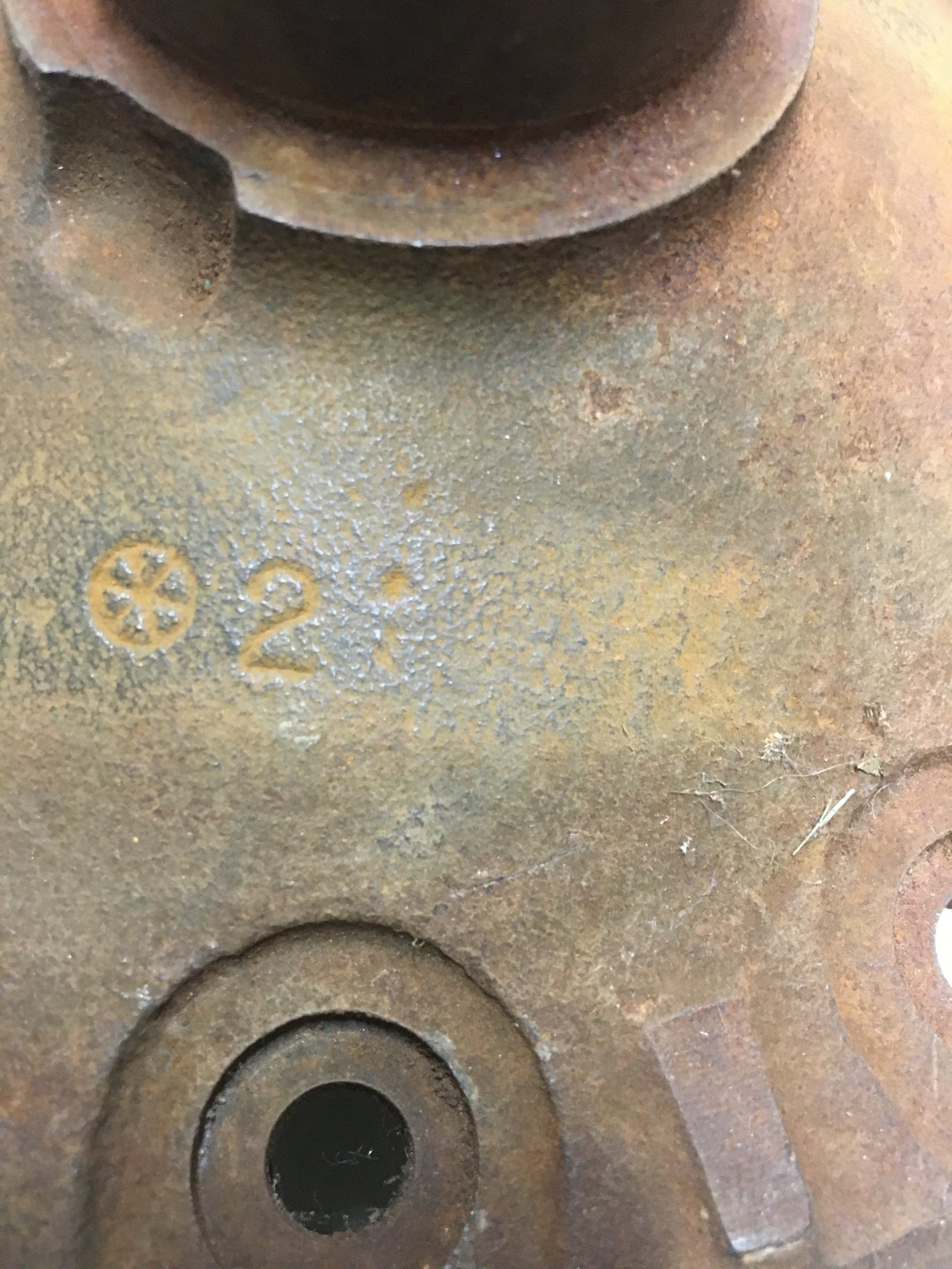

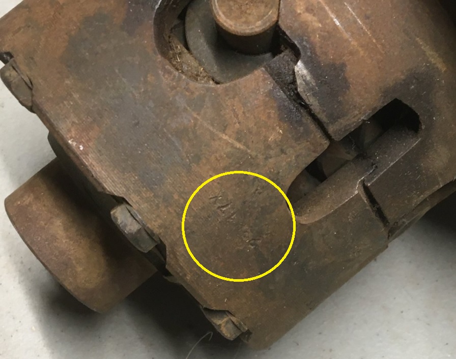

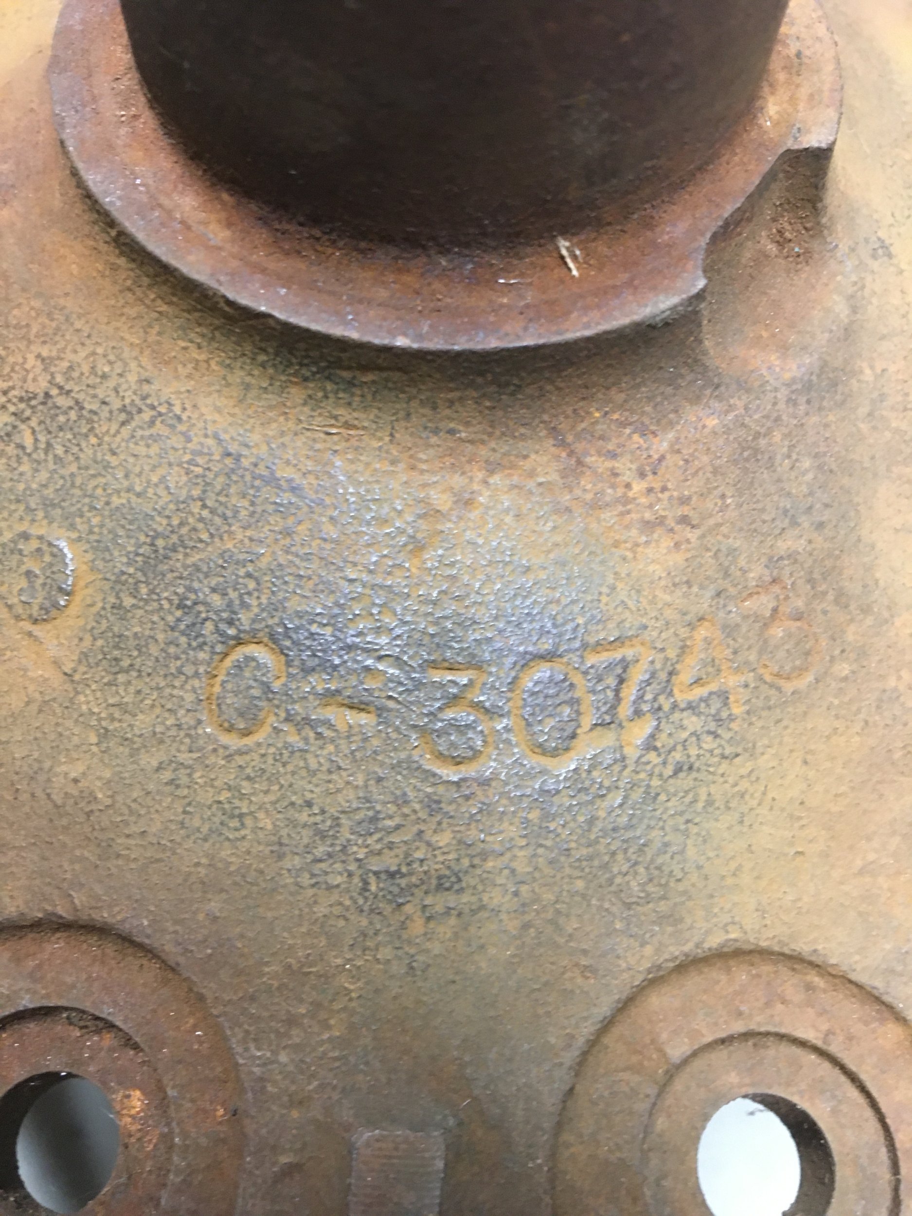

    Not sure of year or application. All help appreciated E0A9625C-CD32-4AE2-B032-5BF891ADD7CD.jpeg 04CEBDED-4777-4FC2-AB14-C46A3DF156A8.jpeg 3DAF079F-BC58-43DC-9E5C-8D48E502C063.jpeg F7A56444-91FC-4909-B938-B0C5EA1B6066.jpeg 38D08670-B2BC-4458-BAF3-1C9342050756.jpeg 1693886A-6E25-4FCE-9E24-99C52D656DA4.jpeg 11C7DABF-1B92-4403-AA34-5B2B222D875D.jpeg

    Arma steel is a GM name for a malleable cast iron. Pontiac crankshaft for example were mostly cast, and are Arma steel.
    How many splines on the axle gears? What diameter is the ring gear bolt pattern?

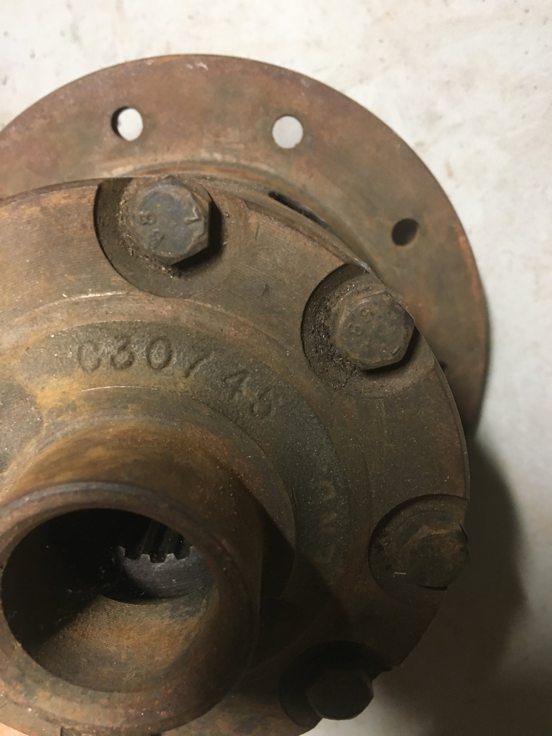

    Looks to have metric markings on the ring gear bolts.

    is that a Spicer looking number?
    hard to read it from here...

    I found some info from search for 30745 . Dana 44 posi carrier maybe 2 series.

    Took some new pics F7864F36-E33A-4324-9920-16E26AE9AE46.jpeg D9F6C829-A2B1-4B70-8658-A18E48D6E56C.jpeg

    Came in a pile-o-parts in a clean out. Only part I couldn’t identify. Diameter isToo large for a Chevy,maybe Olds or Pontiac?

    a quick google suggests its for 55-64 chevy pass cars

    Posi unit 55-64 Chevy. Nice find, they are quite desirable

    But how come the metric bolts if it’s that old?

  13. I don't think they are metric. If I remember right, they have a crazy marking because they are left hand thread. Gene.

    or someone broke stuff and tapped them with a right hand metric thread? :)

    Right. I just looked at mine, originally out of a '61 Corvette, has same markings. The one in question is a '64 piece.
