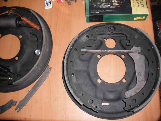

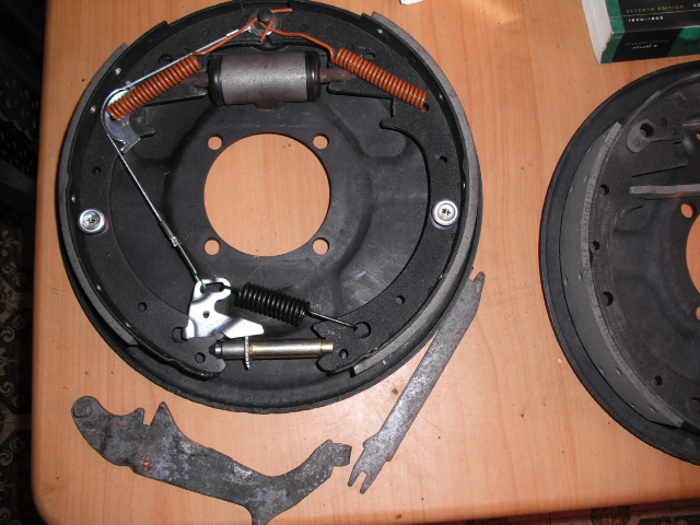

    The only pictures i saved was my f2 backing plate that im shipping out tomorrow...parts on it were just for mock up....i never fully mounted it.
    its installed w/ 12 x 2 inch brake shoes w/ a self adjusting kit.
