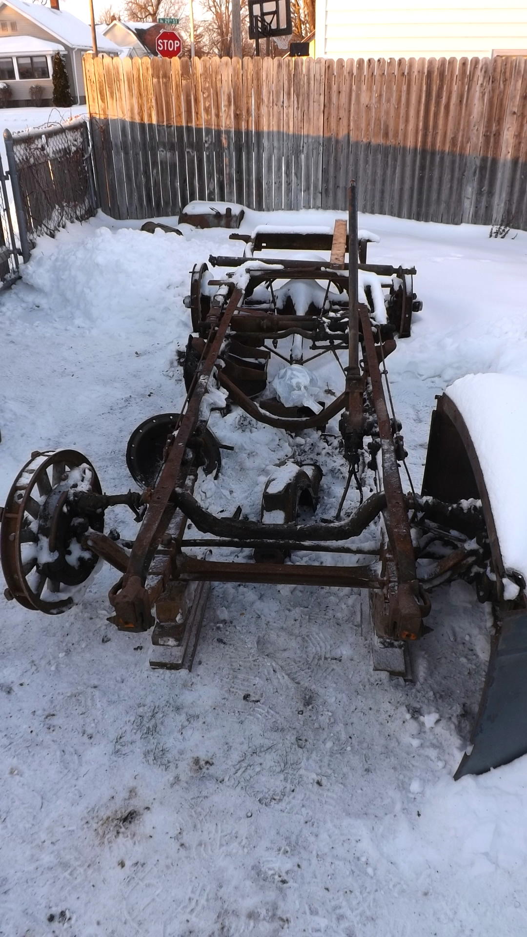

    Deconstruction continues in my open air garage... If you're up in Michigan you count a shovel as an automotive tool this time of year.
    Pulled out the rest of the engine and front sheet metal. Buick was kind and used a heavy tube for the front frame cross member/engine mount. It'll be an easy mod to weld some mounts for the Nash 8 on top of it. The rear mounts are gonna be the fun ones... they're a good 2' behind the original Buick mounts and will end up near the cross member with all the brake rod actuators... gonna be tight!

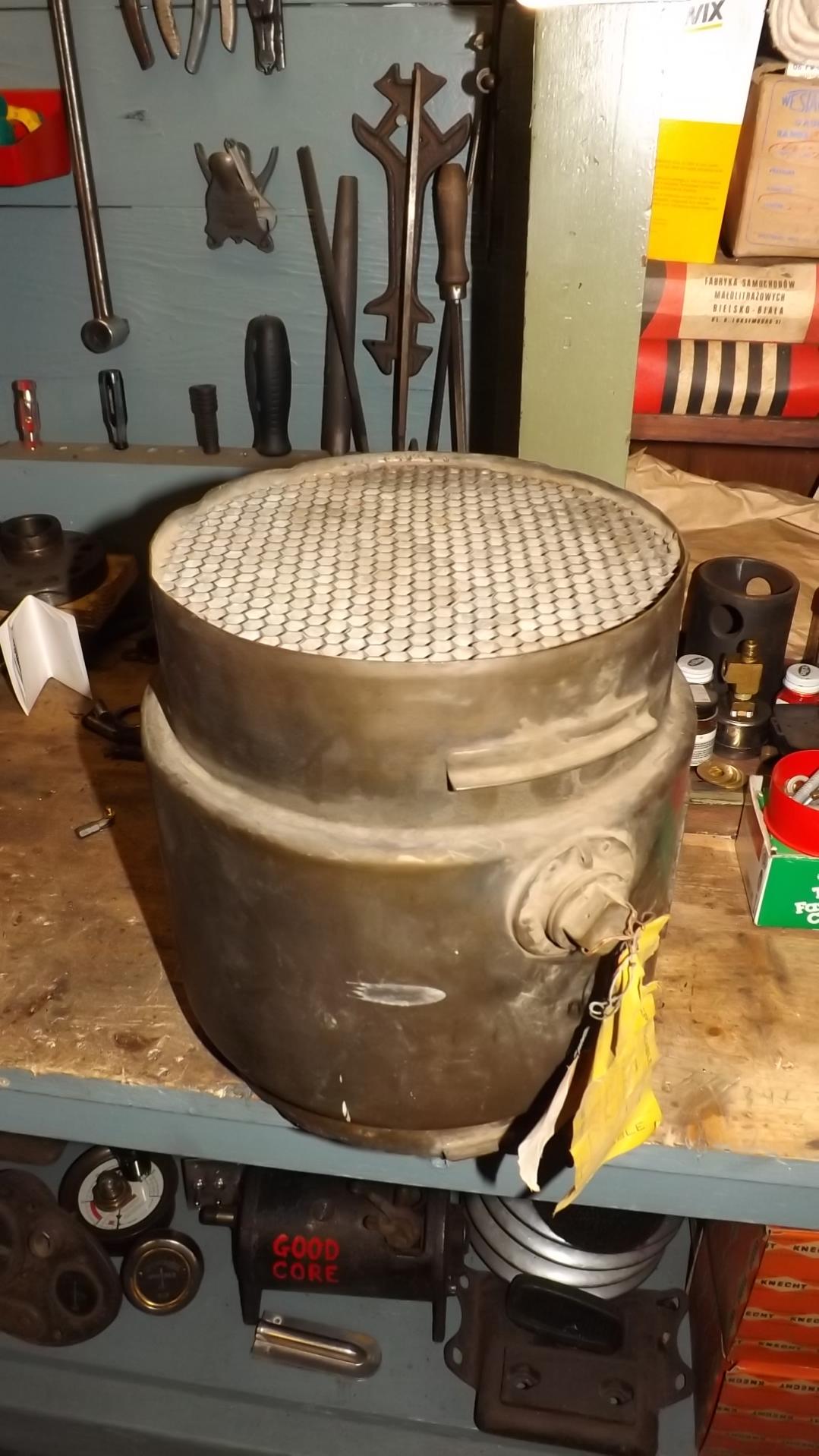

    Also scored this early 30's oil cooler out of a Douglas army plane... still has the army air corps service tag on it dated 1932. I doubt i'll need it but its just too cool to not put on the car somewhere! I'll just plumb it up so I can have the option to use it or not.

    Maybe it could become a coolcan to prevent vapor lock in the fuel? Or maybe a cooler for a beer?

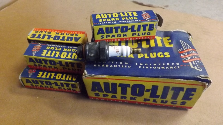

    I managed to get my hands on 16 NOS plugs for the engine... no small task!

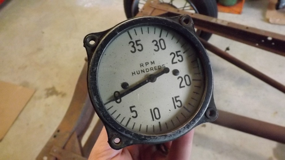

    Snagged a neat counter clockwise tach that has the perfect RPM range...

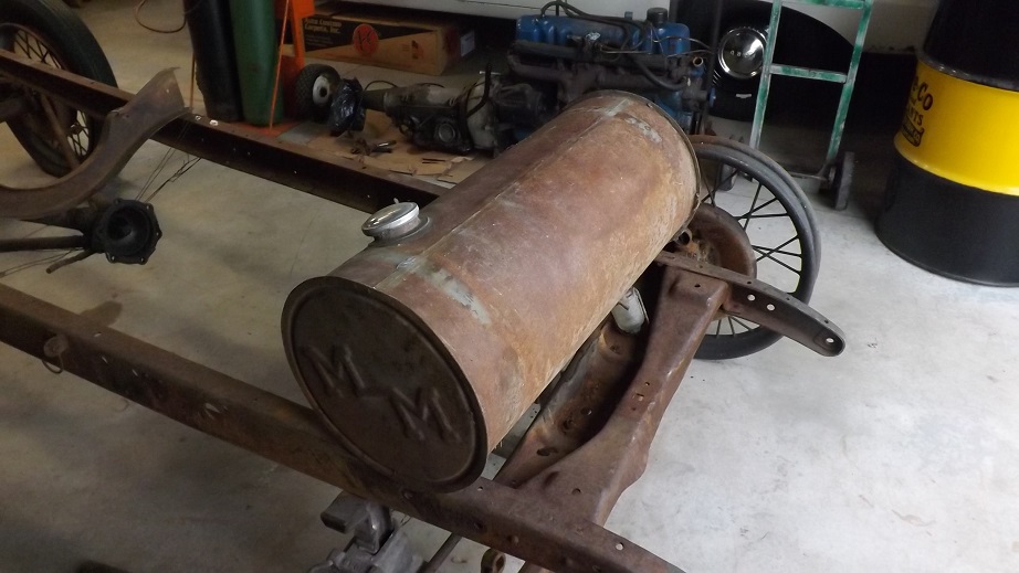

    Found a fuel tank also, its of off some sort of vintage Minneapolis Moline equipment. Its got a few dents but I'll pop those out. Looks like it holds about 7 gallons. I won't be driving this thing anywhere but local so that will do.
