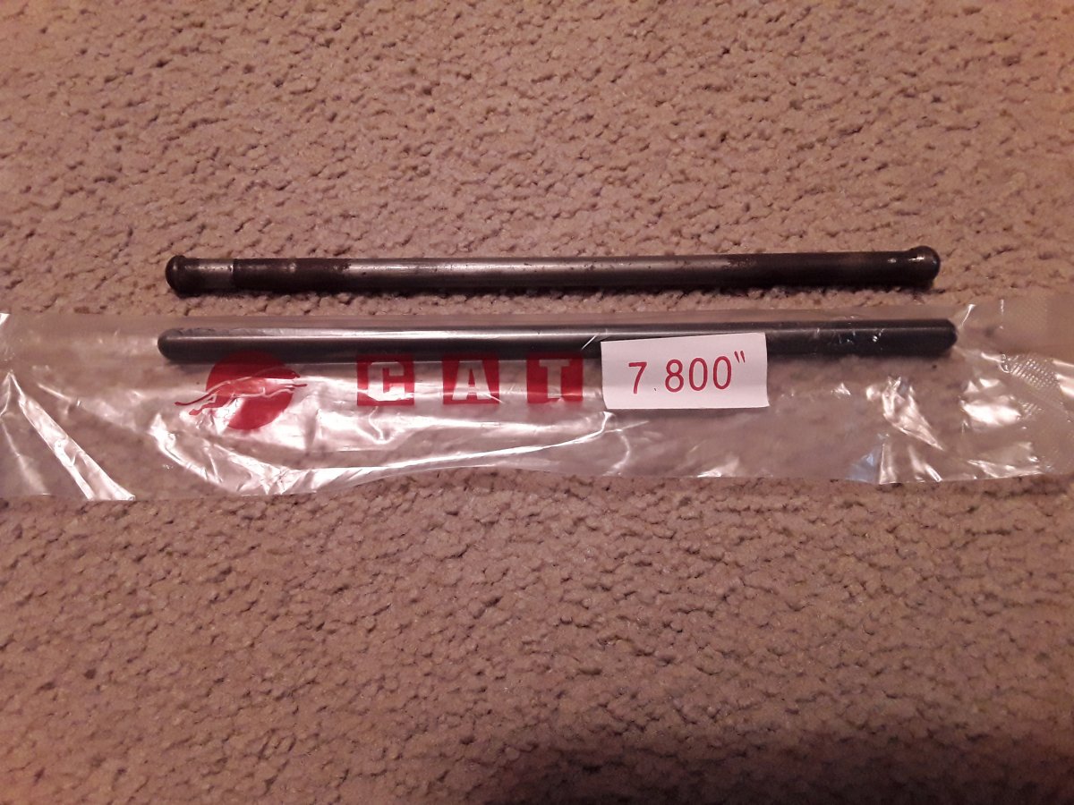

    I did not get the through spindle operating rods. True or false that a SBC pushrod works for this? I can certainly build them on the lathe out of something like 4130 or drill rod if I can not locate a suitable part.

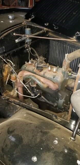

    Pics of the car atleast :)
    Jet96, adam401 and slv63 like this.
  16. Brake rod have a ball on the top end and socket on the bottom
    rusty valley likes this.
  17. 20200831_145527.jpg 32-34 brake pins are 7.75 inches long with a ball on each end. I used hollow push rods that measured 7.8 inches long. Been 5 or 6 years now with no problems. Not sure if they were sbc or not. Stock 32 brake pins are hard to come by.

    Good deal. I will have a couple on hand.

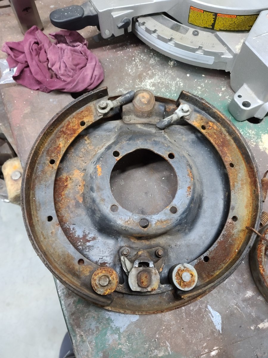

    Another pic of my big brake kit lol
    If you need everything to be perfect, look away. These came from up north and while they are structurally sound, the plates do have some pitting after being stripped and wire brushed.

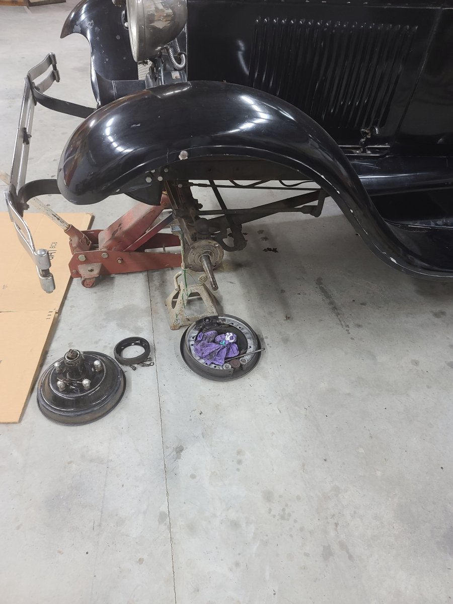

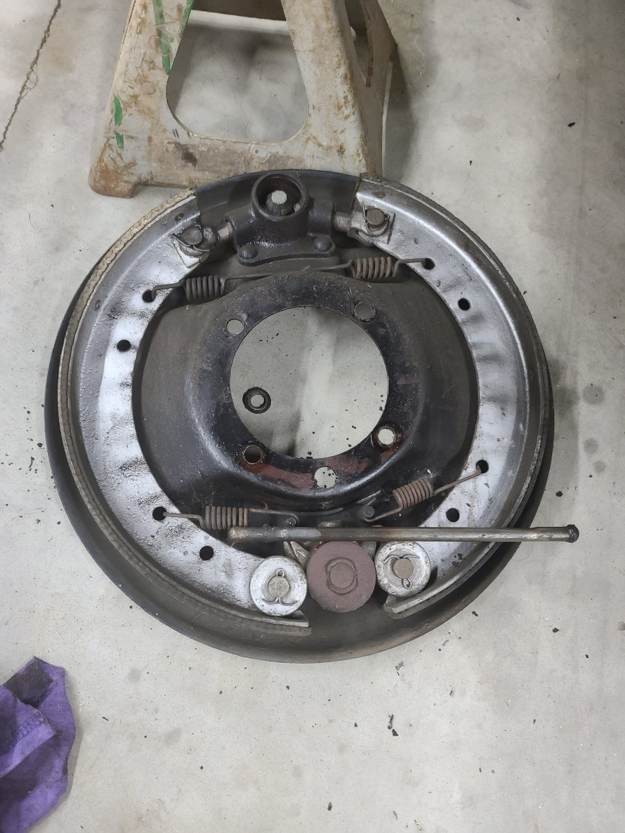

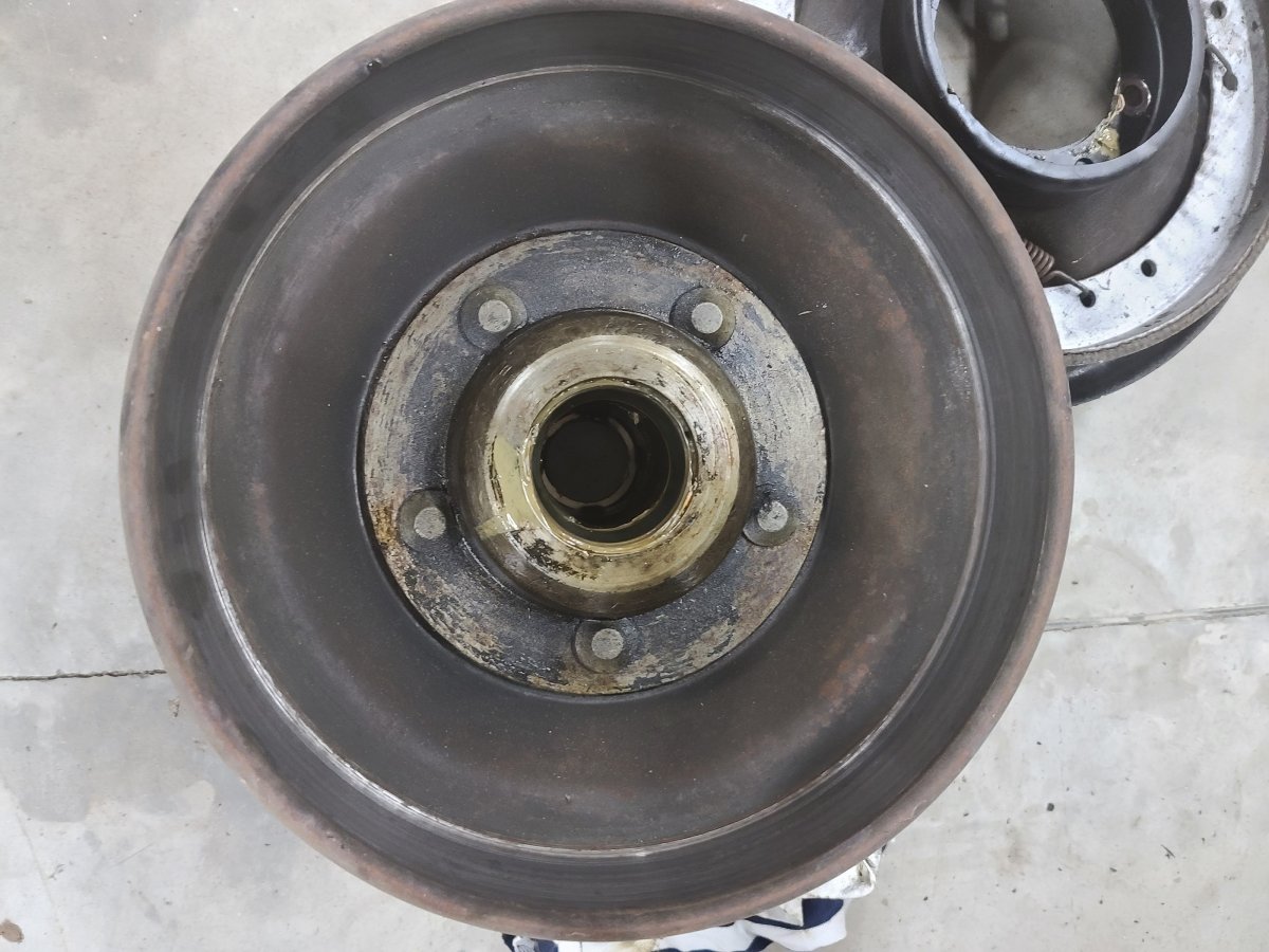

    Pics of the removed brake setup. Everything is in decent shape, there was just no "bite" to the brakes. The steel drums are polished to a mirror finish, as are the linings. Maybe fresh linings would have helped but I really do not think so. I will put these up as I think a set of 31 iron drums and fresh linings would put them into order for a lighter car. I am also looking into collecting pieces for a another stockish car/truck build so I can slap these on and have a roller with some brakes if needed.
    20201021_165623.jpg 20201021_165633.jpg 20201021_165639.jpg 20201021_165734.jpg
    I am currently waiting on rivets to arrive. The linings came with steel rivets and they just don't seem to crush like I want them to.
