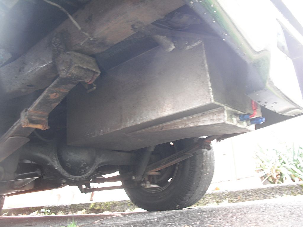

    The vehicle this is under is not a Mopar, and its not HAMB friendly, lots of hambers think that the OEM rear this replaced is suitable for use in a hot rod....I think its a POS.;):D truck 006.jpg

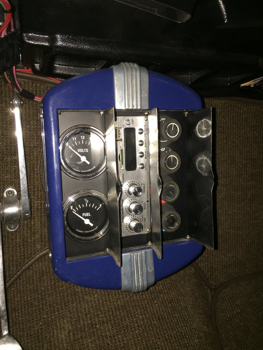

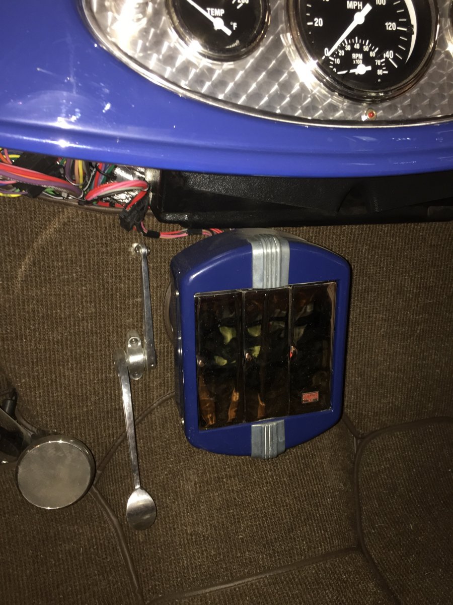

    I have a few. On my 32 I wanted to keep the dash looking stock with 3 gauges so I had to find a place for the other two. I found this old heater and the light bulb went on, put the gauges inside. I also had room for a radio unit I can plug my Ipod into and all of my heat and A.C. controls.

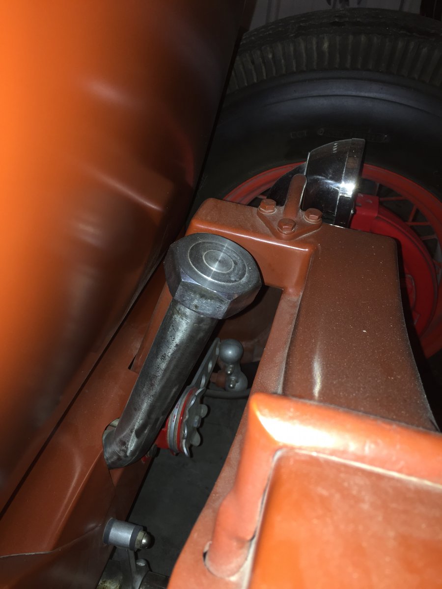

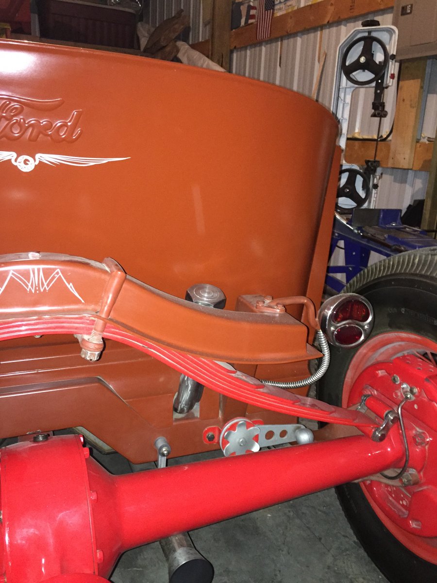

    On My 26T modified I built my own stainless gas tank but didnt have a tig to weld it up. The guy that welded it worked at a dairy so the filler neck is old stainless milk pipe and the gas cap is a union that we did a bunch of work to.

    This is fantastic! this not only gives you a place to mount the extra gauges but a place for the radio & switches and the dash stays simple and clean.HRP

    I forgot to mention If a guy looks close at the pictures of my T modified you can just see the exhaust pipe. I made the hanger out of a Geo metro connecting rod.

    George, where are the shackles? This the S-10? Just curious. I am Butch/56sedandelivery.

    SHHHH. ;) Dont say that too loud.:D The shackles are at the back, sorry the photos pretty piss poor, I know its pretty blurry.

    that heater cover is about the coolest thing ive seen in a while. backyard ingenuity at its finest...

  15. Ya. Love that heater box.

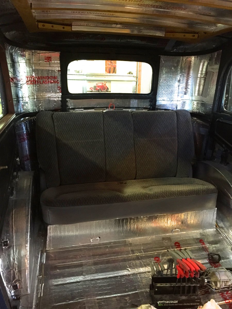

    How about Peel and Seal Sticky window flashing instead of a Dynamat type product? I bought mine at Lowes and it cost about a quarter of the price of a name brand IMG_0086.jpg

    That's pretty cool and innovative
  19. Greenblade
    Joined: Sep 28, 2020
    Posts: 652
    Greenblade
    That looks really clean! Matches the other dials well

  23. I've used that stuff from Lowes on a couple of builds...

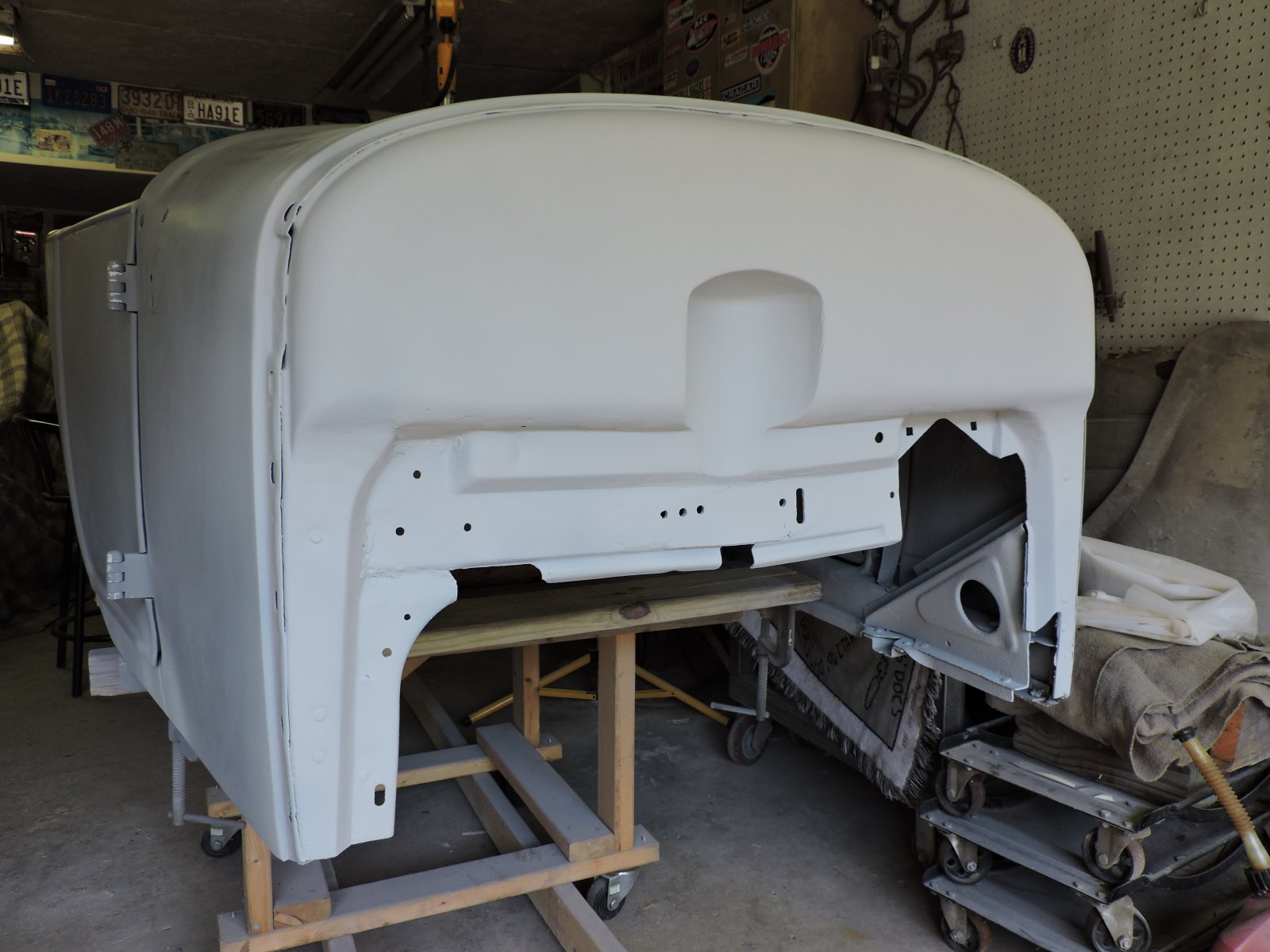

    I've got a bunch of them but here's a firewall inset for distributer clearance made out of a large cut up oil filter on my 27. DSCN1134.JPG
