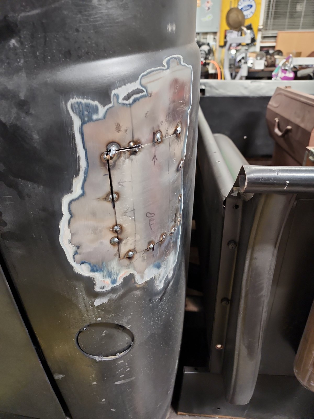

    Made a couple patch panels now. They all fit really well. I'm trying the cut and **** method. Each time the patches end up real low. I'm tacking in basically a star pattern, using air to cool the weld after each spot. Really Taking my time to fit it all flush and not get heat, yet after I grind the weld down its low every time. Anyone have an idea on why it's not staying flush? I'm at a loss at this point. Trying everything I can not to use filler.
    47 dodge steel, 20 gauge patches.
    Thanks

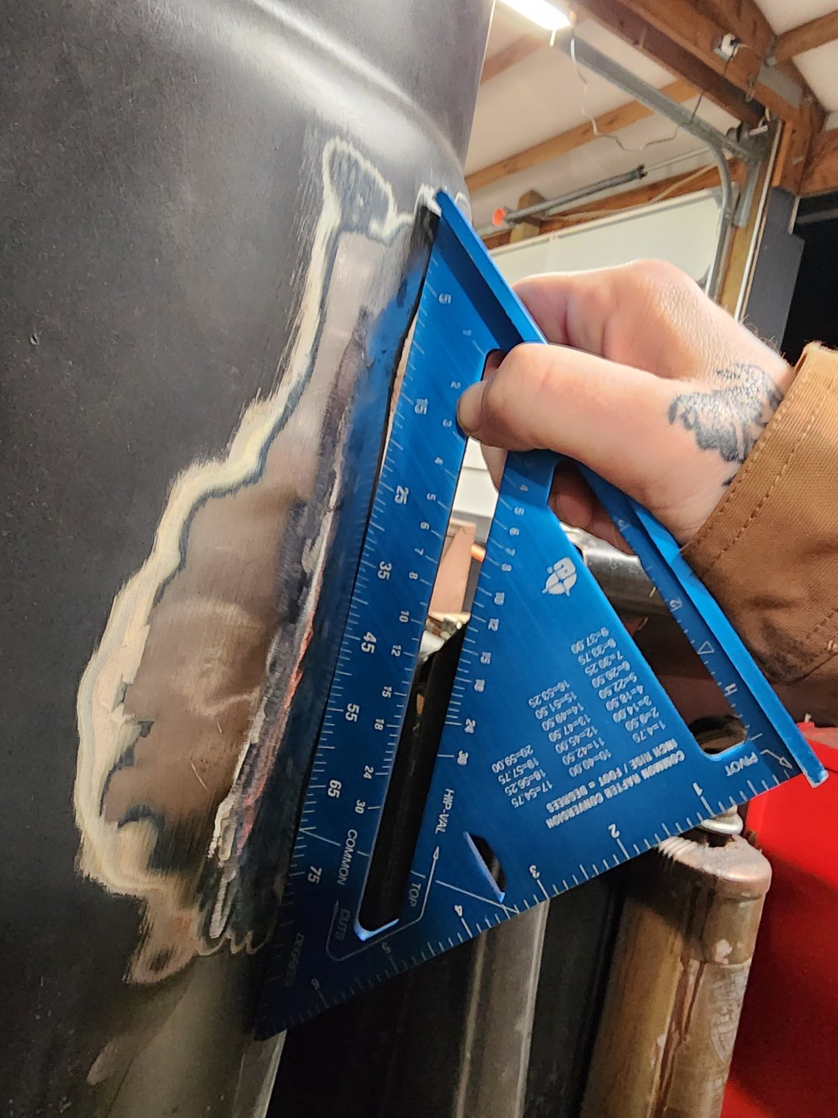

  3. OZCAST
    Joined: Oct 12, 2020
    Posts: 277
    OZCAST
    Pics added below. You can see where the welds are it dropped, but the middle stayed true. I literally blew off every tack. I could touch the weld and paned with bare hands the whole time with warmth, buy not hot

    Don't cool the welds! let them cool on their own. Patience! When you heat the metal by welding, it shrinks as it cools. When you blow on it it shrinks more. After every tack, bump it back up from behind if you can.
    Also keep your gaps as tight as possible.

    Welds shrink. You need to stretch the weld back out by hammering on dolly afterwords.
