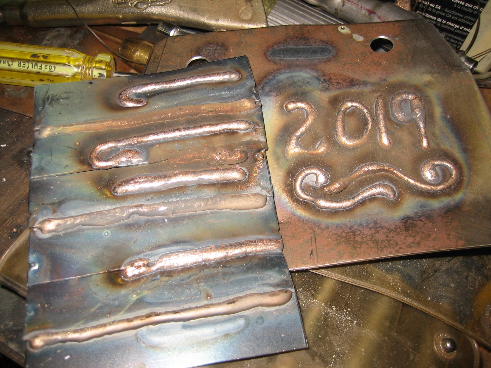

    While this is welding, it's also as complicated as asking for opinions on setting up 3x2 carbs, is it bad cams or bad installs, or maybe is there enough zinc in Rolaids to help with break in.

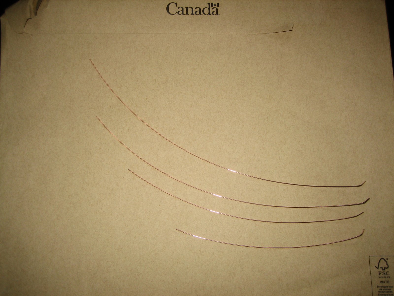

    What size of wire. 023,.030,.035? Think of it as a fuse that needs to burn, with that you have speed of ignition and length of time to burn.
    Think of WFS a as poking stick, more of it comes out the firmer the push. Also in the abstract, more means colder. Like adding to a boiling pot, it cools down the water when you add more or dump the noodles in the pot.
    The gas or gas mixture is the equivalent to different grades of gas. Burn rate, heat release, force of explosion when the droplet leaves the end of the wire.
    Also cutting the end of the wire with each start, it helps with arc initiation where the ball ends will slide or bounce.
    Lots happens in a nano second.
    You have a good little welder. Just got to get you to understand the process to better adjust to different welding conditions. That means practice, learn, discover and more practice. IN this instance I was playing with stick out. Longer stick out restricts the arc column. Voltage widens it. In theory, how wide should the bead be if the wire is only .023 in diameter and the metal 20ga.?
    Usually when taught welding it's monkey see monkey do. My approach is more hands on learning, see what it does if you do.
    My first attempts with a silicon bronze wire. Scratch that off the bucket list. What polarity do you use? Anyone want to guess?
    In regards to wire and polarity. Most read and never ask what if I did.
    Why you might not want to, or when you should.
    That's electron theory **** is actually quite interesting and most recently, it's been changed. But contrary to popular belief, it's just in theory whether or not electrons actually flow. No biggie.

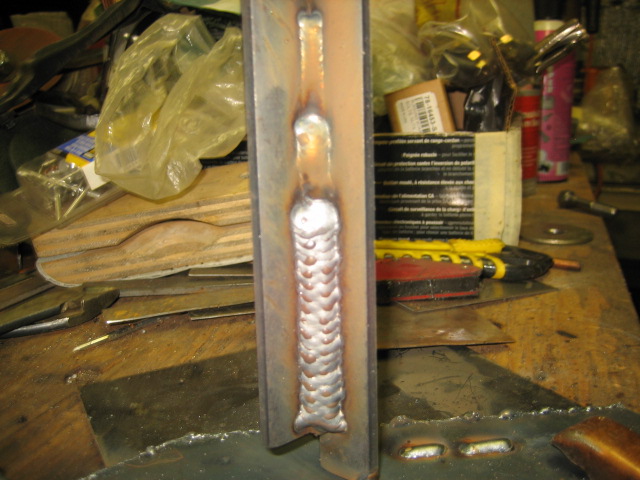

    Getting back to those two paper I originally attached, you don't need to know that stuff to weld, or to weld a pretty bead, but it helps. A lot actually. Sure, I could slow down, tweak the WFS a bit and tighten my motions, but at the time it was do it get it done take a picture for proof I could. Typical welder excuse but it it what it is.
    Penetration or fusion. You want fusion. Trust me when I say, penetration is over rated. It's like saying, look at all the rubber I left on the ground or I have a foot long wiener but a 6" bun.

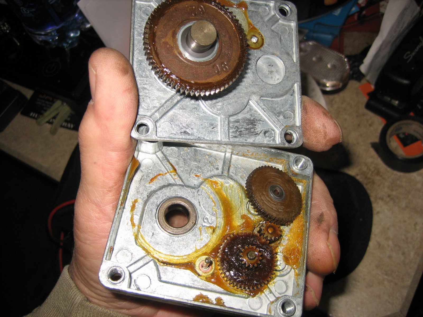

    Sometimes it is the scalpel. Old dry grease, little motor won't over come the resistance, wire doesn't feed as promptly, jerks and jumps. Nano seconds but if you don't know, you could be scratching your bald head and wondering why. This was a used machine that I bought just because I knew what buddy didn't about them.
    All I got at the moment and really, the best response comes from asking a direct question and include a picture.

  5. NoelC
    Joined: Mar 21, 2018
    Posts: 779
    NoelC
    Just a few thoughts on welding in that patch. As mentioned, what's heated expands and when cooled contracts, but... what's heated and what stays cool affects how it contracts and is equally as important to understand.
    It's about energy and where it goes. That said, air or water removes heat, reduces material temps., but as far as shrinking goes, it's done long before you squeeze the hose or grab the pliers.

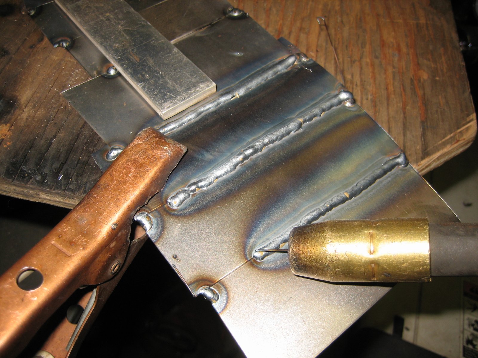

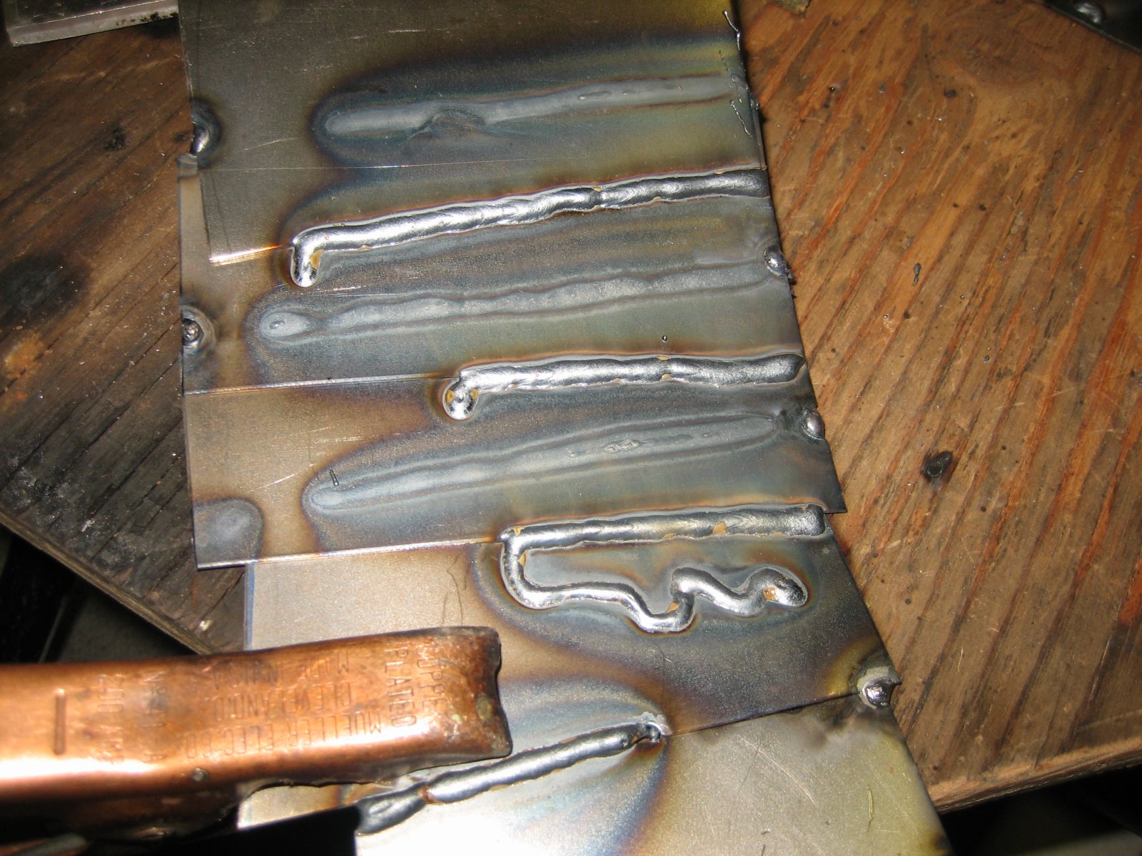

    Gap or no gap, cut it straight or at an angle...who thought it would be so complicated. How about this, see that picture of all the welds in a row, progressively changing, can you see how that could be done with voltage or WFS? Increase or decrease. and if you were to see stretch marks, where would they lead.
    How about this on for a size, try to understand what each component is doing by referencing it to what you know.
    WFS as example. You have a wall, a car and a gas pedal, squeeze the trigger. DO more penetration or do less.
    It's a gun, point where you want the bullet.
    Soft ice cream, how quick does it melt? Does it melt lol. I tried that with my cheese slice and it didn't melt it burnt.
    One thing for sure, you will learn in spite of us if you want it bad enough. Good luck.
    PS... your wire size...hard to understand but, if you want to see a conversation like the cam shaft one, terms like slope and induction and volt amp curves come up in relation to wire size.
    There is some science to the wire size, timing cycle to melt the end, that like a cam is some what forgiving yet, controversial.
    An example of that is one might think to much WFS when really it to much drag and moving to slow.
    My picture, little men, rope, fire. That's polarity looking at you.
    Well, that and surface area. So why do some wires require a plate positive, electrode negative while others plate negative, electrode positive. And if you said who's tried it the other way for ****s and giggles not one will raise a hand.
    What did you think would happen eh? World come to an end, lol. It doesn't. I'm proof. Good luck trying. But having said that, posted those pictures, you did good. That's how guys get screwed over in autobody jail, and still have it look no where close to what you accomplished on your own. So yea, skim coat of filler, primer and paint it, because perfection is over rated.
    Tops and bottoms, one dial was turned.
    OZCAST likes this.
