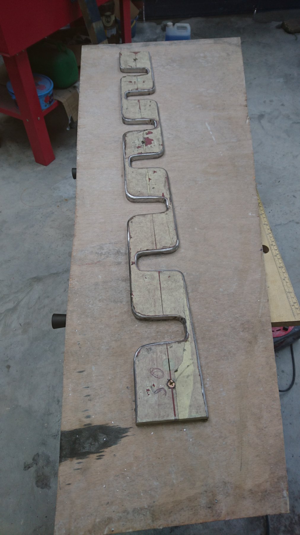

    I am in the process of cutting out all the rot in my trunk , It would have been easier to replace the whole trunk floor but they are not available for 59 Edsel , well not over here in the UK
    Here are some of the patch panels I have made using home made jigs DSC_4313.JPG DSC_4325.JPG

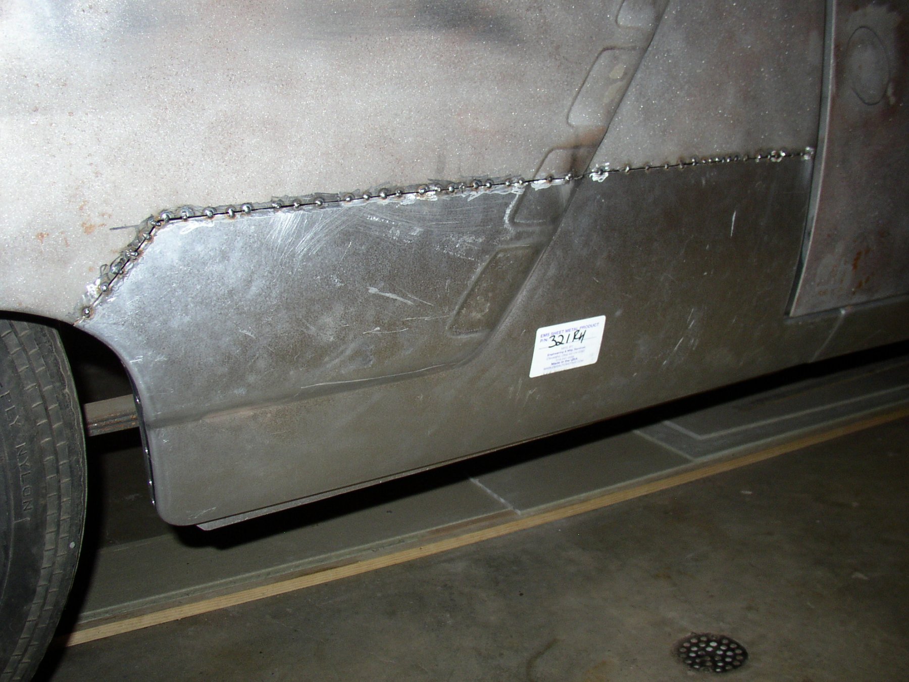

  26. safetythird
    Joined: Feb 26, 2014
    Posts: 295
    safetythird
    I've always made a slightly oversized patch, and then I either tack it in place of rivet it, then cut through both the patch and the panel underneath. Then I separate the two and the hole is the same size as the patch.
    YMMV.

  29. Lap welding Vs **** welding.
    For me, **** welding is easier. A lot less mud work.
    I will make patterns. Yes, multiple if a body line is involved.
    Make the part. If the pattern is accurate and you faithfully follow that pattern, it’ll work.
    Fit the pattern and scribe around it. Make reference marks across both the patch and panel being repaired.
    I will rough cut within 1/4 inch of the scribe line. Then use aviation shears to cut against the scribe line. Line up reference marks and weld.
    By not lapping over, the weld distortion is easier to remove.
    It’s easier to metal finish and eliminates the possibility of a shadow line in the future.
