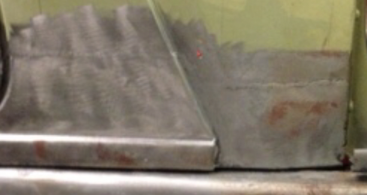

    this piece wasn’t 100% ***essable from the back side. The weld area was file fit. No gap.
    That’s easier to do than you think. The advantage is the minimal weld it took. The weld was barely 1/8 of an inch wide. **** welding for the jamb area saves the filler transition. Meaning less filler work.
    If you start learning these skills now, it pays off later.

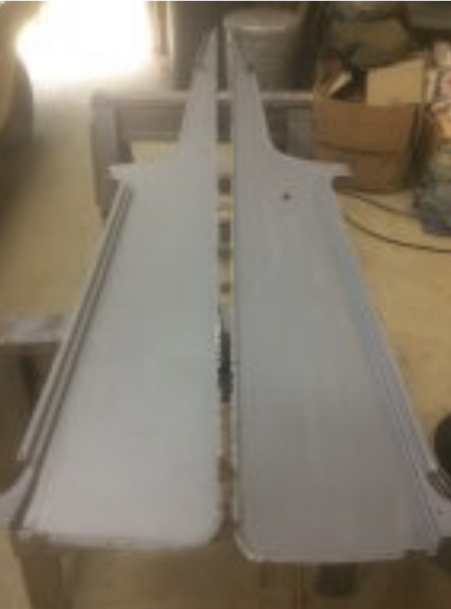

  22. 7CFC39A9-FBCB-4052-9A42-A29CC528957D.jpeg 4EDEFFBC-345D-4277-8DF8-1B3FE101E6A2.jpeg
    qtrs removed from a 59 impala. The entire bottom was replaced as were most of it where the upper fin welds to the qtr. Spot welds are easy to remove. The removal enabled all this work to be metal finished. Also the wheelhouses were repaired easily.
    these are the tops of the fins after being rebuilt and epoxied, did the same for the qtrs. The inner structure was also epoxied.
    Is this normal? In my world it was. We all come from different backgrounds. You have asked for advice and great suggestions have been given except maybe for that one video.
    My experience from the collision side removing welded parts is natural. For someone learning it may seem daunting.
    I really do not care which method you choose, it’s your ride. I’m glad to see ya attempt to save it. I’m actually surprised the panel bond junk hasn’t been brought up.
    As far as **** Vs lap. I was taught to flange or build sleeves when sectioning. This method was taught through I-car in their early days. Then I started working in a shop with access to factory repair procedures. None listed a flange or sleeve.
    Lead joints. Manufacturing techniques required many to use those large leaded seams. That’s no longer the case. I have removed many of them successfully. Or make joints in new parts that look better than the factory in these old beaters.
    this rocker, cowl and qtr pieces were built to eliminate the need for lead or other heavy fillers.
    I’d visit my friends in shops working entire sail panels (C pillars) with mud covering up lap or sleeved joints. We **** welding them and most times only needed a thin layer of a 2 part glaze. Some got nothing but primer.
    Your difficult spot is the roof. The drip rail area can be tricky. I’d probably save those spots for last after you get practice in the other areas.
    Good luck and get busy welding
