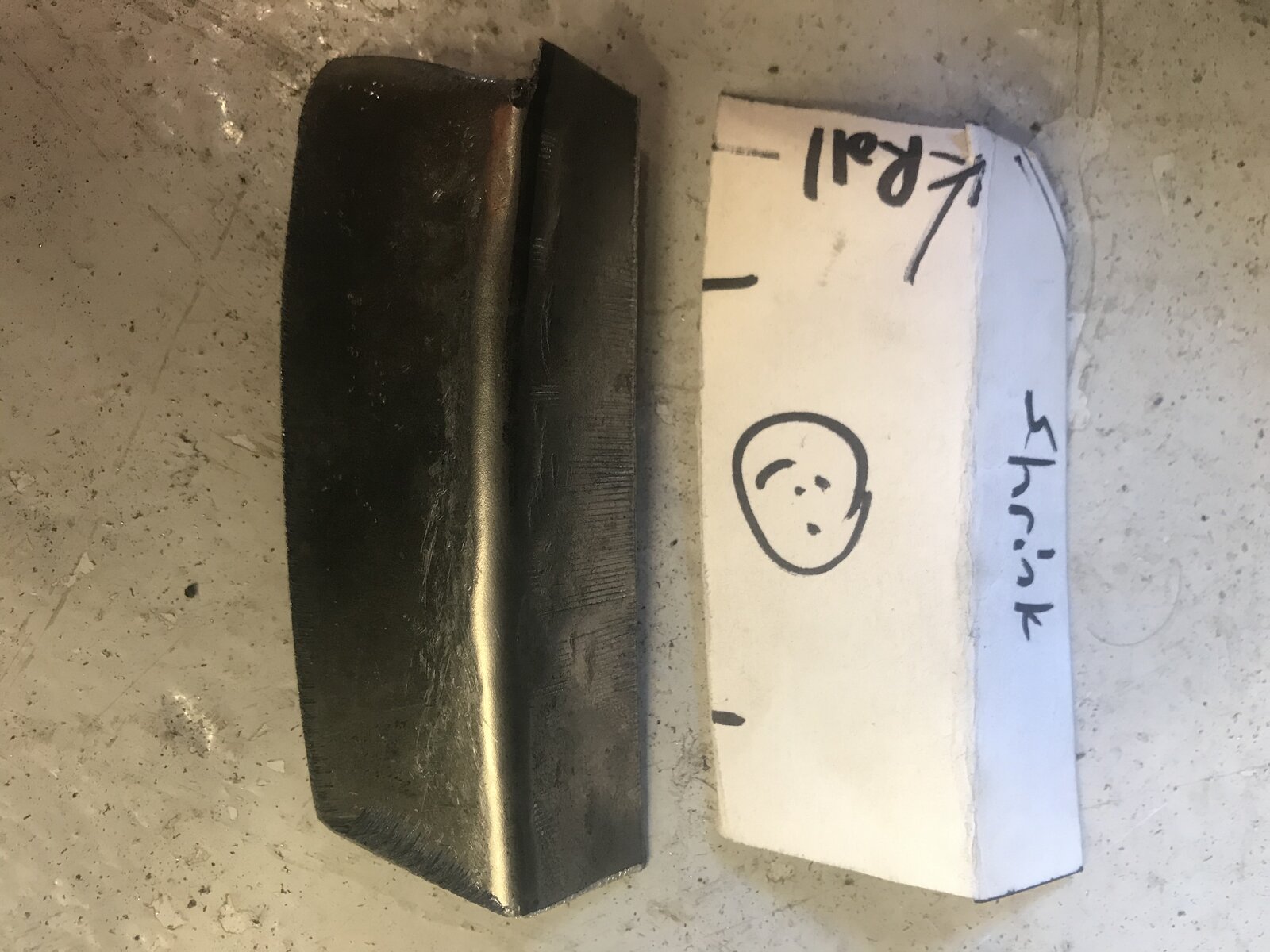

  4. Use poster board to simulate the part. It’s cheaper when you mess up. The poster board will tell you how to shape the part.
    Where to stretch or shrink.
    F-ONE, fauj, FAKKY and 1 other person like this.

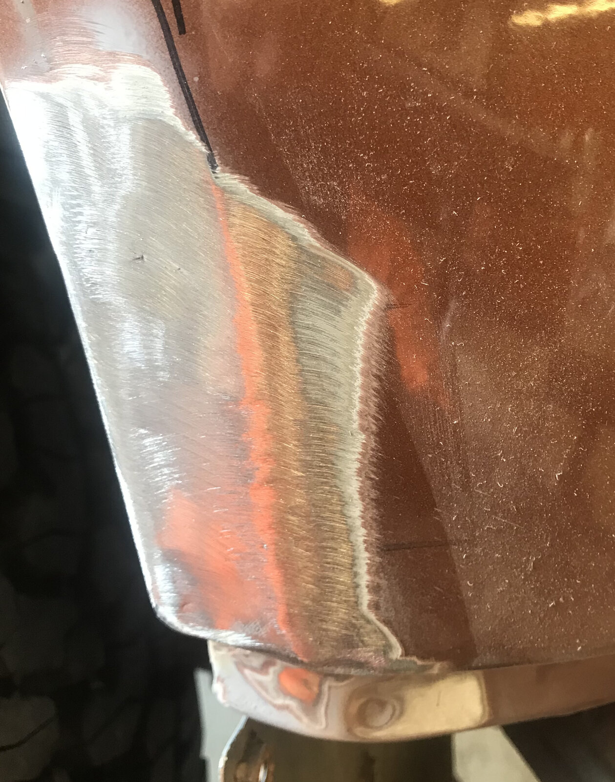

  7. FAKKY
    Joined: Sep 9, 2016
    Posts: 295
    FAKKY
    well I got it in ........
    It looked really good originally ....... but made a bonehead move of trying to grind everythin down flat ...... then realized I had cat into base metal in few places and had to reweld and build up the thin metal ......
    So will be more bondo to straighten out and cover welds ........ but at least its all solid behind her
    ** rattle can primer is just to keep rust at bay until I finish the rest
  8. indyjps
    Joined: Feb 21, 2007
    Posts: 5,397
    indyjps
    Good first patch, some feedback if youre interested.
    See how your joint line pops in and out, the cut on the body was wavy, as you tacked the 2 pieces pulled together and puckered in and out. In the future set the panels with straight edges, with a slight gap, successive tacks tighten up the joint, but it prevents the edges from ****ing up hard. if you see any pucker along the joint, fix it early.
    That panel likely needed some curve between the patch line and bottom.
    The rear corner, needs to be formed over something to get a crown in it, curves down vertically and wraps around the back, where those two bends meet it needs a crown. The weld bottle cap sugestion is a good one. Make the bottom bend, make the rear bend and pie cut the corner, start forming over the bottle cap, tack the outside edge of your pie cuts and hanmer over the joint to keep it from bunching, dont overlap your pie cuts. Dont be afraid to cut thru your tacks on the pie cut to get it to lay down correctly.
    Hope this makes sense, hard to put into words.
    I try not to have corners in my patches, drill the corners of the area and use a radius. Easier to cut out. More difficult to make the patch. The sharp corner pulls and makes waves.

  10. Use patterns to dissect each part.
    the bad.
    the pattern
    the new piece installed.
    Not great pics but using patterns you create a repair plan
    FAKKY and F-ONE like this.

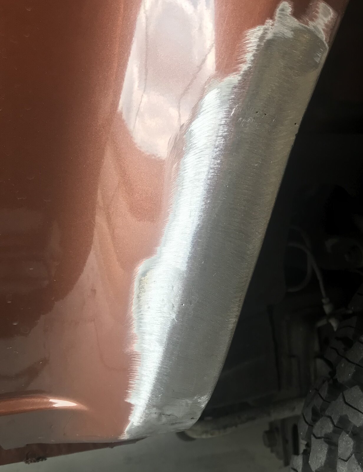

  22. Metal finishing this one now.
    Use patterns for the shape. Break the steps down into manageable parts.
    This qtr bottom was 2 pieces. The lower lip was made in a shrinker/stretcher to make the contour. The side of the panel was made by hand using a profile pattern and overall shape pattern.
    The curved radius (bottom of the side panel) was made by hand.
    Still have a little bit of metal finishing.
    There are a couple “stud gun” impressions used to raise the area not accessible from behind and a little more hammer and dolly work left. The **** weld process speeds this up in my worthless opinion.
    FAKKY, fauj and AGELE55 like this.

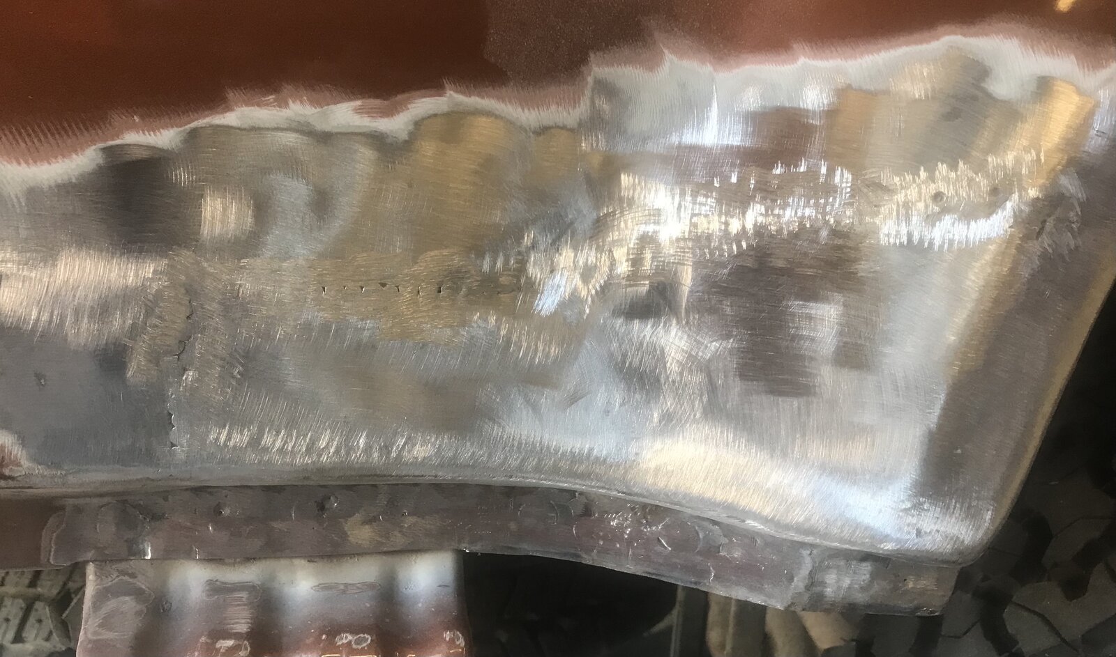

  27. FAKKY
    Joined: Sep 9, 2016
    Posts: 295
    FAKKY
    So I fell like this is someones fault :)
    In deep now ....
    Good news is Im **** welding everything on outside - especially now that I've moved over to MIG as welding outside and SO much easier ....
    I am doing a few lap welds on inside back quarter behind what will be shown. I did it as it was easier and IM interested to see how it holds - wont be seen and easy to fix if need.
    Anyway - tuips here on making sure the door looks good after I **** weld everything in ? Mean keeping it in line as kind of both sides have to be replaced and pinched together.
  28. tb33anda3rd
    Joined: Oct 8, 2010
    Posts: 17,595
    tb33anda3rd
    take your time, keep the panels aligned as you go. if it starts to get out of alignment, stop and tap it back
    FAKKY likes this.
  29. Squablow
    Joined: Apr 26, 2005
    Posts: 19,045
    Squablow
    Last time I did a door like that I made the inner section and fit it tightly before I removed any of the outer skin, the old skin was **** but there was enough left to know where it had to line up, then I made the outer skin to fit onto the inner structure. Also, if those are holes on the left side of the skin, you need to cut way more sheetmetal off. Use a straightedge to get a really straight clean cut, the wavier the cut line is the more likely it'll be tough to match up your patch and big gaps are harder to keep from warping.
    Atwater Mike and FAKKY like this.
  30. Squablow
    Posts: 19,045
    Squablow
    Also, lots of cooldown time in between tack welds. The worst thing you can do is build up a lot of heat.
