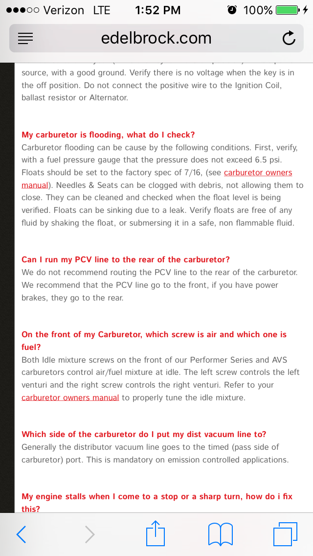

  4. You can do what you want and listen to who you want and ask who you want.
    Edelbrock doesn't recommend it.
