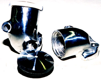

    So.. been buzzing around in my coupe now for 5 years or so... mechanically. it runs perfect..... but little issues always arise.
    I've never owed a Supercharged engine before.. but What i have seems to run very very well.
    (Watch,... now i have jinxed it!)
    So, one issue I have had was after a long run,.... Oil would be splashing... or actually misting and leaving a mess on the upper ridge of the VC's.... not a big deal... just messy.On short runs... it really would not have(or I just could see it) but after a 5-8 hour day of driving on the local hi ways,... when I got home..I was wiping Dino Juice.
    It just started to bother me.
    The coupe never had a PCV system... not a big deal.. but I just could not bring myself to drilling into pristine Dodge VC's with a big ugly Valve sticking out.
    Also... the previous way of filling the engine with oil was a major PIA..... was using the oil tube in the valley Pan.. with a rubber bolt in the centre plug.Very difficult to get at due to the blower set up.
    It needed to change.
    The old trick was to use a set of Water fills like that on top fuel cars.This has been done countless times in the past on many a Hemi powered car.
    So I thought about a PCV SYSTEM....
    So I had a set of Donovan Water Fills from my ill fated Drag Roadster Project.... I found a tight 90 degree PCV Breather at the local parts store and a grommet that fit snugly into the Water Fill.
    Running a 3/8 fuel line from the rear second carburetor .... a br*** fitting , I ran it under the blower manifold and out to the drivers side under the alternator bracket.I always use fuel injection clamps.... better than those ****py Chinese band clamps.
    MAKING THE WATER FILL WORK---
    my big concern was the bolts I was going to use.... that the head would interfere with the rocker ***embly inside the VC.
    It sure did.... so I ran down to my local machine shop and he turned the heads down"About" 1/8 or 1/16th... not quite sure... but it cleared the rocker ***embly just fine...
    I wanted no pieces touching or getting any wear on the ***embly..... vintage engines ain't cheap.
    I think the hardest and longest part of the process was staring,measuring,staring, measuring,measuring and balancing the Waterfalls to the right angle and height.
    Of course.. taking a set of perfect valve covers and drilling holes into them made me think...... along time.
    You have one shot...don't miss.
    I peppered holes on the oil fill side after use the gasket as a template(ya gotta make your own gaskets)
    I made one small breather hole(1/4inch)? on the breathe side.
    I test fit again and everything worked out well.....
    Got out my"Right Stuff" RTV goop and put it all back together.
    I waited 24 hours to make sure everything set up properly and torques the VC'S to factory specs.
    All seems to work well,.. no oil misting, all clean and functioning.
    I don't have a ton of pics.. but you will get the idea..... I believe this could work well for many types of engines... just got to get creative.
    So there is my ****py 1 day tech....
    Like I mentioned.. been done a million times before, but this was my situation.
    Now my little Hemi Dodge...**** and blows at the same time..... like my ex wife
    ha ha

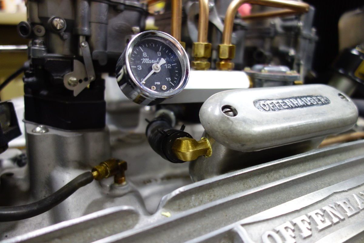

    Rear carb shot,the fasteners and breathers I use...Offy Juniors.... IMG_3332.jpg
  4. I plan on doing similar at the back of GM script valve covers.
    thanks
    Jeff Norwell likes this.
  5. Jeff Norwell
    Joined: Aug 20, 2003
    Posts: 15,278
    Jeff Norwell
    MODERATOR
    I should mention I used ****on head bolts.... You need to find the latest head possible..Elevator bolts would have been perfect.. but making a square seat would been.. impossible at this stage

    As an observation, a correct PCV system should include “all” of the air in your engine entering the valve in the water elbow. As I see from your photos I’m guessing most is coming from the closest rocker cover breather. The 2 on the same side as the PCvalve should be sealed and the one on the opposite side closest also. Just an opinion on how the systems were designed to work. What you have looks great and I have 2 of those water fills also.
  11. Jeff Norwell
    Posts: 15,278
    Jeff Norwell
    MODERATOR
    jimmy six..I completely agree with you...and if I had the room at the firewall,.. I would have installed the waterfalls on each end of the VC's..... but.. ya gotta work with what you have.

    I think you might have missed what Jimmy 6 was telling you,, you need to block the little breathers so your PVC doesn't just grab outside air and circulate it to the carb, but instead you need to removed crank case pressure from the lower end to stop the 'oil spray' in the upper end,,
  14. Blues4U
    Joined: Oct 1, 2015
    Posts: 8,068
    Blues4U
    from So Cal
    Just seal up the 2 breathers on the side with the PCV, and the front breather on the other side, so just the rear breather on the opposite side is open to atmosphere. That will have the PCV draw fresh air IN through the back of the opposite valve cover, down through the crankcase and back up to the PCV and out to the intake, fully venting the engine.
  15. Jeff Norwell
    Posts: 15,278
    Jeff Norwell
    MODERATOR
    Got it. thanks guys.
