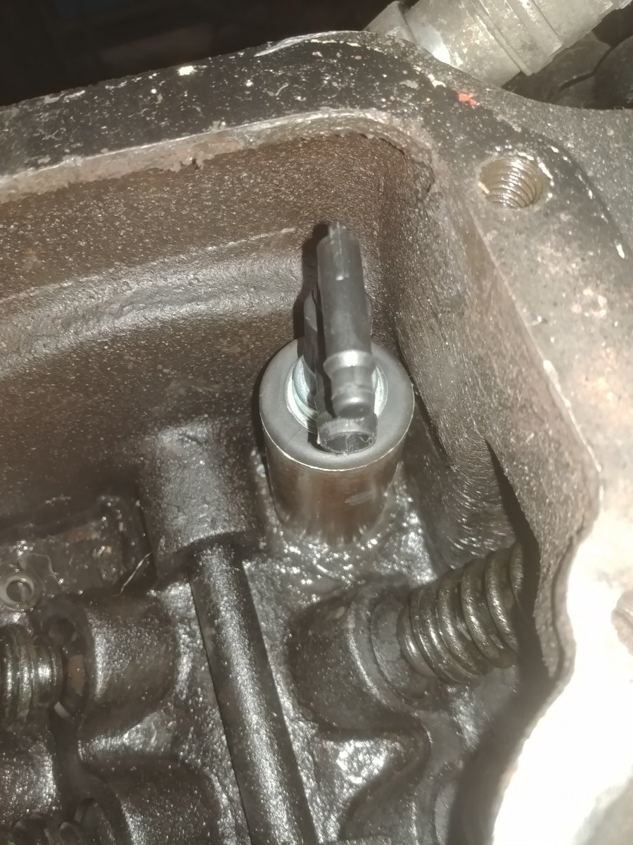

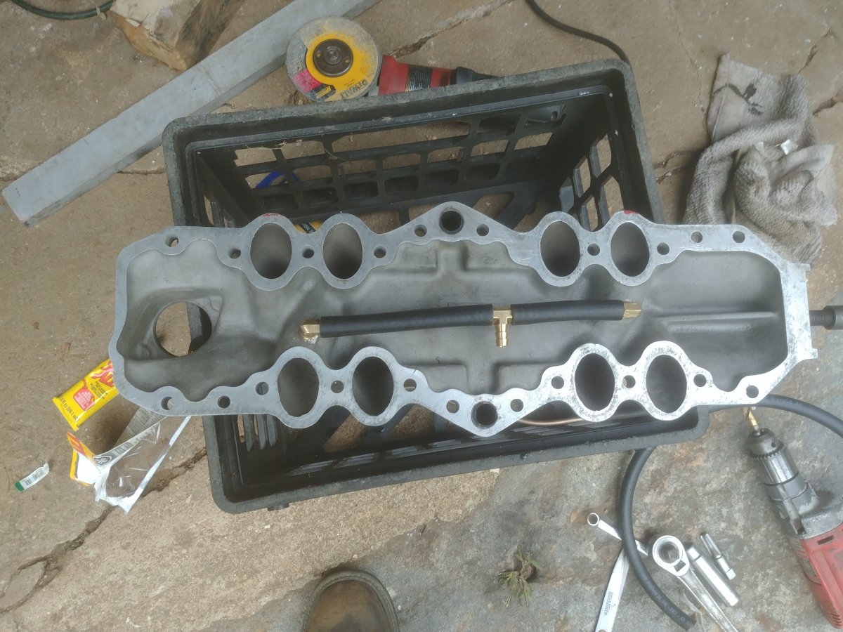

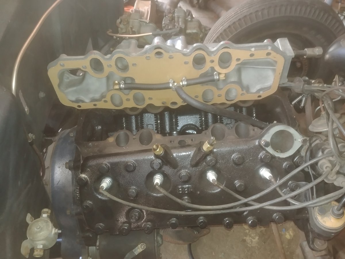

  2. adam401
    Joined: Dec 27, 2007
    Posts: 3,011
    adam401
    I’ve run 2 different early intakes on 8ba engines with pcv valves. One was a edelbrock slingshot and one was a 2x2 offy. First one I did I put a port in 2 runners from below one under each carb and ran it Into a pcv valve fit into where the road draft tube would have in the valley. So it was all under the intake. I learned it wasn’t necessary 2 run 2 ports under the manifold and switched to just one. Worked the same.
    So my point I guess is even though you don’t want to drill the manifold, you could. I’d drill and tap one hole in the bottom and run a hose to a pcv valve below. Clean and easy. You can always plug it if need be.
    I did post a thread on doing this on here a while back.
  3. adam401
    Posts: 3,011
    adam401

  6. len_m
    Joined: Jul 6, 2005
    Posts: 392
    len_m
    from wpg,can
    I don't have a picture of the bottom of intake handy, as i am not home, but the bottom basically looks like the topside of the main plate pictured above. Just a solid chunk of aluminum with vertical ports. There is no runner detail exposed like adam401's pictures. There's basically nowhere to drill into underneath and get into the runner. One thing i thought of was drilling and tapping a hole into each intake port on the block and then connecting with a hose, which would require zero holes in intake.

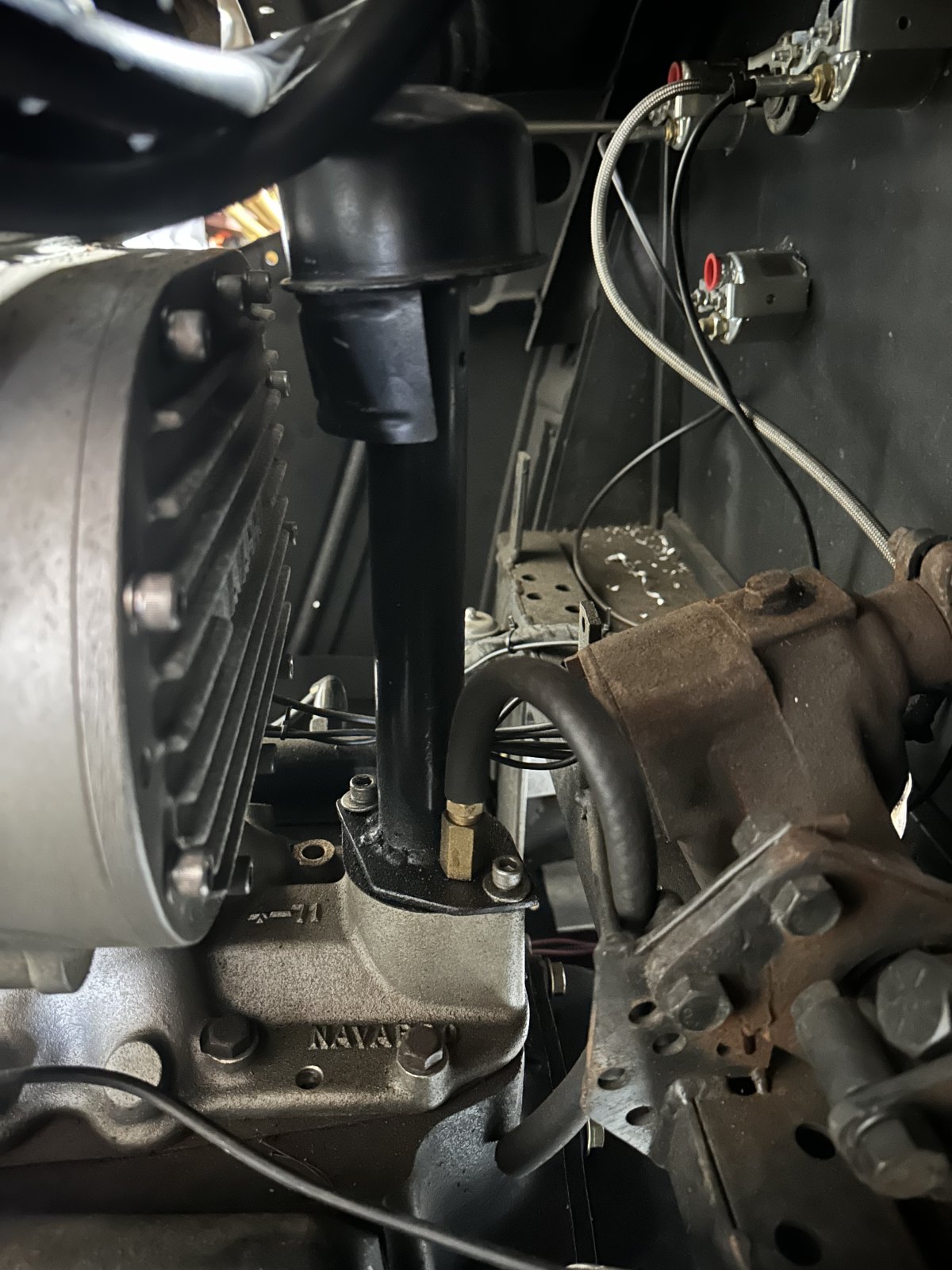

  10. adam401
    Posts: 3,011
    adam401
    I’m experimenting with a setup on my current 8ba right now. Instead of a pcv or roaddraft tube, I ran a line from a sealed fitting where the road draft tube should connect and ran it out parallel with the rear oil fill. Basically just relocated the road draft tube. This car doesn’t run a mechanical fuel pump. So far I think it’s working fine. It’s not a street car so my experience with the setup it 1/8th mile intervals but so far so good. You could certainly fab something more elegant than my setup. Zero drilling the manifold required.

  12. adam401
    Posts: 3,011
    adam401
    The fumes do not re-enter the crankcase. There is a fitting pressed into the opening where the road draft tube should be pressed in the valley below the intake. From that fitting a line runs through the valley and p***es through the rear of the manifold out of the engine. I didn’t explain that well at first.

  14. adam401
    Posts: 3,011
    adam401
    It’s no different from a road draft tube. It’s a road draft tube. When you run an intake designed for an earlier engine on a 49 an later engine there is no provision for a road draft tube in the intake. Some intakes can be drilled for the later road draft tube. Some intakes there isn’t a great spot for that up front or it’s not asthetically desirable to do so. In my particular case there’s a lot of **** in the way up front and the manifold isn’t ideal to drill for the standard road draft tube.

    adam401
    I think a picture with the intake off would clear up a lot of confusion but I don’t have one unfortunately. The hose is connected the same way a stock roaddraft tube is and in the same location internally. it just exits from a different spot. The same paths in and out exist as stock. But no matter. Just spit balling ideas haha

  17. ronnieroadster
    Joined: Sep 9, 2004
    Posts: 1,192
    ronnieroadster
    Unfortunately with the design of your intake {a copy of the original Alexander} you now have two four cylinder engine's without some type of cross over between the intake runners. To add to the problem every intake port needs to be connected together for the vacuum needed the operate the PCV correctly. The flat plate design on your intake makes this all port pulling vacuum impossible to connect to for what's needed.
    The only way it would work would require a hose connected below each carb {location of needed vacuum signal} each hose can then be connected to a fitting in the flat base which would now connect under the plate to the hidden PCV located in the road draft hole in the valley of the block. Obviously that would make it rather ugly. But maybe taking the time to use say copper tubing for the connections in place of hose it would look a lot better and work well also.
