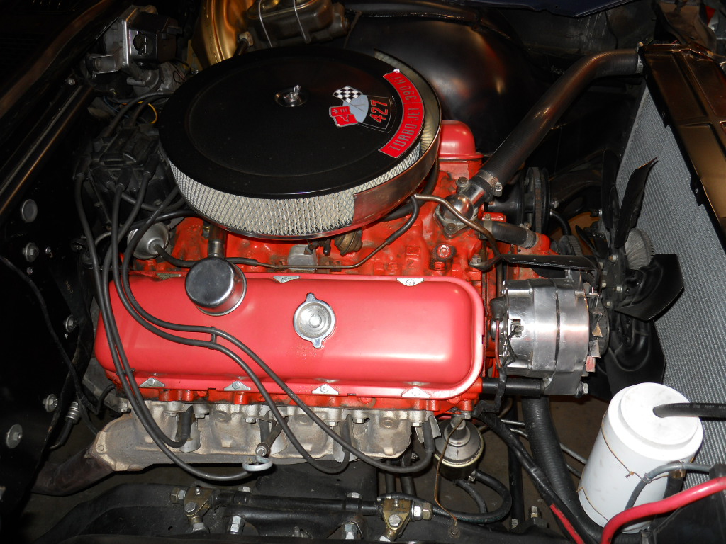

    I like the stock valve covers. The big block Chevy has nice big covers with a decent P.V.C. system.. The 427 came with factory painted covers. It gave the engine an all business look which I like..
