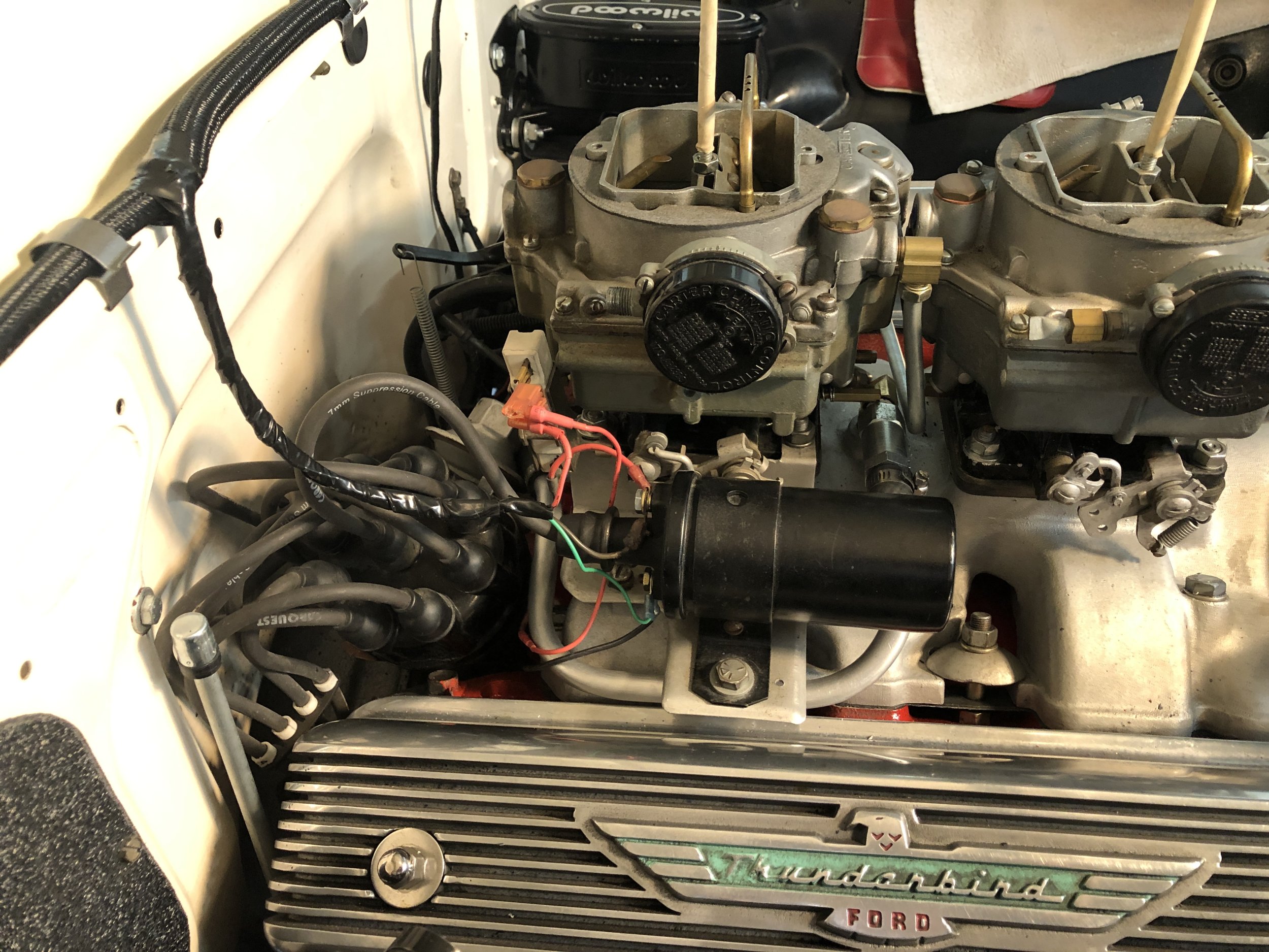

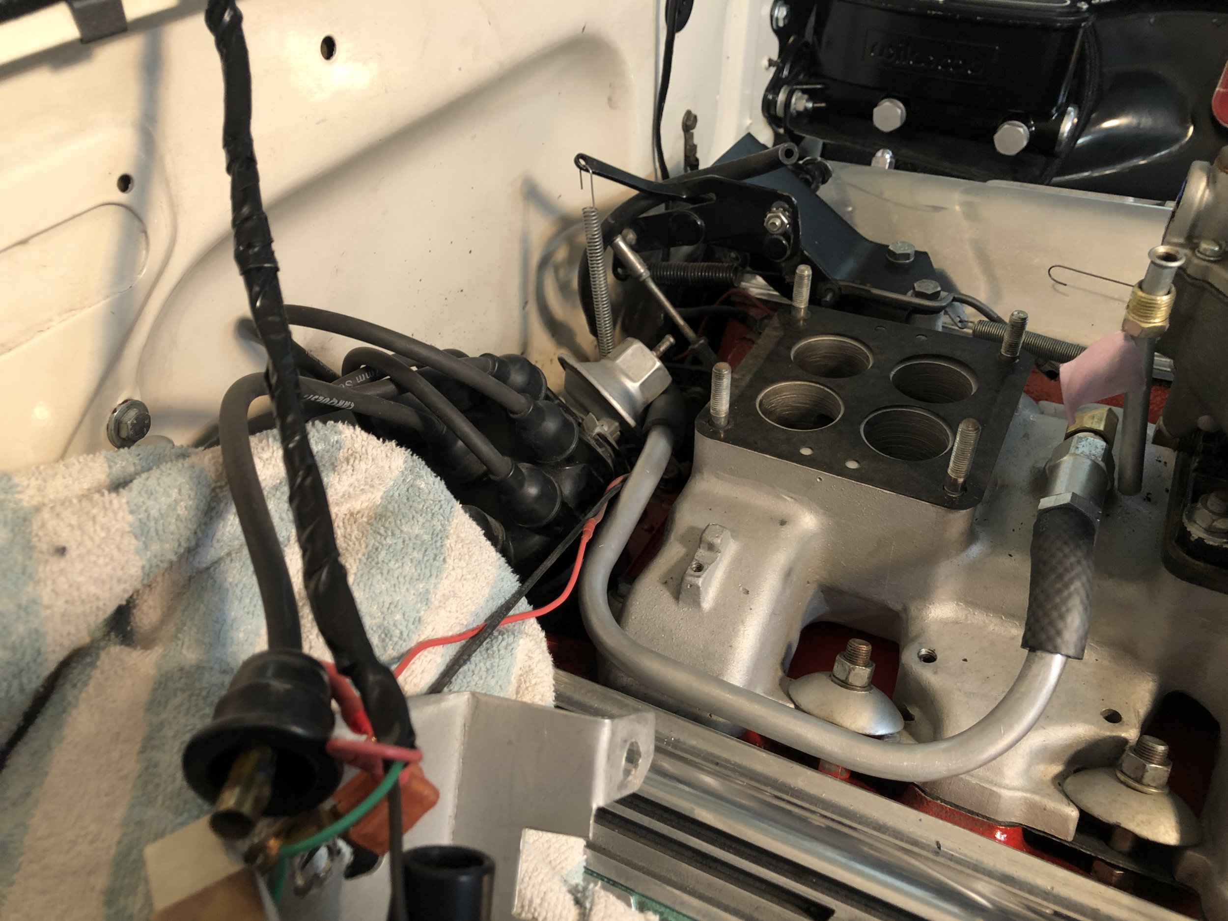

    Even tho mine is on a dual quad intake the 90* fitting is directly tapped into the intake between the carbs none run lean.
    In the early years there were 1/2” plates added under the carbs with the fitting on the rear AND all the GM fittings at the rear of the factory 4 barrel carbs and p***ages to the rear barrels only and I have never heard of rear cylinder running lean. Actually all the blowby PCV air is shared even in a dual plane manifold because of these p***ages at the rear of 4 barrels. IMG_3656.jpeg IMG_3652.jpeg
