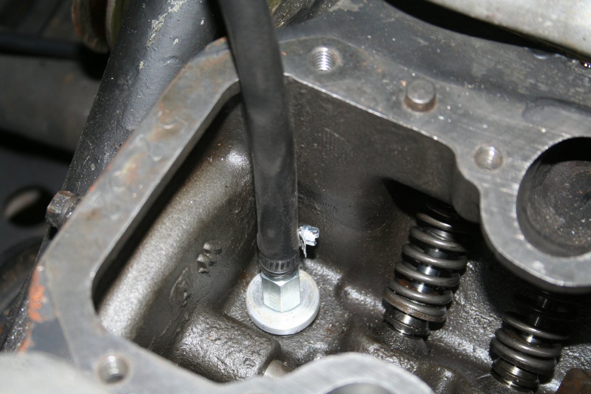

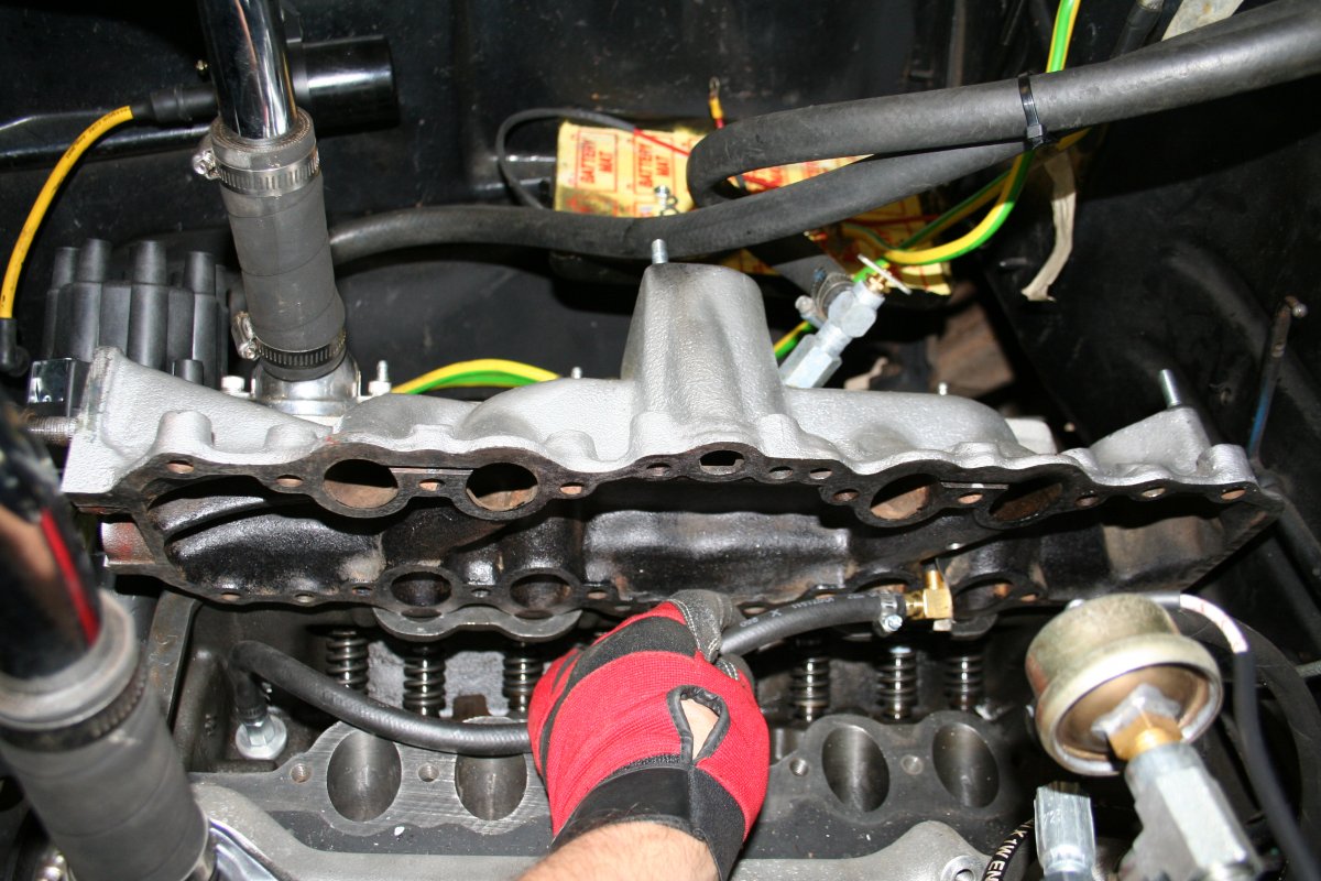

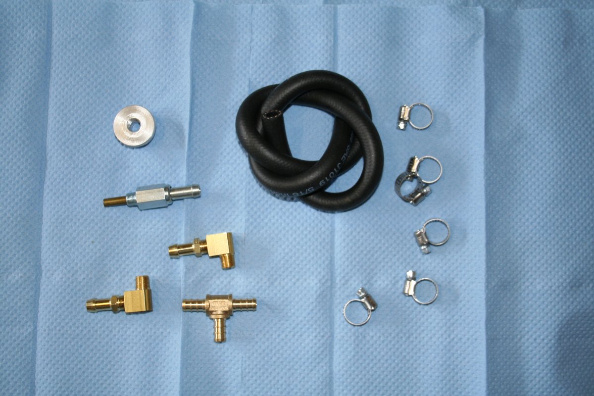

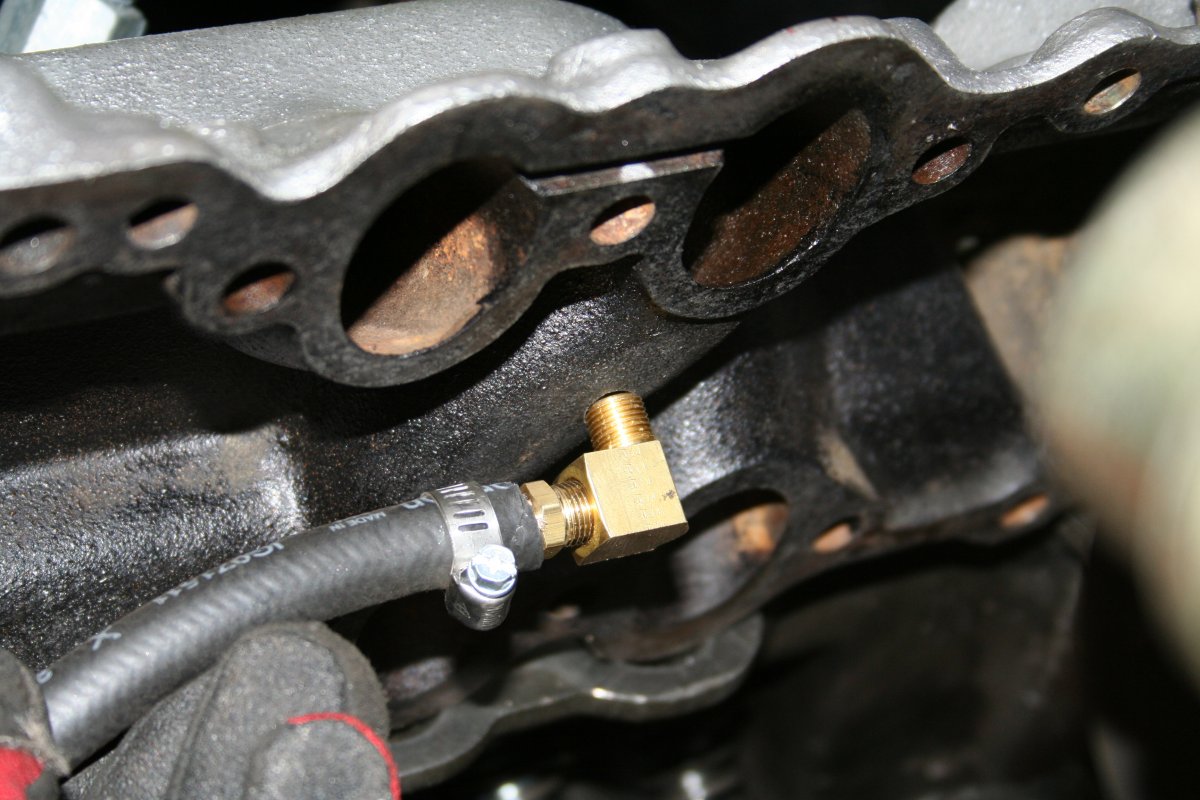

    I had installed the PCV in my 239 french flathead with 59AB intake in the valley
