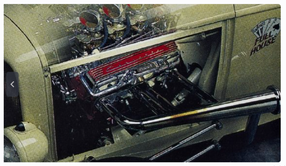

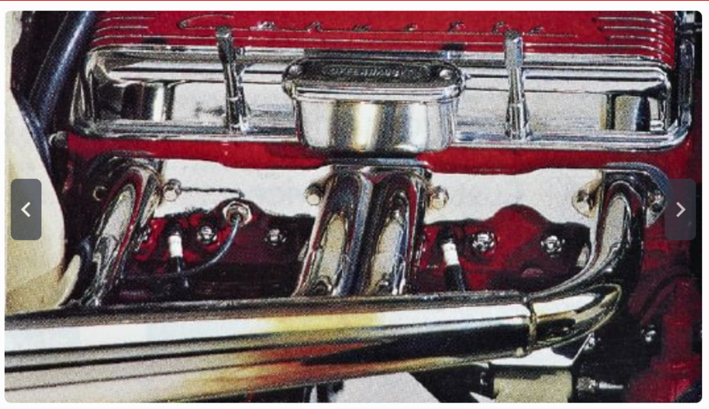

    The valve covers are the original chromed and painted ones off Jim Inglese "Full House" deuce. This car was just off the chain and I really hate to whack up a piece of hot rod history. When they were on the Full House Jim used some big Offy breathers cut into the lower sides of the covers. I believe from some folks I've talked to about this he had issues with oil out the breathers. This may well be a false or true, who knows. I haven't spoken to Jim in many years. It doesn't look like I will be able to fill oil through the Offy breathers although they are still available through Jegs and Summit. I think the Full House used a breather tube in the intake in addition to the side breathers.

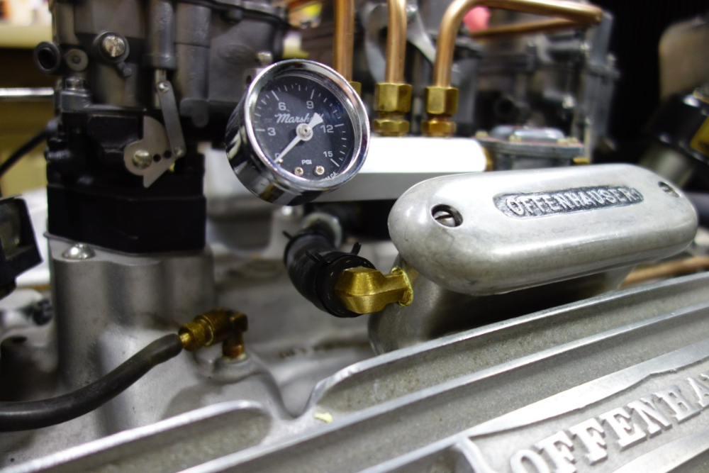

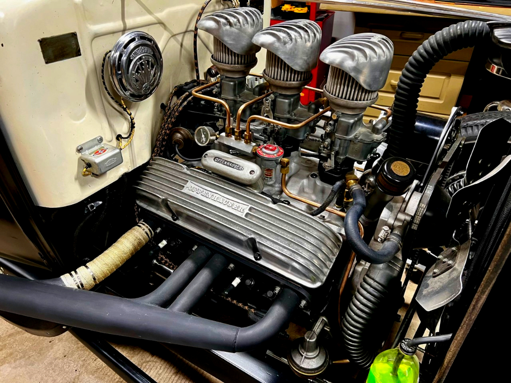

    Being that it originally had the 90 degree Offy breathers.....you could add them back and do this:
    Koz likes this.
