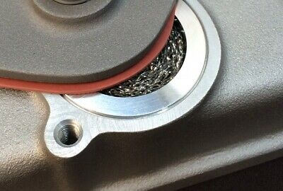

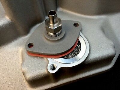

    They make a kit that goes in that hole that has like aluminum strips in it, and a place for a PCV then you just hook it into a vacuum source. Not sure who makes it. Might be able to find out tomorrow. I think it may be Carl’s Ford Parts?

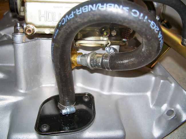

    Used a Basket... can be bought for about 50 bucks...Blue thunder,Tony D.,....
    I too wanted a clean look on my trip-power set up.

    Winner winner chicken dinner , that was my answer also, Jeff
