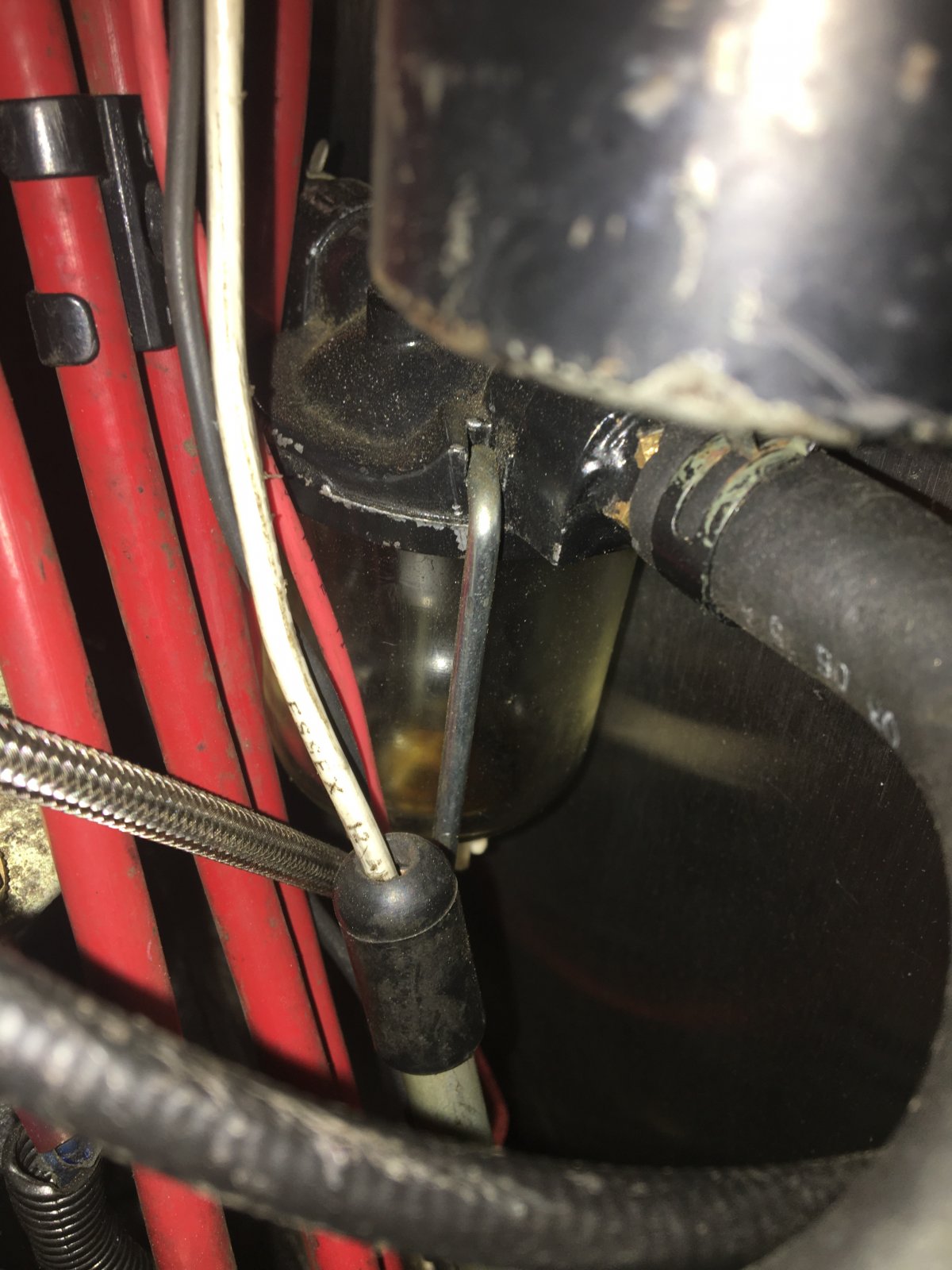

    Here a photo of intake vent holding paper on my running engine. You can see the hose from the oil filler. My rockers don’t have any holes. E24BFA5E-CAC7-41BF-96CD-0650179EFD96.jpeg

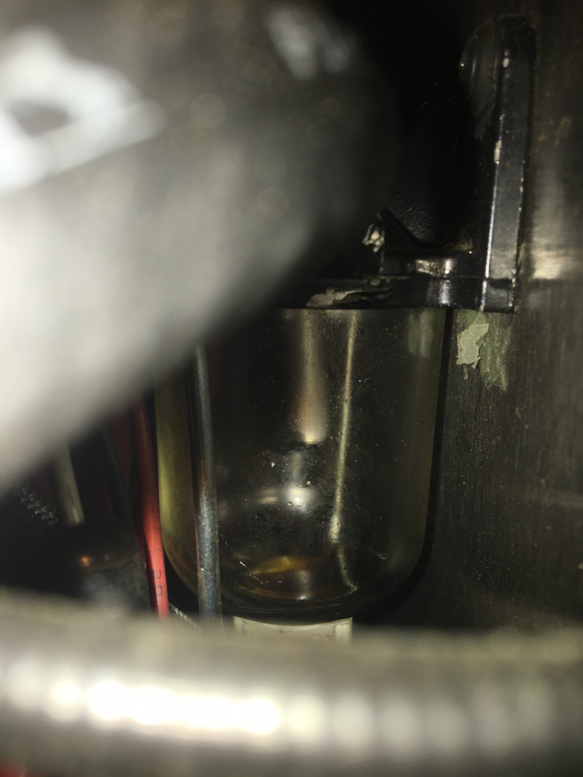

  12. I have an early sbc intake that I retrofitted a pcv. Created a simple sheet metal baffle below the pcv and it draws no oil. Easy enough to fab with intake off, why chance it.

    Thanks for taking time to reply, and include photos.
