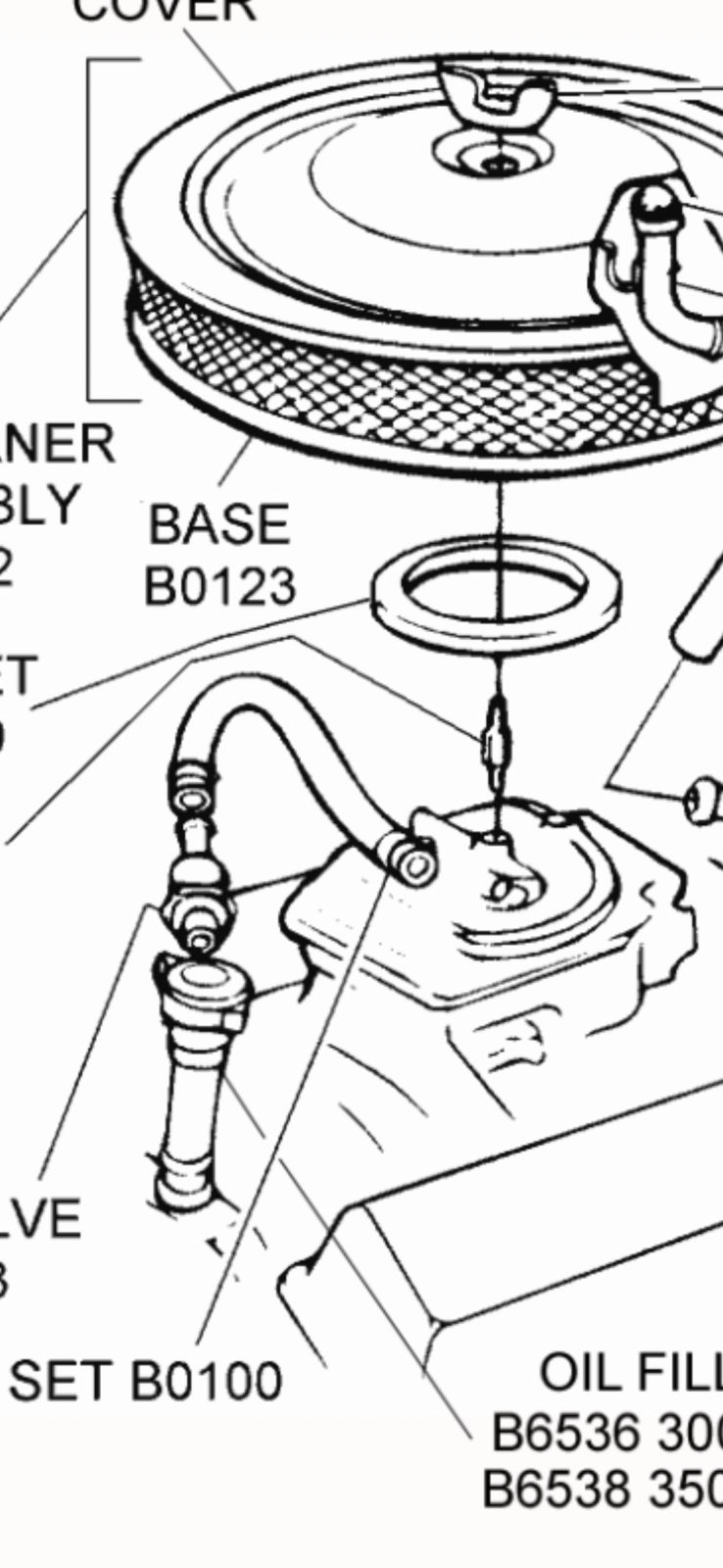

    Vertical and Horizontal use is not the same
    The original GM p/n was 6422294 (item 5) ; this diagram is for a 283
    NAPA CRB29255 is a replacement. It is a horizontal mounted PCV valve.
    It is what I used on the 331 Hemi
    It has a 1/4" NPT male thread and a 1/2" hose barb
    From what I have read elsewhere, an AC DELCO CV590c is also a replacement for the GM valve.

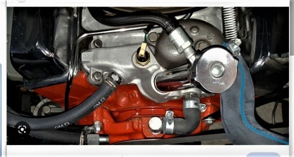

    I have used this setup on many of my sbc with no issues or rattles. This is the way the L79, 350hp motors
    came from the factory, as well as others.
  8. DDDenny
    Posts: 21,537
    1965 327/350 hp engines did not use a PC valve, it had a metered orifice on the carb.
    1966/67 L79's (325/350) hp engines used this style.

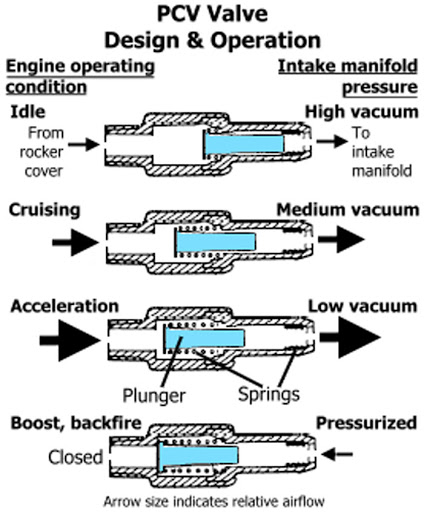

    Thanks for the information, I guess I don't really understand how they work inside, but I know what they do and why you use them.
  10. Bob Lowry
    Joined: Jan 19, 2020
    Posts: 1,587
    Bob Lowry
    Basically just a simple check valve to allow for one-way air movement only. If there was a backfire, it
    prevents damage to attached hoses and equipment.
