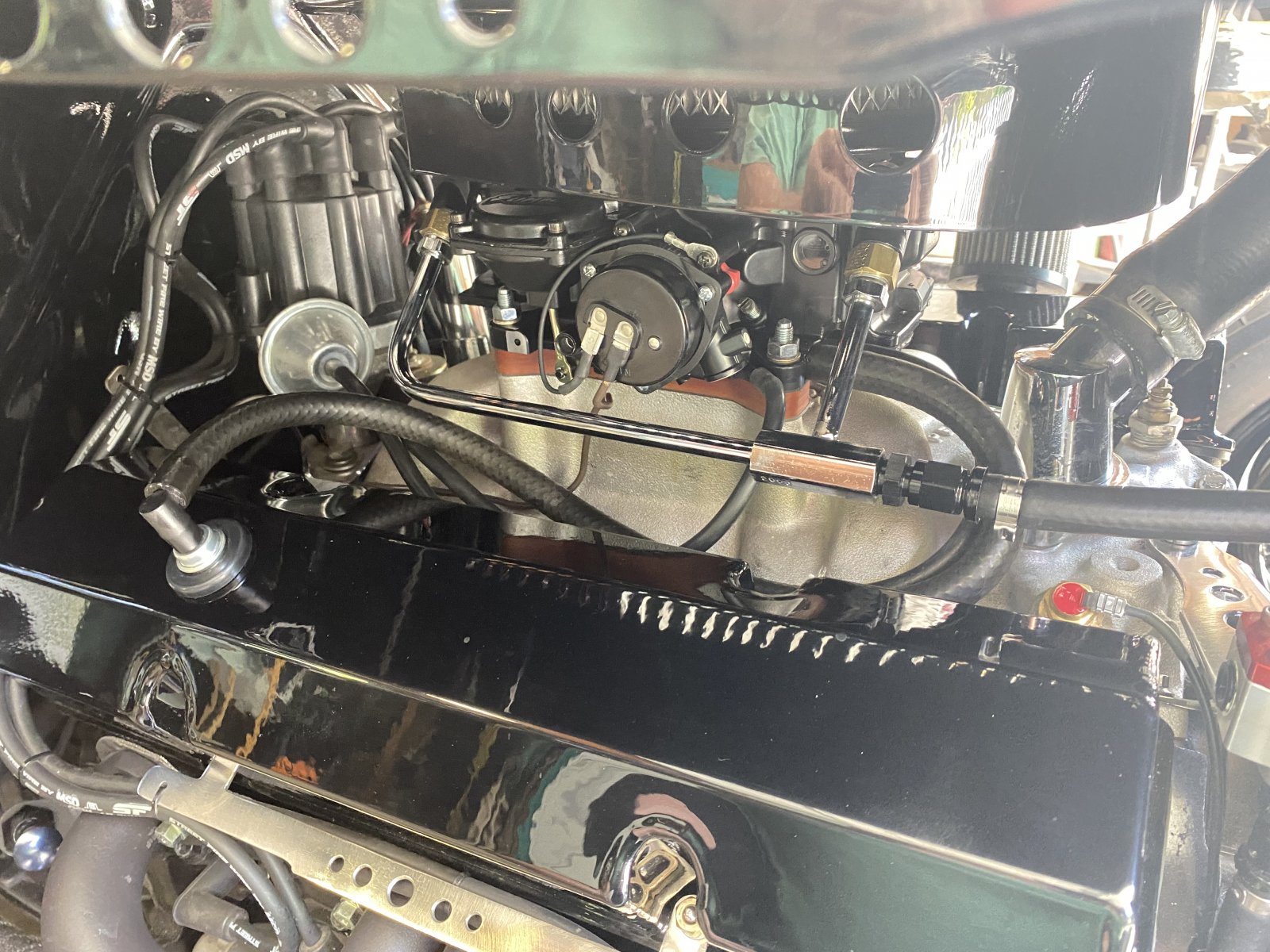

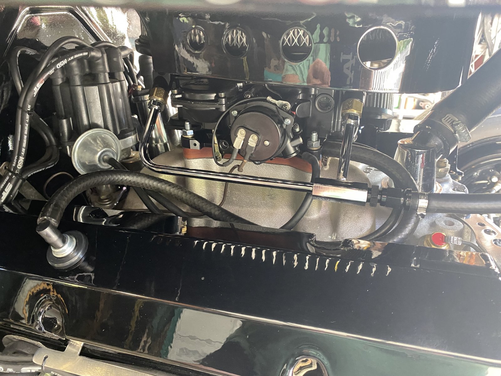

    How do I know the correct PCV valve for an engine....is there a chart for different vacuum ...my engine pulls about 15 psi on a vacuum gauge. I can hear the pcv valve rattling at idle and if I pull the pcv valve out of the valve cover and block the end of the valve with my thumb, the idle smooths out and drops a hundred or so rpm...this suggests to me the valve may be causing a vacuum leak...I think it may be the wrong valve, not sure....the number of (Fram) pcv valves that look identical but have different part nos. suggests the difference is internal, so how do I know which one to use......

    My PCV hose is connected to base of carb...can I plug this outlet and run hose to base of air cleaner...this would eliminate the vacuum leak?

    Please post some pictures of your setup.

  10. Ron Brown
    Joined: Jul 6, 2015
    Posts: 1,760
    Ron Brown
    545FDEB7-D23C-4426-8AFE-18C773C47FC4.jpeg 650AEFA9-3A7F-4BBF-915D-380D0BE95E84.jpeg

    Looking at your photo, make sure there is a splash deflector in the rocker cover or you have the grommet with one built in. Mr. Gasket sold them at one time.
    If a system is correct, the suction at the opposite rocker arm cover cap or breather should be 1” to 3” of vacuum. If it holds a piece of paper that’s a good check.

    I cannot ID that carburetor, but if the port you are using receives manifold vacuum, it should be fine.
    If it does not, the hose needs to be moved to a port that does.
    And yes, as has been mentioned, the PCV valve is a controlled vacuum leak. If your idle performance is not what you expect it to be with the PCV in place, you need to re-tune.
    Since it is a small amount of extra air that is not going through the carburetor at idle. That being the case, you might need to richen your idle mixture slightly to compensate.
