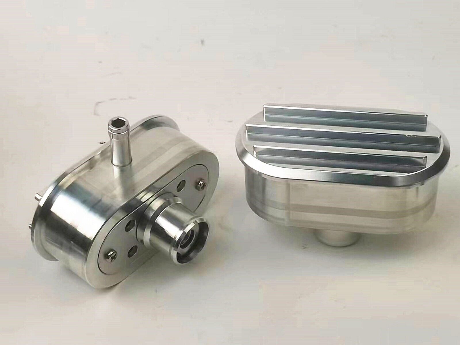

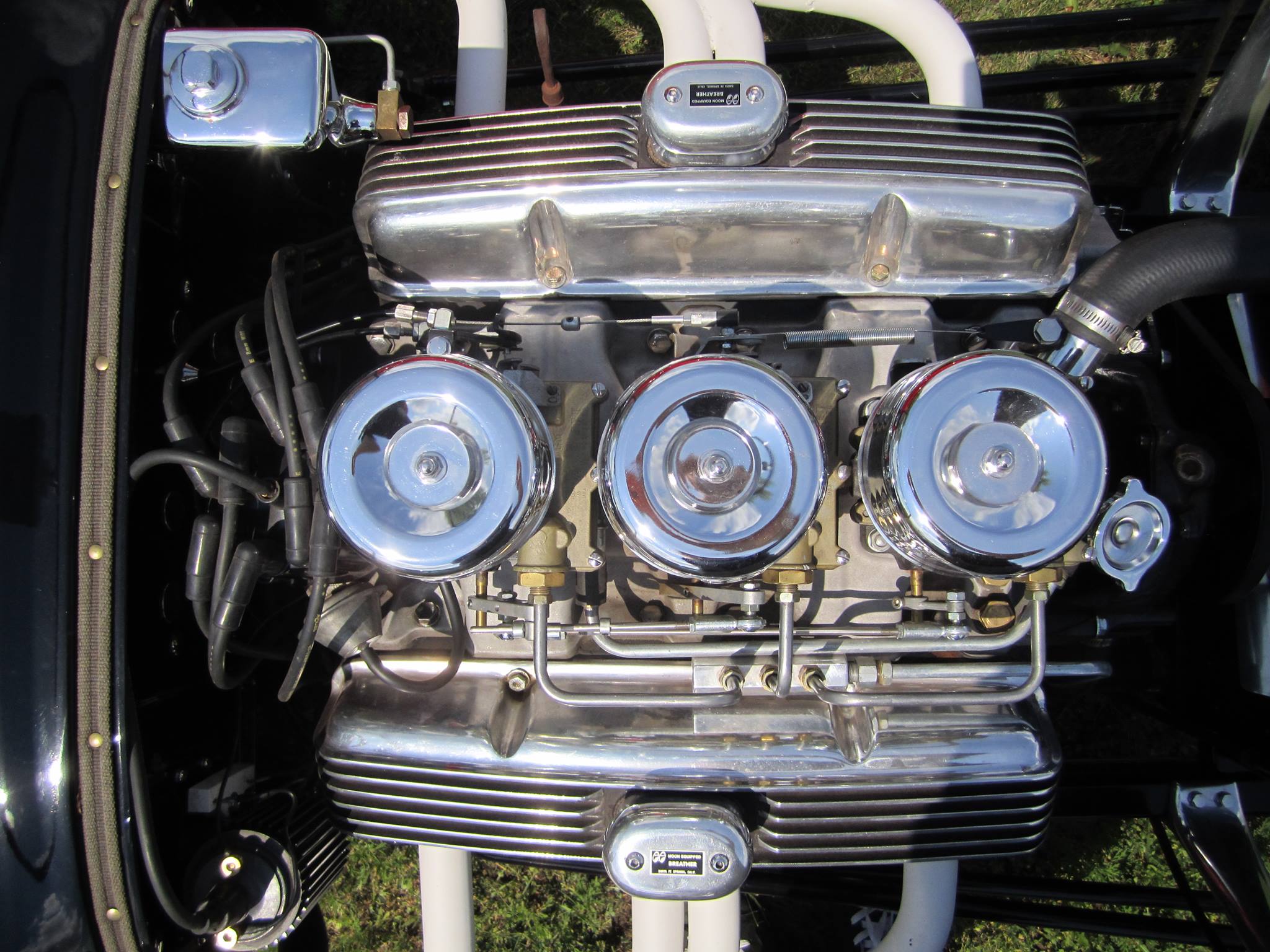

    FWIW, you can get finned aluminum breather/pcv combos. I used to run the finned Edelbrock valve covers and had a set on them that looked pretty decent. If you dig around enough, I'm sure you'll find a paid that matches your valve covers pretty close.
    lothiandon1940 likes this.

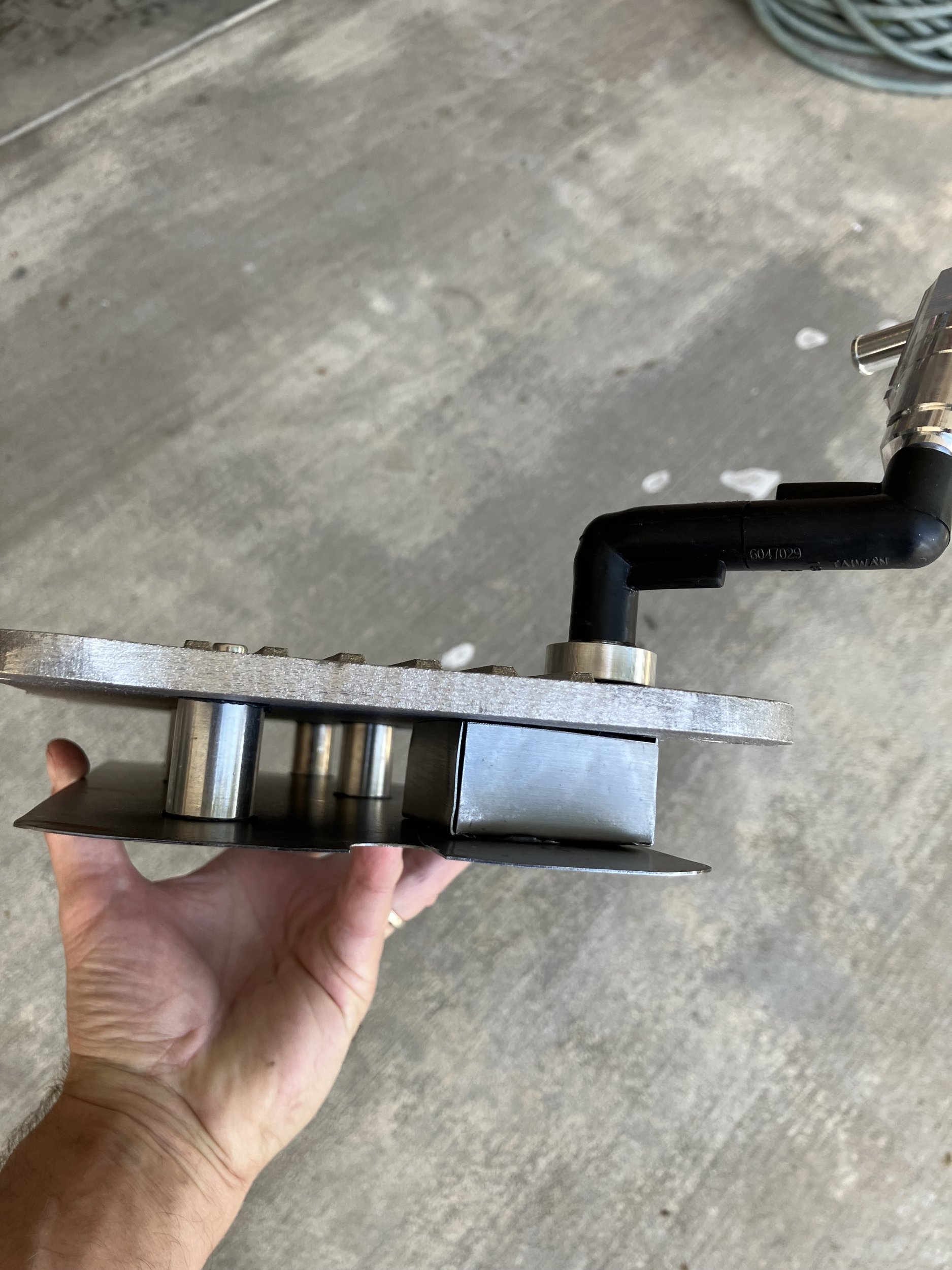

    Put the breathers on the valve covers, get a fill tube that takes a cap, and weld a bung for a line on the tube.
    I sliced into the tube at alternating angles a couple times, slid in some sheet metal to act as baffles, trimmed them flush, and welded them up.
    You can see the steel line running from the fill tube to the PCV valve on the back of the center carb.
    If your carb takes a hose, you could instead weld a pipe bung on the tube and use a matching Corvette PCV valve.

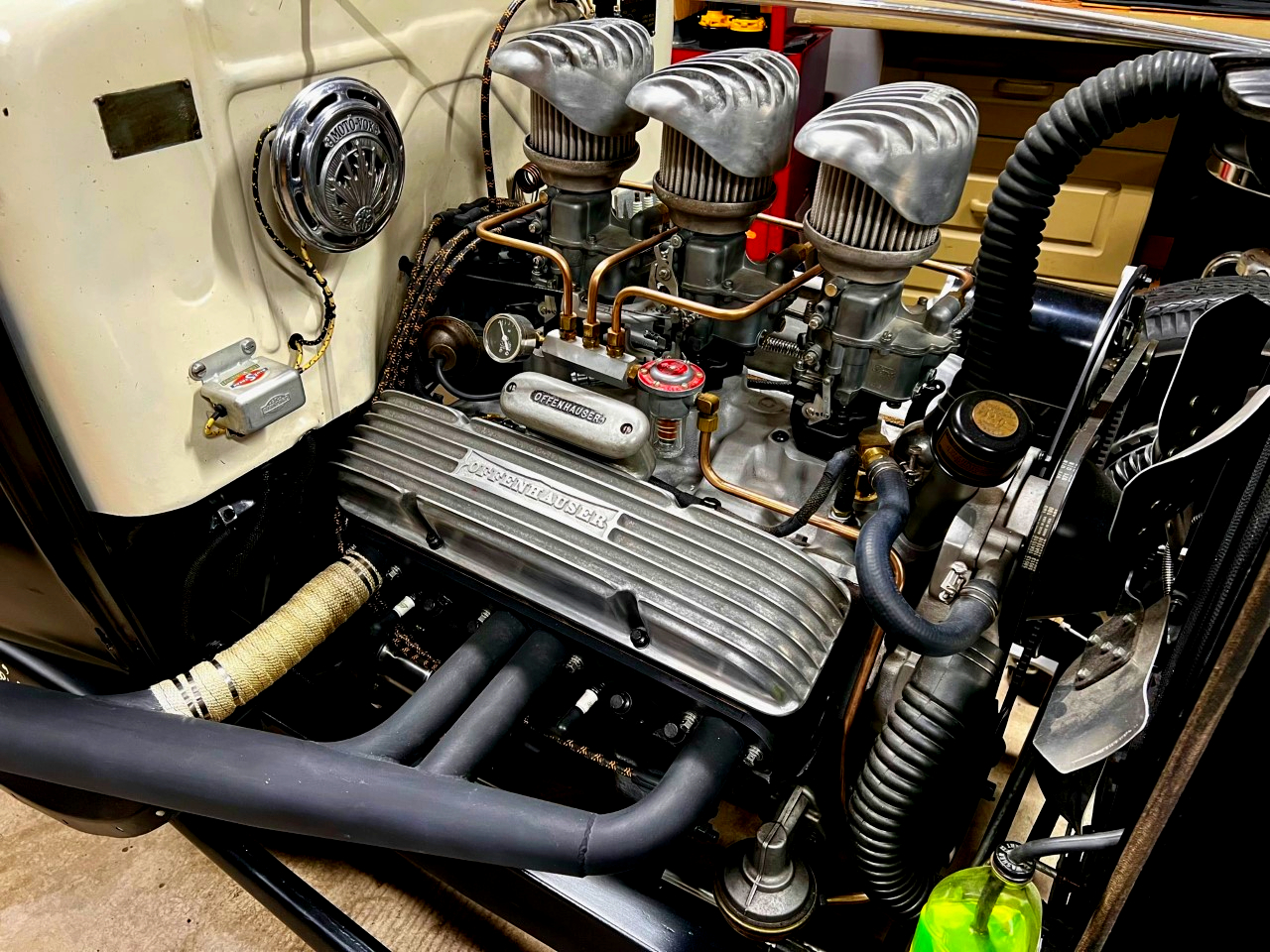

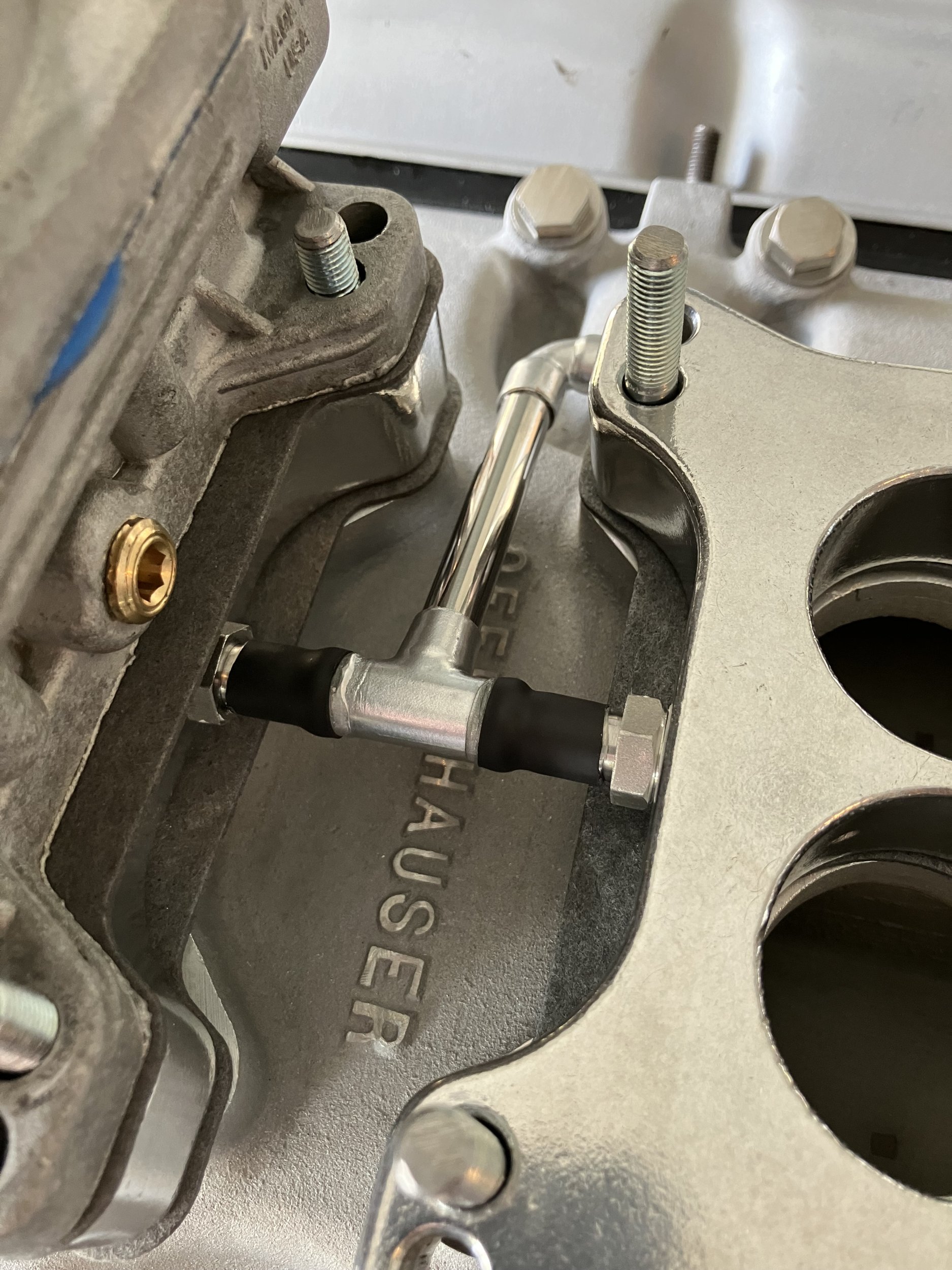

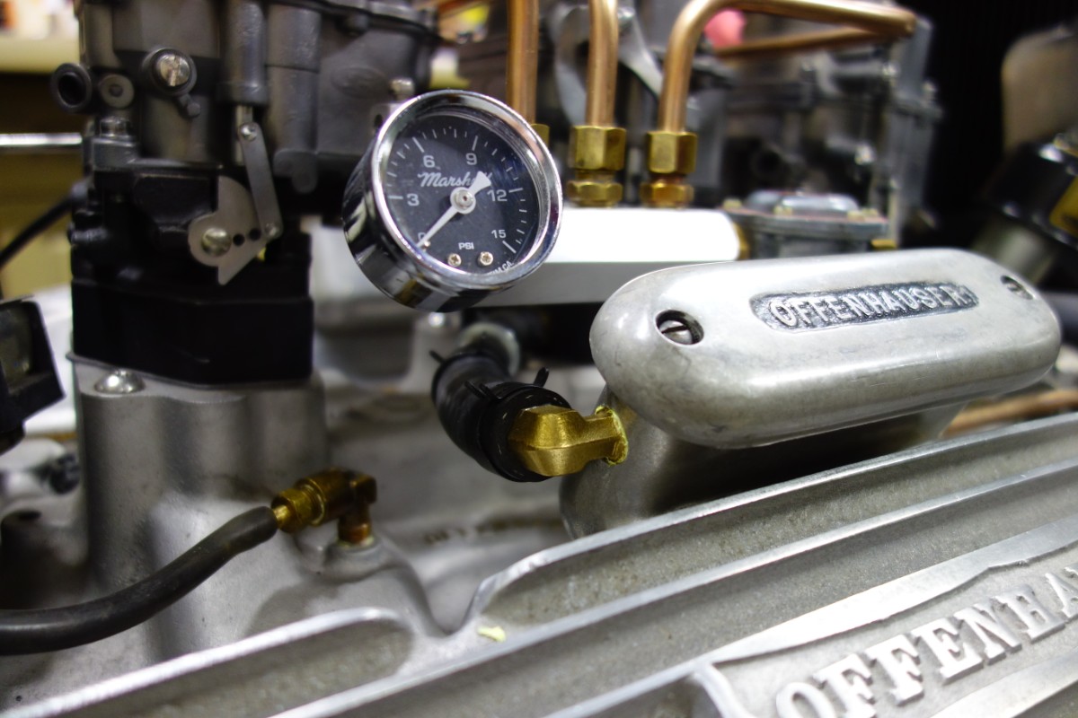

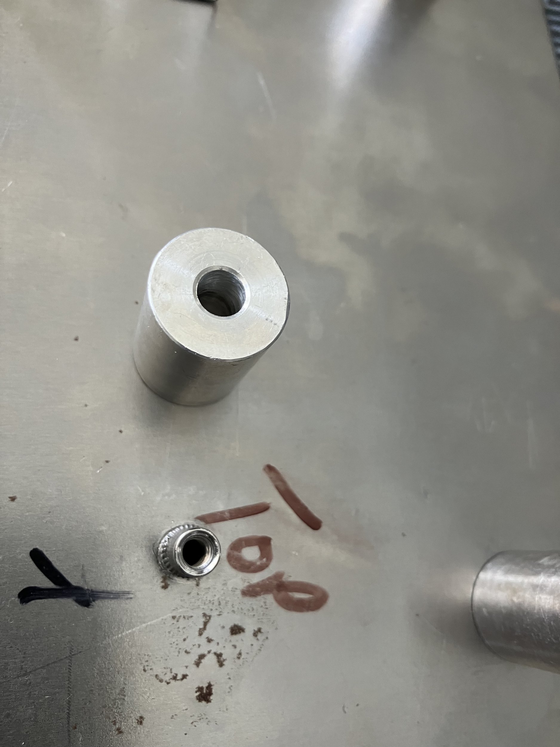

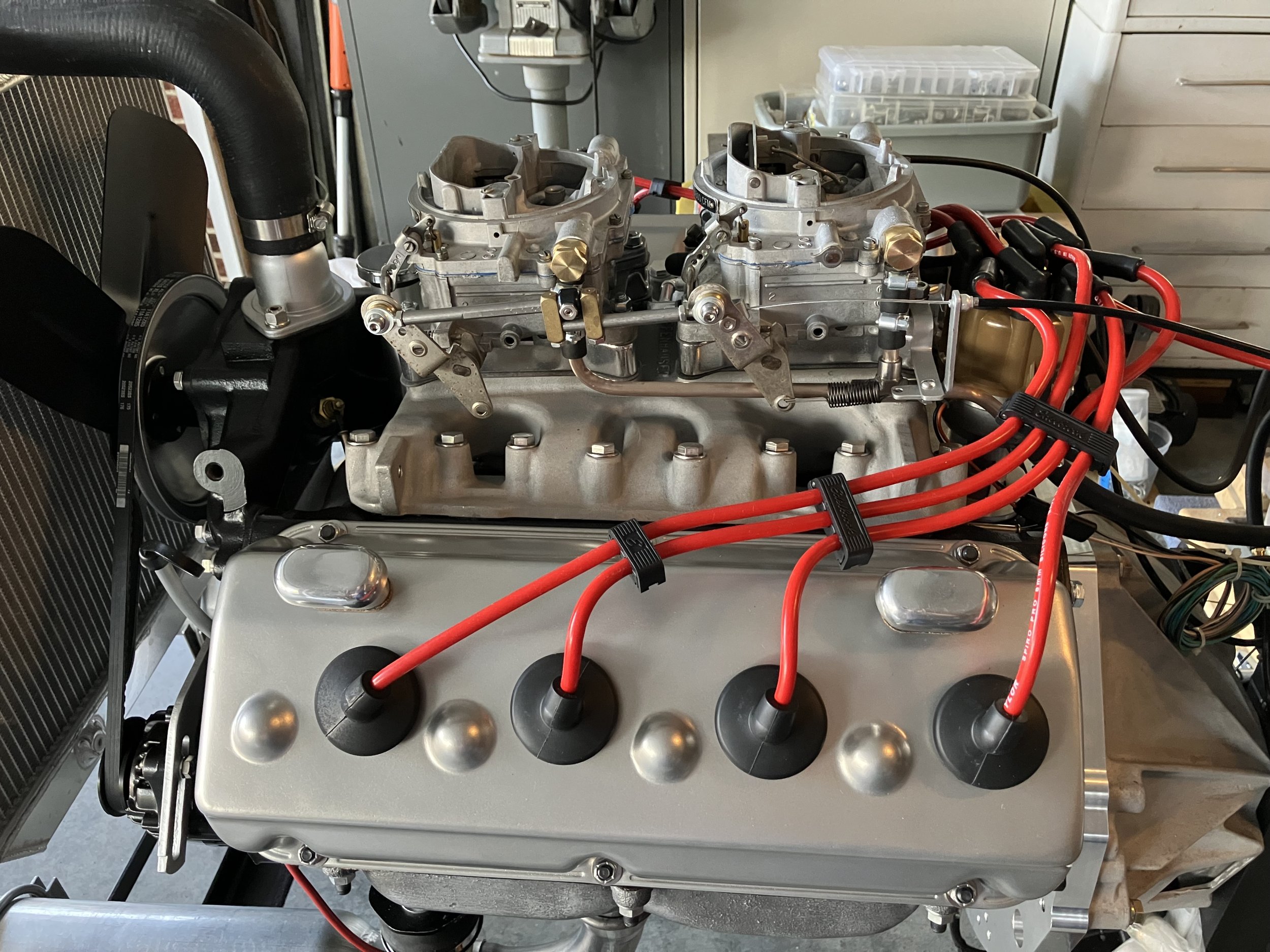

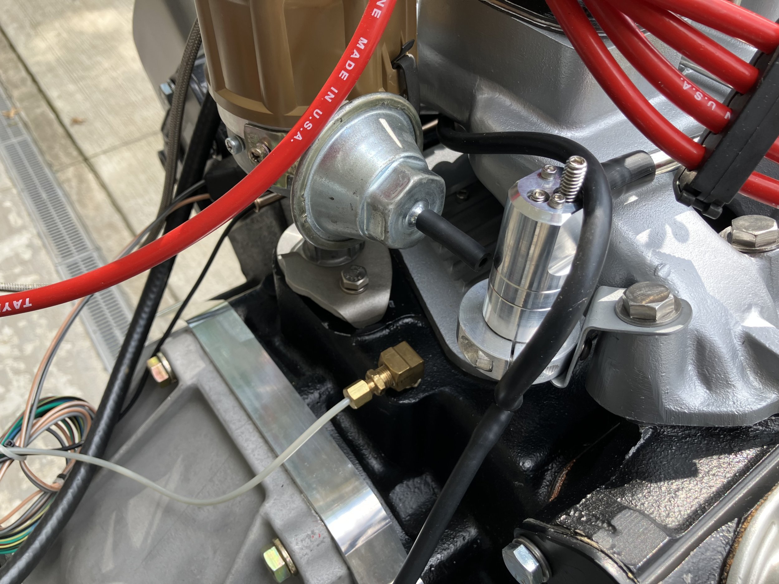

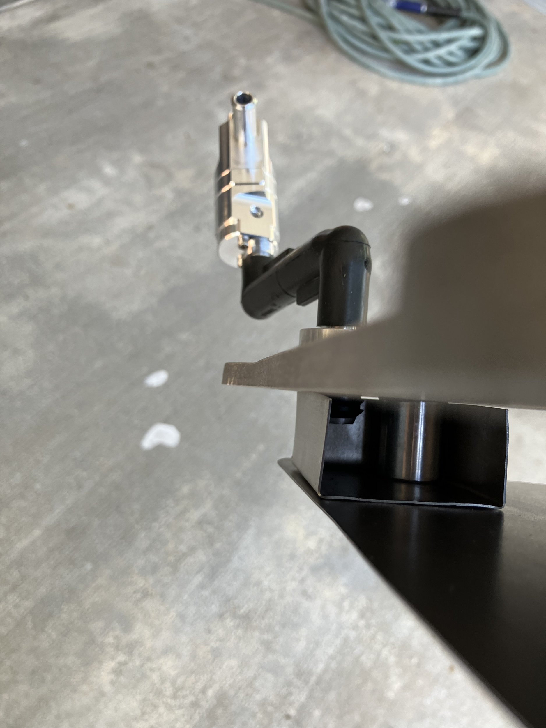

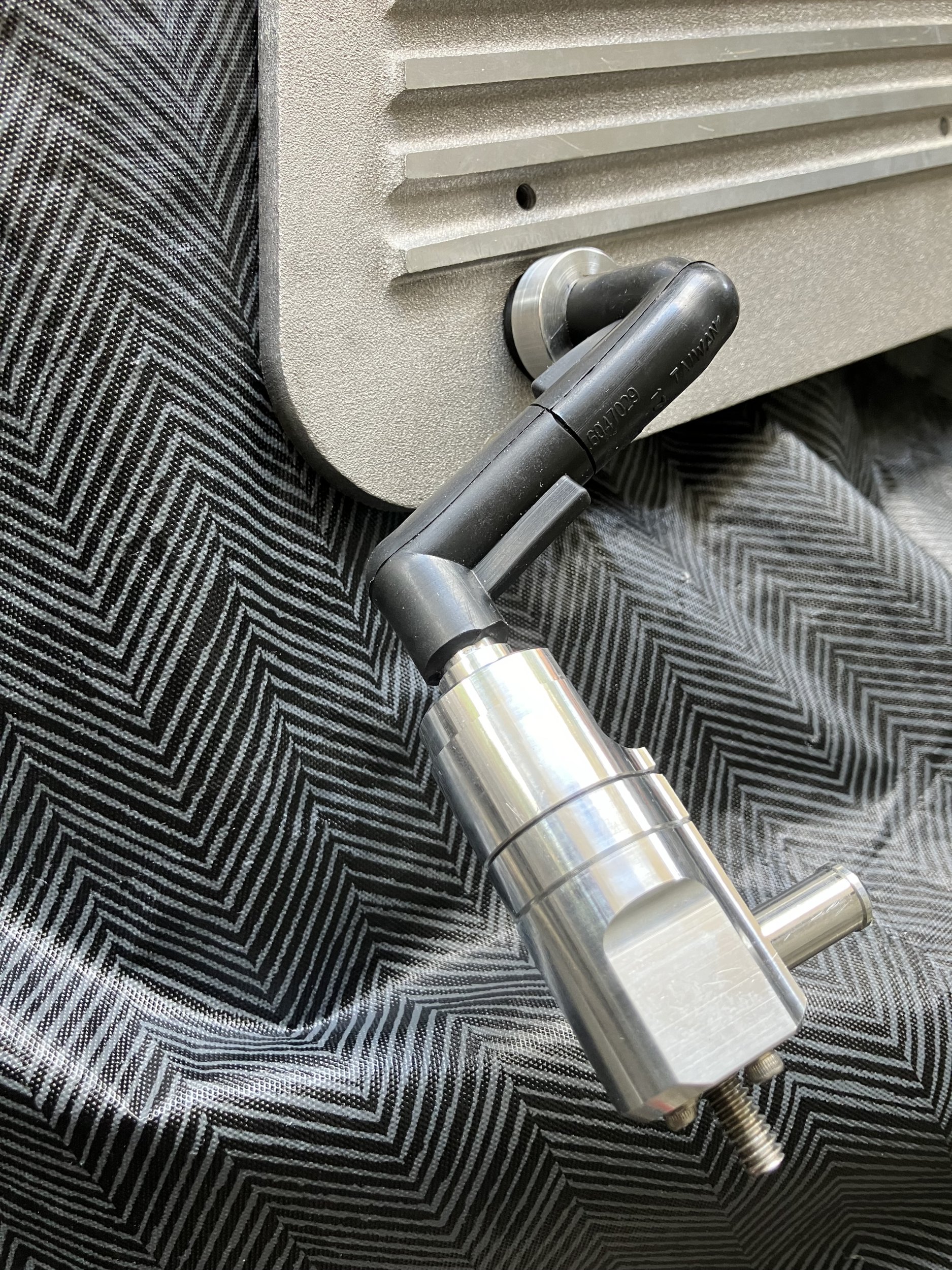

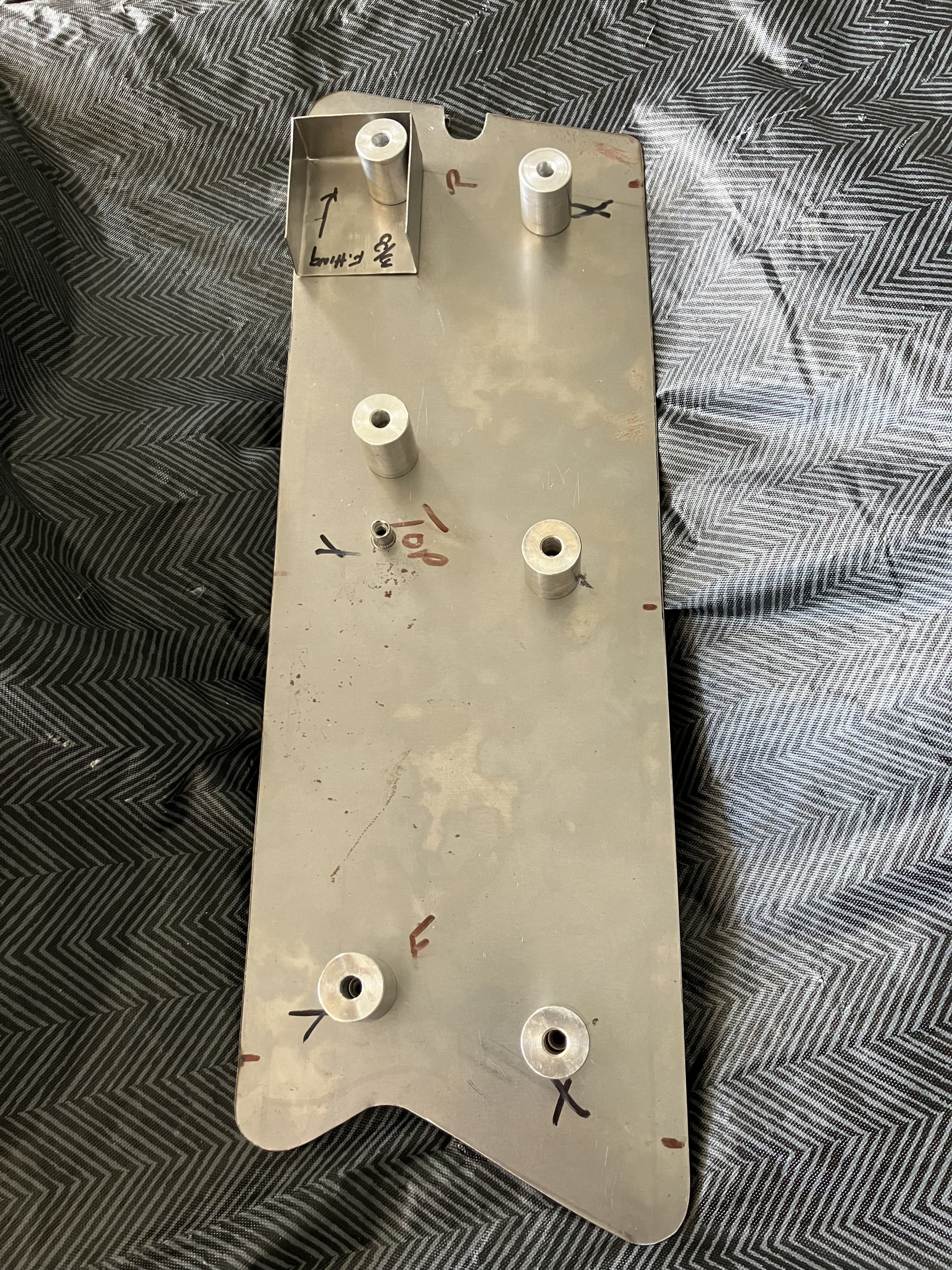

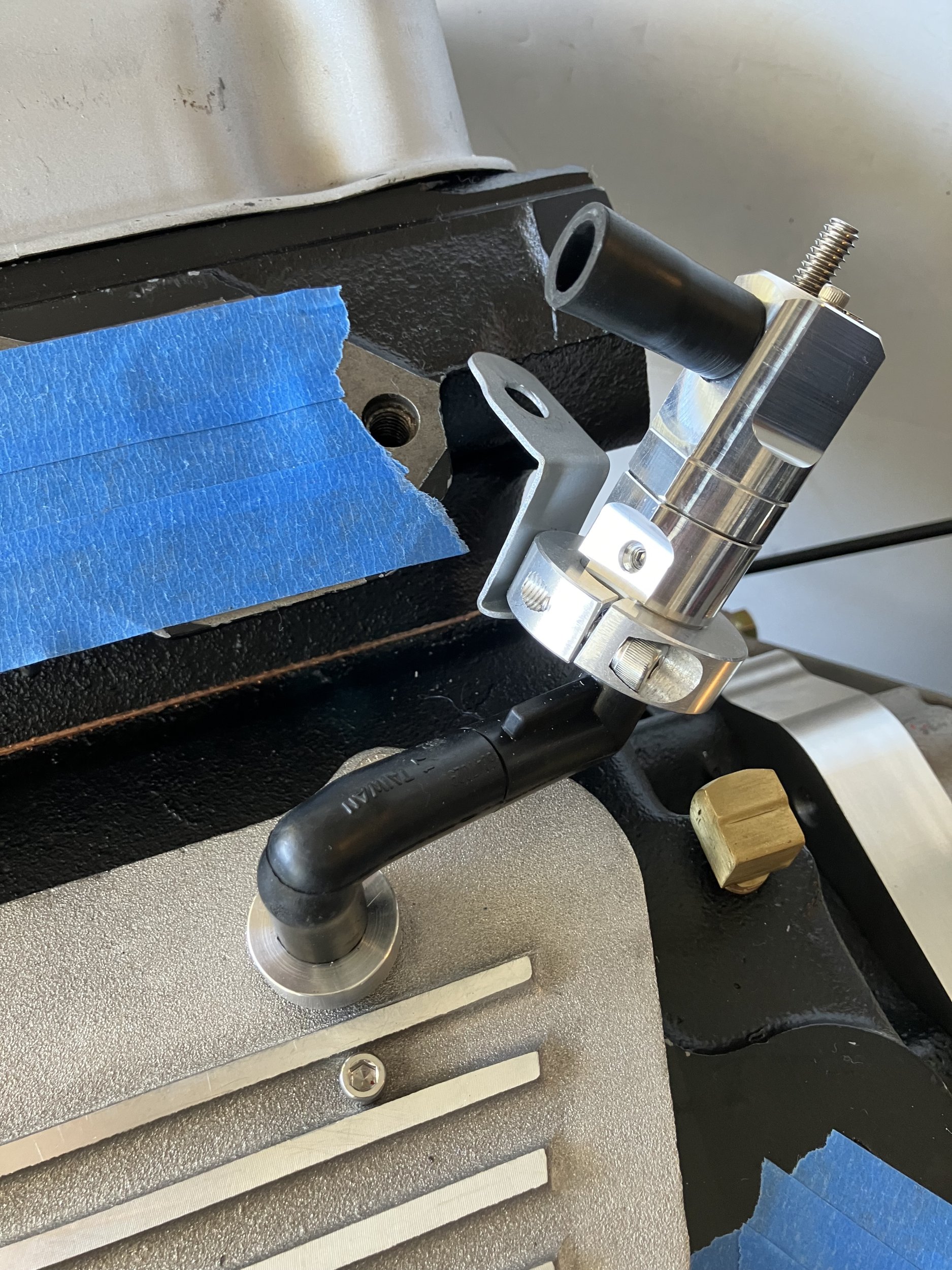

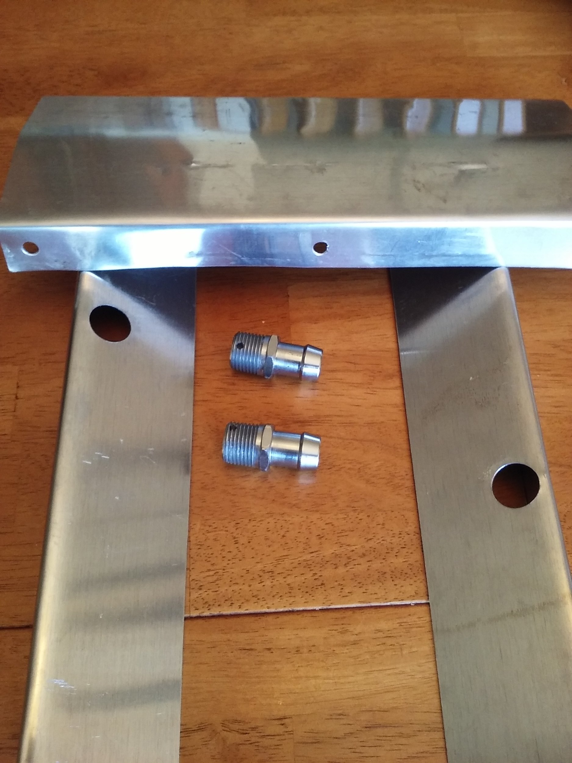

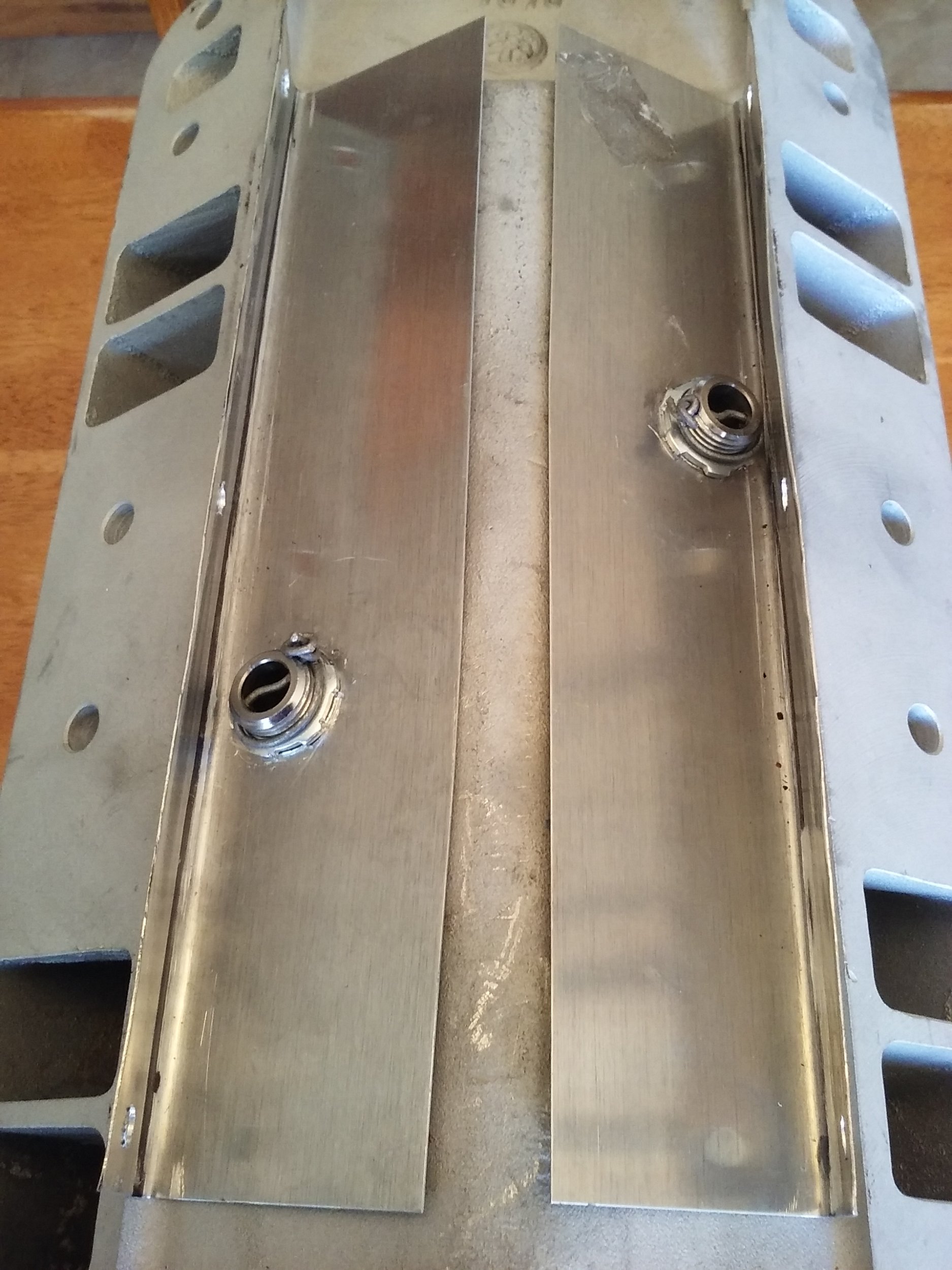

    I went this route.....for vintage Offenhauser valve covers (no PCV/breather ports). I came off my p***enger side breather with an inline PCV to the center carb base. I used a breather screen as a template and cut a plate from sheet metal to plug the top of the (p***enger) breather and epoxied any voids around the edges to seal it off. I then stuffed the breather full with a stainless pot scrubber for a filter. The driver's side breather is unaltered so it's pulling across the engine, grabbing the crankcase pressure. Not a 500 horse mill.....but works great for my application.

    THANKS ! THATS WHAT I HAVE NOW BUT NO NAME BRAND , WANTED TO SWITCH TO THE BLACK finned EDLEBROCKS BUT OUT OF STOCK & NOBODY WOULD ANSWER PHONE CALLS SO FCK EM . AGAIN THANKS! GONNA FIGURE OUT THE OFFYS COMBO SOMEHOW .
    lothiandon1940 and Mr. Sinister like this.

    THATS A SWEET LOOK ! LIKE GAMBINOS FU54 .YES I SAW SOMEONE BUILD A EXTERNAL INLINE PCV SOMEWHERE , THOUGHT IT WAS ON HERE . THANKS THAT MAYBE THE ROUTE IM GONNA GO . COPPED YOUR IDEA & SAVED ! THANKS
    Joe Blow likes this.

    Thanks, not my idea though. I got this system from @tommy (RIP). He was kind enough to go back and forth with me in PMs getting it lined out. Great guy....all props to him.

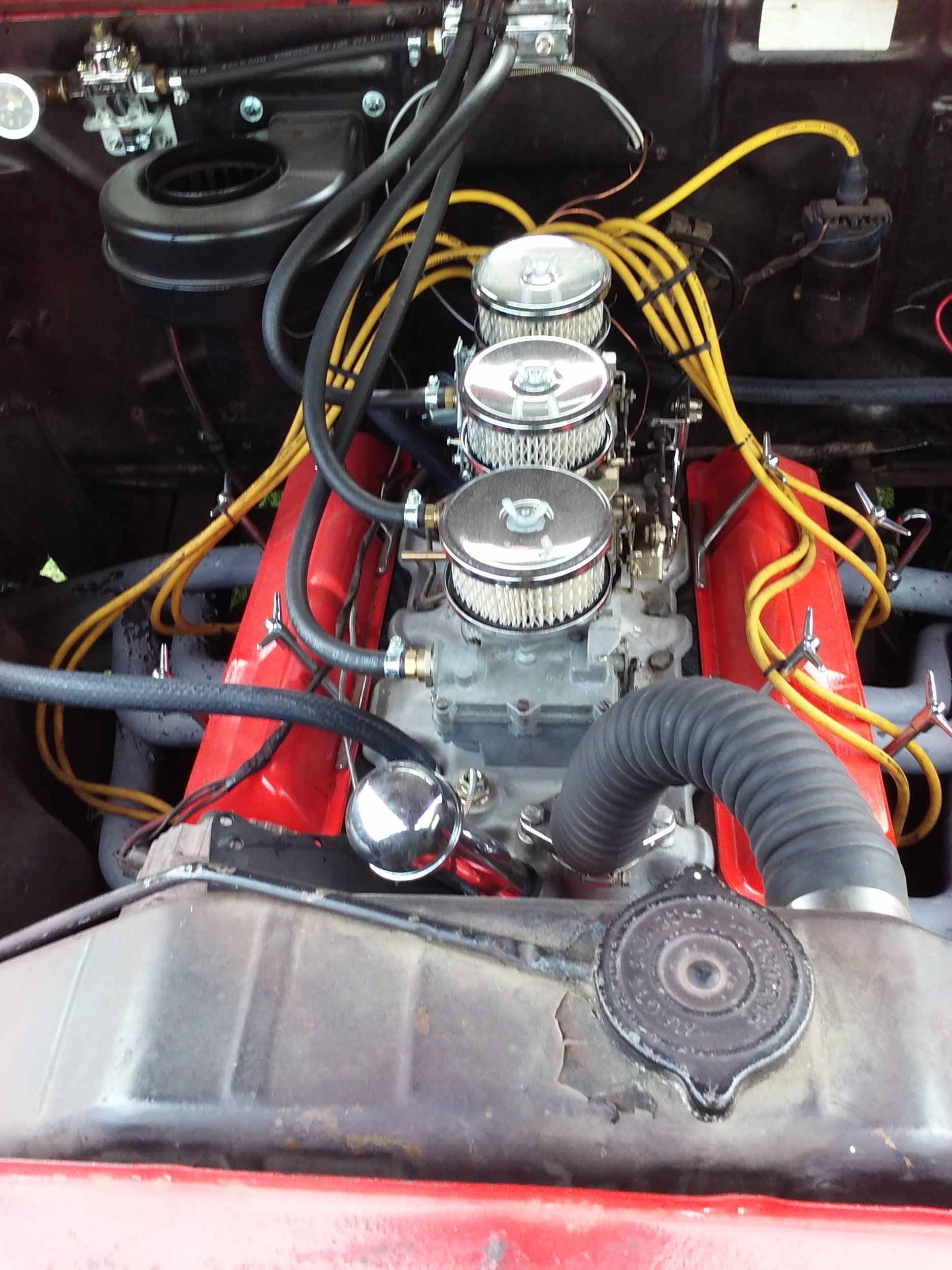

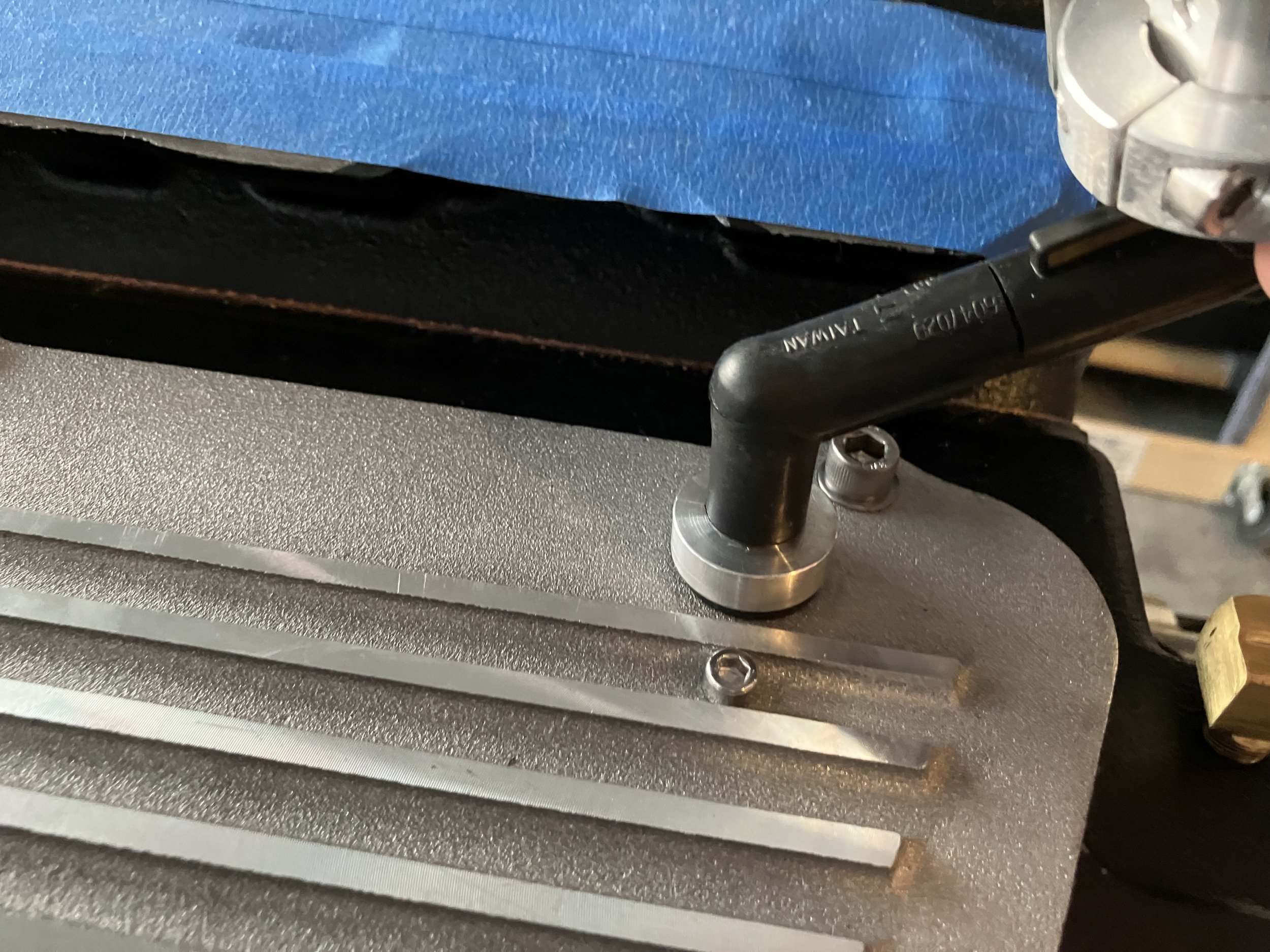

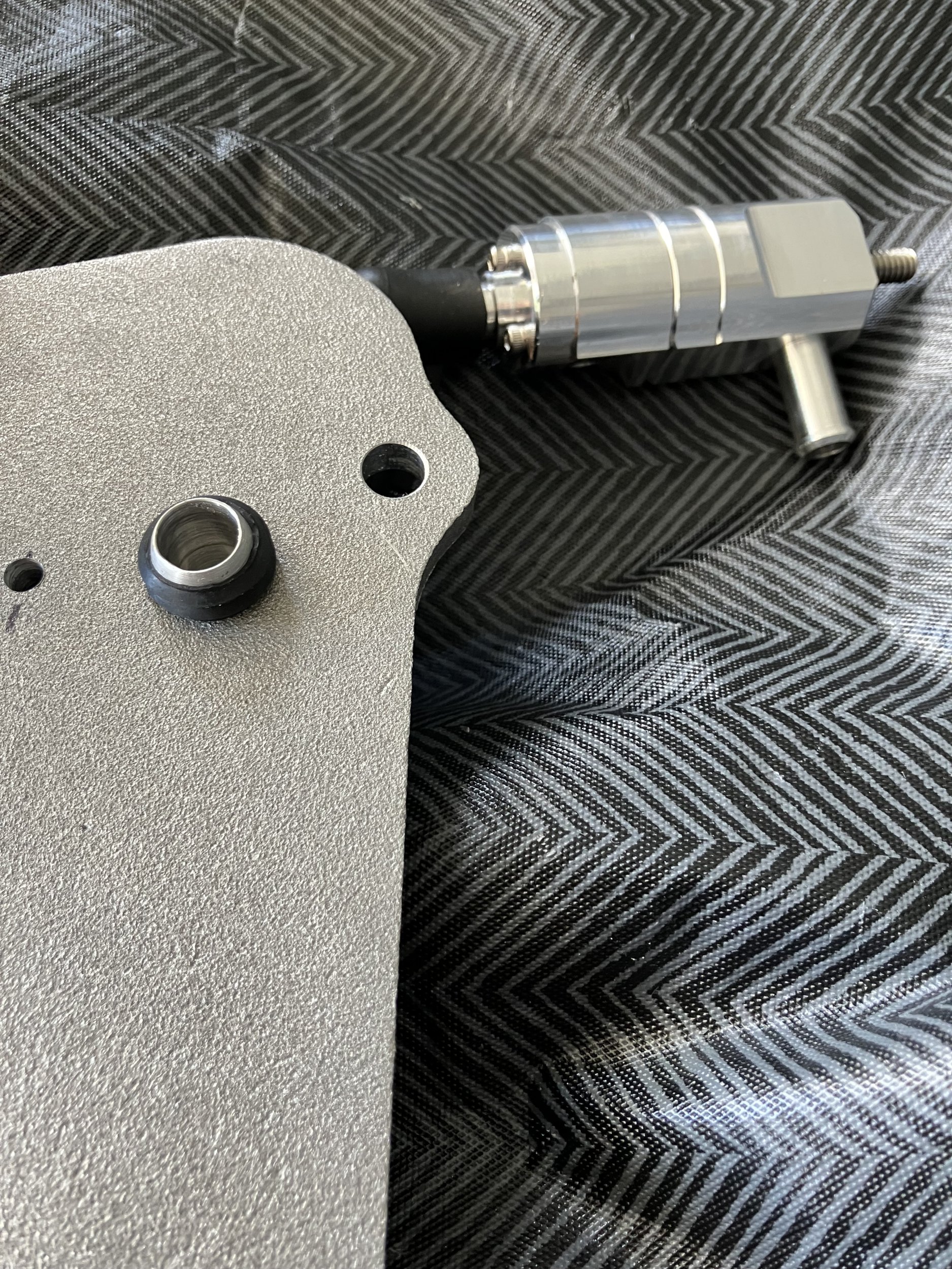

    I've worked through the same problems to run unmolested 327 valve covers, I find accessible places on the intake manifold where you can drill and tap the 3/4 pipe thread to install chevy heater core water pump ******s, then vent to 5/8 heater core hoses into crankcase evacuation systems when running headers ;)

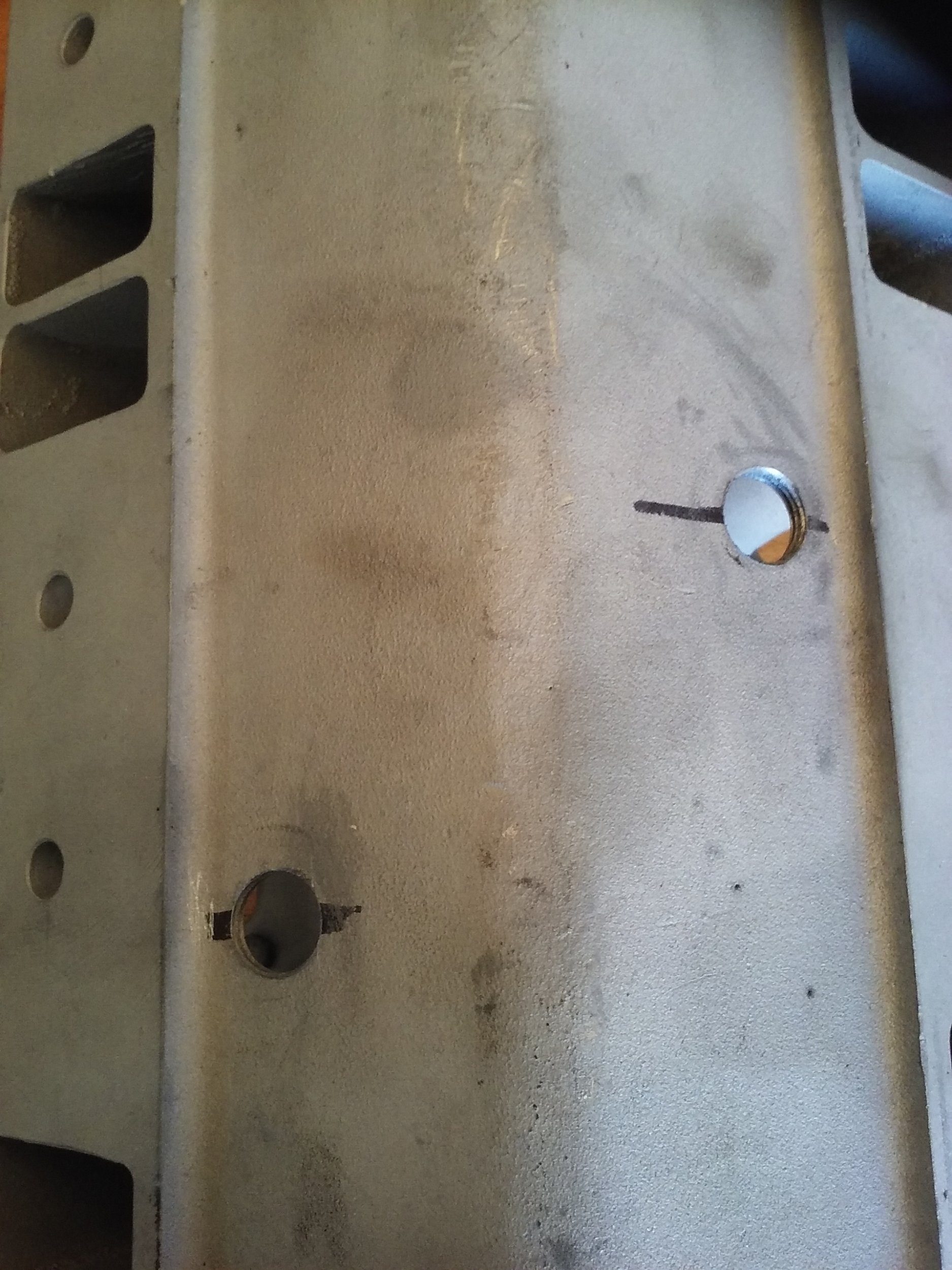

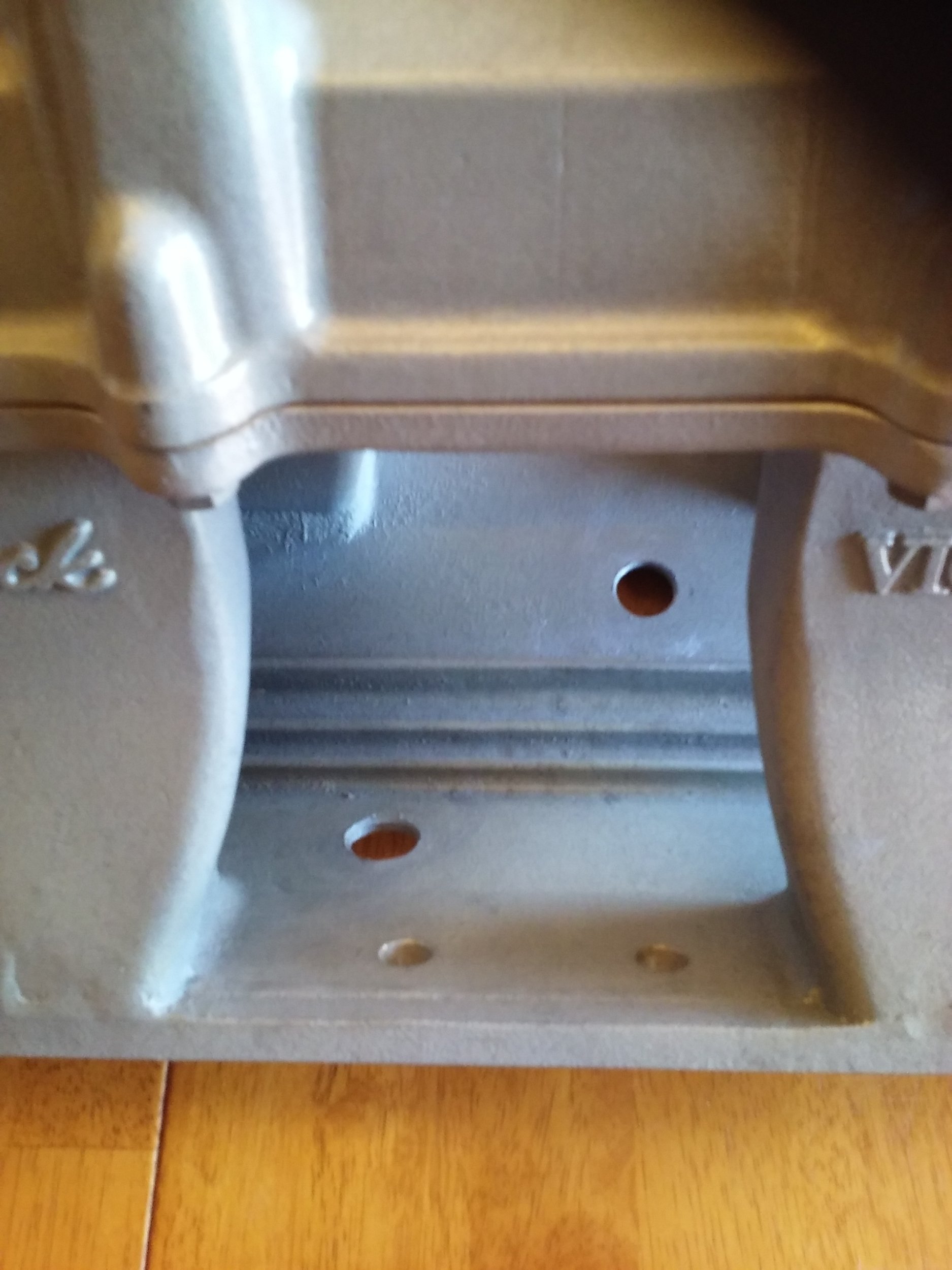

    Running a strong big inch sbc will require large port heads with 1206 gaskets and matching large port intake manifold, I don't know of any large port sbc intakes made with oil fill tubes or pads to drill and install one.

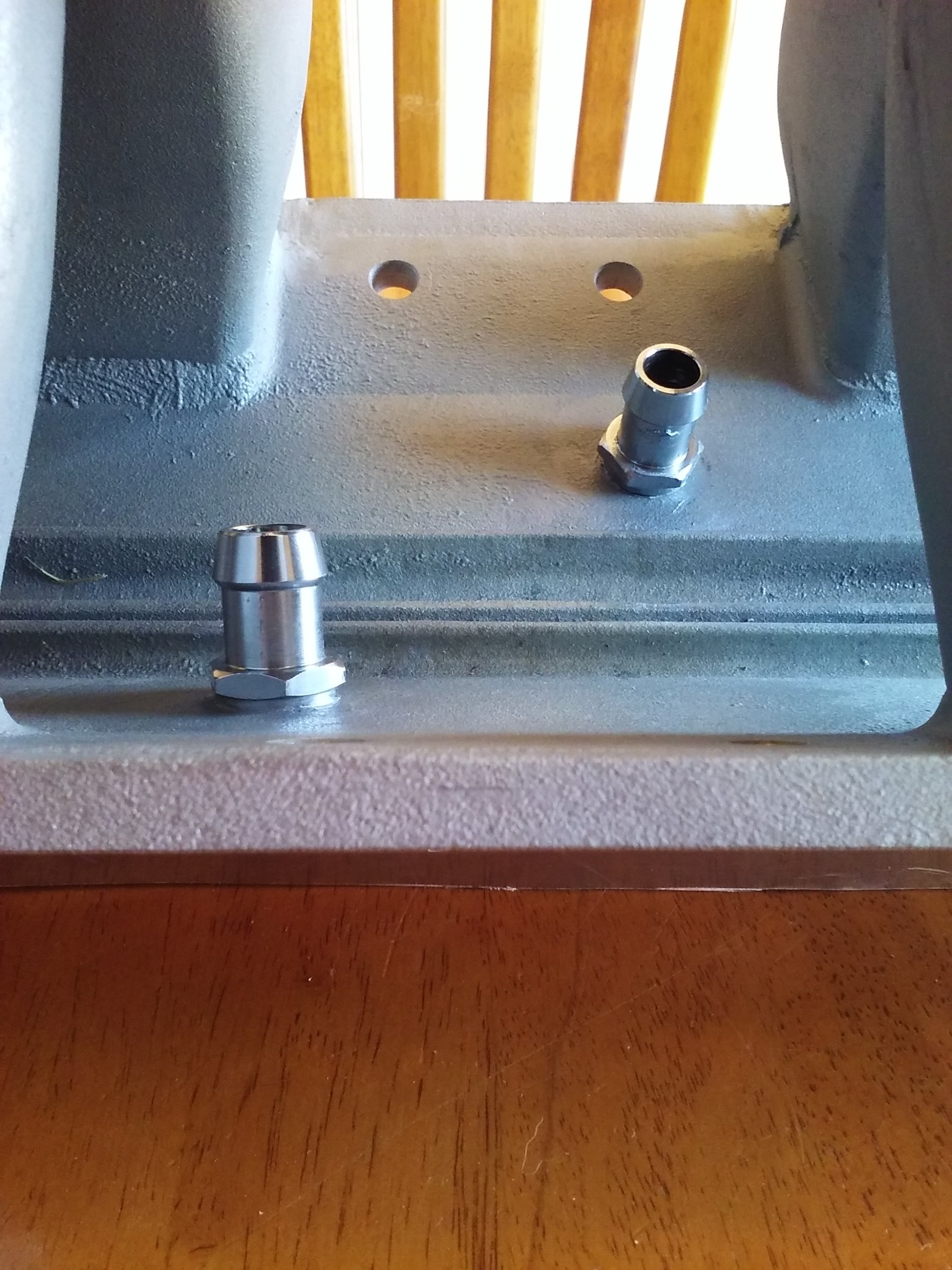

    Drilled and epoxied an oil fill tube on this vortec intake, tapped manifold for the hose ****** behind the carb near the distributer try to hide the hose ***embly, trying to keep a stock look, you can see the vent hose routed out near the rear of the p***enger side wheel tub, untrained eyes never notice, :D under hood 64 .JPG
    bschwoeble and lothiandon1940 like this.

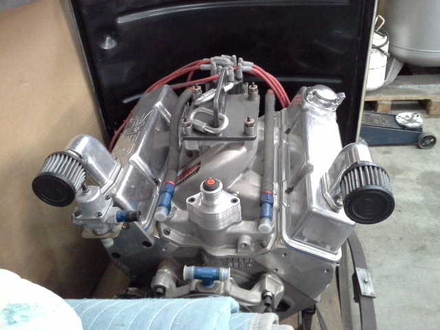

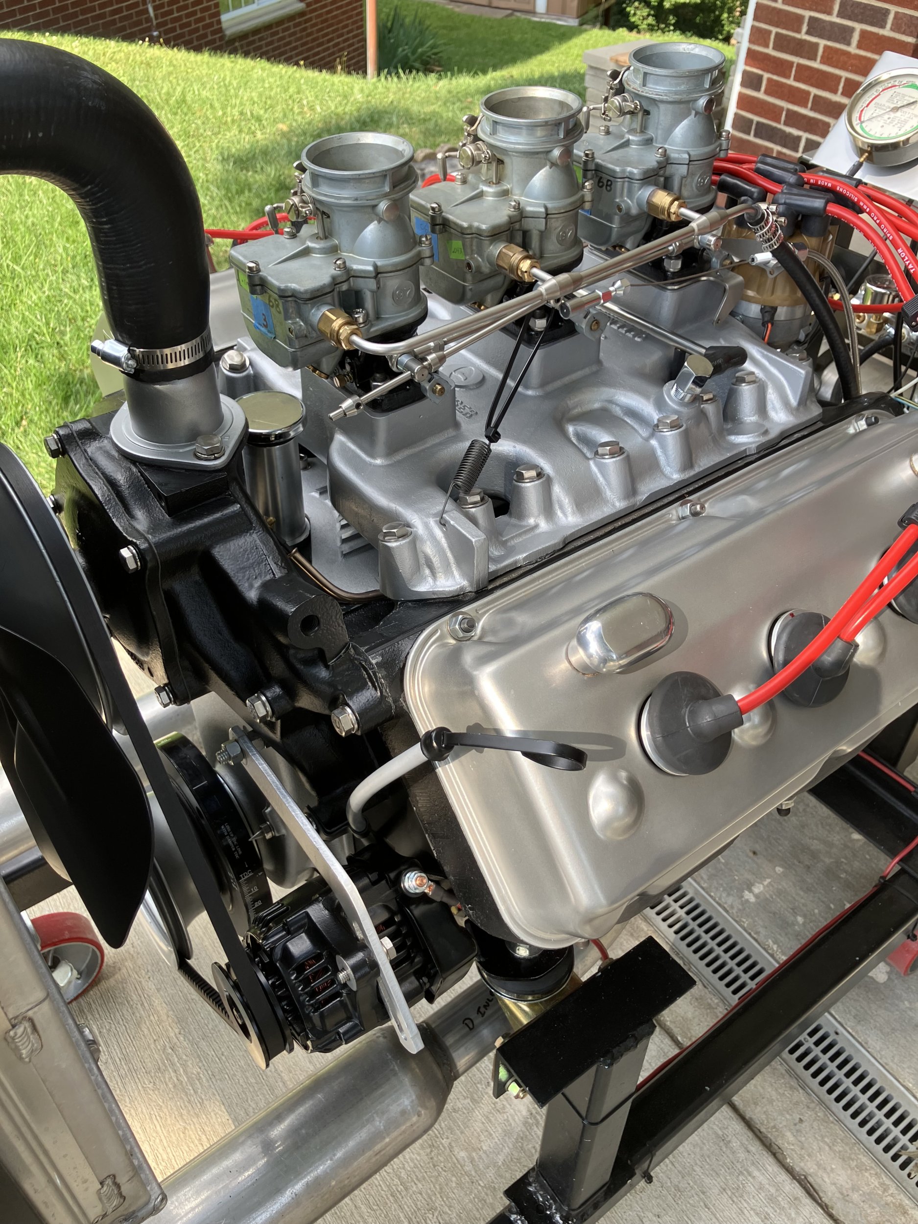

    Forgot to note install lifter valley trays or make a baffle under hose ******s on the manifold to keep oil from splashing and getting ****ed out by the evacuation system.
    This one is a 400 block with 3 x 2 Edelbrock intake vented, 1st installed a lifter valley tray and tapped for 2 hose ******s on the p***enger side of the intake, then ran the hoses into the header crankcase evacuation system.
    Front hose routed over the p***enger wheel tub to the header, and the rear hose behind the distributer to the header.

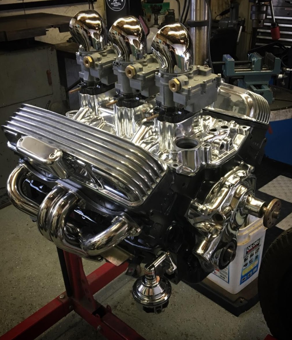

    THANKS !! IDK where i got this photo but this is what im looking to accomplish . With or without trip carbs is OK by me .Whatever , I would like 500hp if possible or damn close .

    SURE DO THINK SHES PRETTY!! LOVE TO HAVE SOMETHING DAMN CLOSE TO IT . MY GOAL

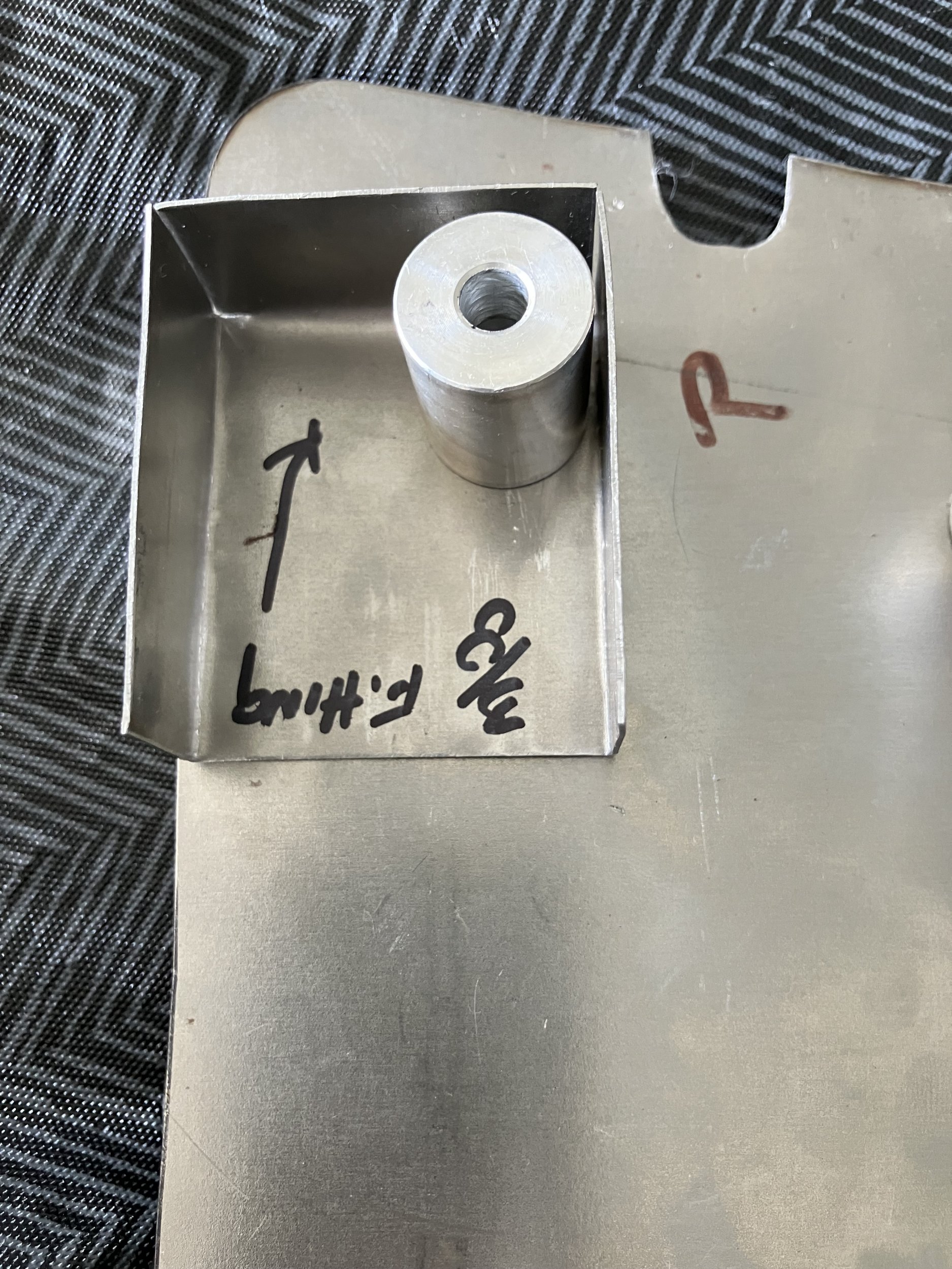

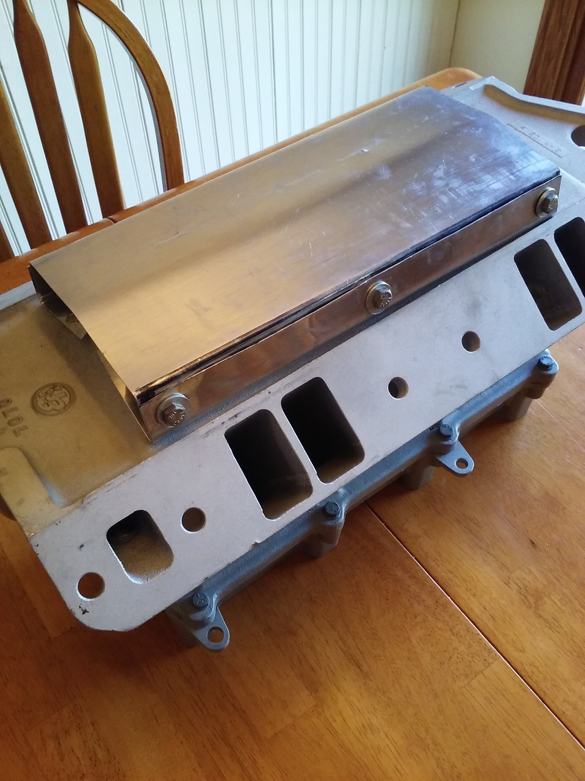

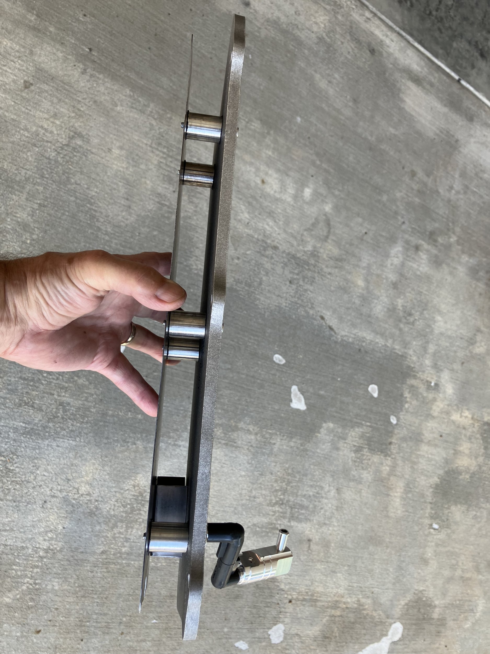

    Vented and baffled this tunnel ram for the drag engine with header evacuation system , there is no room for a front oil fill tube so it's a pain to fill again during oil changes:oops: but worth it for the 327 covers :D
