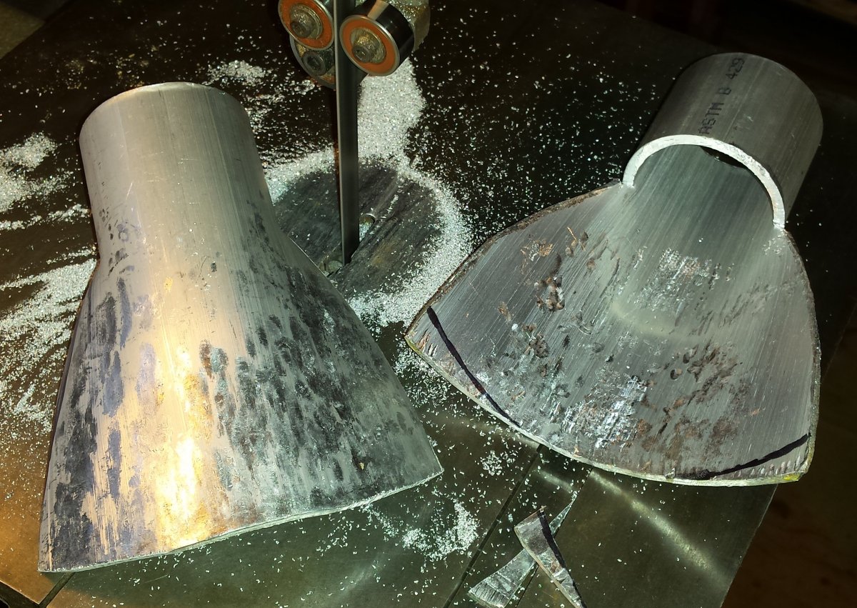

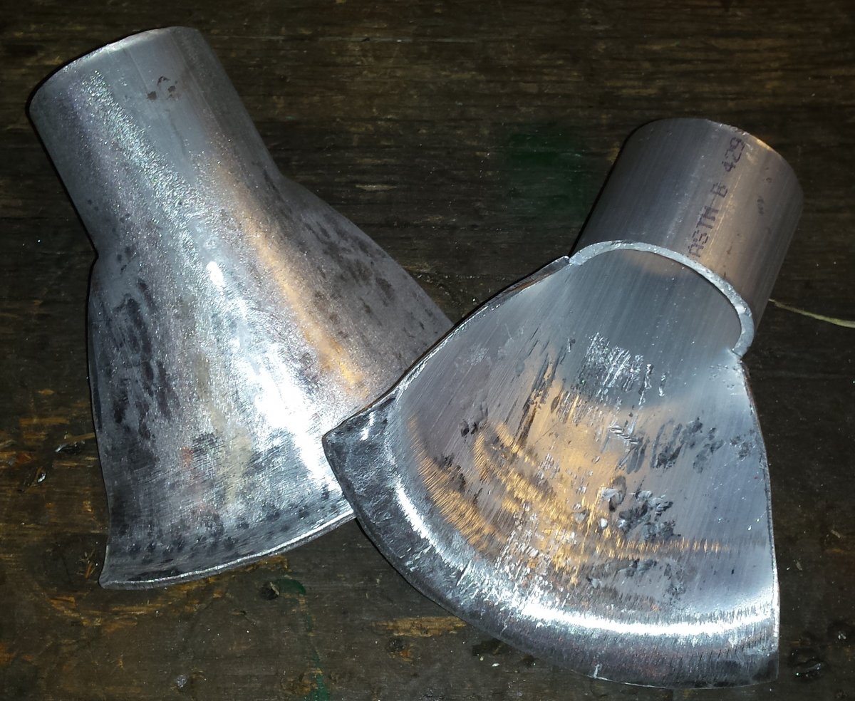

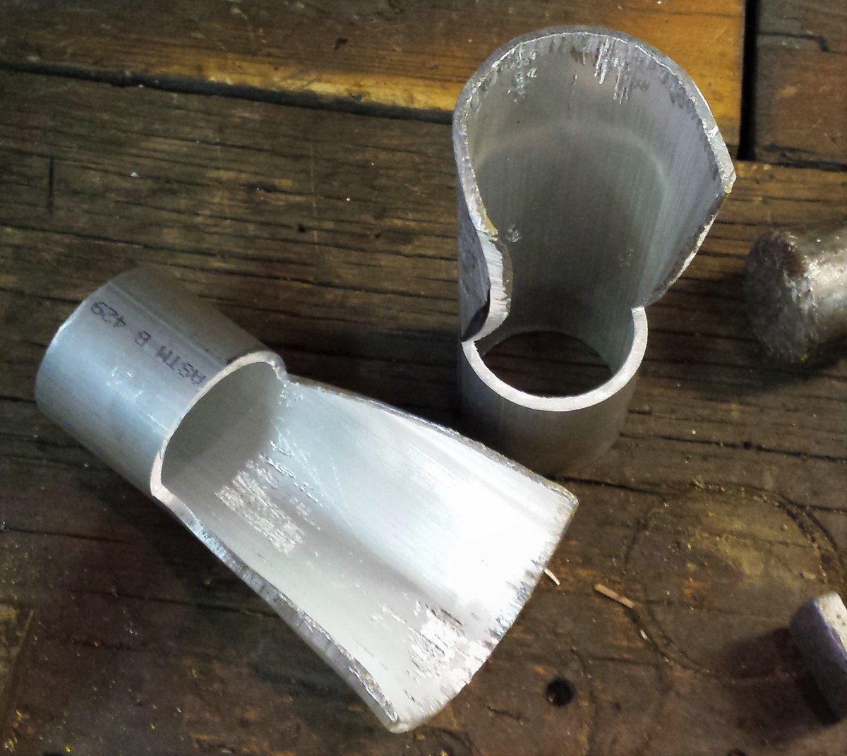

    another try at home made parts, gotta couple little cracks I need to weld and then final sand and polish. also a pic of my new to me band saw, I slowed it down for metal cutting with these additional pulleys :)
