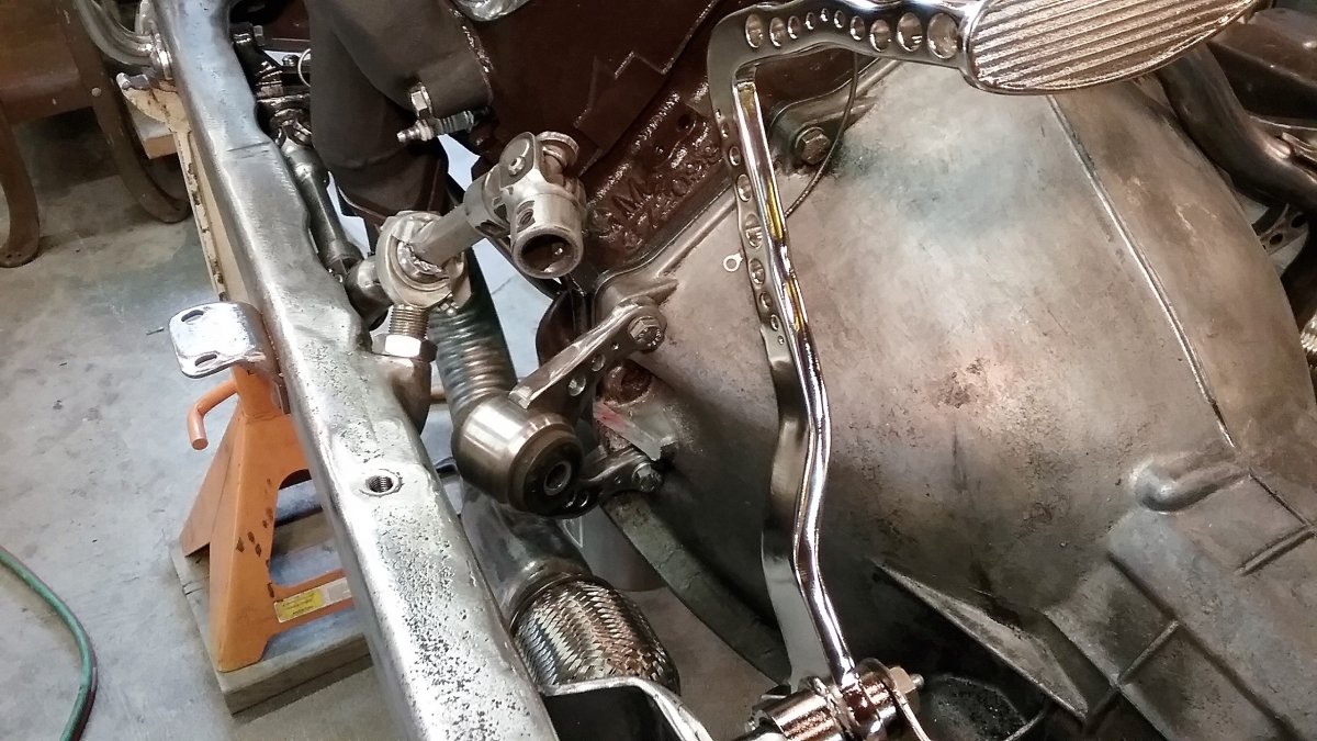

    I usually post pictures after I "pretty up" stuff I build or modify. Well; my crankcase vent tube needed to be flattened out a little and bent to miss exhaust etc..... I bet we heated up 30 different times and it ended up much uglier that this picture shows, (but does fit). not sure what i'm going to do with it now...

    I built exhaust with mockup engine that used a standard mounting starter. when I installed the Danchuk starter adaptor plate my downpipe hit it. I had to grind off over 1/2" of the plate for clearance, then I thickened with this little piece hopefully add back strength.

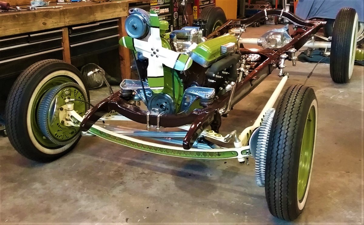

    got me a new phone, takes a lot better pictures.... Been making good progress, but starting to get side tracked with other stuff :(

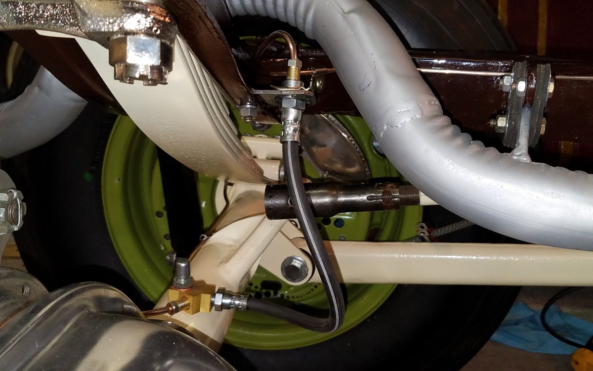

    since going with 4 wheel drum brakes i'm gonna try to get to work good as I can. decided to use a Willwood adjustable proportioning valve for fine tuning and some 10 lbs. residual valves to help keep shoes from creeping off. didn't really pre-plan routing lines, trying to stay away from exhaust will be biggest challenge.

    about 4 hours split between 3 days after work has gotten some brake lines/hoses/brackets run..... must admit I have a TV in garage and the Maroon n Gold chair is pretty comfortable. But truth is i'm pretty slow sometimes.

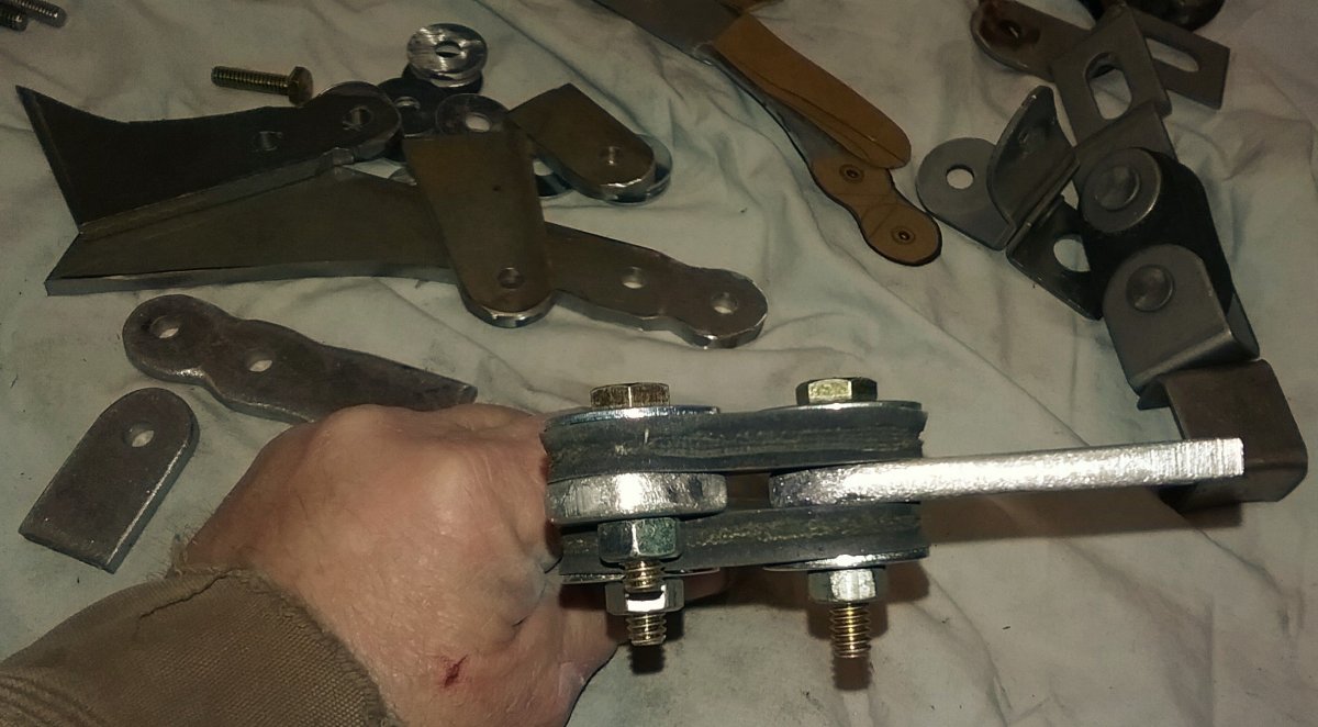

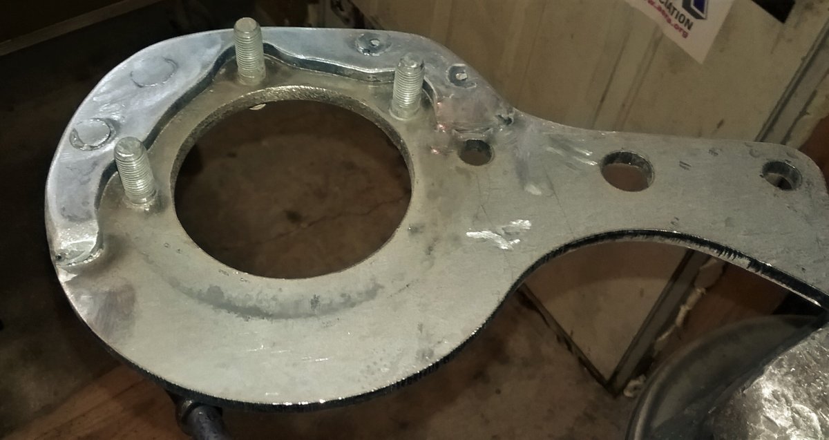

    really should've figured out parking brake earlier....
    this bellcrank is from a 51 ford F-1, same one I got the rear drums and cables from, no sure how i'm going to mount it yet. (maybe to the body floor along with front cable and handle)
