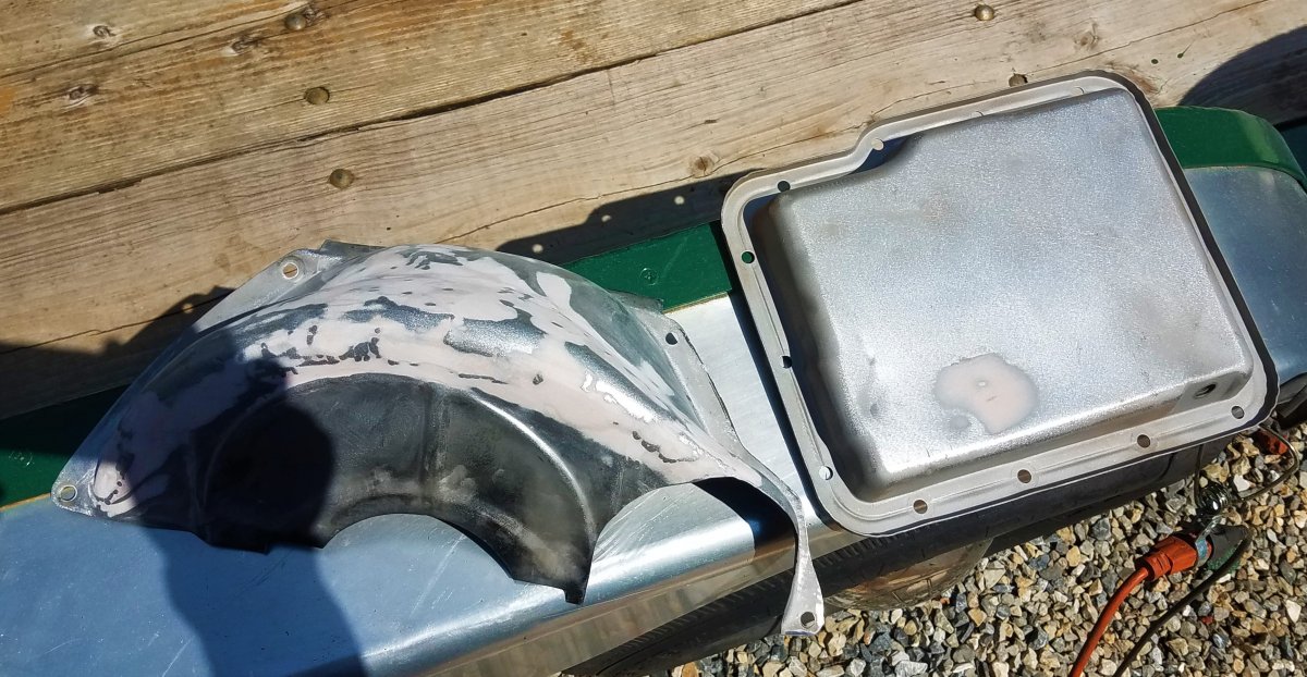

    with my starter mounting ring adaptor, neither a Powerglide or TH350 torque convertor dust cover fit, so I had to ruin both of them to make one. Not pretty but will work....
    Stogy, brEad, loudbang and 1 other person like this.

    slow progress, but did get flexplate cover finished and am about done routing cooler lines. also verified timing and finished sparkplug wires.... starting to dream about first startup

  25. 340HilbornDuster
    Joined: Nov 14, 2011
    Posts: 2,017
    340HilbornDuster
    The Green & Brown combo [emoji106]
    Paisley drain holes [emoji106]
    Lotso COOL Details [emoji106]
    Almost there [emoji106]
