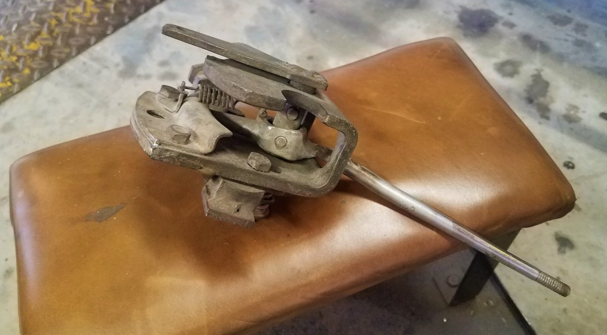

    got me a used and abused 63-64 corvette powerglide shifter, I think I can get to work for my needs.
    also made a couple tube clamps, i'm sure i'll be making some more.

    had some time after work today, got another what the hell is that thing......

  22. NashRodMan
    Joined: Jul 8, 2004
    Posts: 1,989
    NashRodMan
    Looks like some kind of bracket that looks like it slides over a frame rail or cross member??
    '52 F-3 and loudbang like this.
  23. SimonSez
    Joined: Jul 1, 2001
    Posts: 1,667
    SimonSez
    Shifter mount for the trans tail-shaft?
    '52 F-3, loudbang and BradinNC like this.
  24. '52 F-3
    Joined: Sep 30, 2007
    Posts: 961
    '52 F-3
    from Central PA
    SimonSez Yes :) , initial test fit is pretty good....
