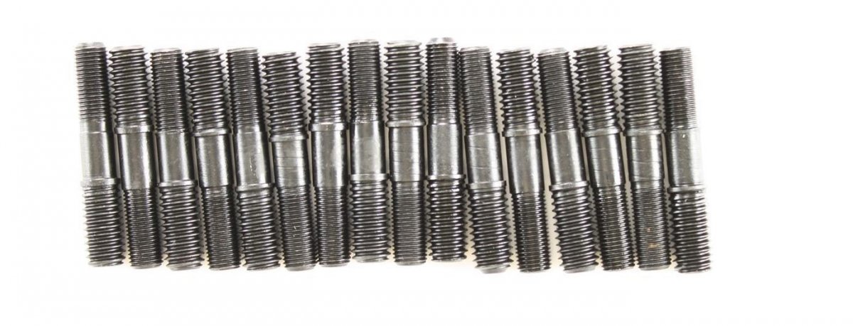

    97; thanks for the replies and info about studs, what do you think about the ones below?
    I ordered these screw in studs that don't require the boss machined flat. And this tool designed to help pull the studs and align the tap to cut threads straight. I don't like the ideas of taping while still installed but removing heads I like less :(

  9. So much easier to buy a box of 1/8" roll pins, drill and pin the studs. We did that 50 years ago before screw in studs were available. 100's of passes over 7500 rpm, and never a failure. Why make it harder?

    yes , just put plenty of grease around where you are tapping to catch the cuttings and clean it up carefully with a rag. Dean's way is the trad way .. you still have to press the studs all the way back to where they came from.
