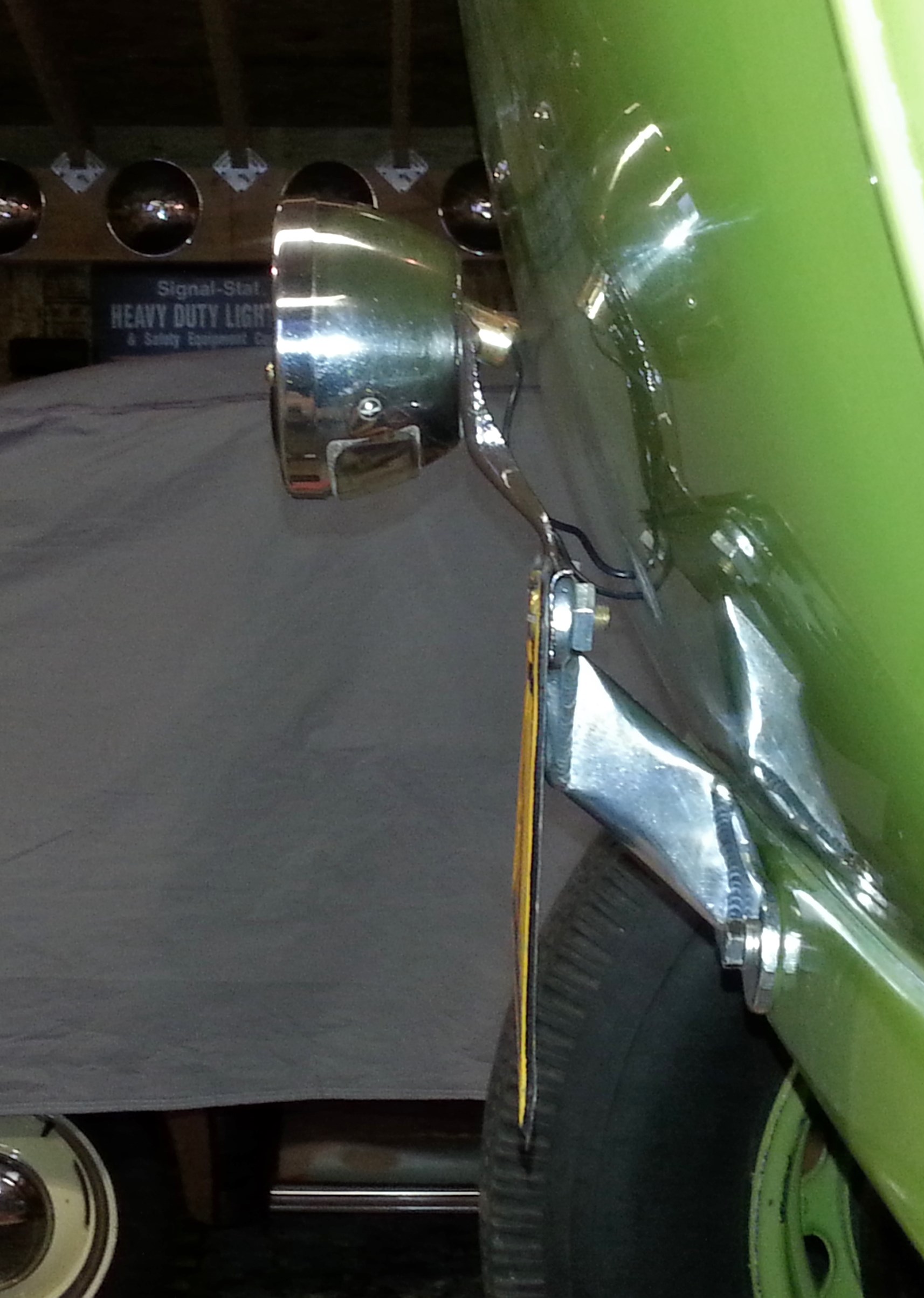

  8. '52 F-3
    Joined: Sep 30, 2007
    Posts: 961
    '52 F-3
    from Central PA
    yeah, I liked the idea better than how it looks.
    so I changed back to my original idea, moving the mounts from the bottom to the back aluminum piece. 2nd pic is for those that like detail, br*** screws and 1,000 hammer marks on the inside of aluminum.

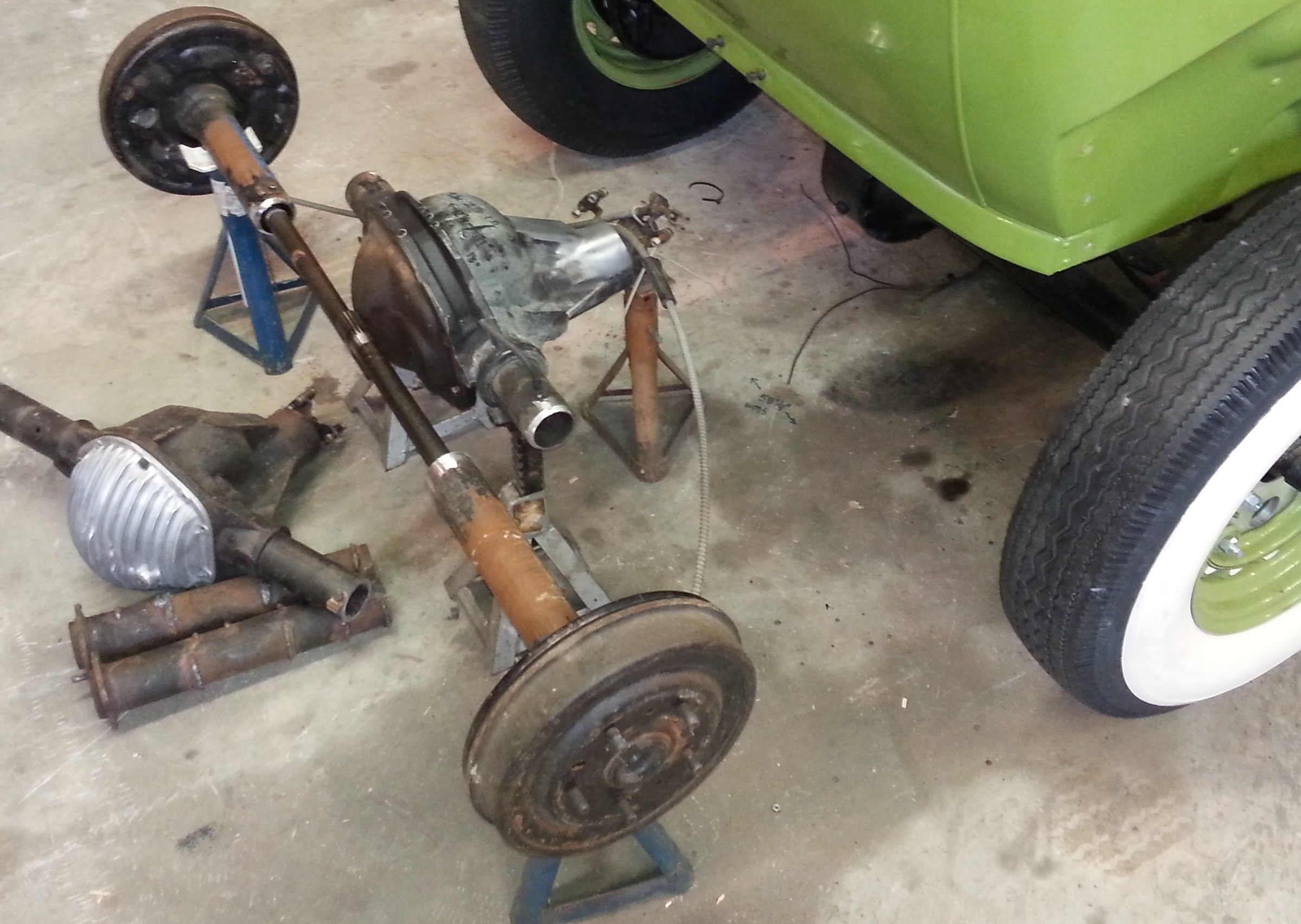

    while waiting for headlights paint to dry I decided to measure rear axles again and start cutting....
    plan to made a sleeve that matches the ID of each tube.... (and ensure straight before welding)

    headlights are pretty much complete, still need to bend the stands into shape and paint, (made from the factory light bar) but will have to wait until build is much further along....
    and of course cut those long adjustment bolts down so i can use an acorn nut

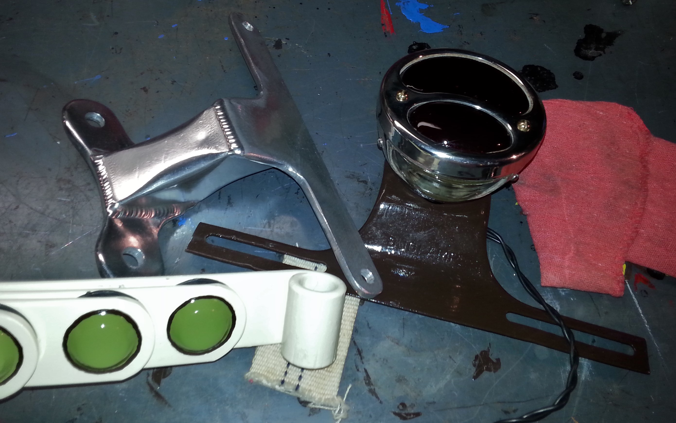

    not much progress this week, started painting front spring and cleaned up Model A shackles (plan to order some bronze bushings)
    also started the license plate mount
  20. '52 F-3
    Posts: 961
    '52 F-3
    from Central PA
    very happy with my simple license plate/tail light mount. used original spare tire bracket holes (I put a rubber grommet in top hole and run wire through it) lotta work for an almost un-seen part. Now I'm thinking about turn signals (possibly locate next to license plate similar to motorcycles, anyone got pics of something like that?)

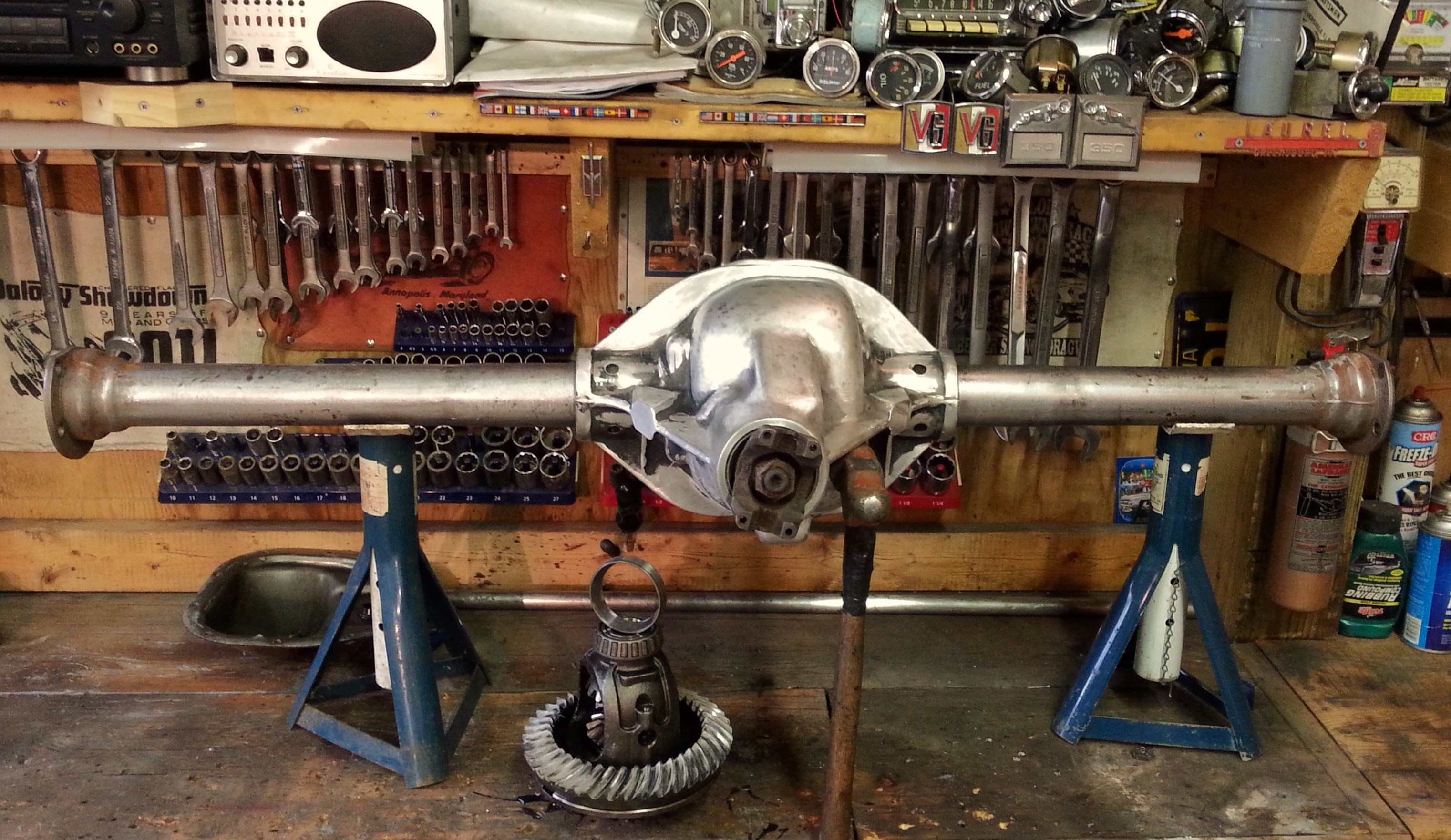

    so made these sleeves to fit the different I.D's of the axle tubes. I pressed in outer then warmed up inner to put in. I use a 1" bar and some spacers to make sure everything stays straight while welding.
    not to artistic, but I have been thinking about the adjustable rear radius arms......

    1 step forward and 2 steps back today;
    got the 1951 Dana 44 tubes welding to the 1993 Dana 44 center finished, but while I had the carrier and ring gear out I found a bearing race issue.... I guess I'll be ordering a R&P install kit later. (I prefer to spend money on things I want over things I need)
