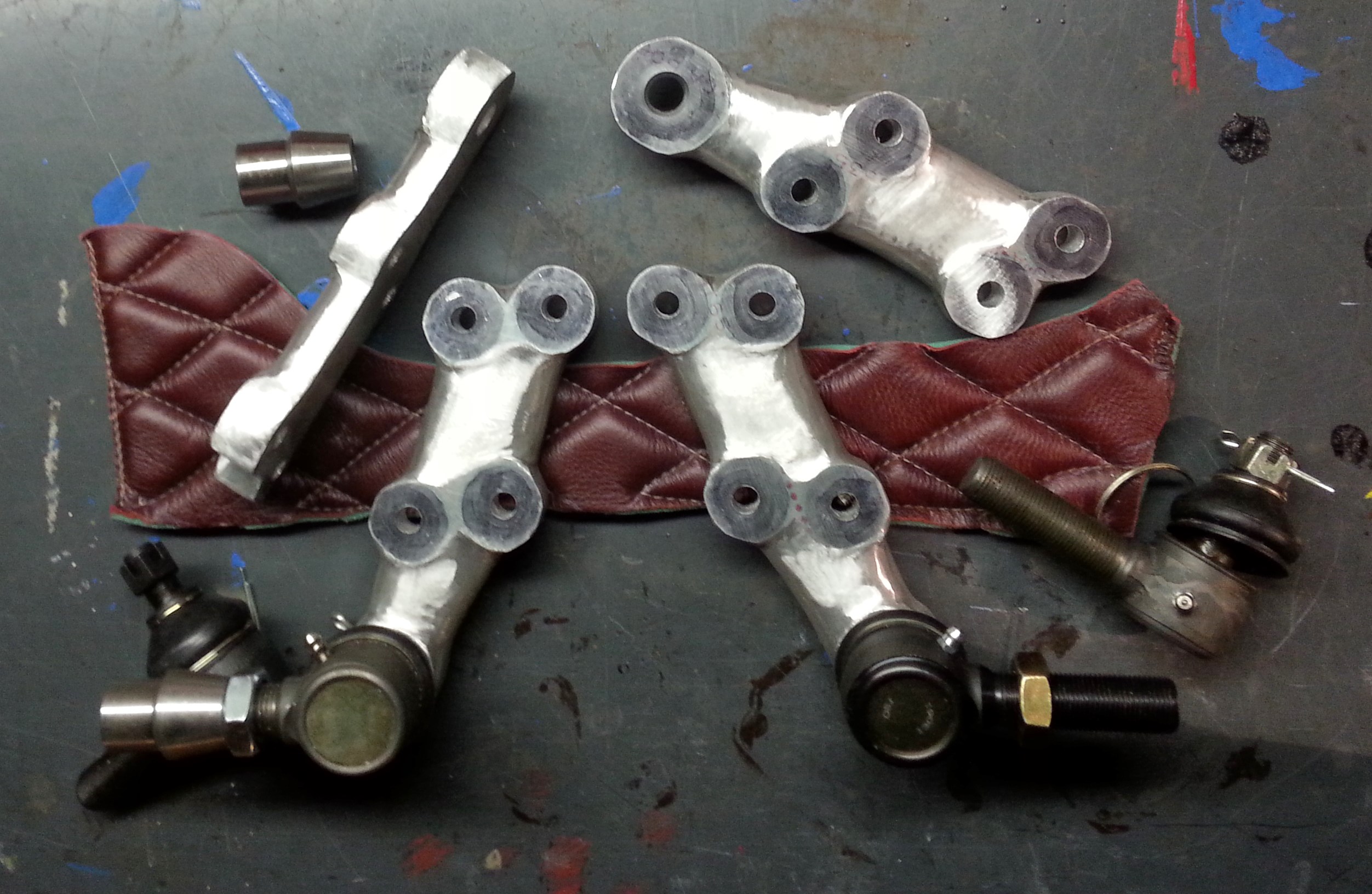

    Yes the rods ends will be used with 6061 T-6 aluminum ginger bread men....

    used a "flapbrush" in a grinding wheel to give the Gingerbread men their rough shape, drilled some mounting and tapered tie-rod holes and they're ready for sanding/polishing....

    So if were calling the 4 shinny ones "Gingerbread Women" what do we call the track-bar mount I've just roughed out?

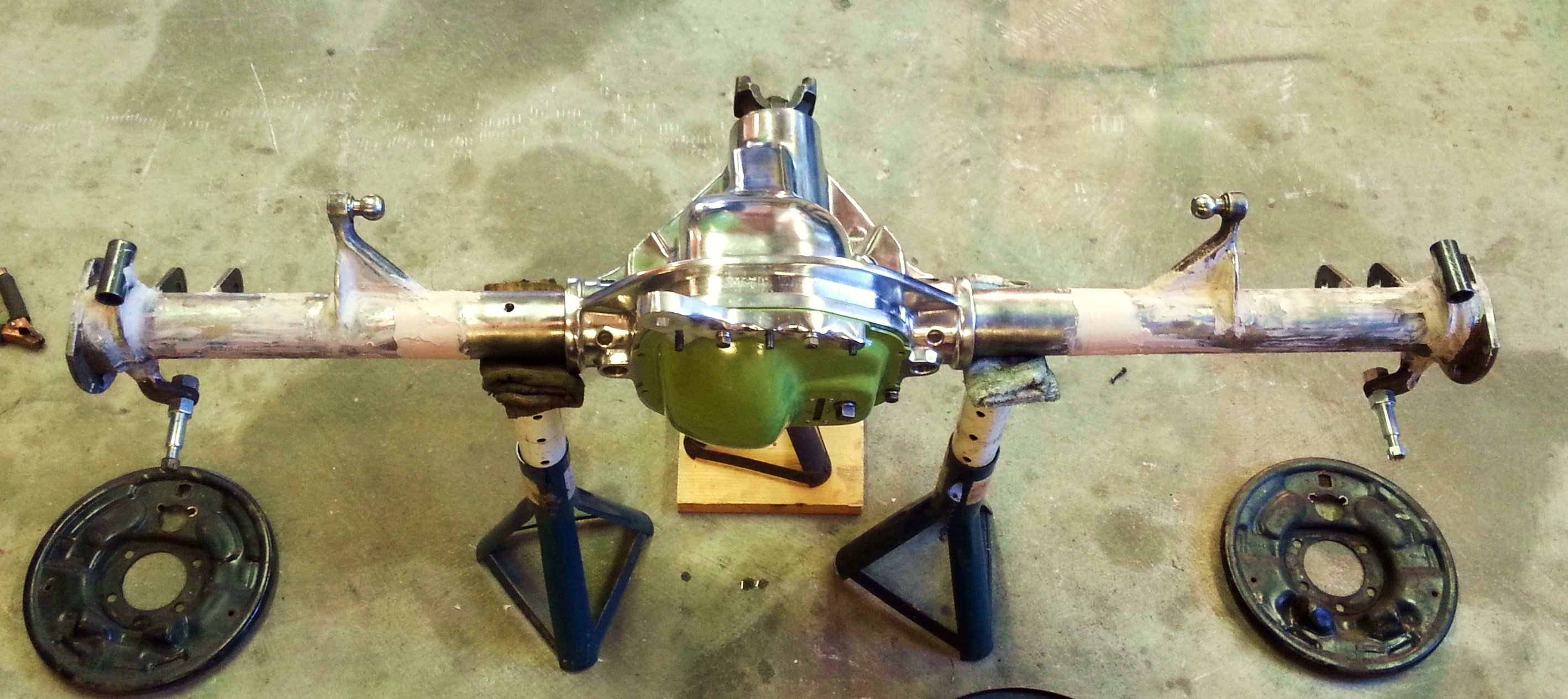

    finished polishing rear Dana 44 housing, installed new carrier bearings and welding brackets.
    "bondo'ed" welds between two different diameter tubes to make a smoother transition etc..... will sand most off.
    Damn it's cold out....

    i was sitting on the couch watching football and thought; "i can drill holes and watch football at the same time".... couple hours of drilling and my rear backing plates kinda match the front ones.
    plan to make a scoop for each plate....(was considering 2 on each side)
