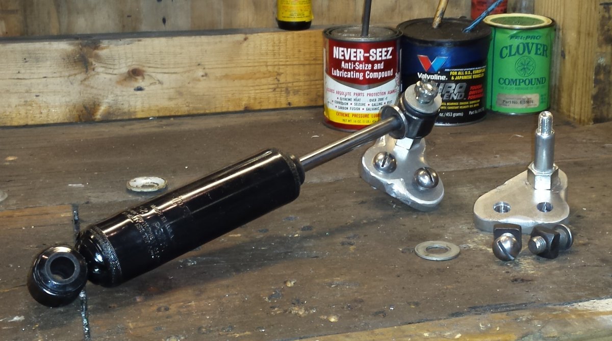

    a couple hours of metal whittling got me the beginning of a upper front shock mount.

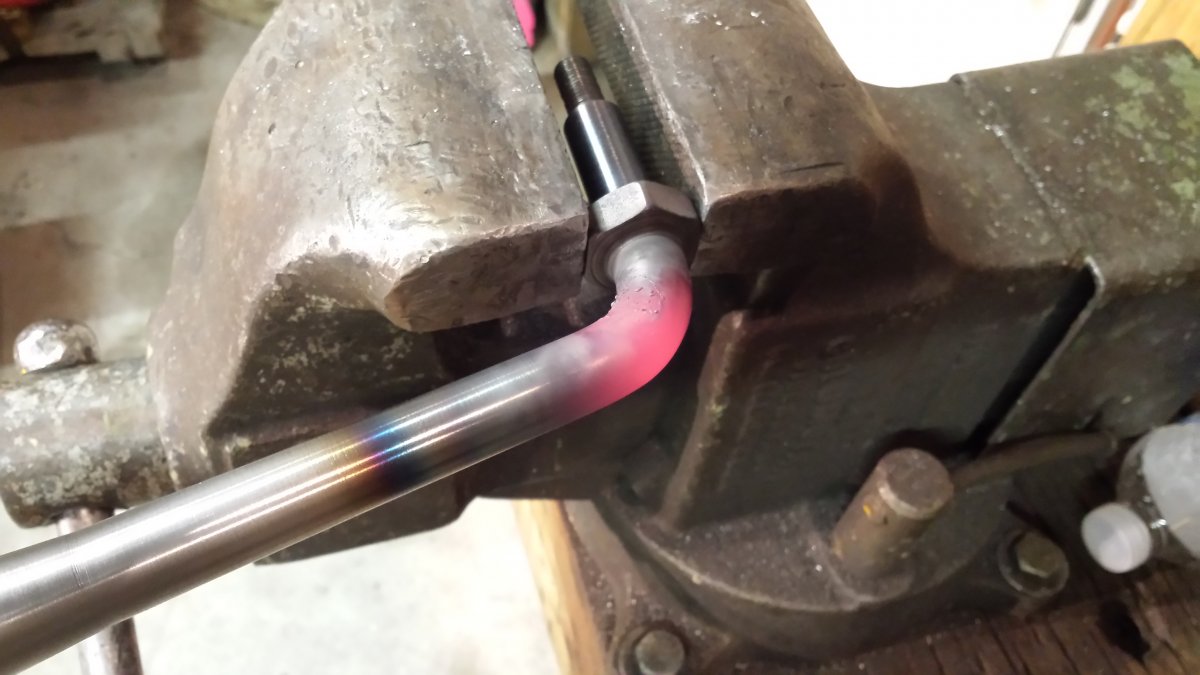

  4. '52 F-3
    Joined: Sep 30, 2007
    Posts: 961
    '52 F-3
    from Central PA

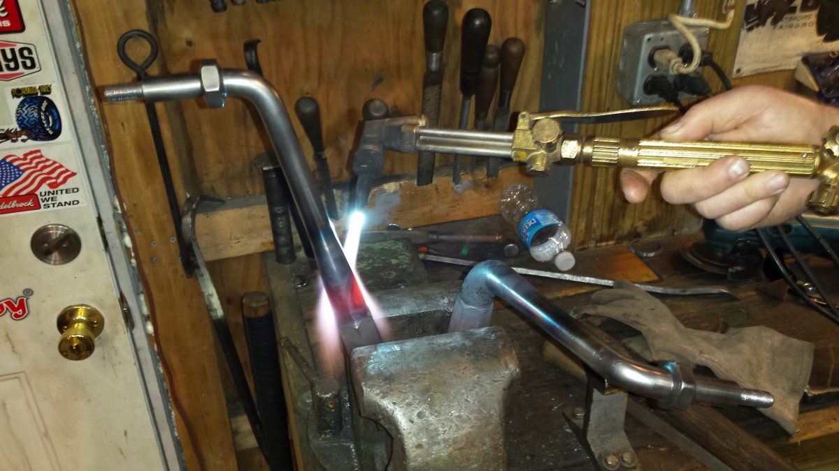

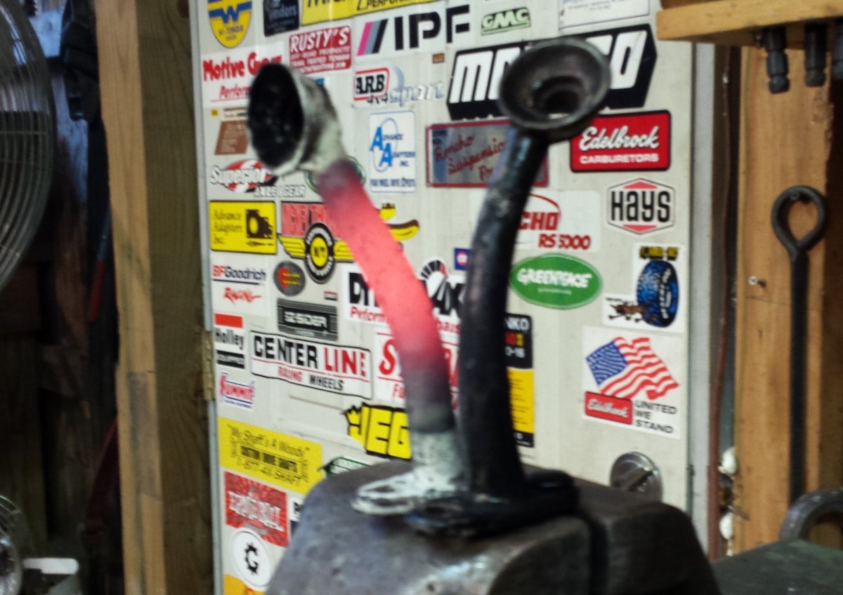

    a little bit of heat and my F-1 inspired shock mounts are starting to take shape....

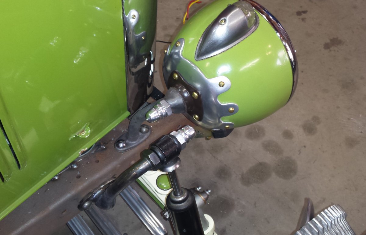

    initial test fit looks kind of tall? and still over thinking the lower shock mount.... so I started working on headlight stand (using original cut offs and bending)
    juan motime, Stogy and kidcampbell71 like this.

    i have too many hours in these f'ing shock mounts and I still ain't happy..... but they're getting closer.
    1st time with headlights mounted (I do like how these are looking). need to get off lift to have a better look at everything.......
    I bent the steering arm a little bit to match drag link angle with the track bar, I don't believe i'll have any bump steer issues. fyi.....strap is holding suspension at right height, and the shock are Monroe 5850's with the cover thing removed.

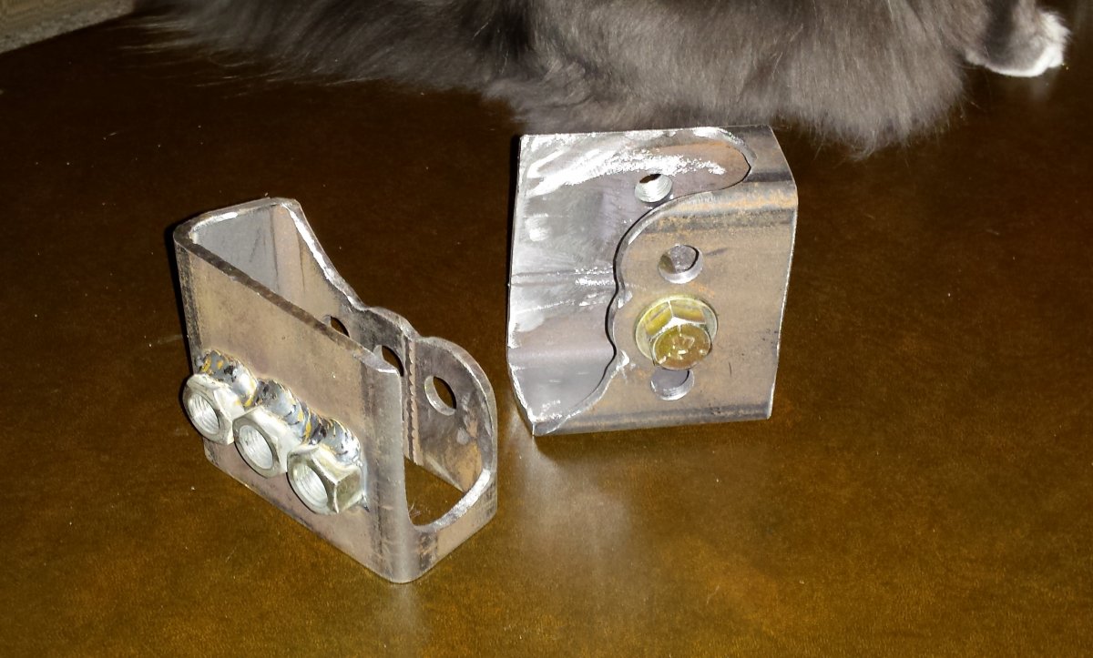

    any guess what these are? bolt is 9/16", and grey hairy thing is Max the cat o_O

  10. 340HilbornDuster
    Joined: Nov 14, 2011
    Posts: 2,030
    340HilbornDuster
    Hey, It's Friday, and I love your quizzes....
    -New Squirrel Motor Mount Adapter?
    -Removable Tow hitch mounts?
    '52 F-3 likes this.

    no, think rear suspension....
    I figure a small block chevy is "mouse" and big chevy is "rat", so a 265 is a little mouse (squirrel)...
  12. 340HilbornDuster
    Posts: 2,030
    340HilbornDuster
    Aha! ... Adjustable shock mounts?

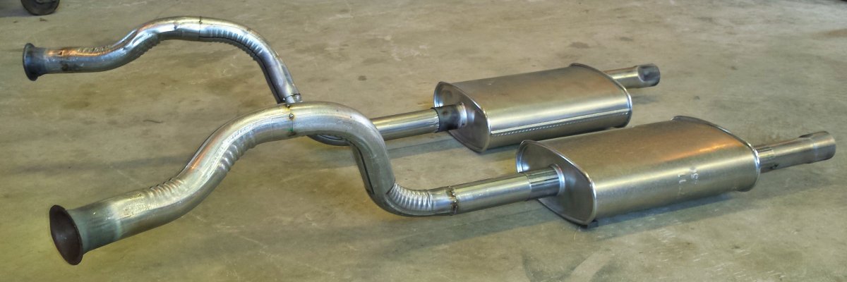

    got the control arm mounts tacked in place, plan to "smooth in" when I weld in boxing plates...
    also getting exhaust closer.

    all good guesses, but it's the mount for the rear upper control arm, the 3 possible positions will allow a little adjustment.

    Nice! (I guess My second guess "Scale" was better..)
    + they were in plane site on your last picture!
    Dig the cool details / Good Ideas on your rod!

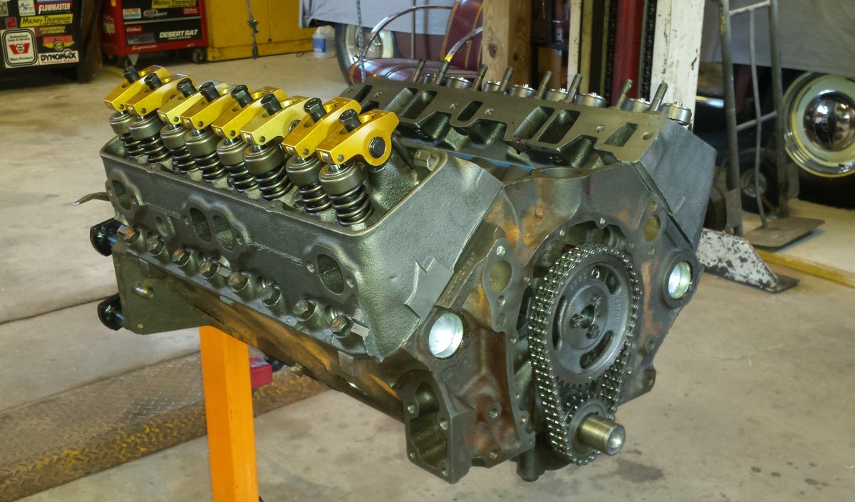

    getting some of the 265 ***embled.... slowly.... got busy with life again.
    Had 2 bent/rusty harmonic balancer/pulleys to choose from. Found another great use for a little shop lathe, used to straighten out bends/dings and ensured straight.
