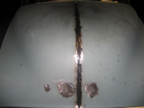

    My friend Bones and I are peakin my hood. Here are sum shots:
  2. FONZI
    Joined: Mar 5, 2001
    Posts: 1,536
    FONZI
    We tacked the hood to the car in all four corners to further prevent warpage. (this was a tip from a NOT so OLD timer mr Radshit) Also, Radshit was helpful over the phone whenever we had any questions. Thanks NEAL!
  3. FONZI
    Joined: Mar 5, 2001
    Posts: 1,536
    FONZI
    Then we started tacking the hood together:
  4. FONZI
    Joined: Mar 5, 2001
    Posts: 1,536
    FONZI
    Started layin Rod:

  6. FONZI
    Joined: Mar 5, 2001
    Posts: 1,536
    FONZI

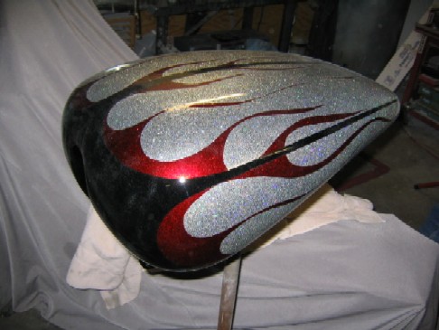

    That is where we left it for now. We are just going REALLY SLOW so we don't mess up my hood. My friend Bones has been doing all the welding and I have been following close behind with compressed air to cool the welds. I think having two people on it is making it much easier. Here is apic of a Harley gas tank Bones is painting (pic is kinda bad, but the base is silver flake).

  15. praisethelowered
    Joined: Aug 14, 2003
    Posts: 1,103
    praisethelowered
    I think the carefully placed Bud bottle helps to act as a heat sink to keep the hood from warping . . . it will also keep you from noticing if the hood does warp.
    looks cool man- the peaks ,along with that side trim really make the lines nice.

  17. FONZI
    Joined: Mar 5, 2001
    Posts: 1,536
    FONZI
    Kustombuilder,
    If I had your skills and experience I would have done mine the way you did. A limited amount of time, and a lack of sheat metal experience lead me down the path of using the round stock. I agree there are pros and cons for both. I think that if we take our time, and have plenty of cold buds to absorb the heat warpage will be minimal.
    We both know that I'll be slingin more mud! Denise's hood looks GREAT! I hope mine comes out 1/2 as good.
    I am learin alot so it is fuckin fun anyhow.
    Thanks for the kind words guys. I will update soon.

  20. FONZI
    Joined: Mar 5, 2001
    Posts: 1,536
    FONZI
    Latest update...........Got her all welded up and grinded. Now just got to shrnik her up a bit and sling sum filler.

  25. Radshit
    Joined: Mar 2, 2001
    Posts: 1,420
    Radshit
    Looks real good Fonzi.....you have to do some shrinking?
    Did it give you any trouble?........Ah...the fun part now....spreading and sanding......Neal

    1. Northwest HAMBers
    Kustombuilder, can I send you my hood for a peak job.. that came out great.
    Fonzi.... now that you are done, any tips with your method... I had thought about doing it your way for the same reason, lack of skills to form a peak patch...
    Question to All.. could I take a bead roller and put a peak into a piece of metal that way and then trim it to the proper width and tack/ weld it on?
  28. kustombuilder
    Joined: Sep 18, 2002
    Posts: 7,750
    kustombuilder
    from Novi, MI
    i had considered having a die made for a bead roller to roll a peak. maybe someday. as for right now i'm in no hurry to peak another hood. i just finished the metal work on Denise's hood today. let me tell you, peakin a hood is the hardest thing i've EVER done to a car. i've cut cars ten ways from sunday and welded em back together in different configurations and it was'nt nearly as challenging as doin that damn peak. i think i'm gonna have to do Donzie's before i'm done with that car and i am NOT looking forward to it at all!!
