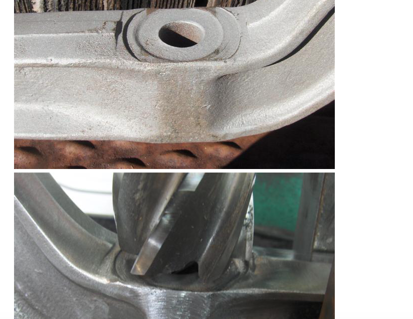

    You own a mill and a welder...... I would have welded this up and milled it back to factory fit.

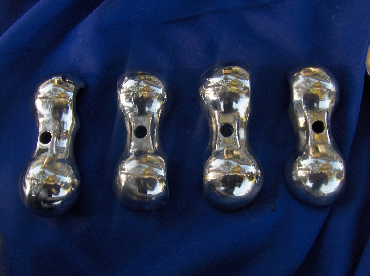

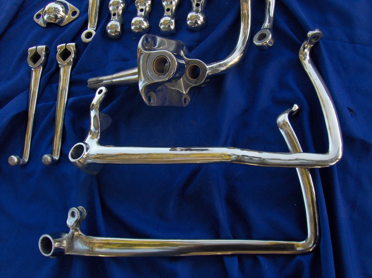

    Some smoothed out hot rod candy for a HAMBer :) Thanks for being patient all of you that have sent me work.... 007.JPG 021.JPG 005.JPG 013.JPG 015.JPG 019.JPG 003.JPG

    Beautiful. You are the keeper of my favorite OCD H.A.M.B. thread. Stop my beating heart .....

    Wowza: So that is what the metal looks like after been smoothed and polished? That's not chromed or is it?
  12. 117harv
    Joined: Nov 12, 2009
    Posts: 6,586
    117harv
    Just bare metal. :)

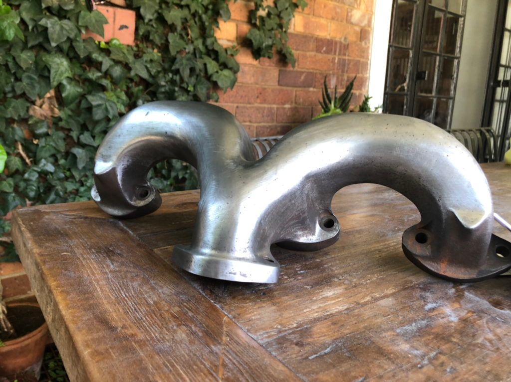

  19. This post has inspired me to do my Y-Block ram horn exhaust manifolds- thank you for taking the time to post your processes and all the pics, will be happy if I come remotely close to the level of your work. Plan to have these ceramic coated [​IMG]

    Good for you, this what I like to see. Cleaning up cast iron is messy for sure, since they will be ceramic coated you won't have to go as far I do. Post pics when they are done... :)

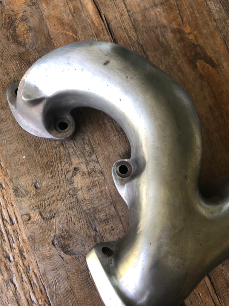

  22. Thanks! Will do. Quite an enjoyable process actually. Is there anything that you coat the parts with between sessions to help with surface rust? It’s rainy season here and surface rust starts in a few hours..

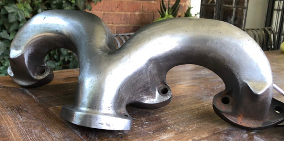

  24. [​IMG]
    Some progress on the manifolds. Find that I make a lot more work for myself using power tools from all the little gouges that they make. I probably don’t have the required finesse though!
    Been removing the rough cast surfaces with a rotary sanding bit and the rest is by hand. Still a long way to go!

    Graham, coming along nicely, you can't get impatient and skip grits, 80-120 1966319b4a17460e0b1714fb440aa296.jpg a88fc3b6970e5ed54172c23560e58644.jpg -180-220-280-320 etc. Yes, the hands /fingers are sometimes better than power tools...looking good.
