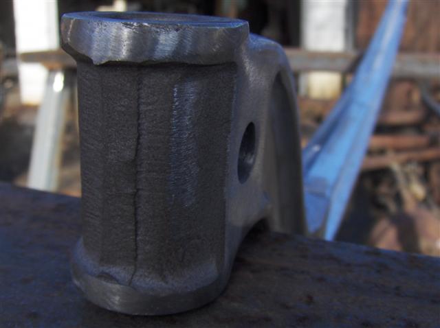

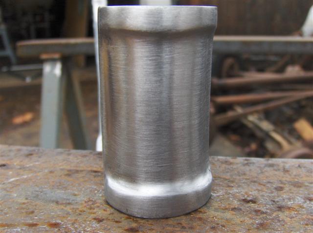

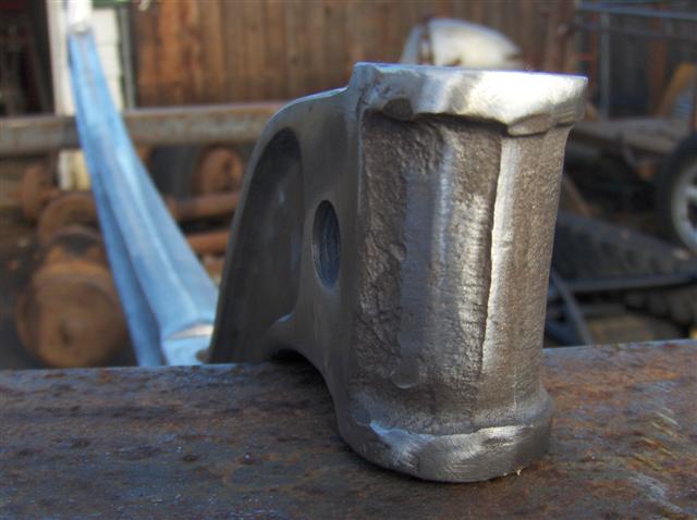

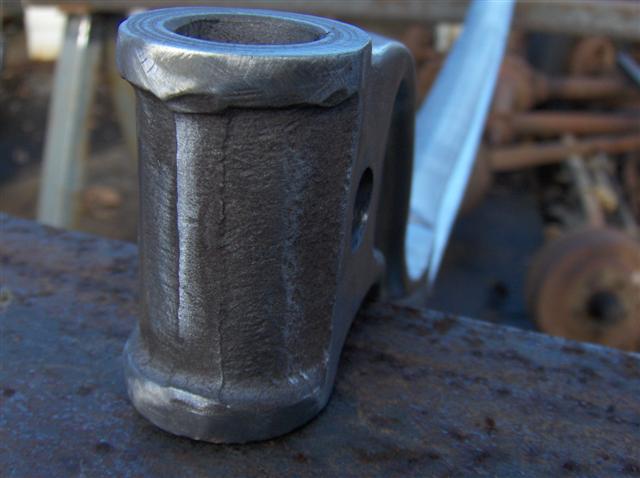

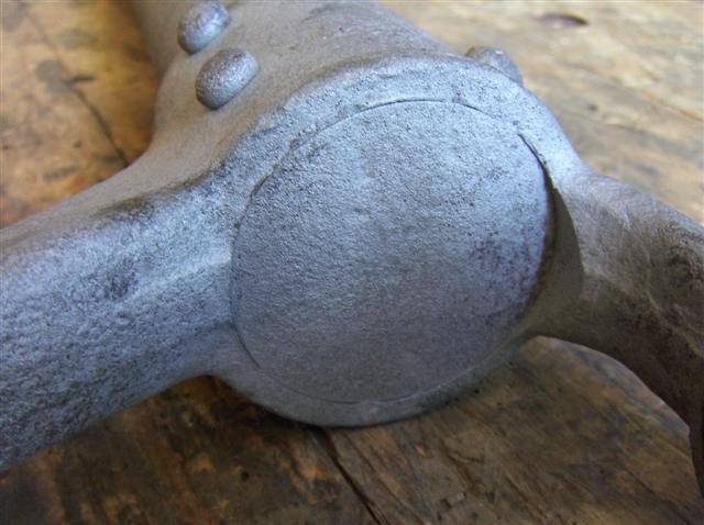

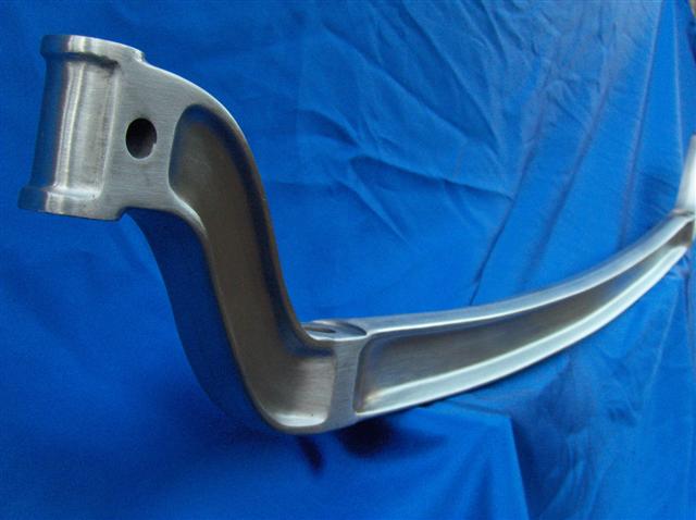

    HPIM1466 (Small).JPG HPIM1467 (Small).JPG HPIM1537 (Small).JPG HPIM1468 (Small).JPG HPIM1470 (Small).JPG HPIM1511 (Small).JPG I worked on the ends today, thought I might have to do some filling but all went smoothly...pun intended:p The first three pics and second three respectivly, are before and afters.

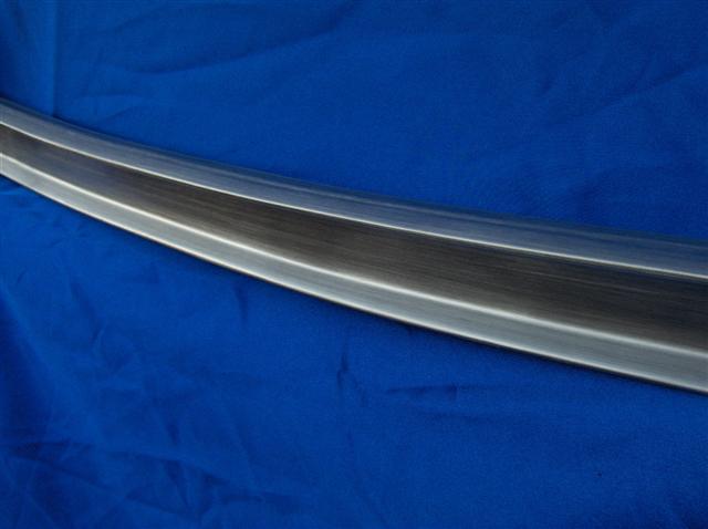

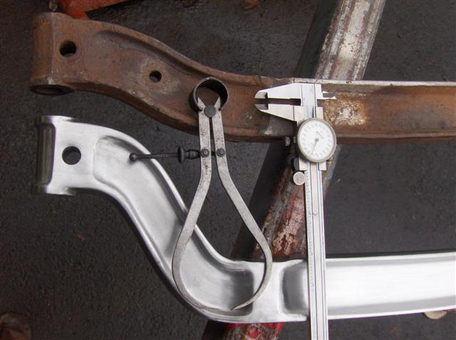

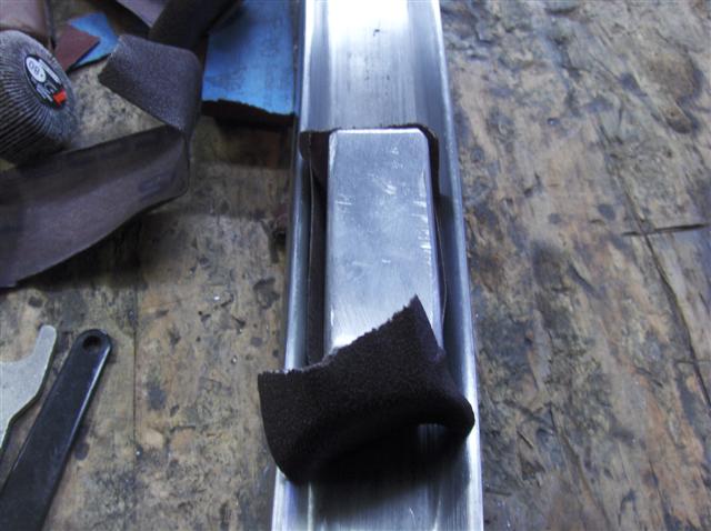

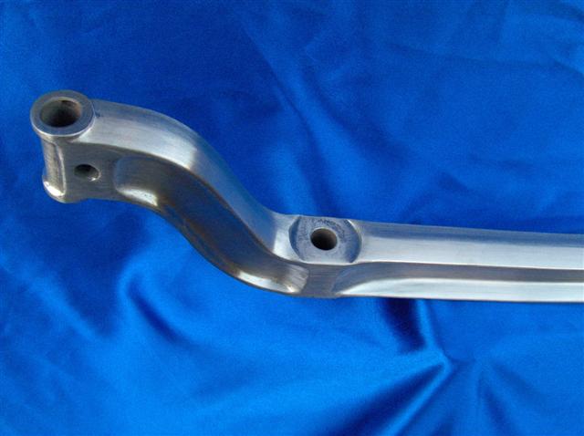

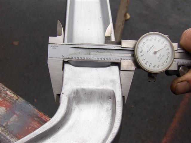

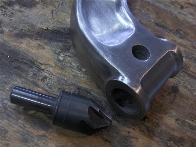

    HPIM1474 (Small).JPG HPIM1495 (Small).JPG HPIM1493 (Small).JPG HPIM1501 (Small).JPG HPIM1525 (Small).JPG HPIM1531 (Small).JPG HPIM1490 (Small).JPG To do the king pin ends I used tapered rolls, straight rolls, flap discs and scotch brite pads, followed by fingers and emery cloth. To do the recess I took a piece of cold bar the right width and tall enough to grip the emery cloth at each end. I contoured the ends and sides to fit. I used two grits of paper, the co**** is too wide and it works great to get the flat and side smoothed, followed by the finer grit.
    As for the questions about the web thickness, I used an outside caliper and checked several areas of the stock and polished axle. I used a veneer caliper to check the outside and inside of the outside caliper, before and after removal from the axles and came up with the following measurements. After polishing, the recess was 55-65 thousandths thinner depending on area measured. Factory thickness is 200-215 thick. I also used the caliper to measure the wishbone mount, you can see how much under 2" it is, chrome will take up some, but a shim will be needed. All holes will get a kiss with the chamfer bit as well.
    In addition, a stock 32 axle weighs 23.2 lbs. the polished is 22 lbs. even. I still have some minor detailing to do, but the weight should not be any less. This is the last post on the polish/tech, the final post will be the completed axle.

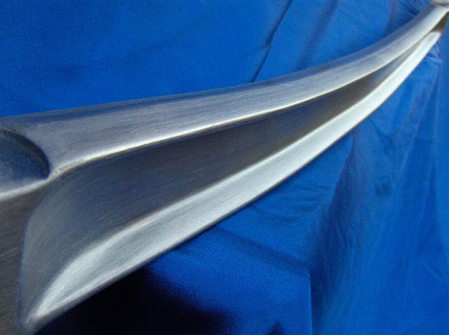

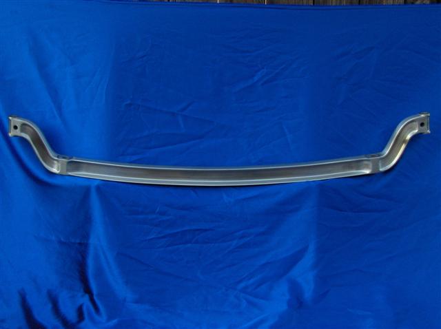

    HPIM1571 (Small).JPG HPIM1581 (Small).JPG HPIM1573 (Small).JPG HPIM1589 (Small).JPG HPIM1575 (Small).JPG HPIM1595 (Small).JPG HPIM1601 (Small).JPG Here is the final product, I have done all I can on my end, the final work will be done by the chromer. This was a m***ive amount of work, I hope it will be all that the owner expects, and lives a long life under the front of a *****en traditional hotrod...ORIGINAL parts rule!
    I would like to thank all here who take the time to take pics and do***ent their builds/tech threads. Doing a thread like this is alot of work, setting up the parts and or pieces during the process, taking clear pics, going through them and picking the best ones and adding the text. The HAMB is about sharing, and if this thread answered questions someone may have had, inspired someone to try it for themselves, or just made for a good read, than it was all worth it...thanks for all the comments guys:)

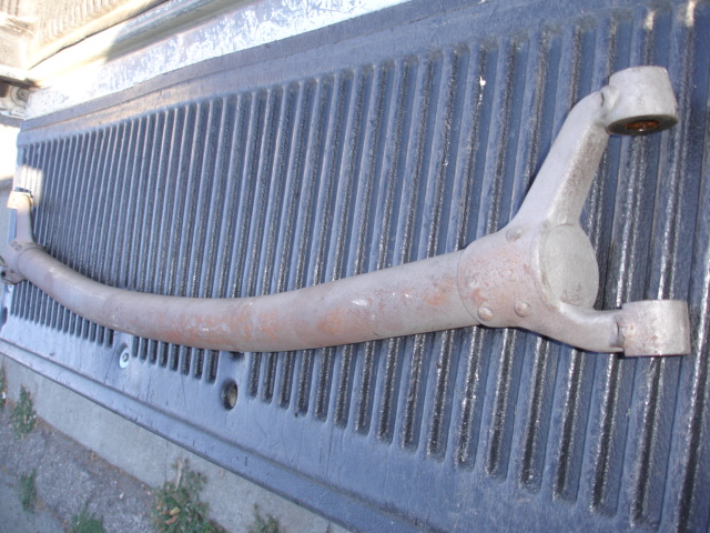

    I have another little project, I thought I would just add it here instead of starting a new thread.

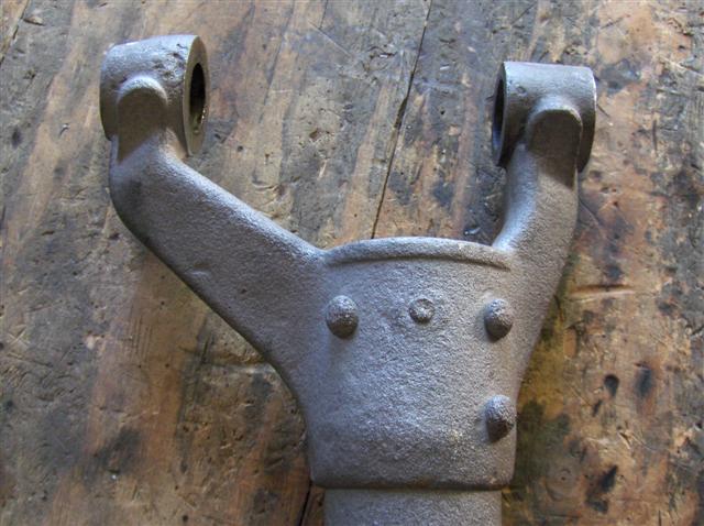

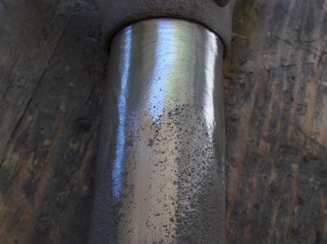

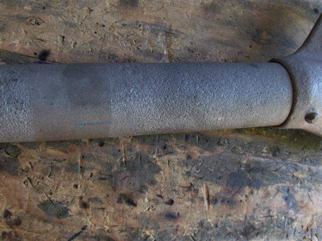

    A HAMBer asked if I was interested in giving his early Chrysler axle the special treatment, as always the answer was yes. The axle is in good shape for it's age, but it has alot of pitting. It seems that all the parts shipped to me by other members have this type of pitting making the polishing/detailing job that much more difficult....enough complaining, time to get down to business.
    Here are the first pics, as you can see I have my work cut out for me. I am useing a new type flap wheel that is exspensive, but man does it cut. I ran the first p***es up against the forgings, the flap wheel has a nice square edge and does a great job. I polished around the tube in this direction untill I was about 3 inches away from the ends and then started polishing lengthwise on the tube so I wouldn't buzz into the forgings and make a gouge that would be difficult to repair. There is a small peg on the ends in between the rivets, more on this later.
    Pics coming in the next post.
