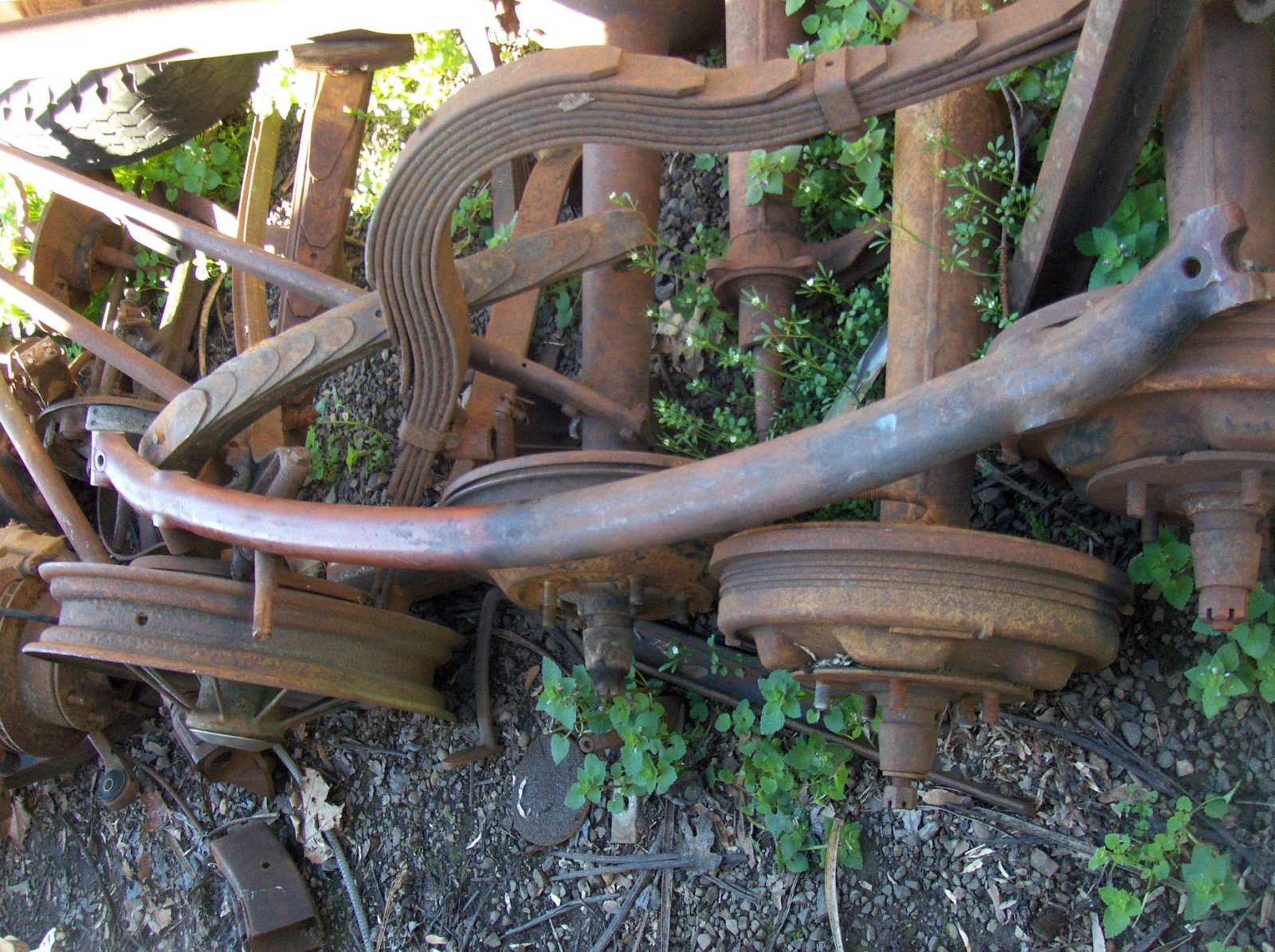

    After a long adventure filled trip, this V860 axle arrived at my door from a fellow HAMBer. The axle was going to be drilled and sleeved, but will just get the full polish treatment now. It looks to be in great shape, took it to the blaster earlier today to get cleaned, will be back tomorrow and the work begins. Pics next.

    Looking forward to another great project. Has anyone found out why the ends on a '37 tube are left open? Bob
    117harv likes this.
  16. 117harv
    Joined: Nov 12, 2009
    Posts: 6,586
    117harv
    ^^^ I have wondered about that, I think there is a thread on here somewhere discussing the manufacturing of these axles.

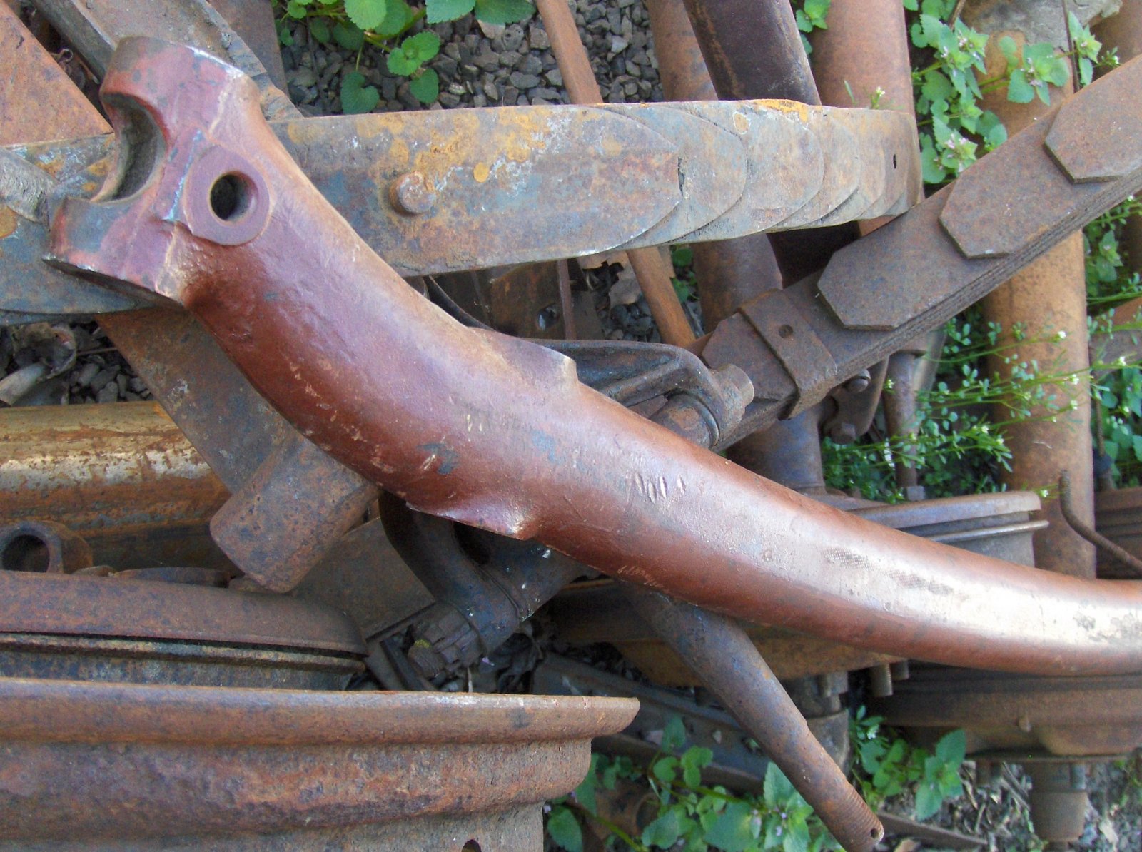

    Picked up the axle from the blaster today, looks like it's in great shape. Pics next.

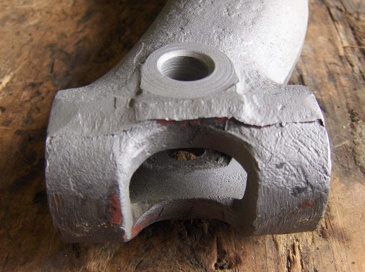

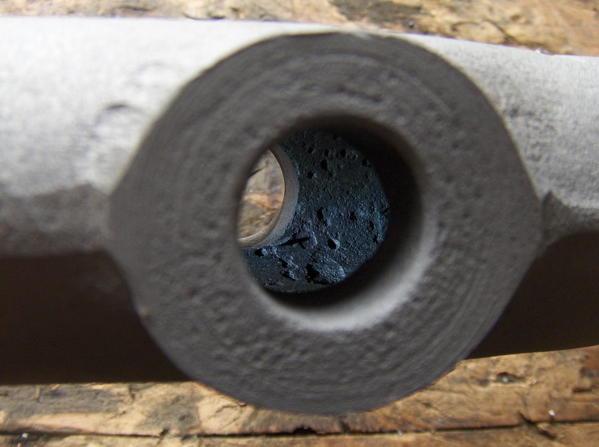

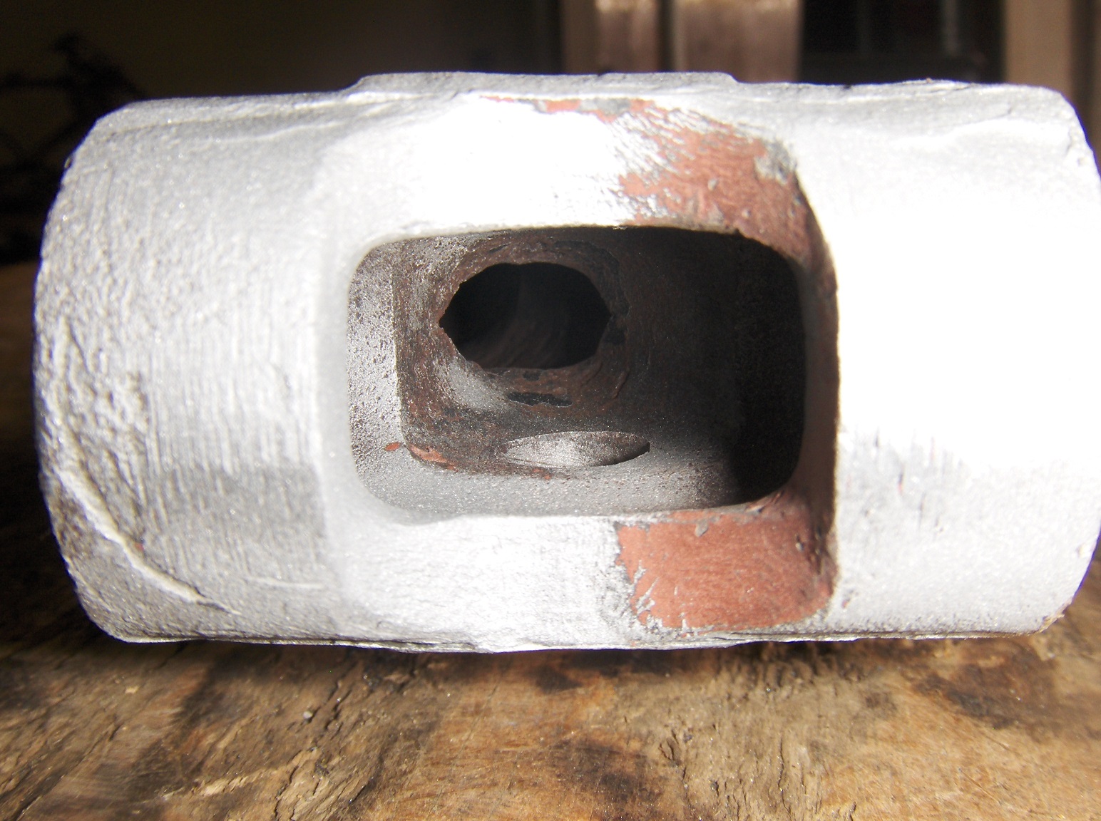

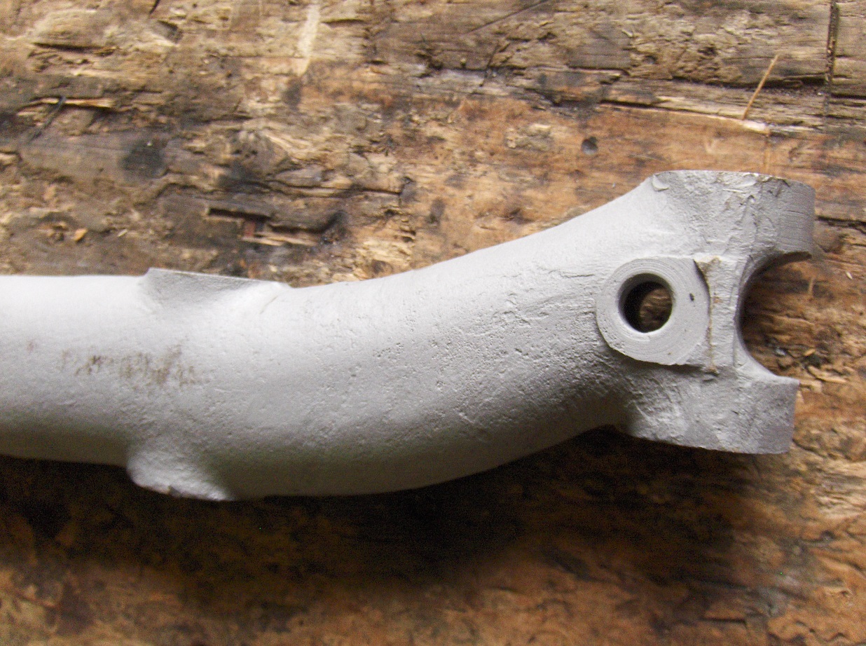

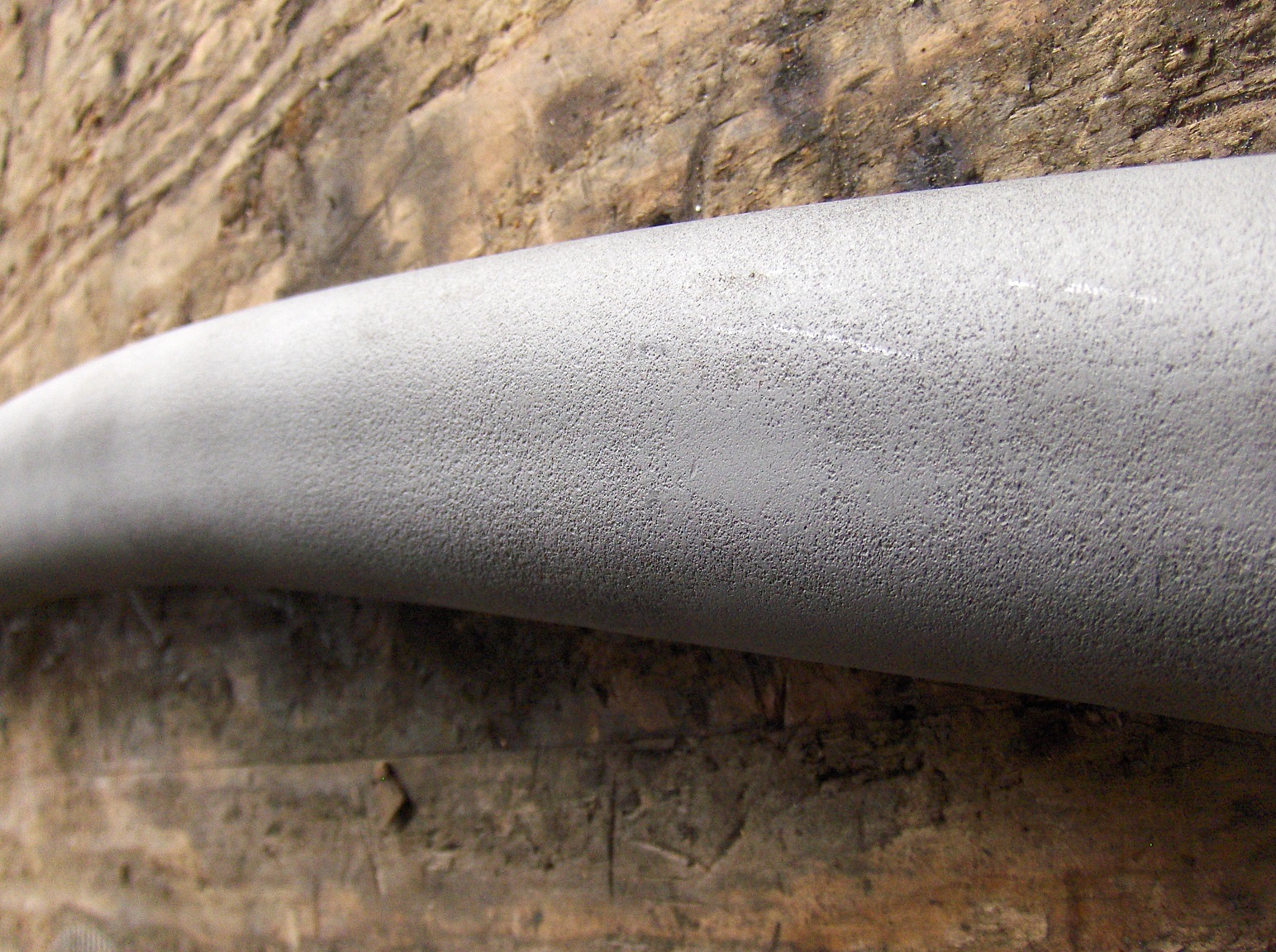

    There seems to be no clear answers as to how these axles were made, lots of speculation, but who really knows. It took many tries to get these shots, these were the best I could get. The pic that looks like the surface of the moon was the top, the lower edge looks to have a weld joint? Looking in from the ends, the wall is thicker than the tube in between the wishbone mount as would be expected as it's has the most stress. It has the ground area where the Rockwell test was done as all early Ford forged parts have. I just ran the grinder over the side to show the low recessed area, again how was this made ? Anyway, time to make it shine, will have progress pics tomorrow.

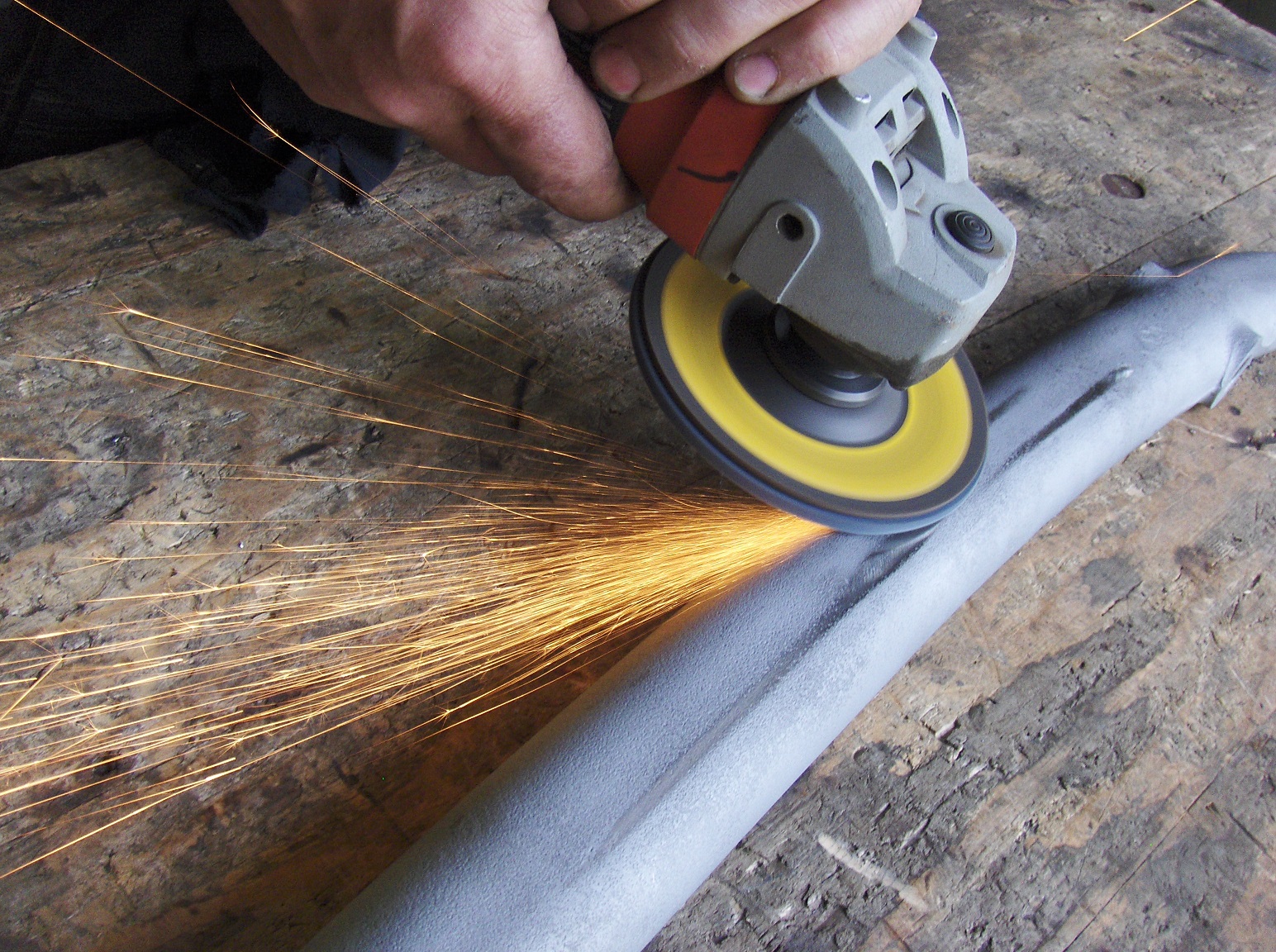

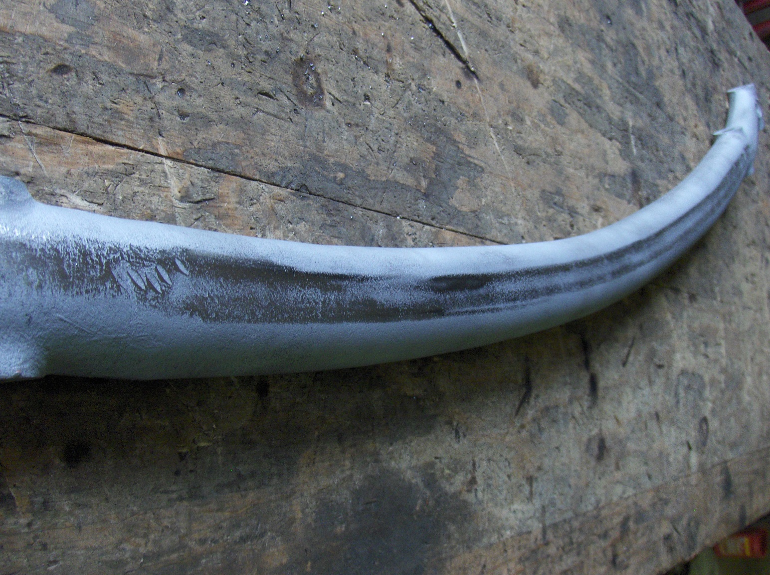

    Made some progress today, the axle is in good shape for it's age, but as always there is some pitting. In the second photo it looks like a shadow line but is the difference in flap wheel grit, rough first to cut, then finer to smooth. After doing this for so long, I can tell when a blem or low spot just wont go away and will need to be filled. I'm showing only one spot, but there were several that needed filling. Also, I thought I could keep the milled pad for the lock pin, but after smoothing it/them out there wasn't enough left to detail, so they got blended. Next is detailing the ends with small screw lock discs, graduating grits...more in the next up-date.
