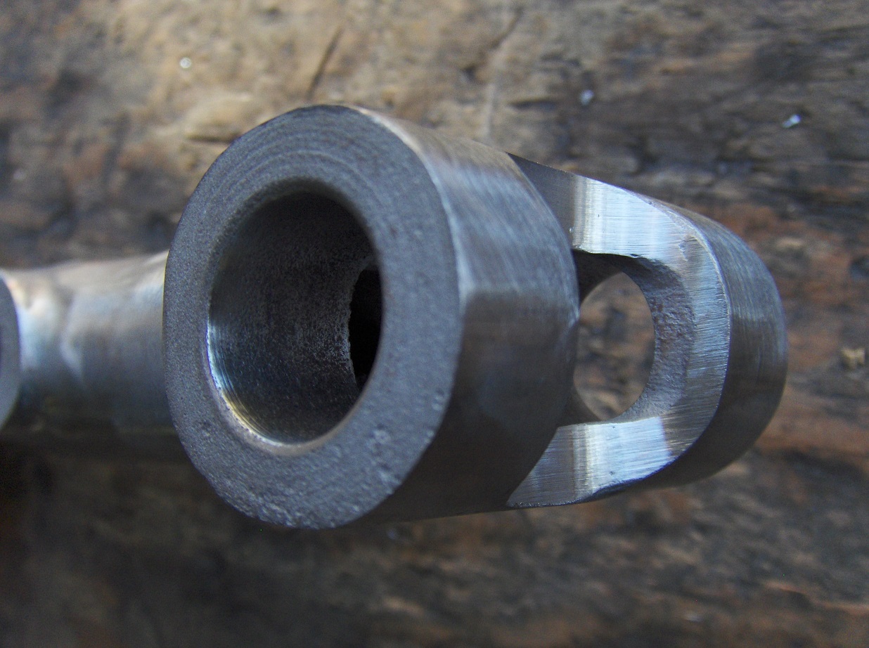

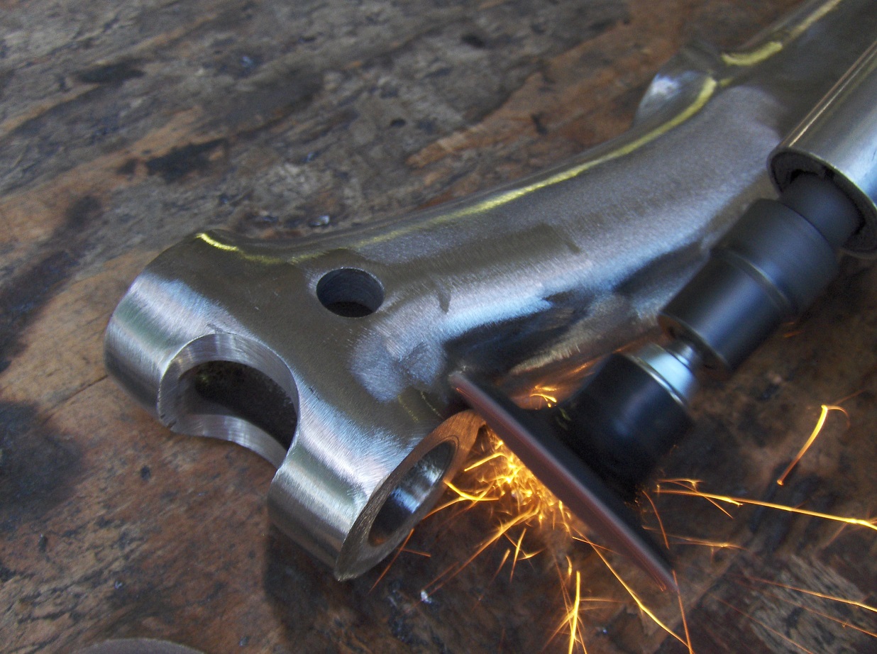

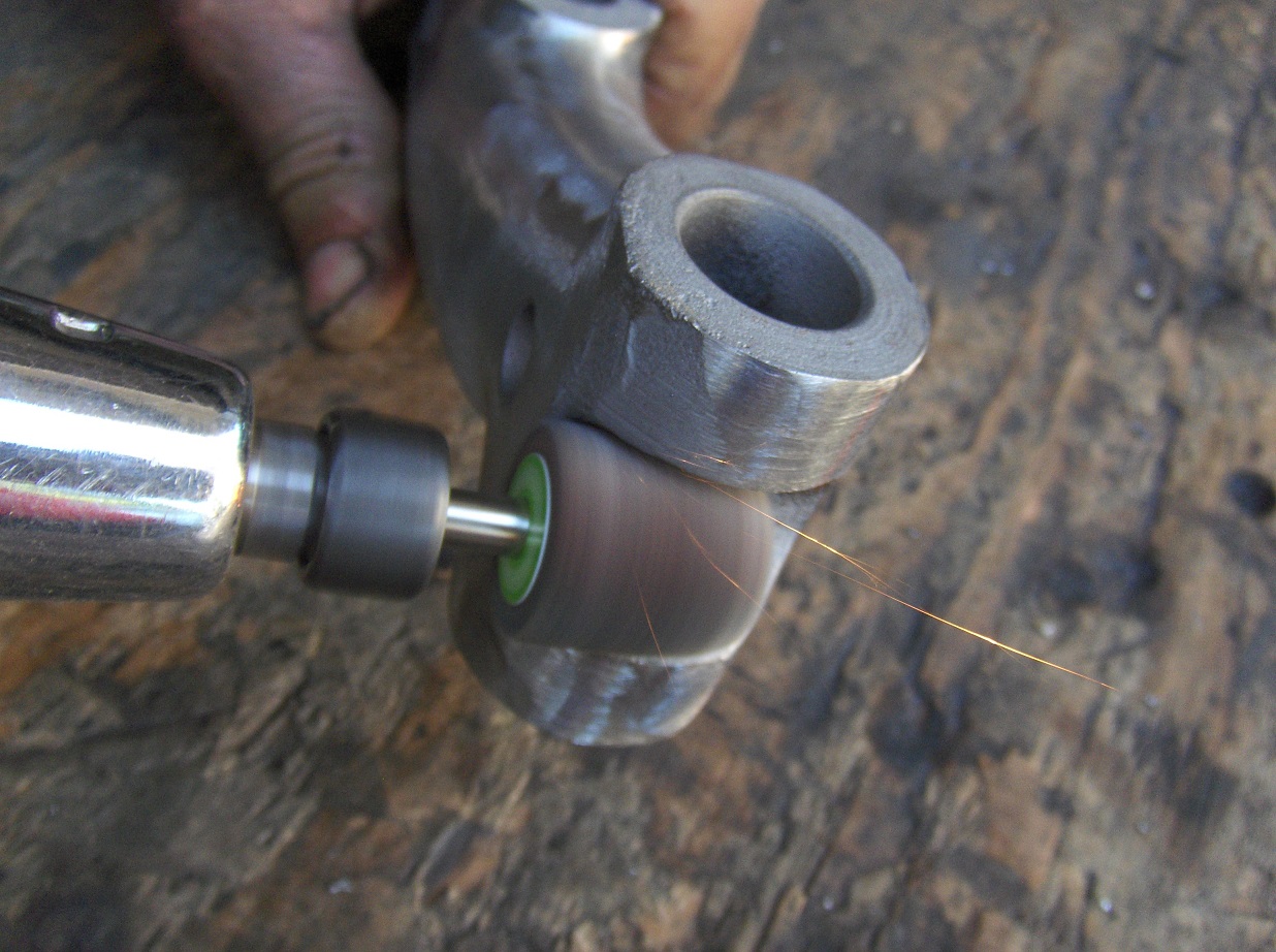

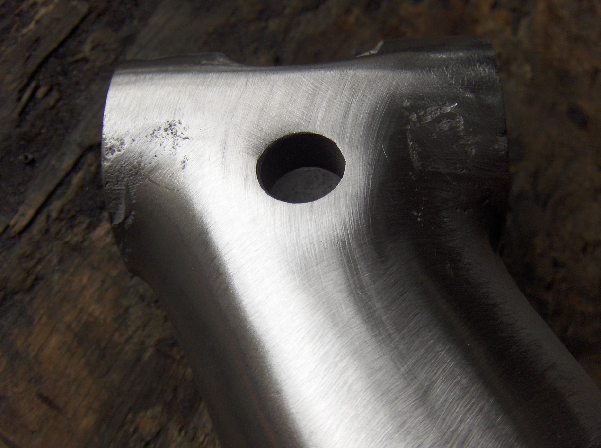

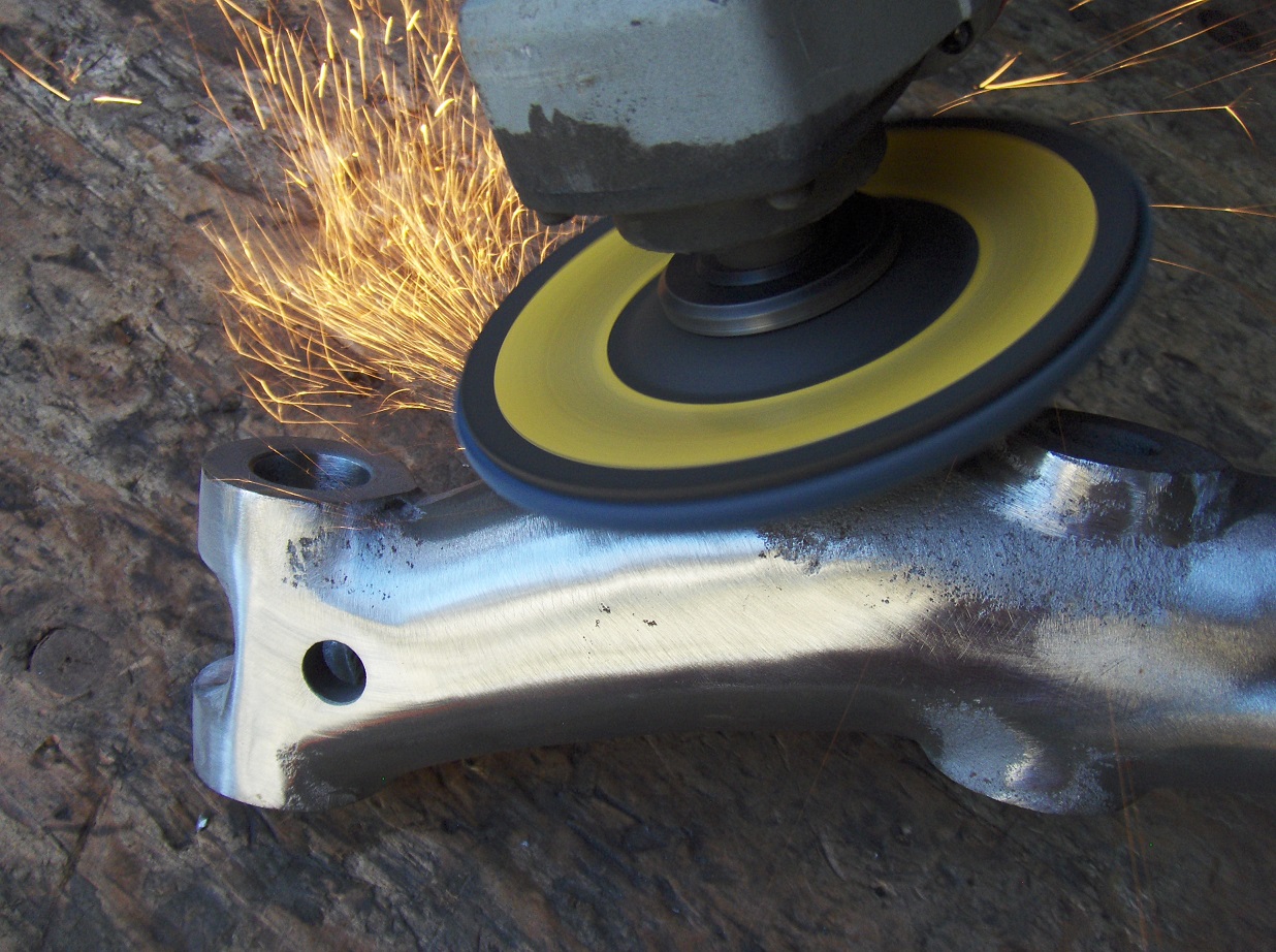

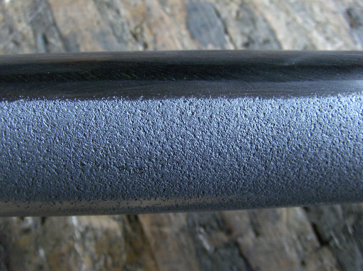

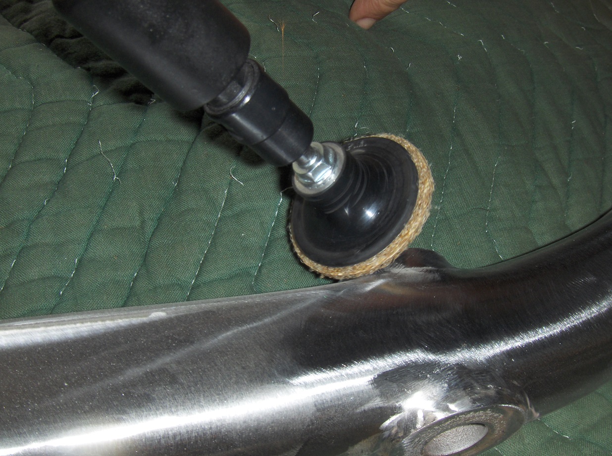

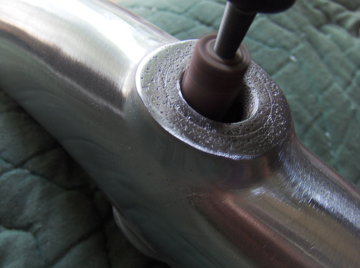

    I used a flap roll and detailed the coves on the king pin bosses, there is a small area that didn't get cleaned up, that will get smoothed with one of my small abrasive rolls. I also ran the same roll down the king pin bore just to knock the texture down abit and clean it up.
    To detail the ends, I use the large flap disc and get as much of it smoothed as I can, being careful not to hit the wishbone mount or pin boss. I then switch to the small screw lock discs and carefully detail around all the tight areas, checking often with my hand to see where more needs to go or a low spot needs to be blended. Some hand sanding with emory cloth and a sanding block will be needed before the final detail....coming along :)
    On a side note, from the wishbone mount in about 6" toward the center on both sides, the tube is squished and wavy from the manufacturing process, more on this later.
    Pics in next post.

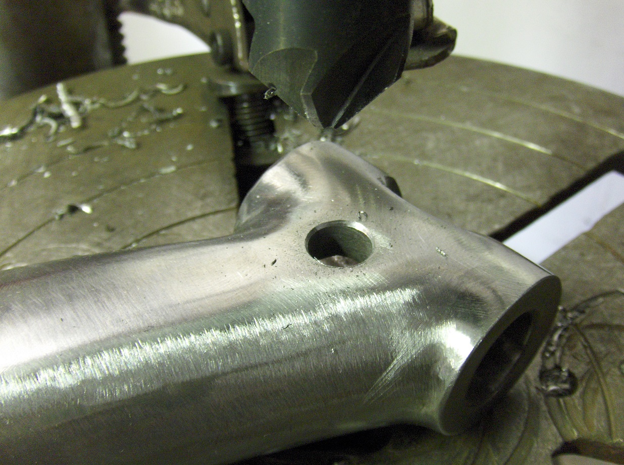

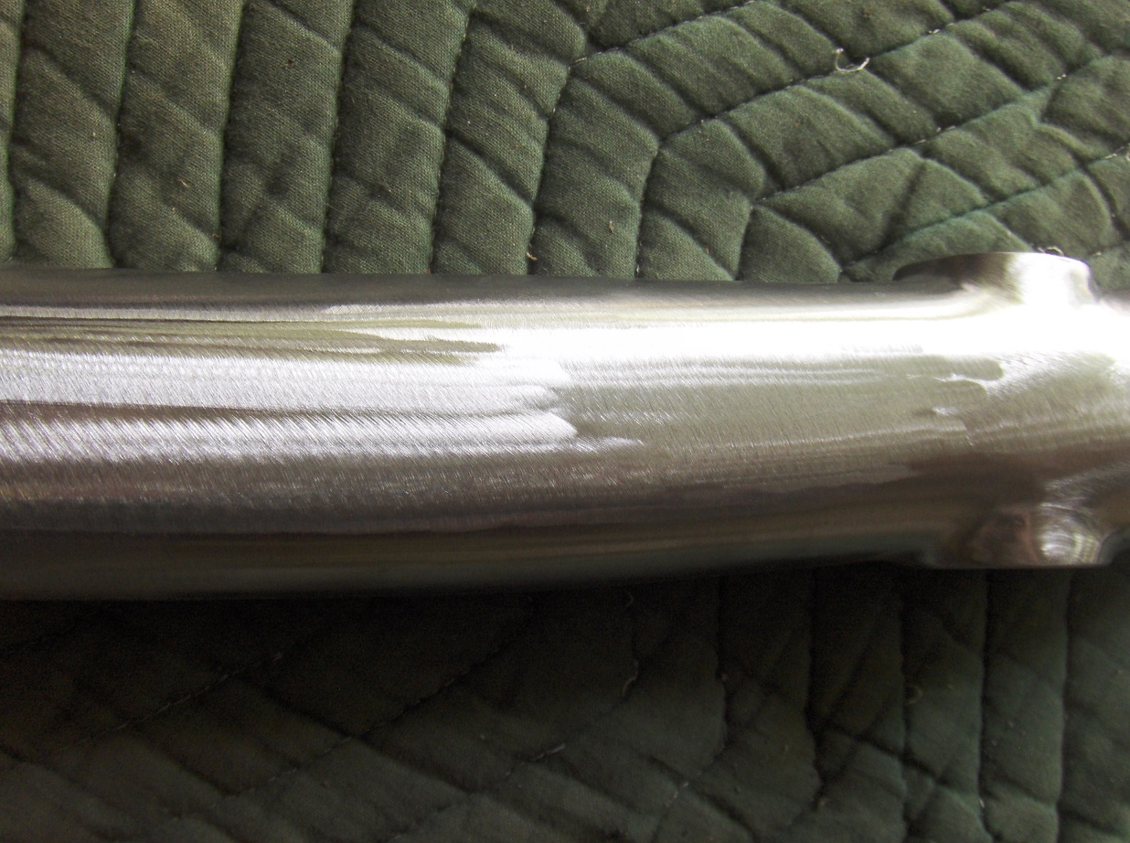

    I use the small pads to get tight areas detailed, then the larger as is flexes around the contours. I also smoothed the small areas in the king pin bores, as well as a quick smoothing of the wishbone bores....getting close.

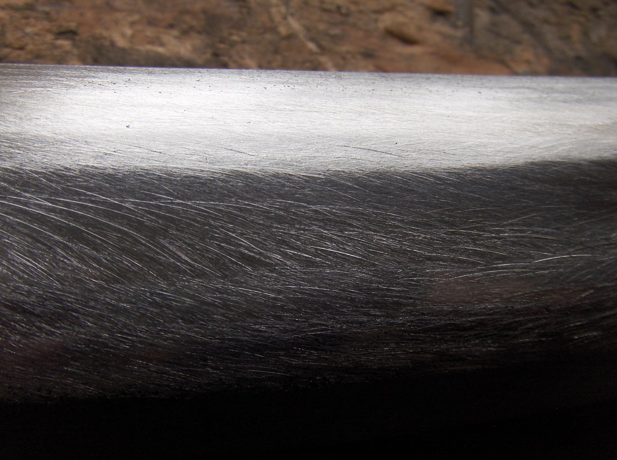

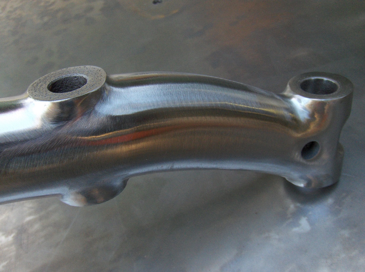

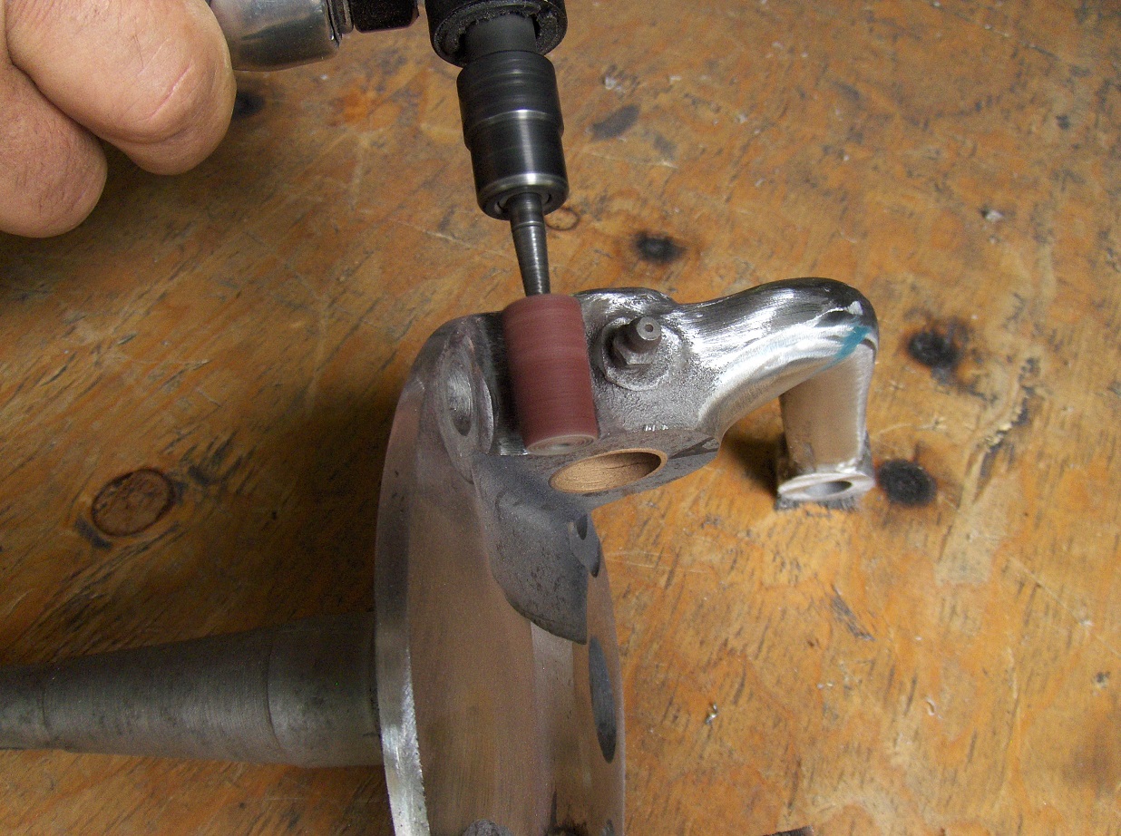

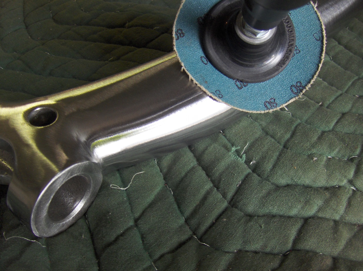

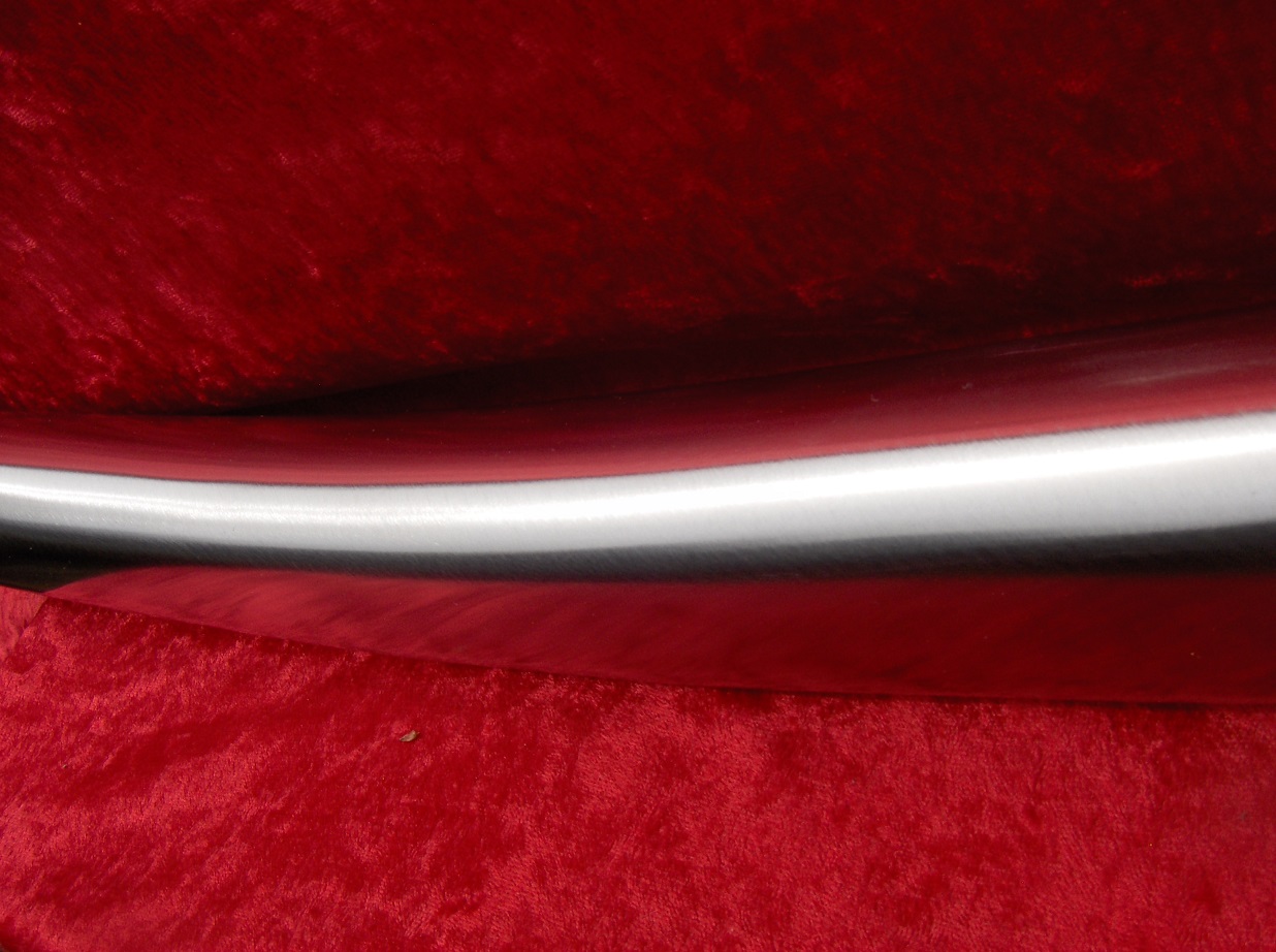

    After the abrasive pads, I switch to a Scotch Brite pad for the tight areas, small first and then to larger as it flexes to the contours like the abrasive pads. I gave each hole a very light shot with the chamfer bit to knock the sharp edge off. I mentioned earlier that the area from the wishbone mount in about 5 inches is wavy from the manufacturing process, the ends were too. After careful work sanding and checking often they came out pretty good. A new big co**** Scotch Brite pad to remove deep scratches and then on to the finer...

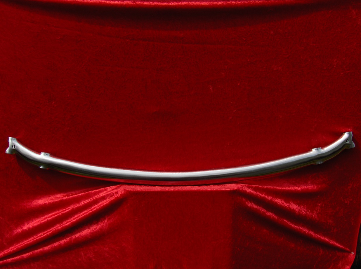

    Here is the final product, abit easier than an I-beam but still with it's challenges. The wishbone pads as well as the king pin ends are not round, but to take more metal off to get them round would make the area weaker. As always there are minor scratches but the vast majority of the work is done and the chromer will have a much easier job getting it prepped. I would like to mention that even though the parts I have shown in my threads will be chromed, they don't have to be. On an open wheeled hot rod the ch***is is out for all to see, prepping the parts like this would make paint look that much better. As always, thanks for the kind words, and I hope I have inspired you to try this yourself :)

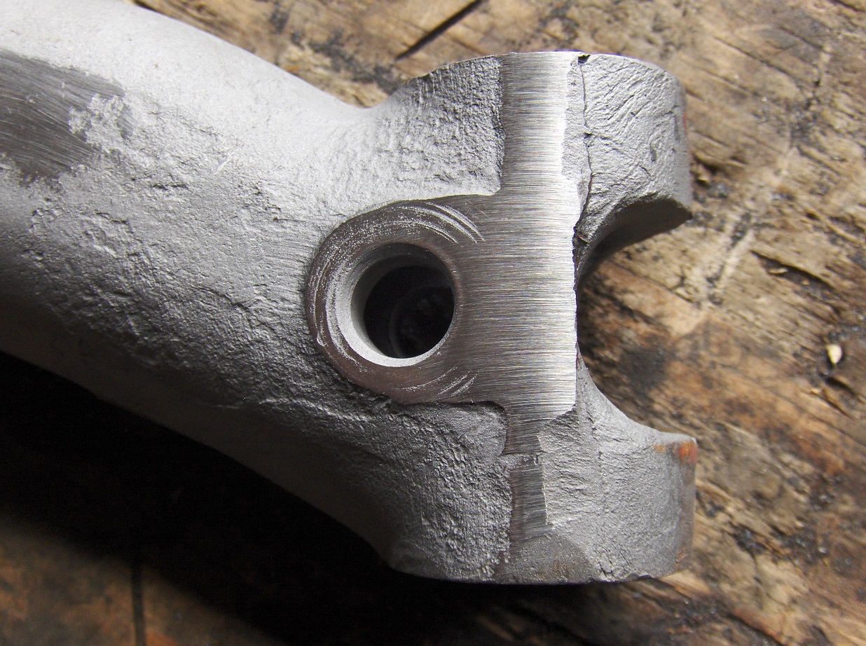

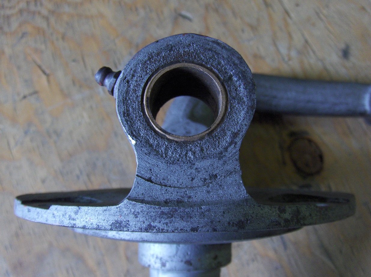

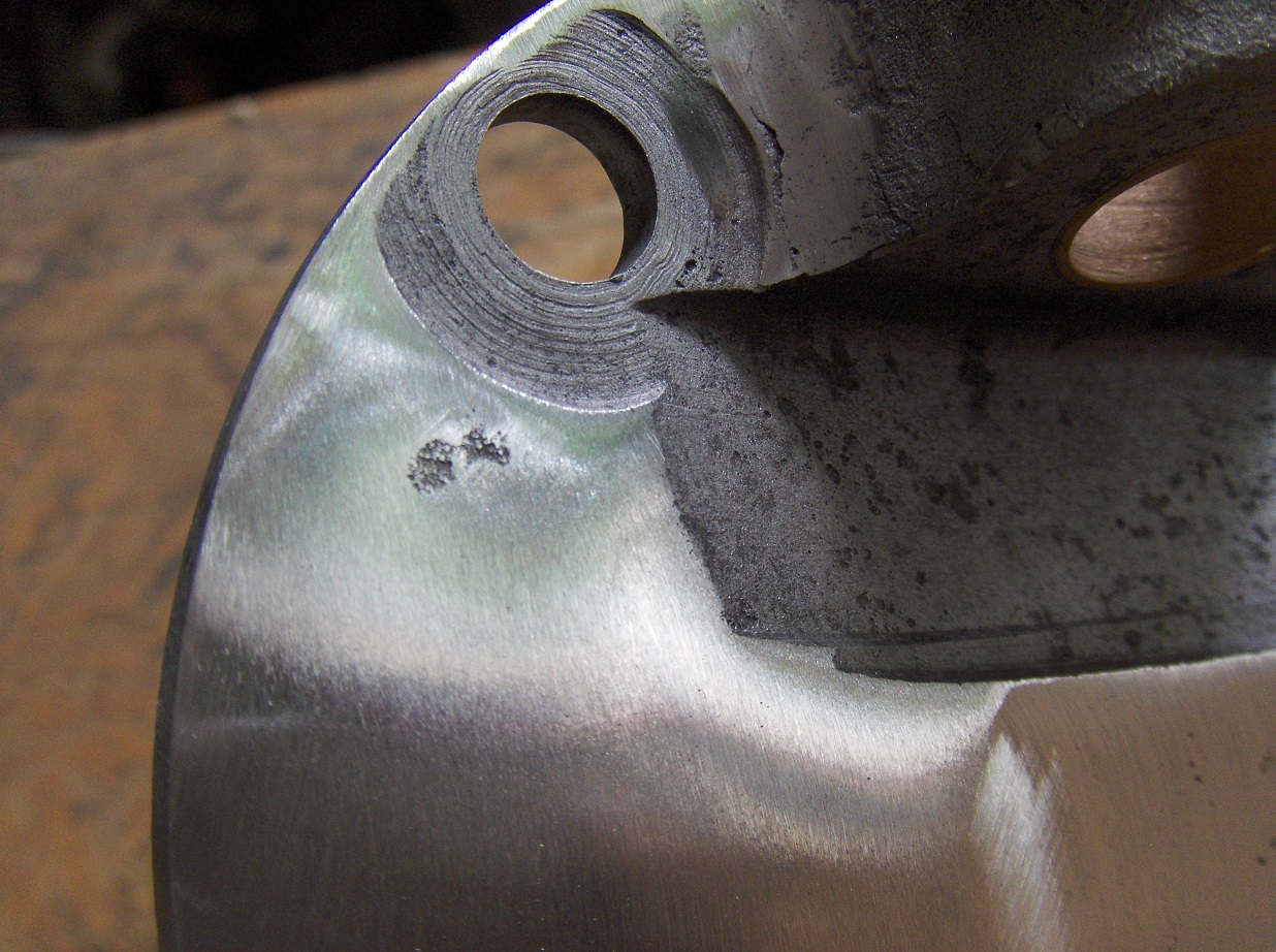

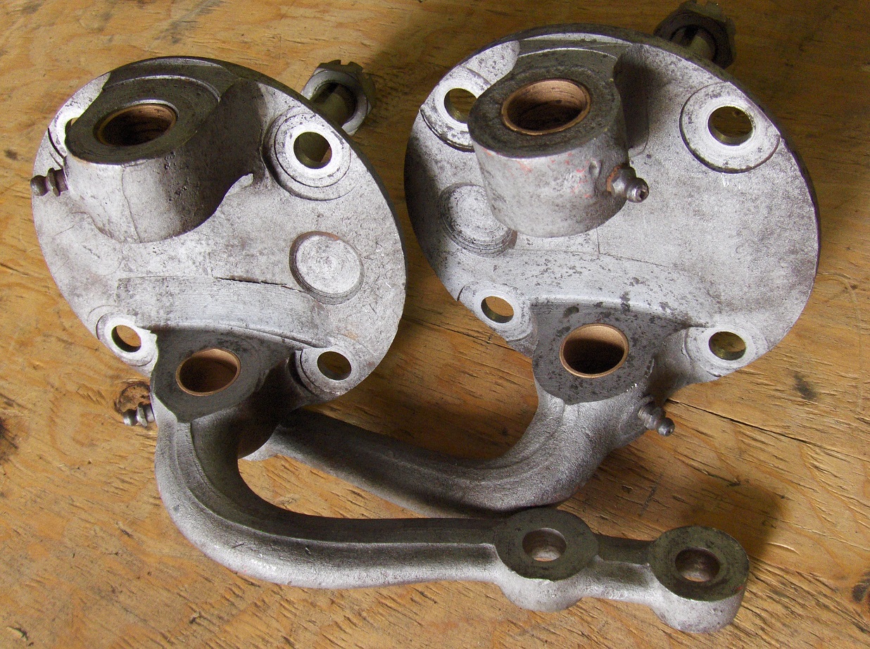

    I had some round back spindles sent to me from a HAMBer for the treatment, thought I would add them to the axle thread.
    The spindles are in decent shape, seen better and worse, minor pitting and misc. nicks and gouges. I start with a flap wheel and level off the tops, the flat surface going into the round edge makes for a strange transition, but will smooth out nice. After smoothing some minor pitting still remains, it will have to be filled with copper.
    Pics next post.

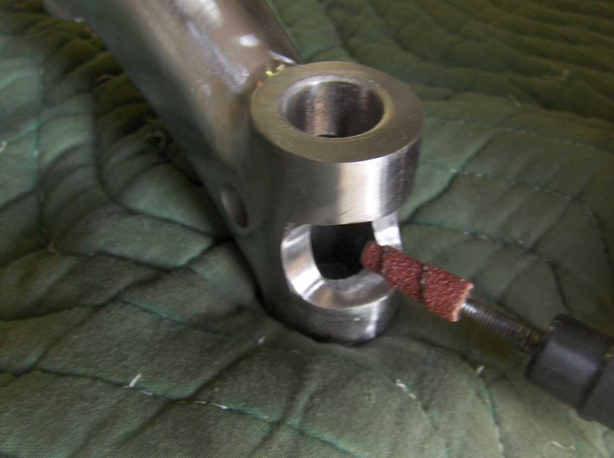

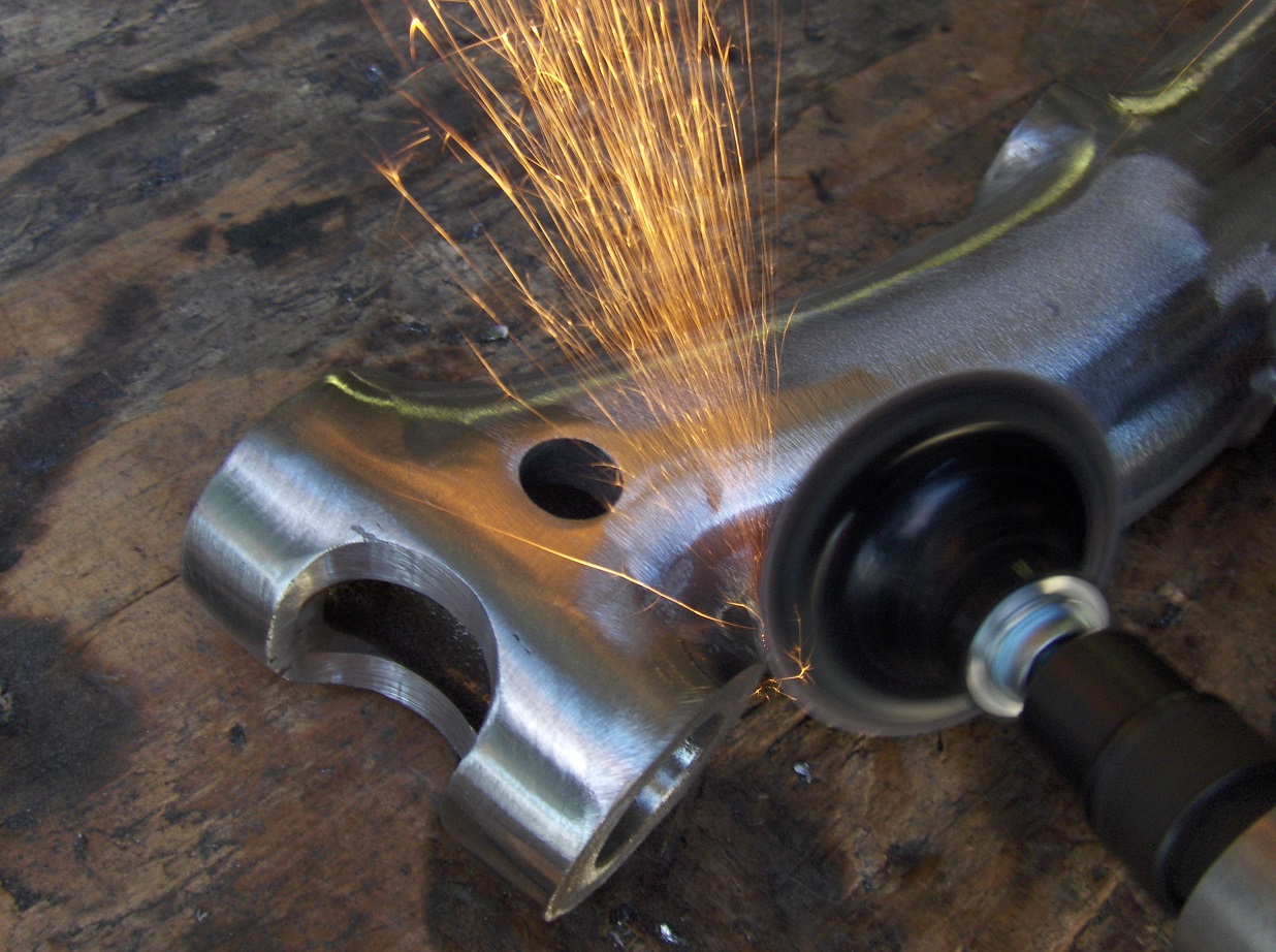

    I used small round and tapered rolls for the tight curved areas and a carbide bit to remove a large mound of metal from the forging below the top king pin boss. There was a small low area that needed filling, welded it up and ground it flat.
