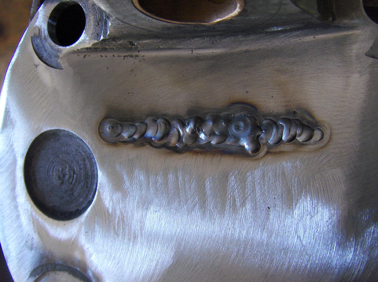

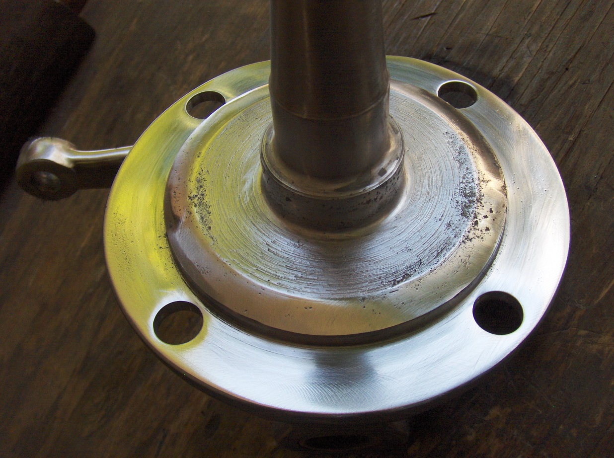

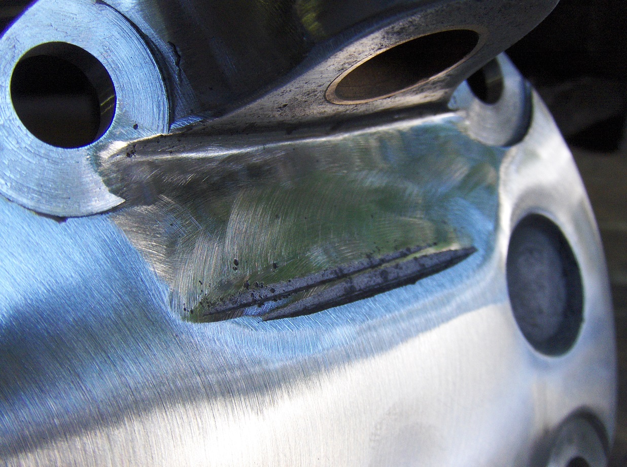

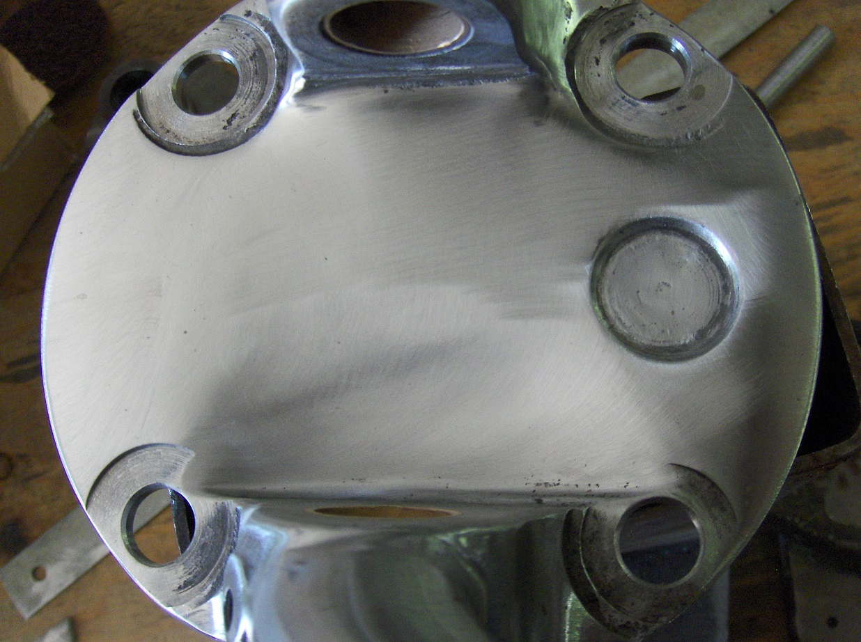

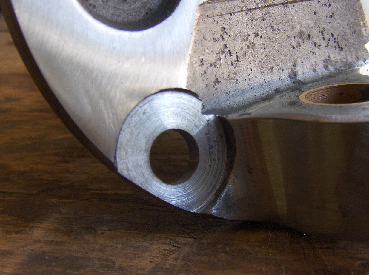

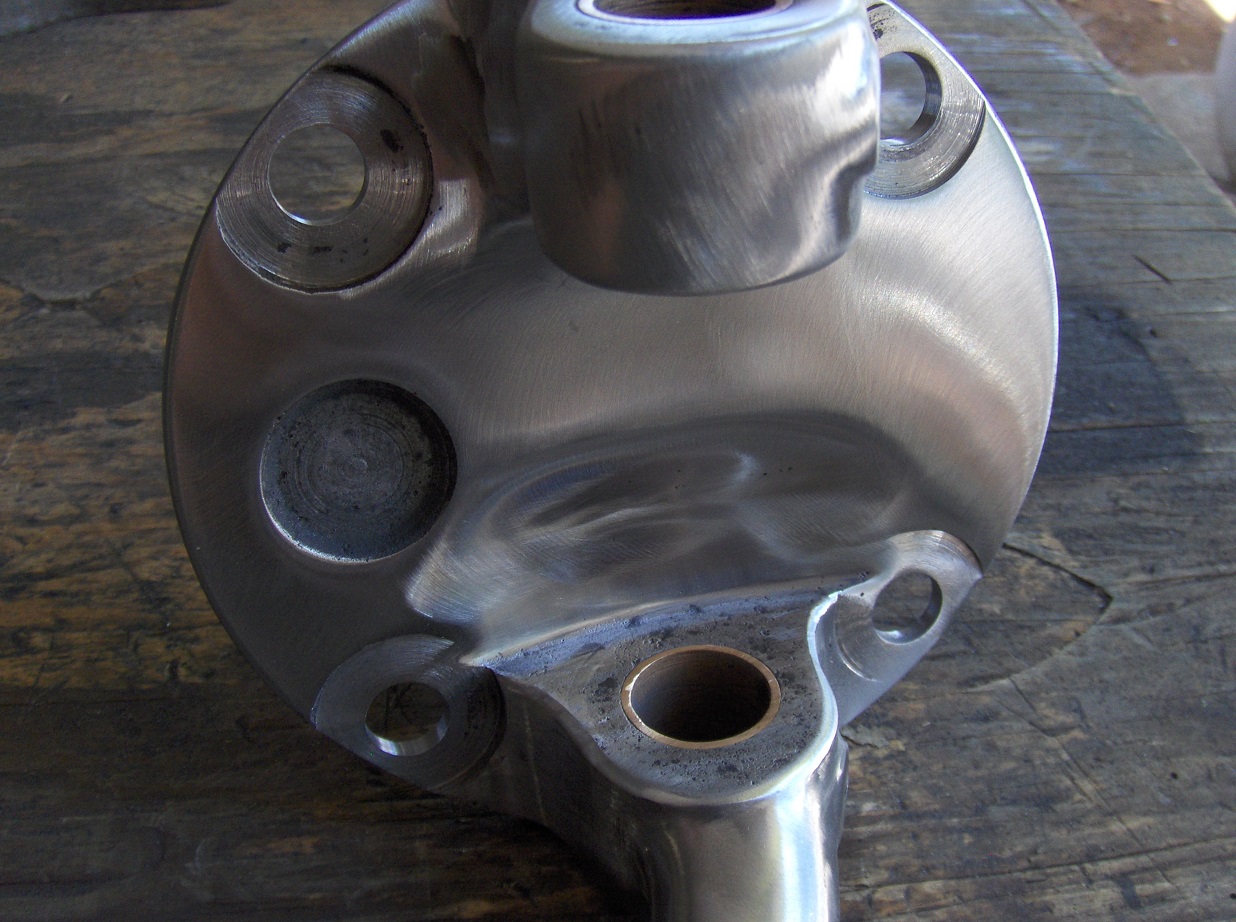

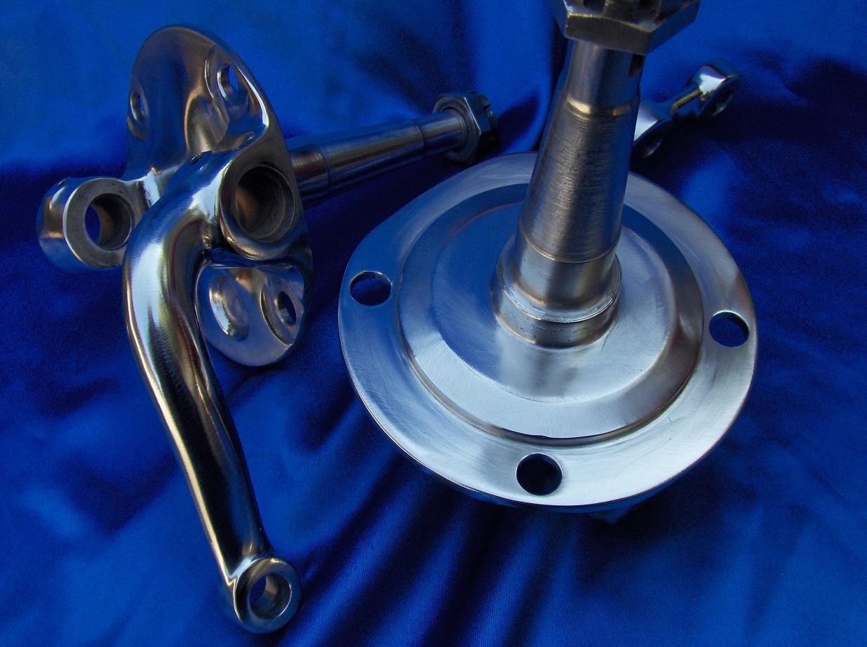

    As often is the case, my small weld wasn't enough, a small spot still remained. I didn't have the clamps needed to set the spindles up in my mill, so I gave them to my buddy who does all my machine work. After abit of set up he spot faced all the recesses where the backing plate bolts go, they didn't get completely clean, but look much better. The area where the spindle was machined for axle clearance at the factory bleeds into the recesses, nothing I can do about that, will just blend and smooth.

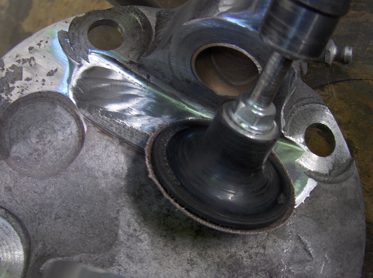

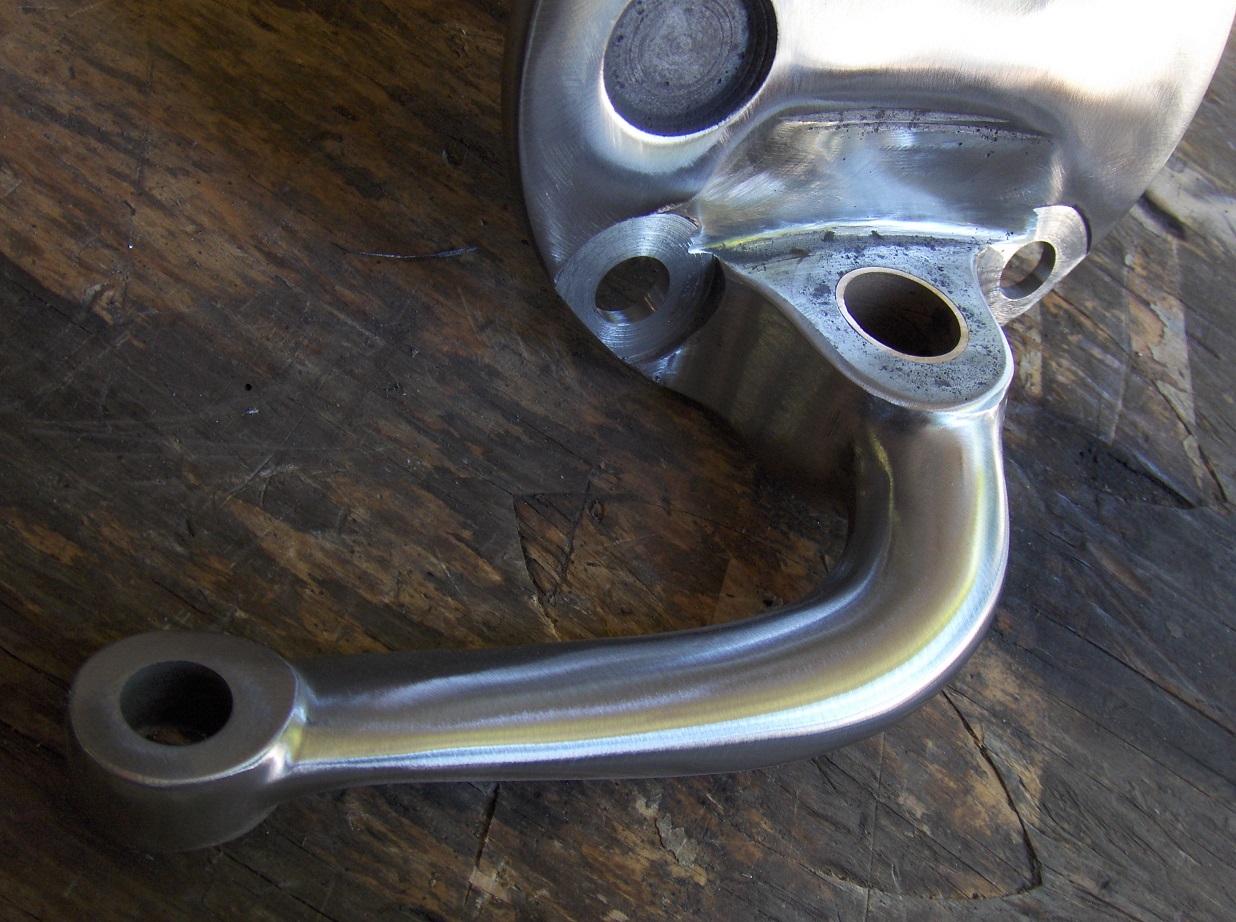

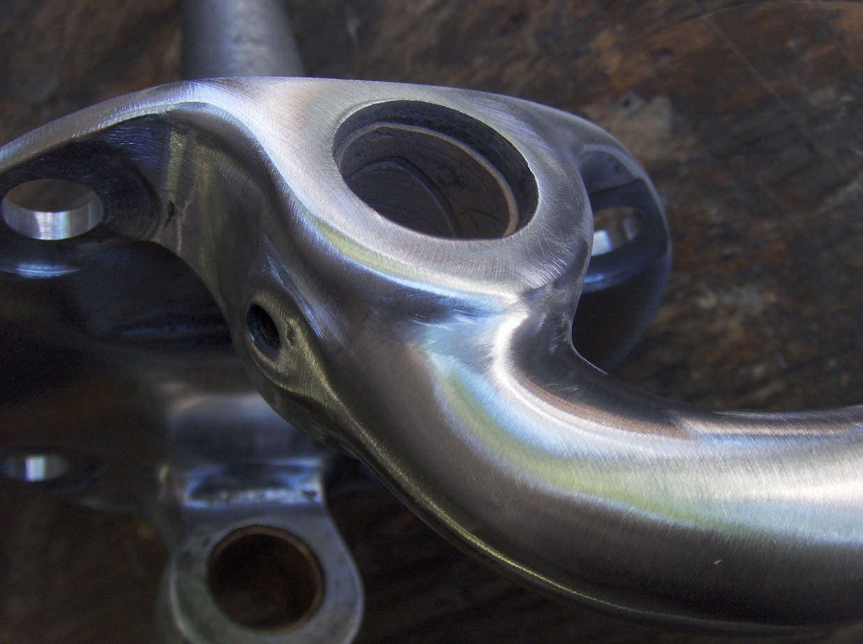

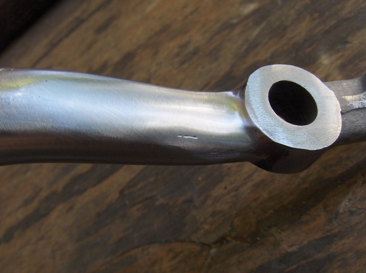

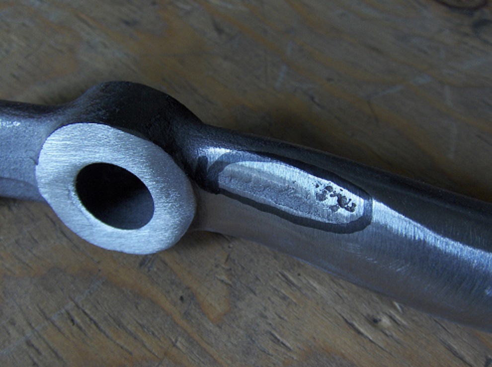

    Using an angle air sander I use small discs to smooth out the under cut for axle clearance, this takes awhile. It's getting closer, and the small discs lose their cutting ability in short order, so it takes a few of them. I detailed the ends of the arms where the tie rod attaches, I left the tear drop shape just smoothed and blended them.

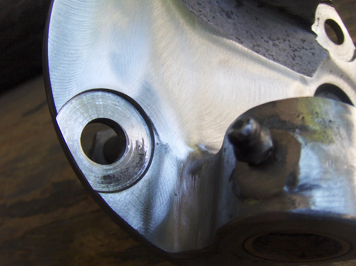

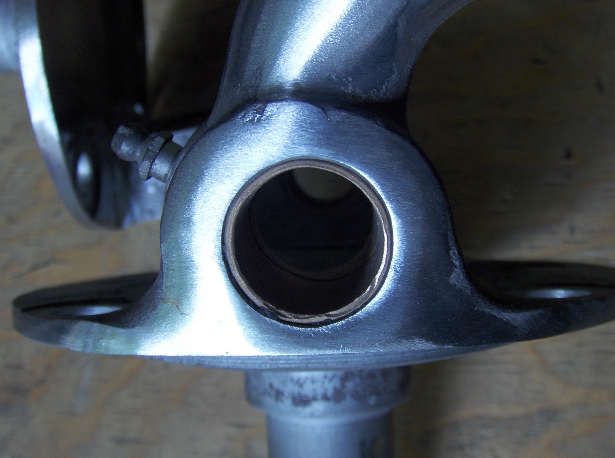

    The under cut is fully blended, and the area that I used the carbide on under the upper king pin boss is as well. All the edges have been rounded, there are still some small spots that need attention. There is some minor pitting that will stay as trying to fill would difficult. The small circle where the steering stop hits will get detailed with some small tapered rolls.

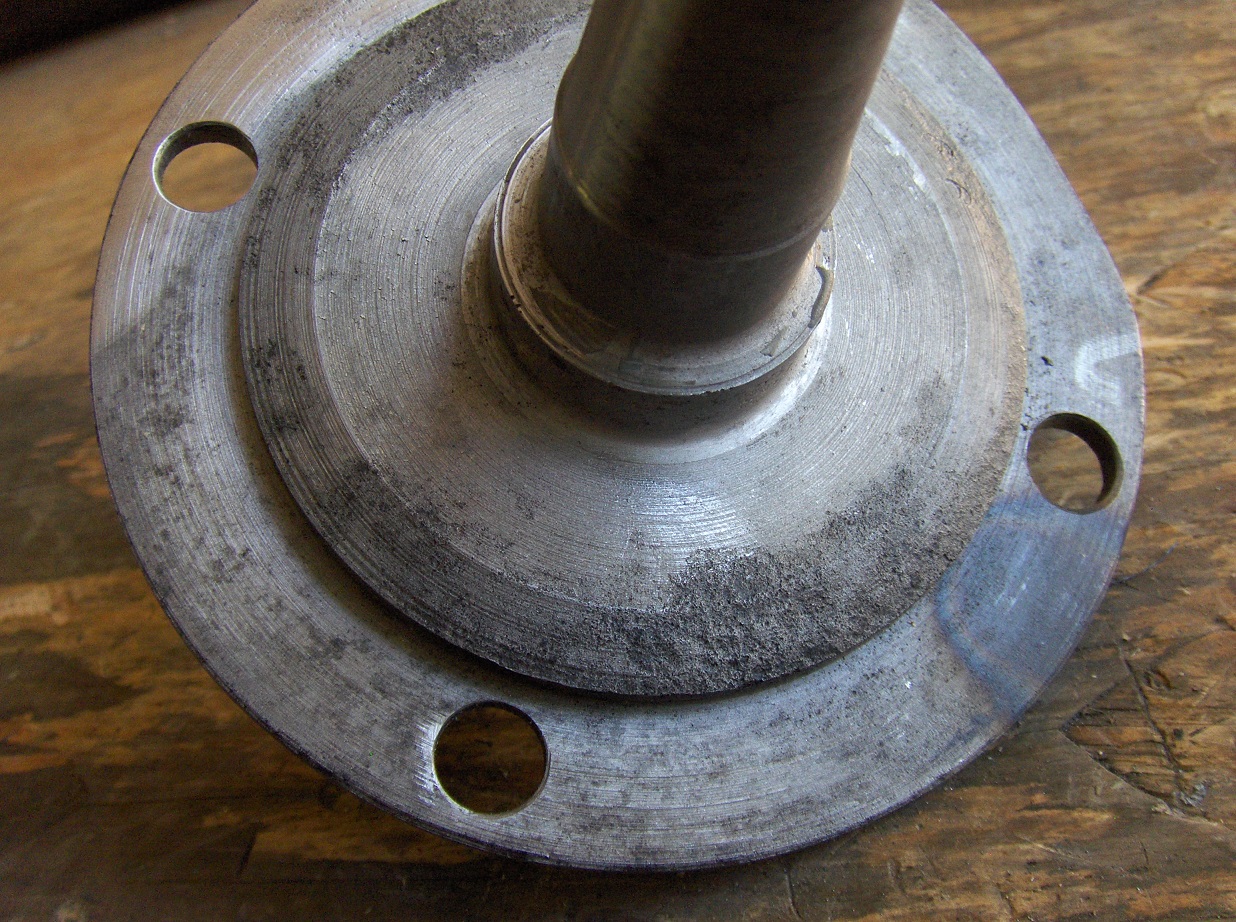

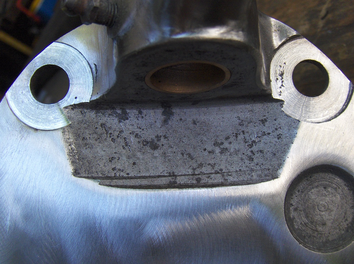

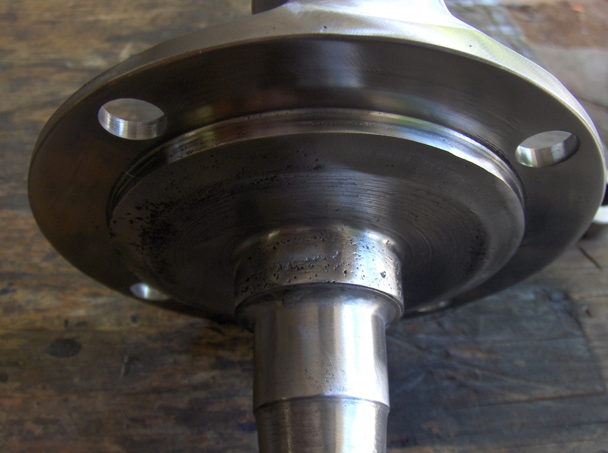

    The back sides have some pitting, even though it doesn't show, I did some minor clean up. I removed most of the machining marks and smoothed out the pitting. I used a fine Scotch Brite pad and gave the bearing and seal surface a quick clean up. The seal surface does have some pitting, and if this was an all weather daily this might need a turning and or sleeve, but will be fine as is.

    Beautiful work as always Harv, what is your plan to restore the seal surface ?
    117harv likes this.
  23. 117harv
    Joined: Nov 12, 2009
    Posts: 6,586
    117harv
    That's up to the owner, I think it's fine as is. Maybe when they are chromed they can fill it with copper.
  24. 117harv
    Posts: 6,586
    117harv

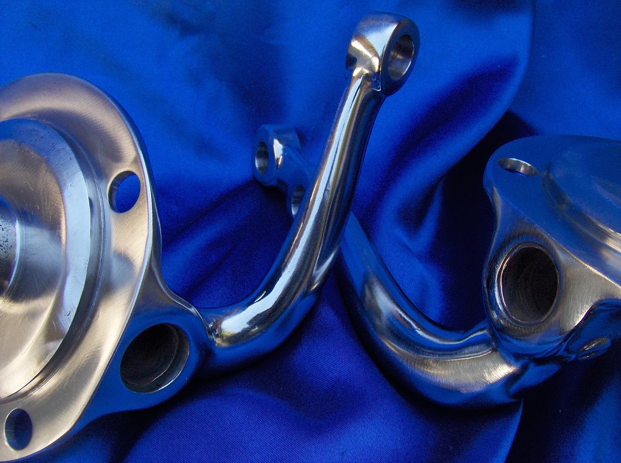

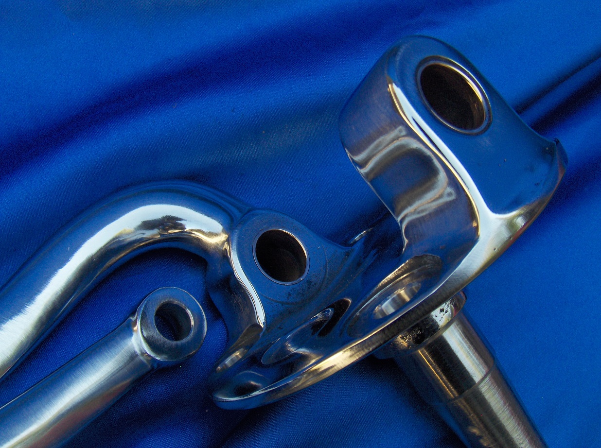

    The under cut on the other one was too deep to sand out, so I took it down as far as I could and filled with weld. As always I had to do it several times, but it came out nice. I chamfered all the holes, and smoothed them up as good as I could with the small abrasives. Being these are so intricate and hard to polish, I went over to a friends and used his buffer. I used two different compounds, they still need some more polishing but came out pretty nice.
  25. 117harv
    Posts: 6,586
    117harv
  26. 117harv
    Posts: 6,586
    117harv
    Here they are, they still have some fine scratches that the chromer will have to polish out, but they came out pretty good.
