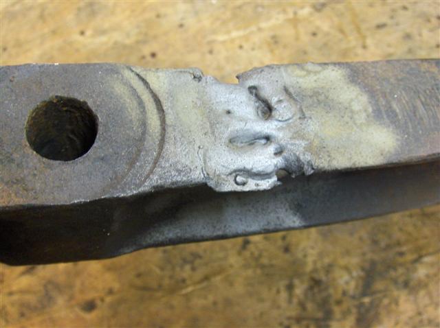

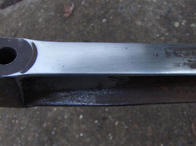

    Amazing work. I have a '32 "heavy" axle that shows some wear where the spring shackles wore into the axle as well as three or four tiny pilot holes where I think someone was going to drill lightening holes. The axle is forged so I presume mig weld in some filler material and then dress the welds. T/F?
    117harv likes this.
  29. 117harv
    Joined: Nov 12, 2009
    Posts: 6,586
    117harv
    ^^^ Yes you could Mig, but Tig is better. Here is one that came out from under a trash trailer that I repaired. 391162-1338769887-63db37a8e2ccfc7c1cc19da6d1c806a1.jpg 391163-1338769887-9223b59496c737cc6372bbf78ba18cb8.jpg

    Ok then, Tig it will be. I just looked at that polished axle again and thought about what you could do to an engine block. Now that would be cool sitting in a T bucket.
