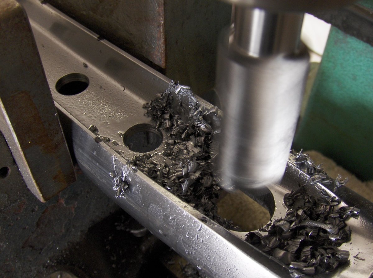

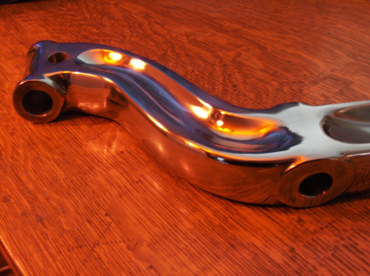

    Here is the finished axle from post 226, I drilled 17 1" holes in it. I have found that 17 looks the best to me, not too many and not too few, your mileage may vary. I remove a slug with a hole saw and then finish up with an end mill, this makes for a nicer finish with less clean up. The spindles are close to being done as well. :)

    Hole Hauger bits make a nice job of drilling axles.

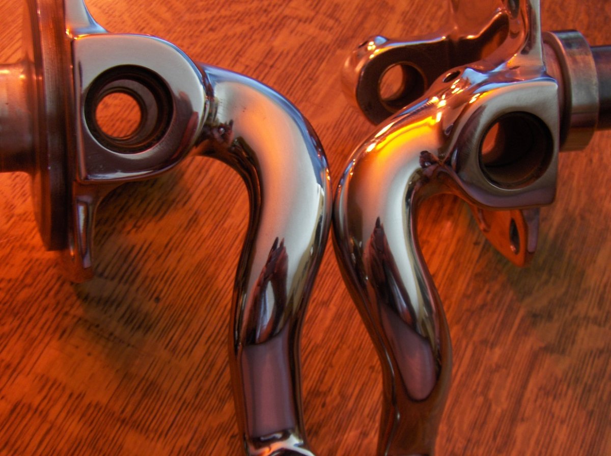

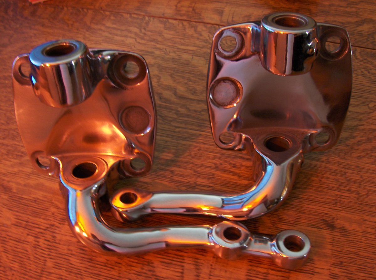

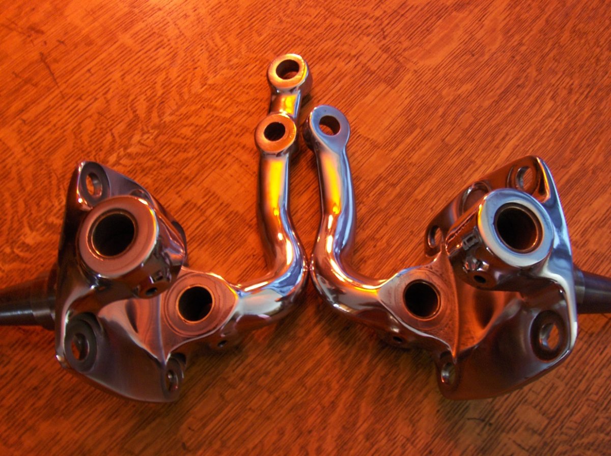

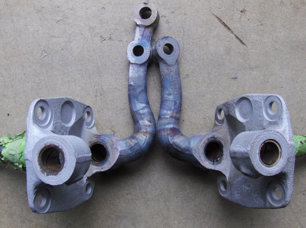

    Here are the spindles from the previous page that go with the axle above.
    Thanks for all the kind words and likes guys :)

    117harv,

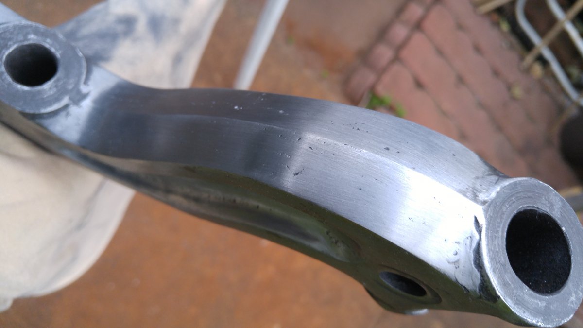

    Do you keep grinding and sanding until all the tiny pits are eliminated, or can you leave a few, trusting the copper plating step to fill them???
    I'm following your lead on my dropped '33-'36 axle. I've created some pretty good peaks, but still have a some tiny divots that are too small to fill with a weld bead. This picture shows the worst of them.
    Thanks for inspiring the rest of us to raise our own personal standards.
    -Gary

    Gary, yes, it looks like all those will sand out. The side profile on the ends is thick so you can keep going down to get rid of the blems and still keep your peak.
    After doing this for awhile I can tell when a blem just wont go away and will need filling. You have to use tig to fill them. Your axle is looking great, this is what I like to see, that I have inspired others to give it a try. :)

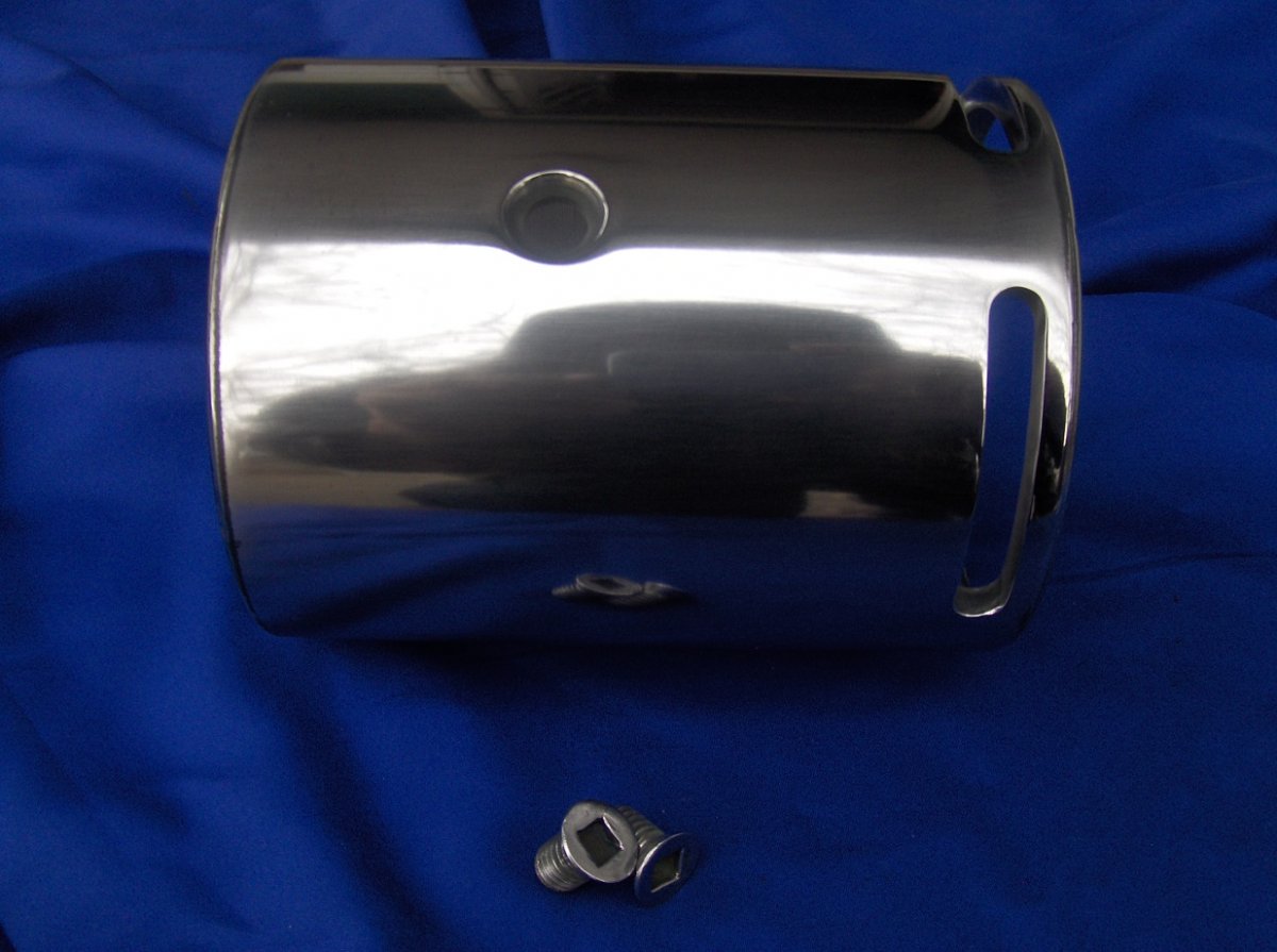

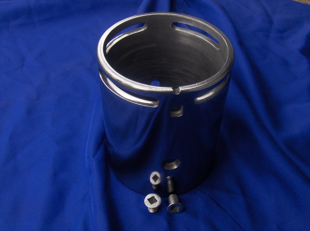

    An early generator housing for a member, no before pics but had some of the original paint with rust and dings from years of service.The slots were a challenge, it's looks hazy but it was foggy out this morning taking the pics 002.JPG 009.JPG .

    Just stunning Harv! Another work of art by the master.

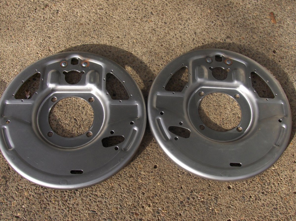

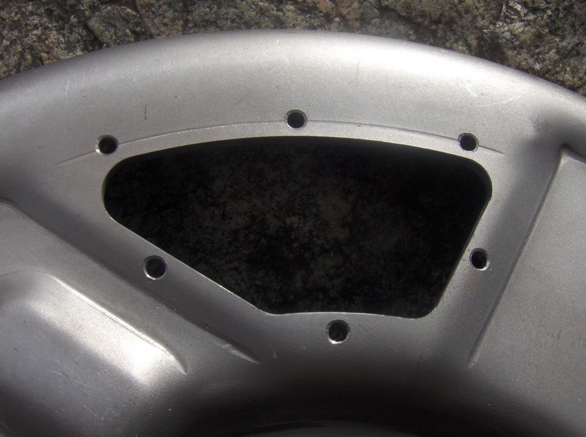

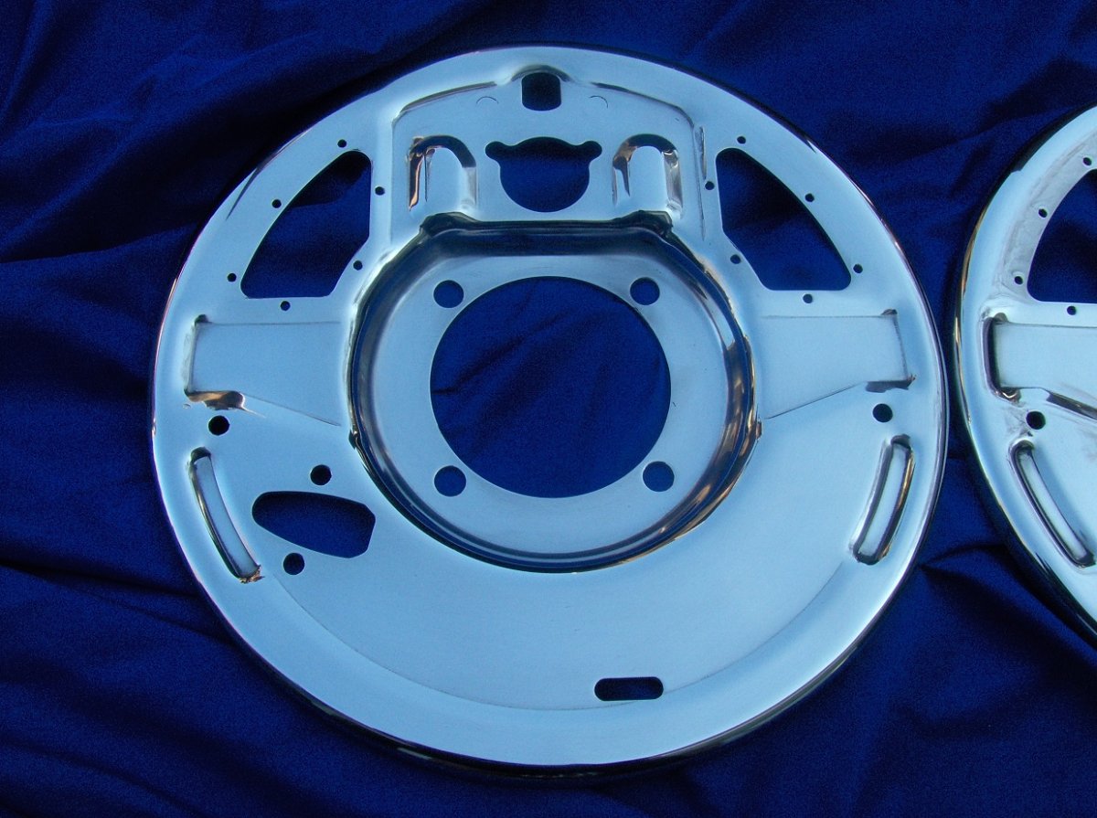

    Here are a pair of Wilson Welding rear plates sent to me for some detailing. While the metal is clean and smooth, there are some areas that needed dressing. There are heavy draw marks around the outer edge that meets the drum as well as the weld beads and other draw marks. I detailed the two weld beads on each plate as best as I could, there are smiles left, I didn't tig them in as it was hard to get into that area to detail, copper will get them. All the small sharp points as well as the shoe lands are done as good as I could get them, these were almost completely finger sanded with graduating grits except for the outside edge.
    Pics next.

    Beautiful work, Harv.
    What's the finest grade of sandpaper you use before sending parts to the plater?
    117harv likes this.
  28. 117harv
    Joined: Nov 12, 2009
    Posts: 6,586
    117harv
    Thanks, 600 grit. ^^^
