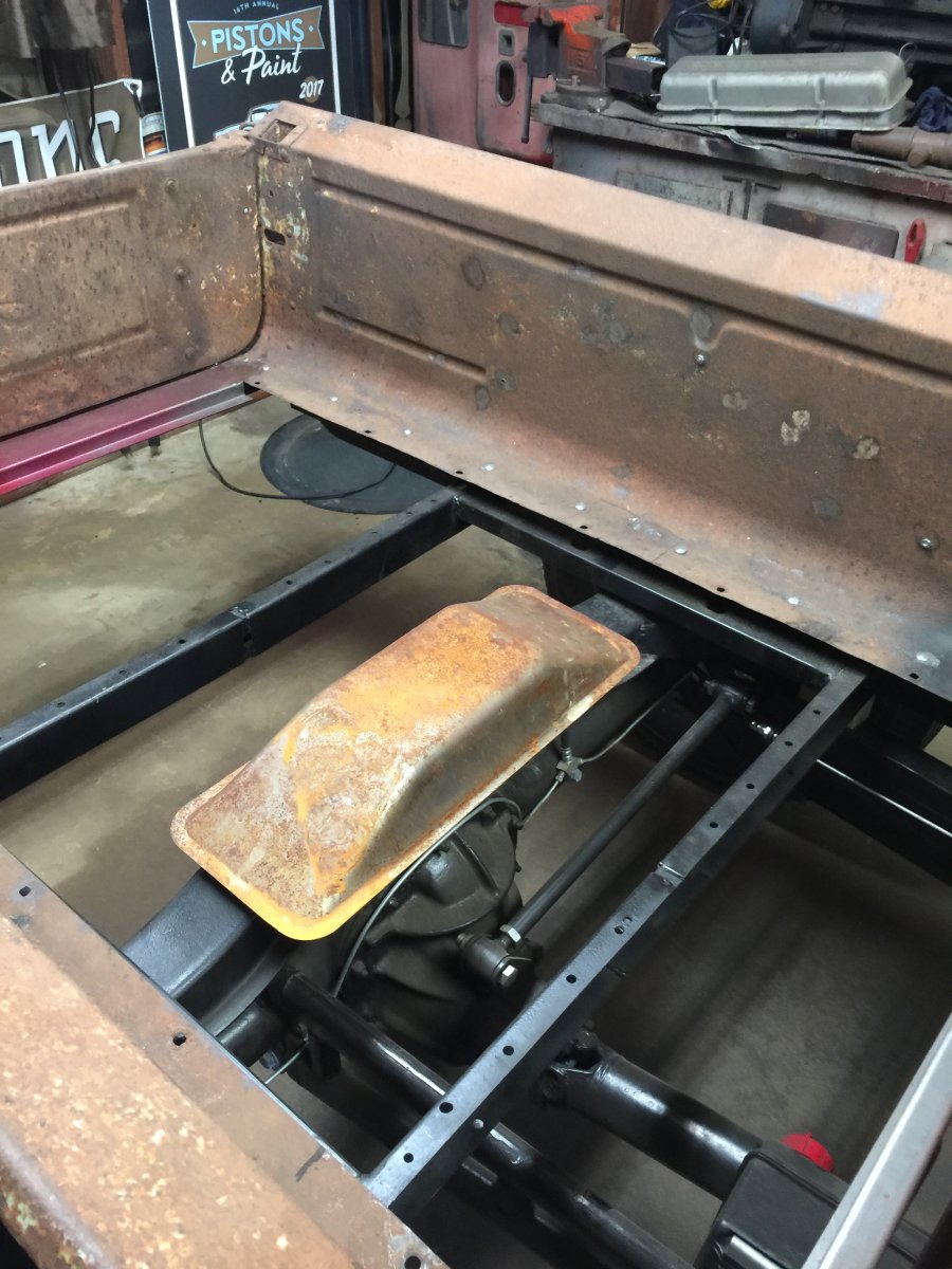

    84D30C14-52B7-455B-9940-C98EC68EE1FB.jpeg I blasted and painted rear crossmember cover yesterday. Then started straightening tailgate.

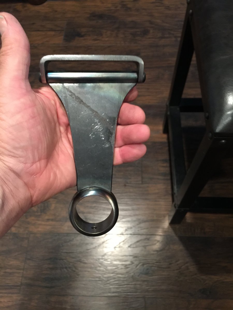

    BB20F895-2D09-45B1-BF2F-191402381915.jpeg 31C56C41-C5BC-4B6F-A929-B4F1BE985D85.jpeg 04CC21AA-D723-4402-A8DF-8407C9030349.jpeg 5A6F5F80-1D14-4646-9A31-39AEDDA1D98F.jpeg Turned this 5$ swap meet 2 1/2” column drop into a 6” column drop.

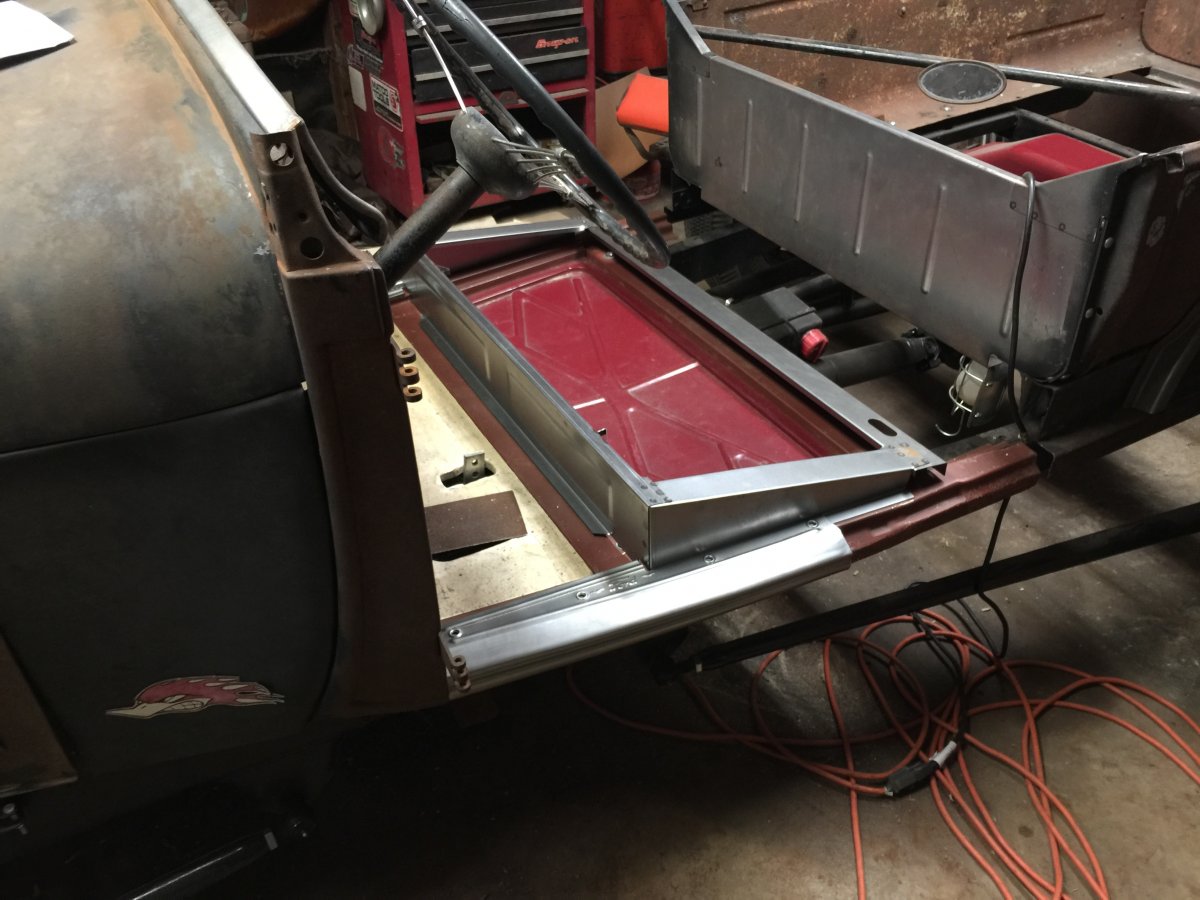

    9370170A-6849-4173-8ACC-9F8DEC575C3A.jpeg 686F32F7-0434-4DD9-8D77-C3C2740DB587.jpeg EEF8C351-A60B-46C4-B0D8-F762725BE334.jpeg Brookville Roadster took a nice bite out of my *** NATIONAL today! I ordered seat riser , door sill brackets, & door sills.
  19. pecker head
    Joined: Nov 8, 2006
    Posts: 4,471
    pecker head
    7D1BD897-9CC2-4C5E-B0FB-410F005E1CAC.jpeg 762157B8-5D6E-4AA7-8C3D-750F5AB12C5E.jpeg 07E1C5CE-F857-4E05-A360-D63AA534B536.jpeg 68D612C8-C098-4FCD-AF8B-090498D8CB4C.jpeg This morning I lowered grill shell another 3/4” to correct the cowl - hood side gap. And then welded up all the holes in windshield stanchions.

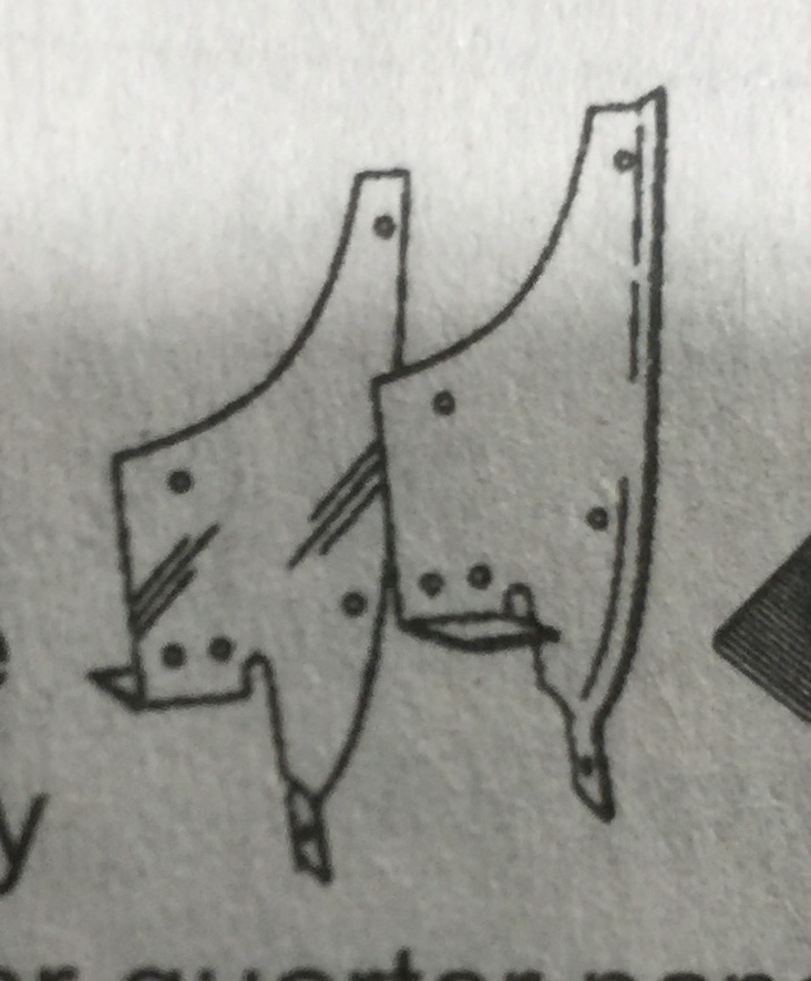

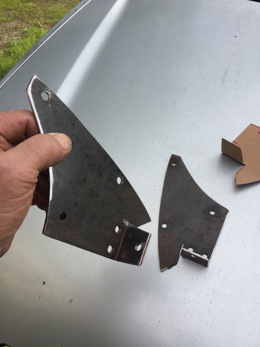

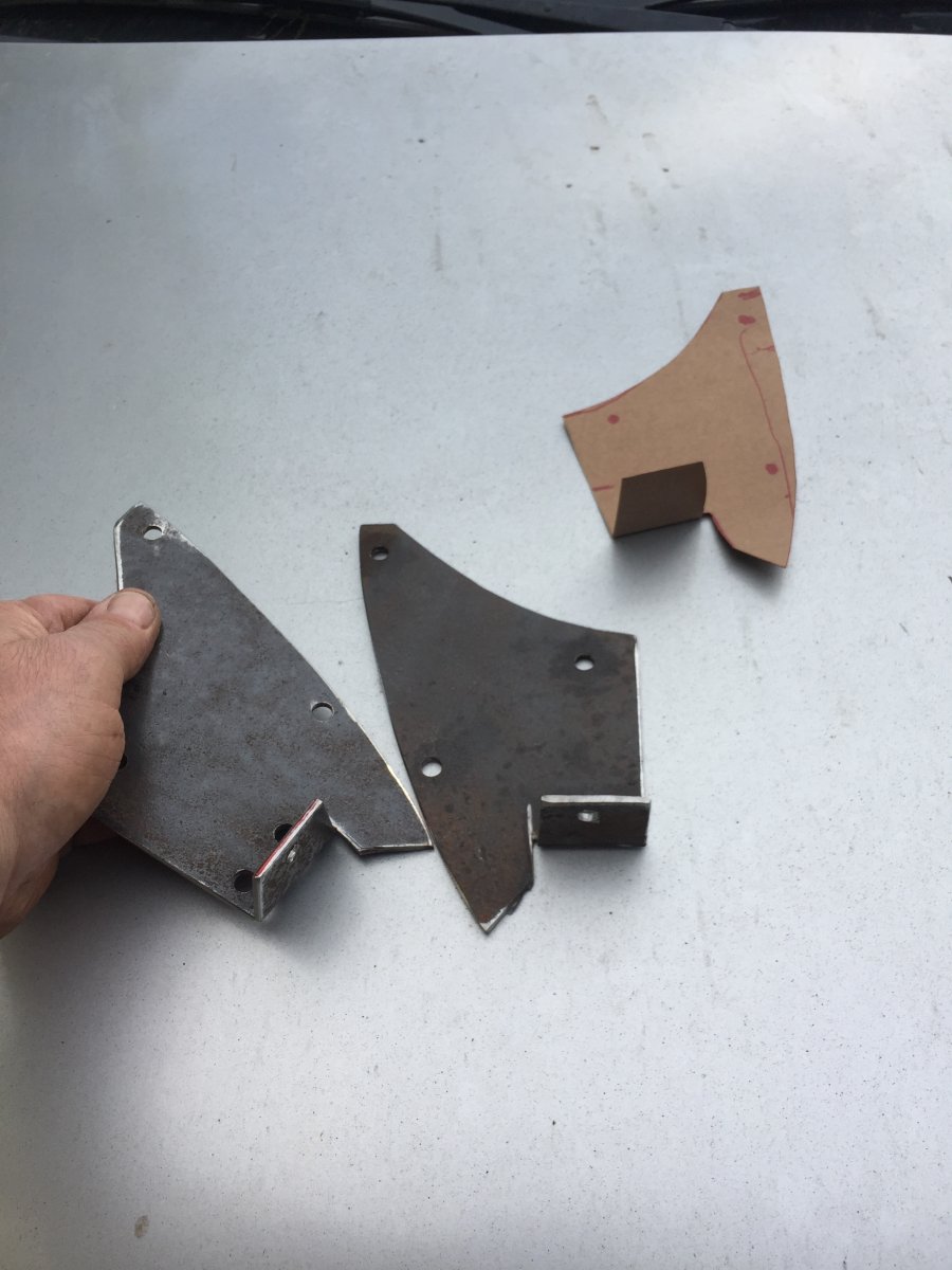

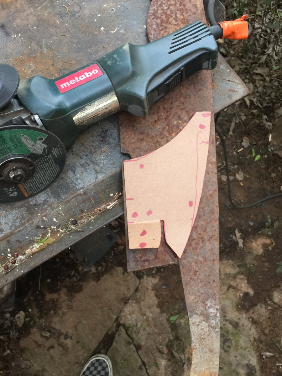

    F0CD7954-0C68-44C7-BBEF-576C18C879C5.jpeg B1EC903B-89CB-4519-B53F-858167FA2237.jpeg 6508CB77-9868-45DA-A81A-49F4FB2239B8.jpeg 7DCB1EF1-B327-4F07-BBF5-334F9700BFF9.jpeg To cheap to pay for $110 brackets.

    I’ve enjoyed following your thread. Please school me on the reason you taped a loop in the grinder cord where it exits the housing?
    loudbang, Stogy and pecker head like this.
  23. pecker head
    Joined: Nov 8, 2006
    Posts: 4,471
    pecker head
    Lol, has a bad wire in it I guess, want work with out it.
    bondojunkie, loudbang and Stogy like this.

    That’s so cool! That’s the kind of stuff I do because I’m too cheap! Hey are those model a pick ups all riveted together? That sure makes it a lot easier to build parts and just grind off the heads! It looks like most of the support brackets for the bodies on those are all 90° angles and stuff too!
    That’s the only thing I don’t like about my 33’. everything is stamped and spot welded and weird curves and stuff makes it harder to fabricate.
