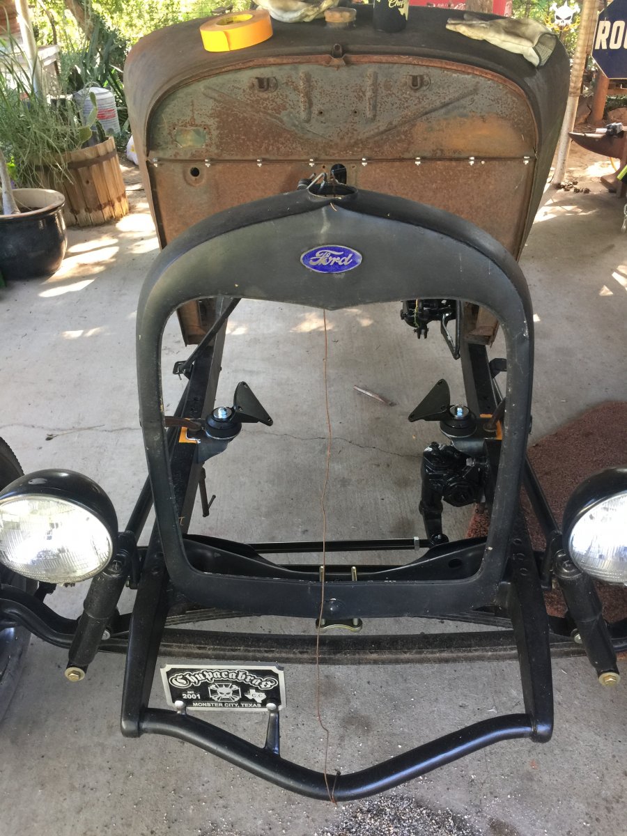

    Making good progress,i like how u took your time to clean and paint everything.
    I also love your yard/garden/work area..

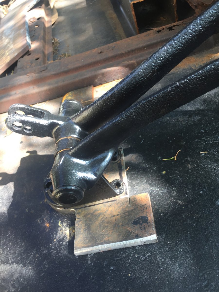

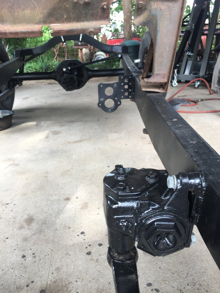

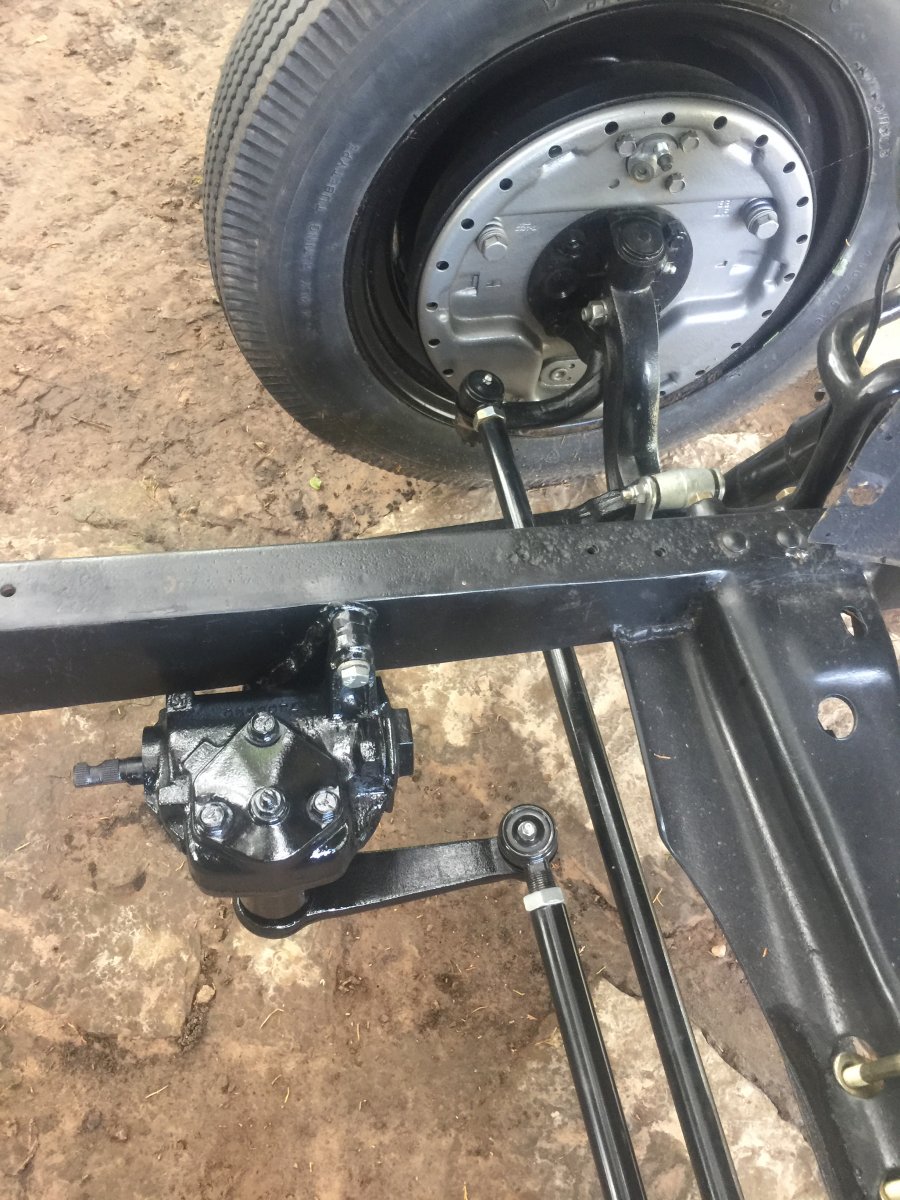

    D15CEC7F-1150-484B-940E-B7445933ACBF.jpeg Finally got draglink installed, and front end aligned.

    You going to leave the backing plates silver? They look pretty good like that. :)
  4. pecker head
    Joined: Nov 8, 2006
    Posts: 4,500
    pecker head
    Yeah , there hammertone finish. I bought the paint for the fuel tank I’m going to use. And tried it out on a backing plate and liked it, when they were black you couldn’t see the holes very well.

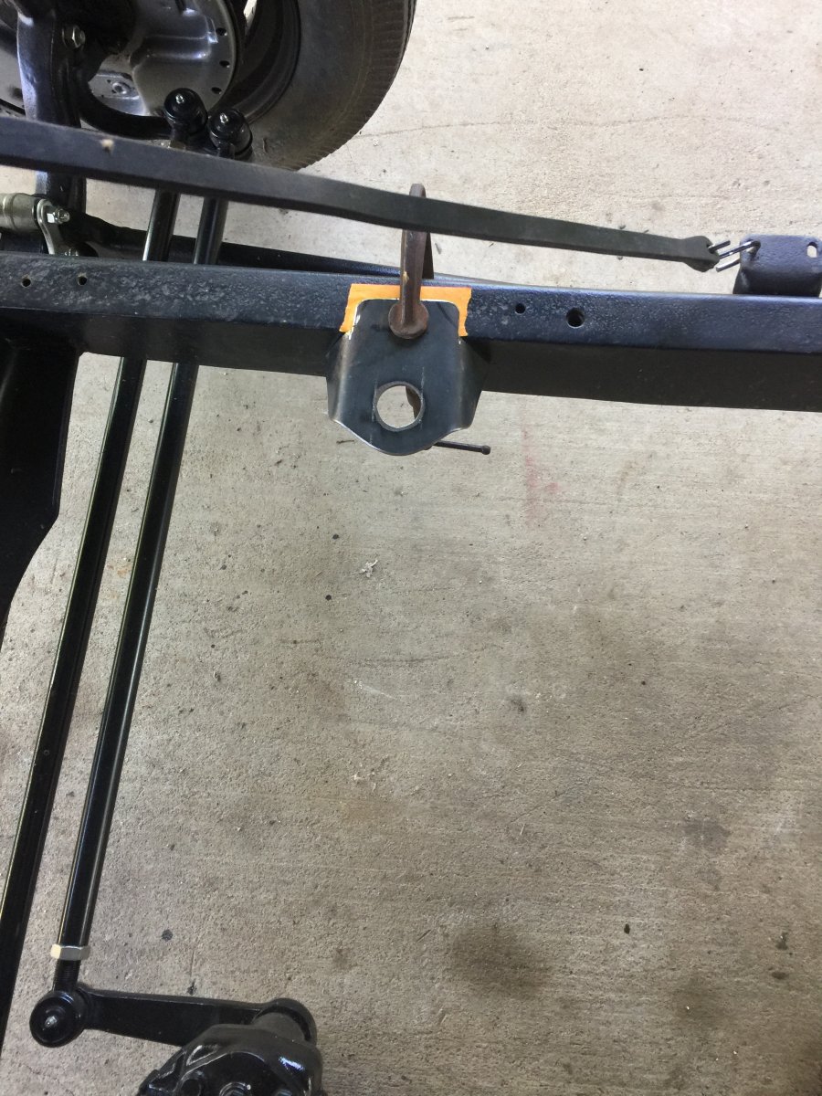

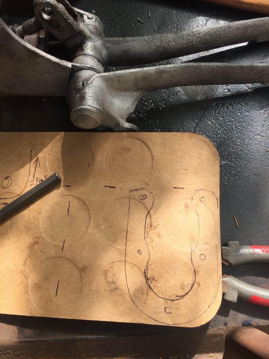

    819BC8DB-B12A-4C7C-B06E-B9AE7156933A.jpeg 0A3978DC-B9C0-4484-89E5-B22B5D353566.jpeg F1 pedals that I bought at Pate swapmeet, and the plans for the weld on frame bracket.

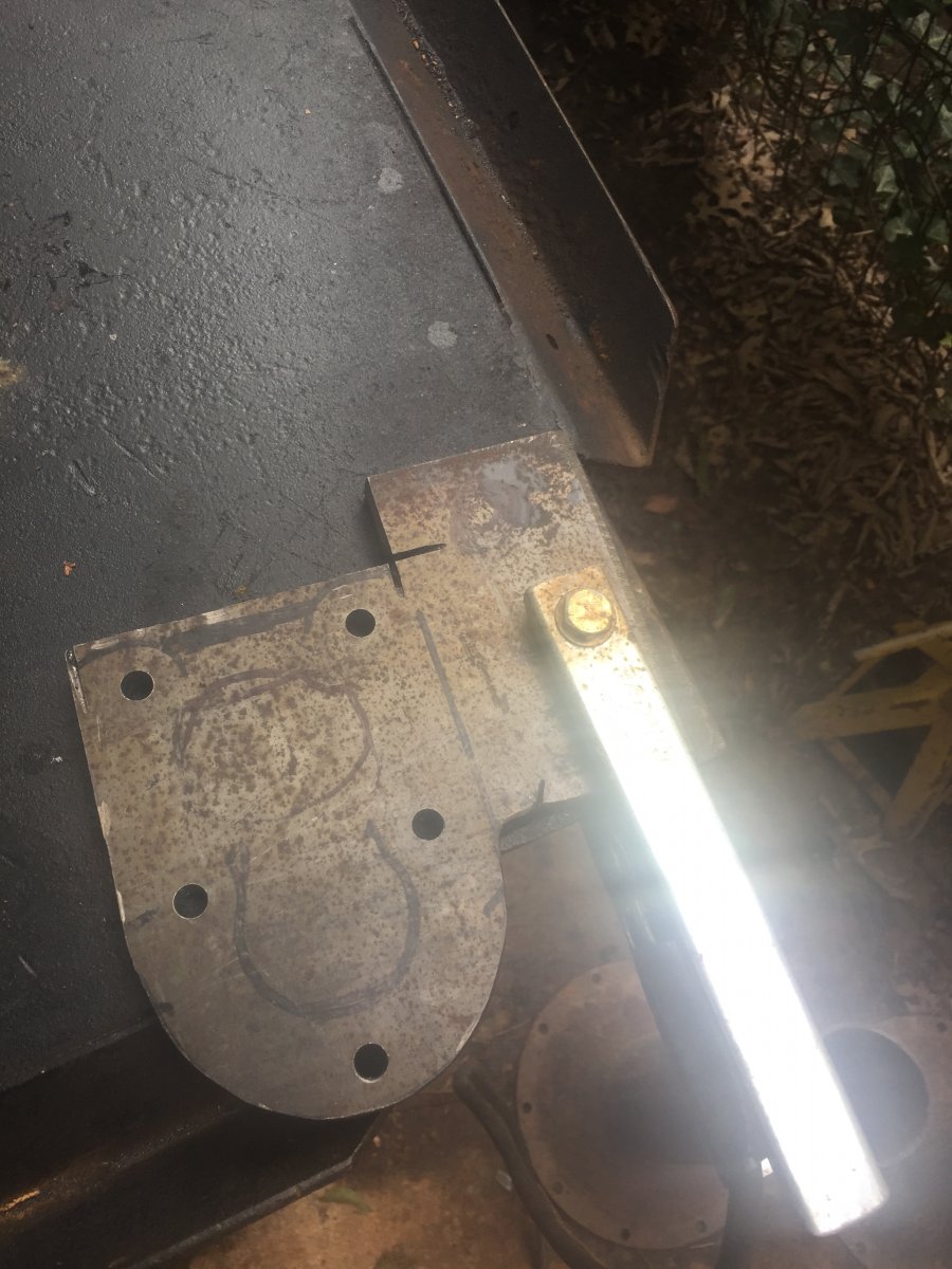

    E63594AA-ADC7-42B8-BD45-31ACAA803F4B.jpeg S**** 1/2 plate I scored at work.

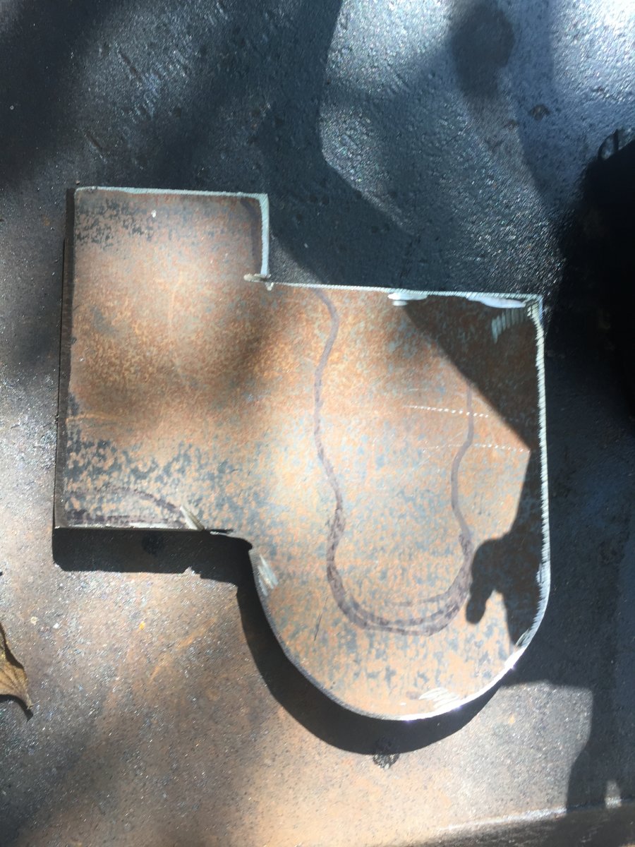

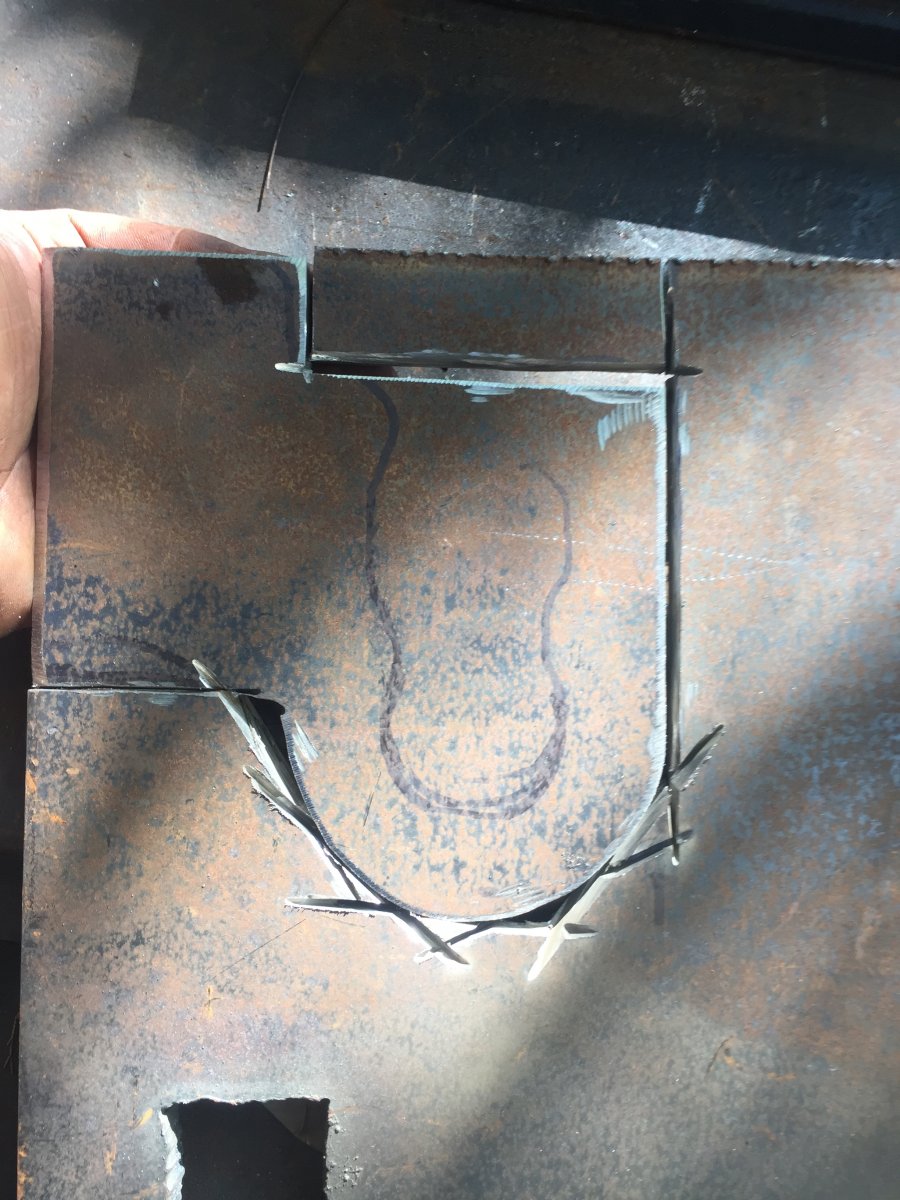

    7C8E4F07-63B8-4B77-87B0-FEDF2EF92FAC.jpeg 1E027B3B-BF9D-4094-9291-B6A398F51CBE.jpeg Disc cutting 1/2 plate. I was bored.

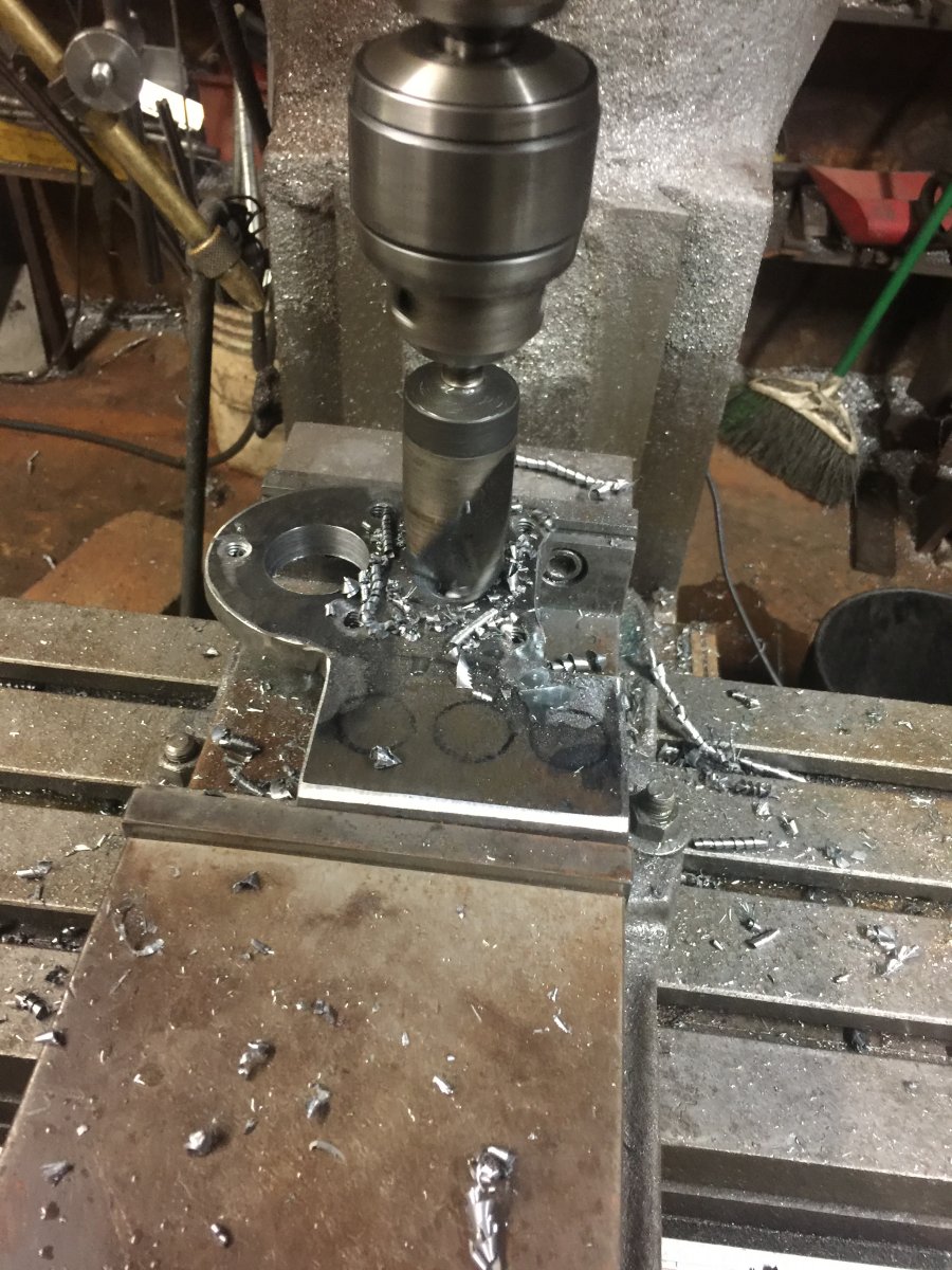

    2EF89A41-EA85-49B5-8592-8C0FE2466BCE.jpeg Back to the machine shop.

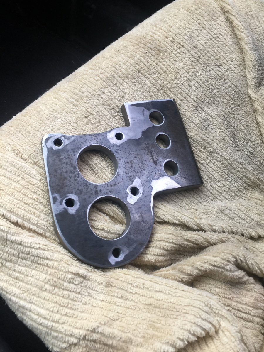

    94E06A56-9668-4A05-ACB7-AA3A5471E706.jpeg A2388254-1A9F-4394-A41D-3AC0C60CF3A8.jpeg When a dude tells you I built everything, he doesn’t mention these small pieces.

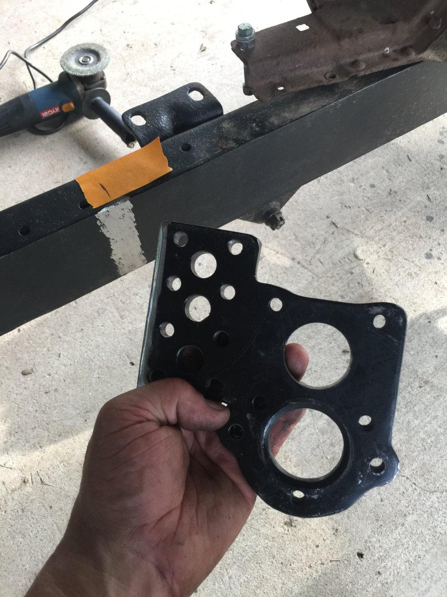

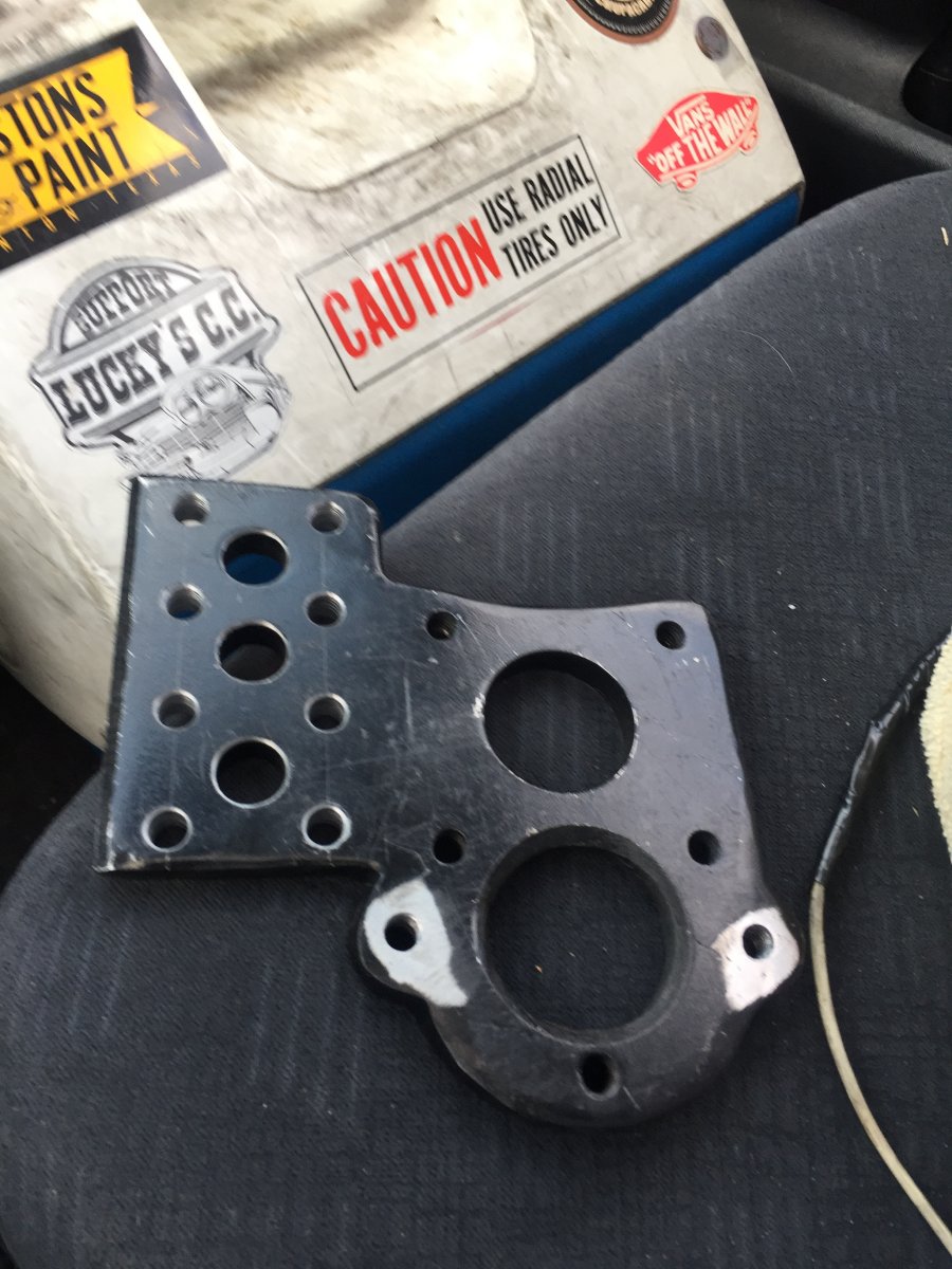

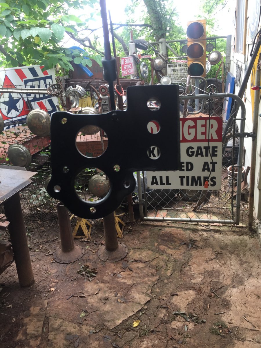

    20ED2E26-BA55-49D6-98D2-66E8C30B0C8A.jpeg Some lightning holes. All it’s fixing to get real.

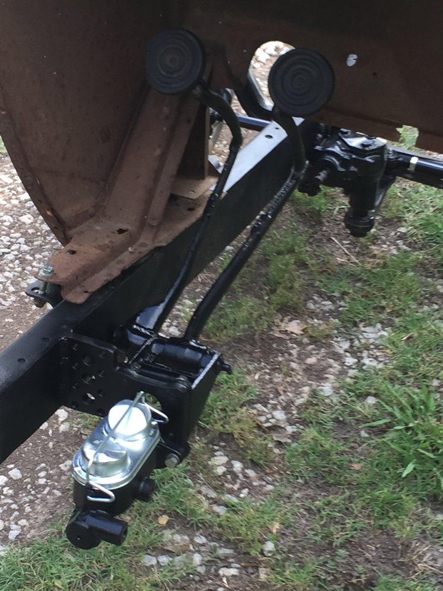

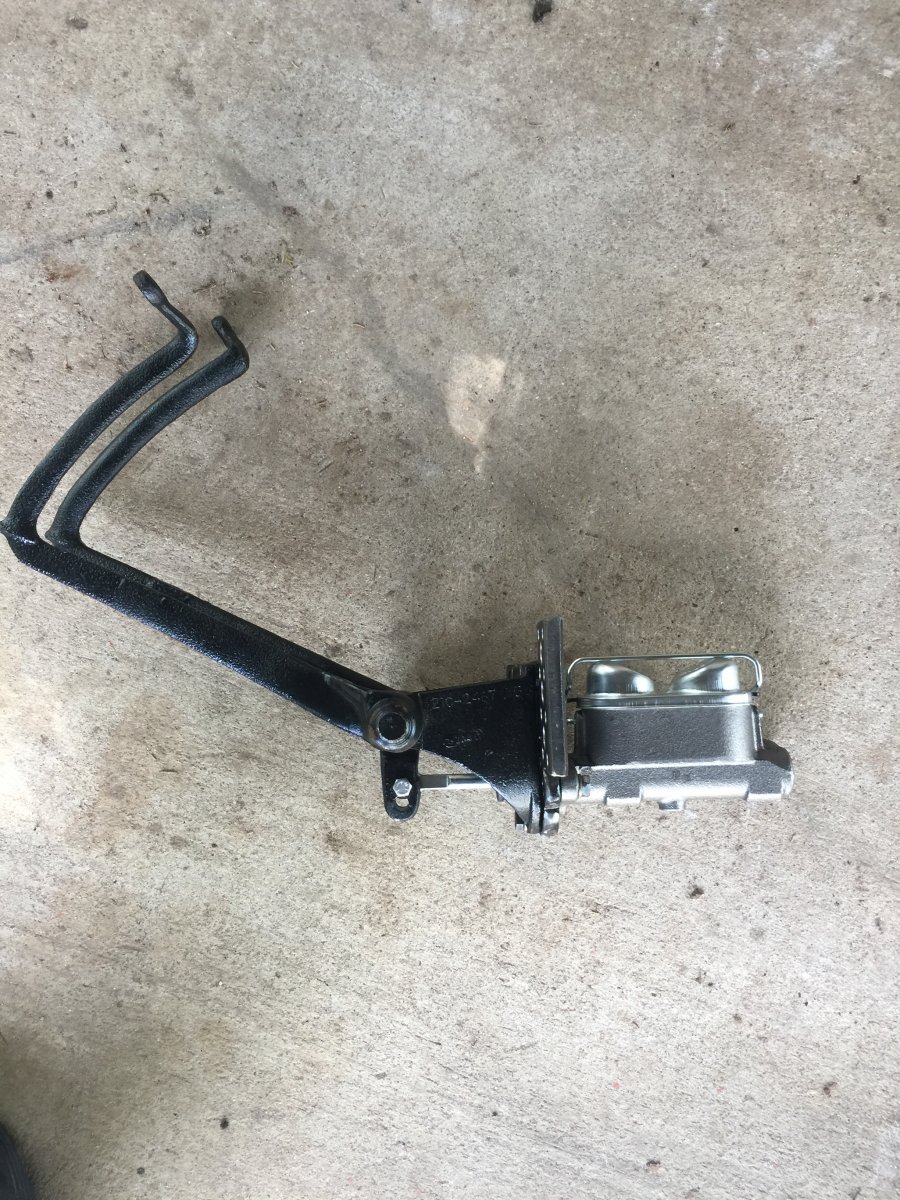

    01270A1E-7502-4189-A093-4DE664288E97.jpeg 0E48ACD3-09EA-4CC2-9FF4-5125A95A15F1.jpeg F9A01916-F7B2-4258-8B47-0AF9E2CDFF0C.jpeg 61E98460-0DD2-4DC3-B690-9B86D0824510.jpeg Early Ford Mustang master cylinder. For drum drum brakes.

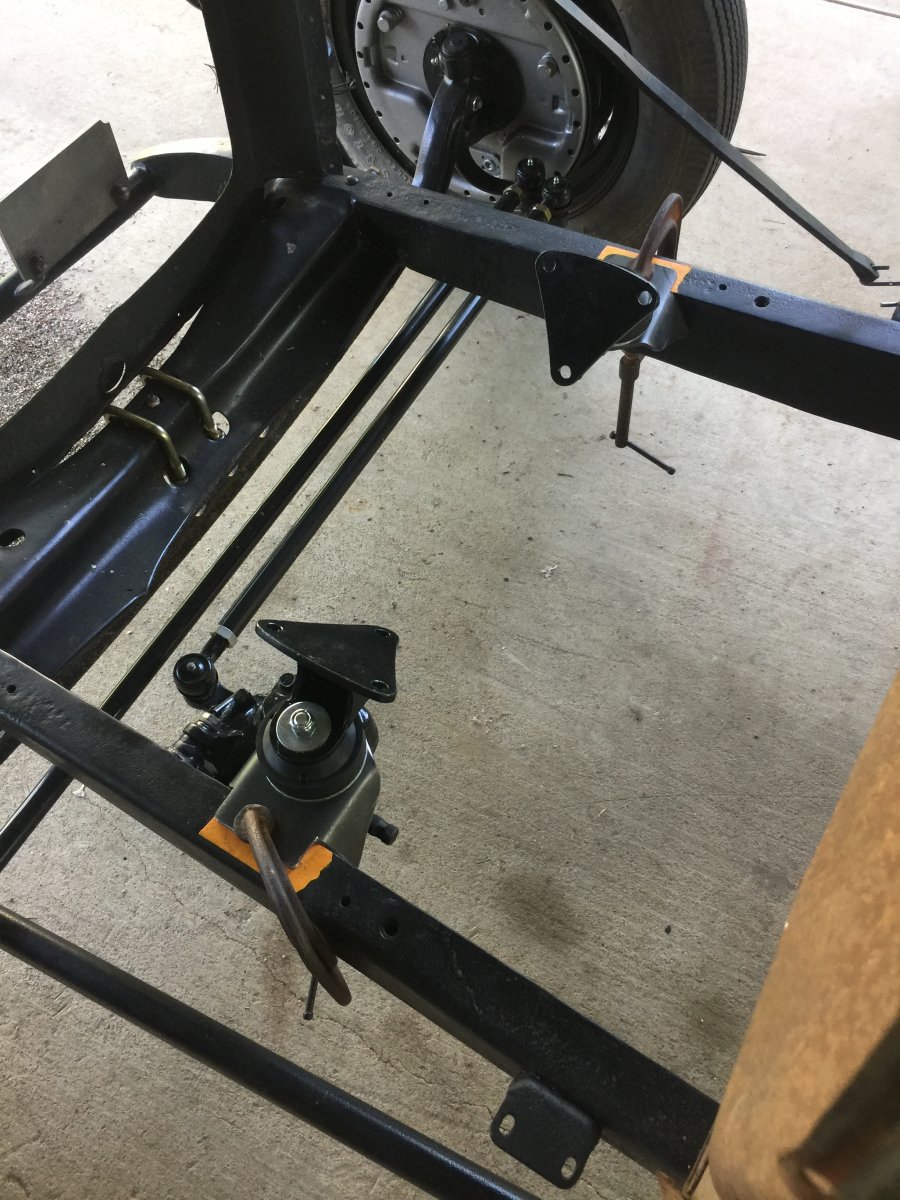

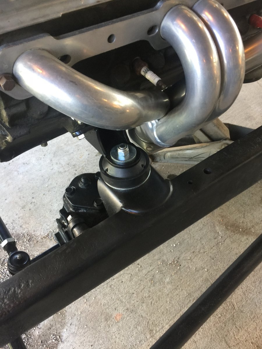

    93BB88A7-A188-489F-AE27-07B7057295DF.jpeg 957E4A1D-2FD0-4FAE-9712-B802BF29208B.jpeg 80274DC7-F186-4C0E-923A-784A29C521F4.jpeg C628252D-73EA-417F-8822-A906CD2E1C0A.jpeg Getting motor mounts ready, picking up a light weight dummy motor tomorrow from my bud.
