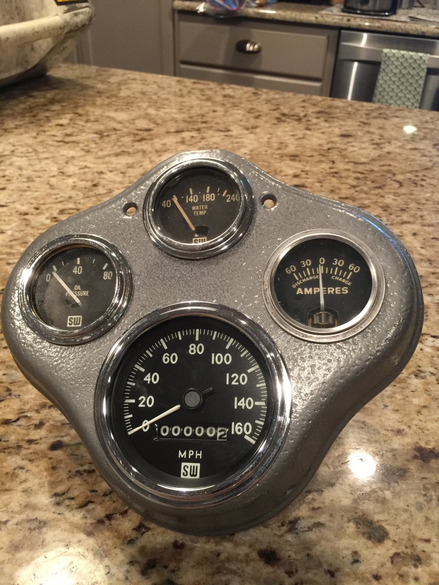

    Someone gave him the Gauge panel - that's all I'll say.........

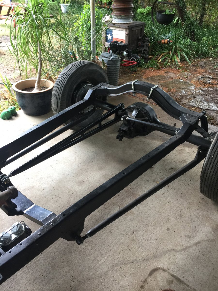

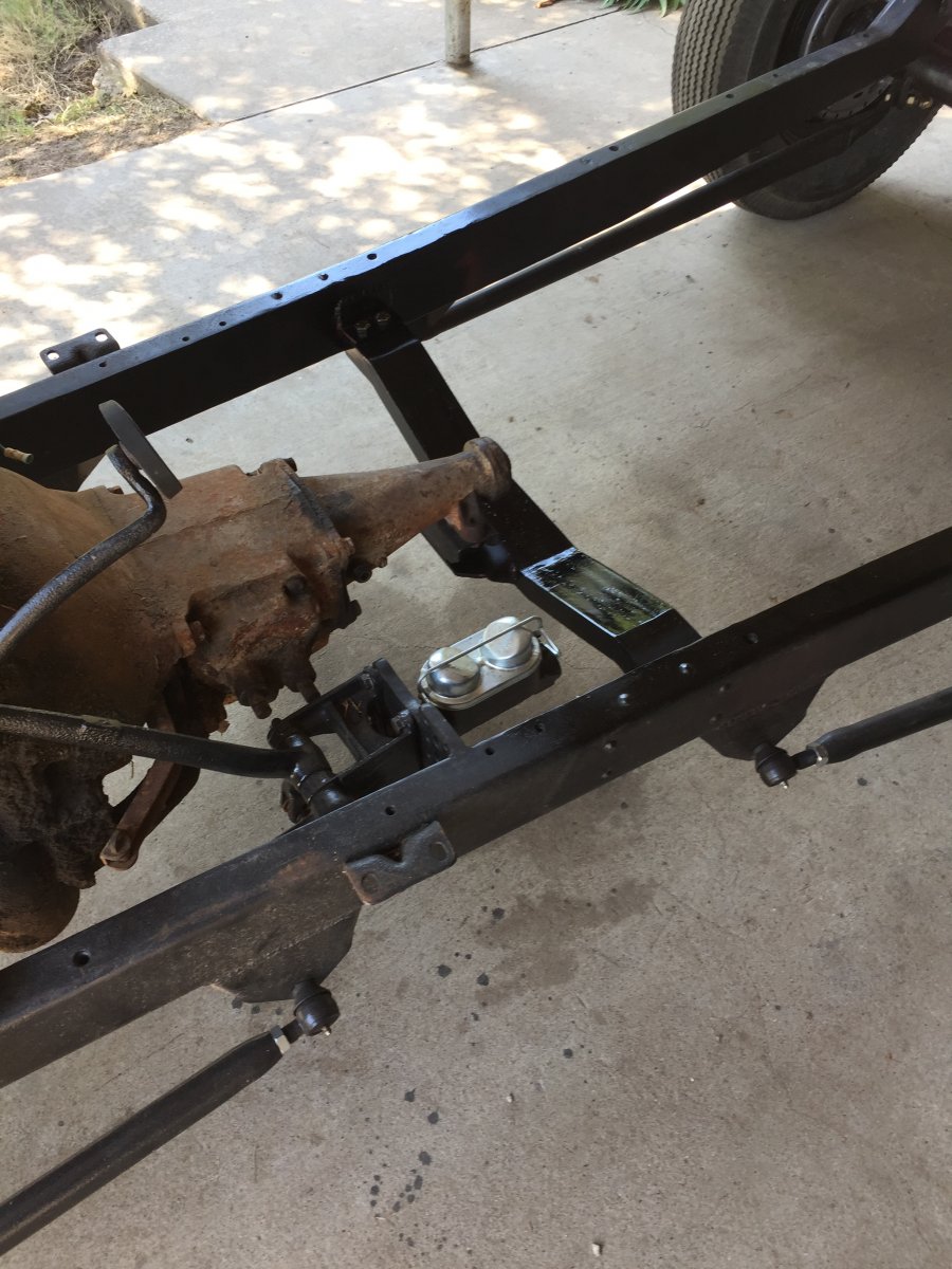

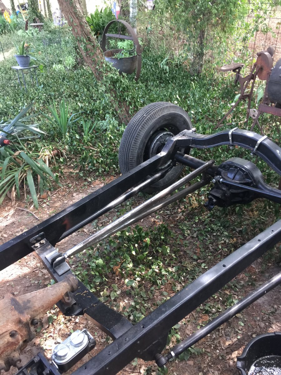

    Project is moving fairy rapidly.

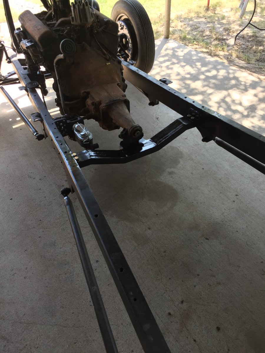

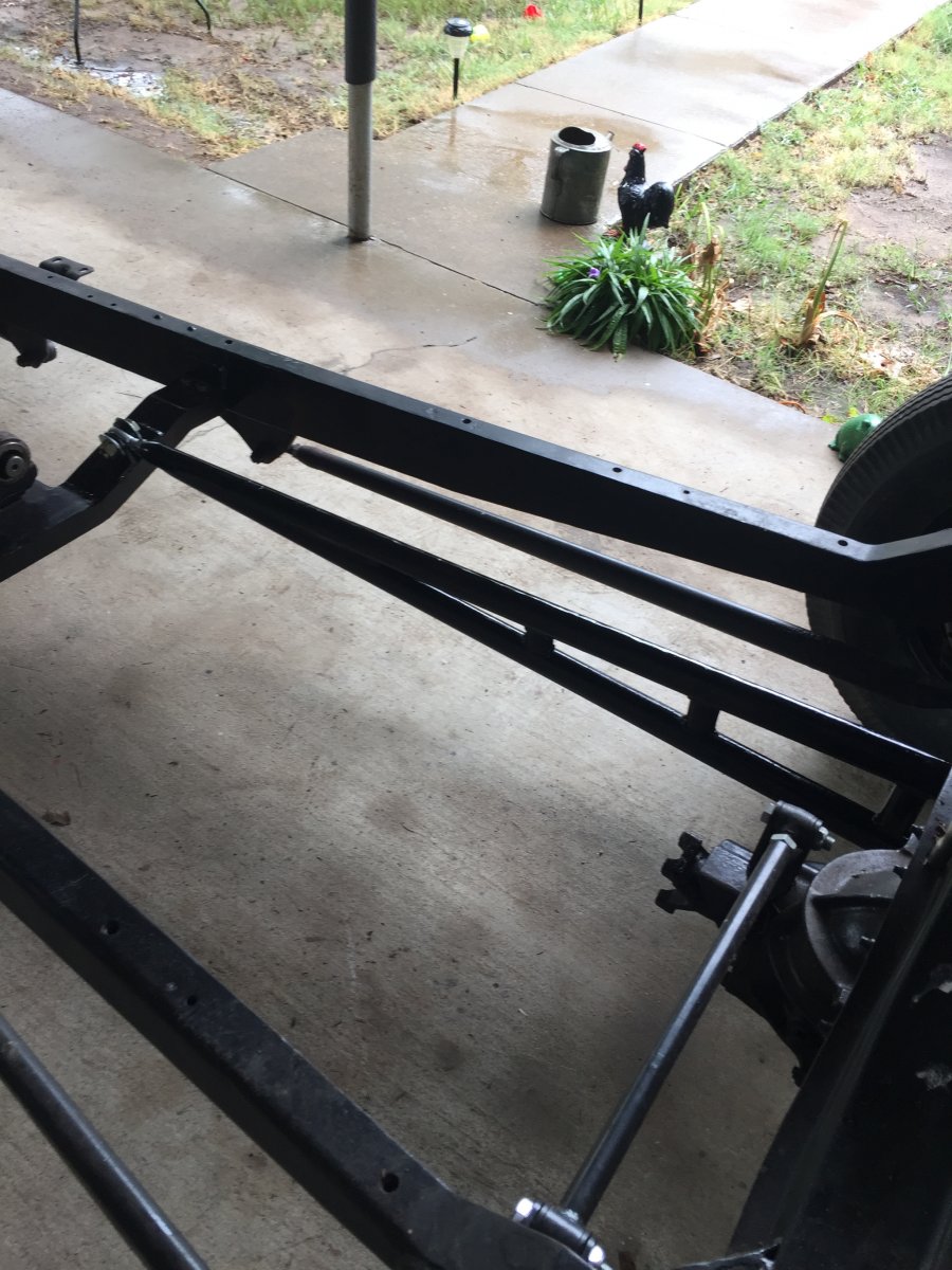

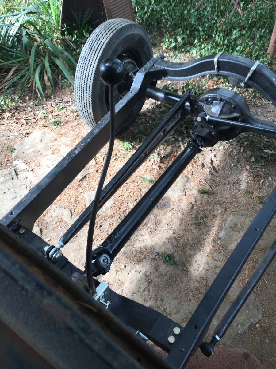

    I'm not sure the rear end torque arm will function correctly in its current configuration, and will probably break the adjacent trailing arm. I believe the pivot points should all be on the same rotational axis, both on the front and rear, similar to a 4 bar setup.

    0BB42C1E-A7F7-424C-A71E-A6D1AEE5384A.jpeg Been running one on my 28 coupe for 12 years no problem.

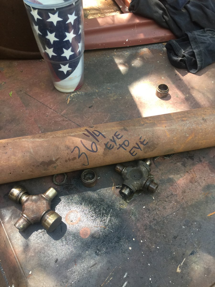

    435C45E2-3160-48C1-8D75-3CE650284653.jpeg Putting driveshaft in shop today to get cut down. 71805FD2-46E5-412A-A316-6D87E9742FE8.jpeg

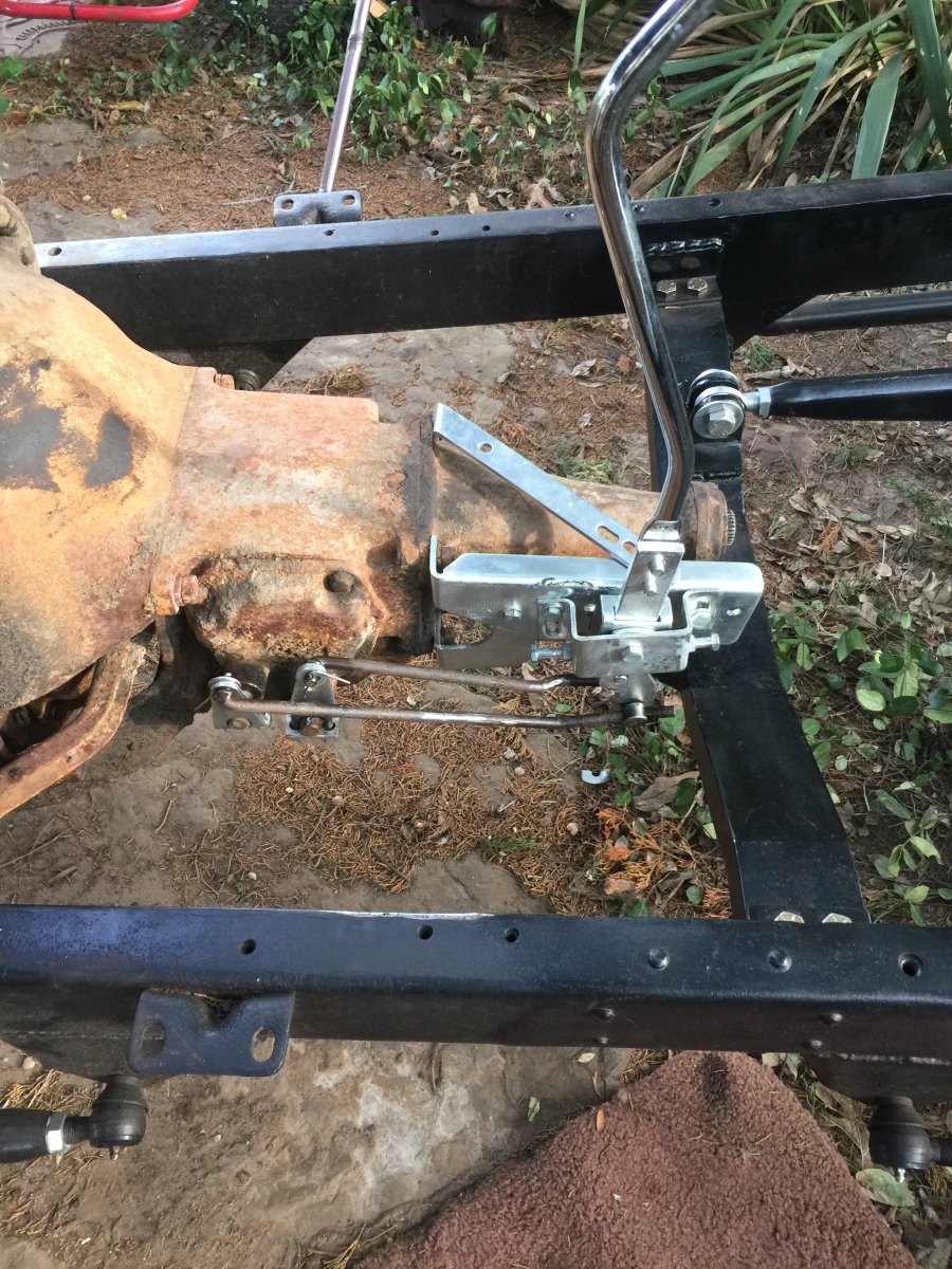

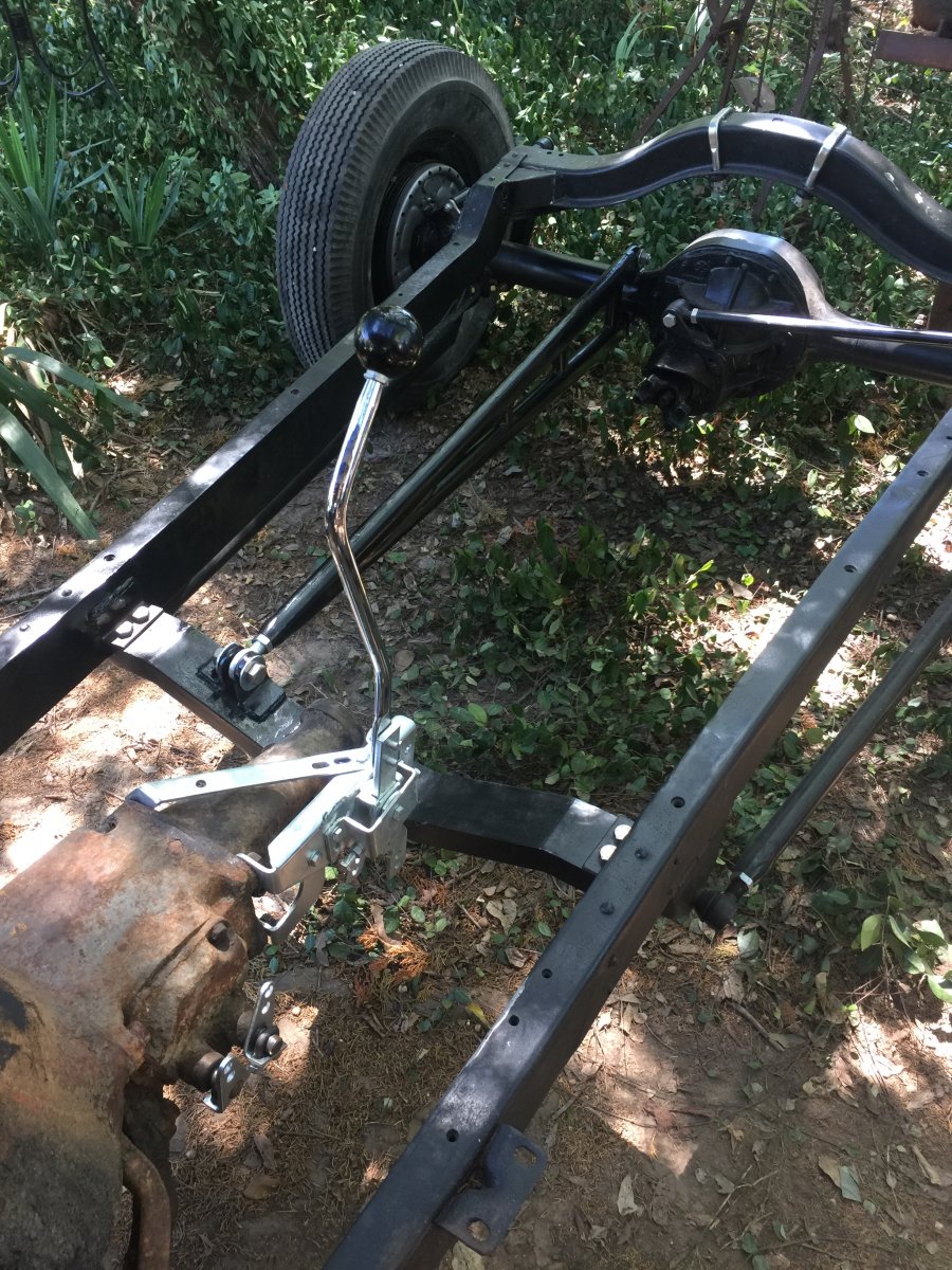

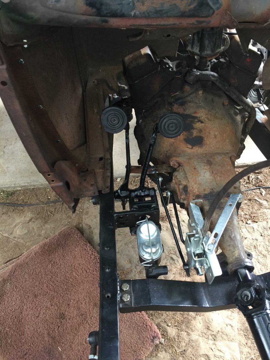

    0C3D050F-BDD8-4ED5-8640-0C1690E5158C.jpeg F6BEA105-41FF-4675-8065-984F5A1DF875.jpeg C1AB8DC1-9A6C-486B-9816-0B3DBEB0299C.jpeg Got shifter installed, stick will be changed to a 39 stick.

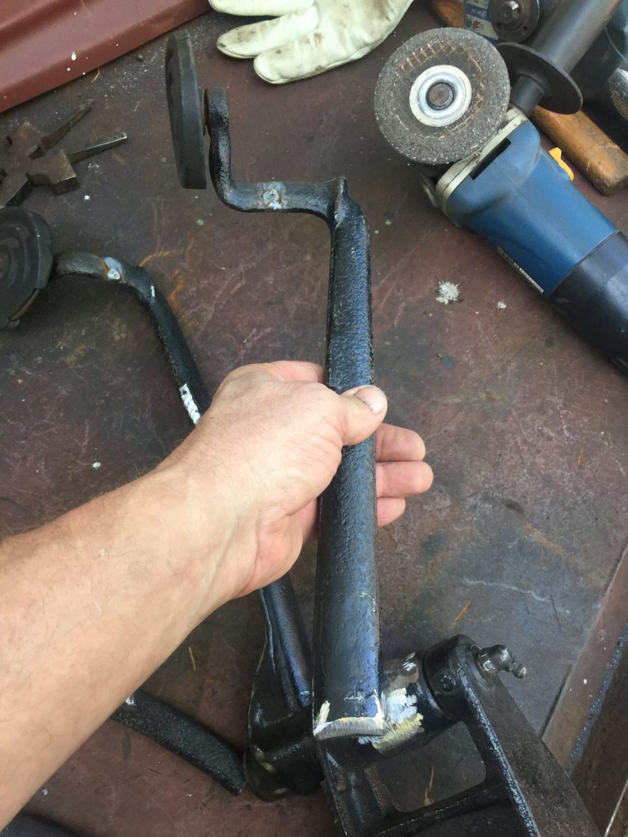

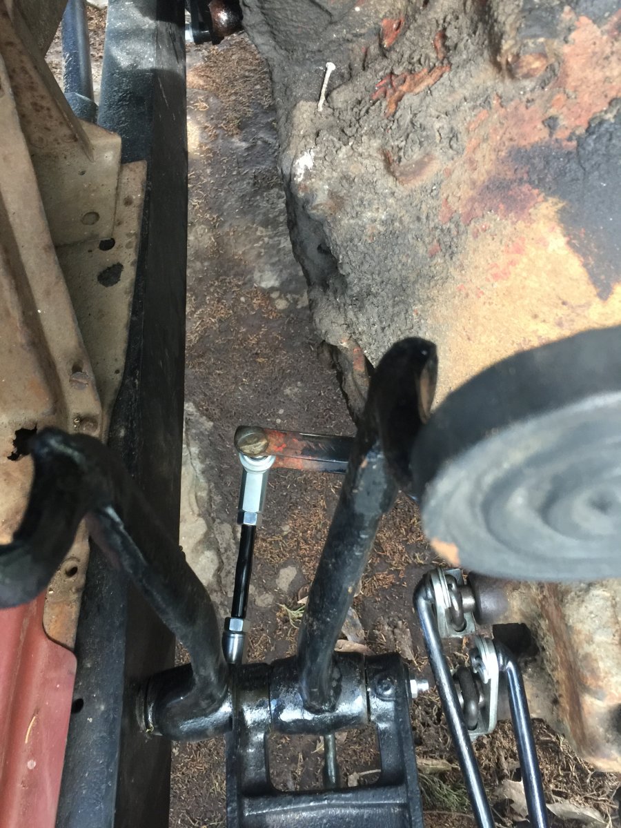

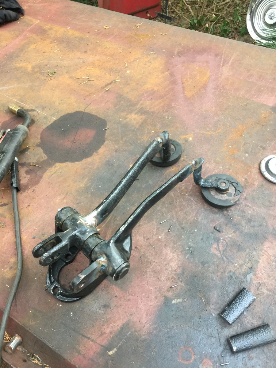

    C4362A5A-9D2D-4375-B94F-E087CF8A659C.jpeg 5DBE4C18-3456-4380-BFAE-CABD6BC12063.jpeg E4DDF0B4-BE46-4825-89C2-3179CEFAA52C.jpeg B1B6A07A-8449-454A-B77E-EF27D6B63C67.jpeg I’ve started cutting the F1 pedals and changing them up to my liking. Still not there yet.

    856A8D72-2DEB-4F7D-B4CE-B5D1205C5627.jpeg Driveshaft done.

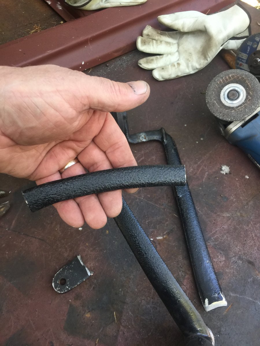

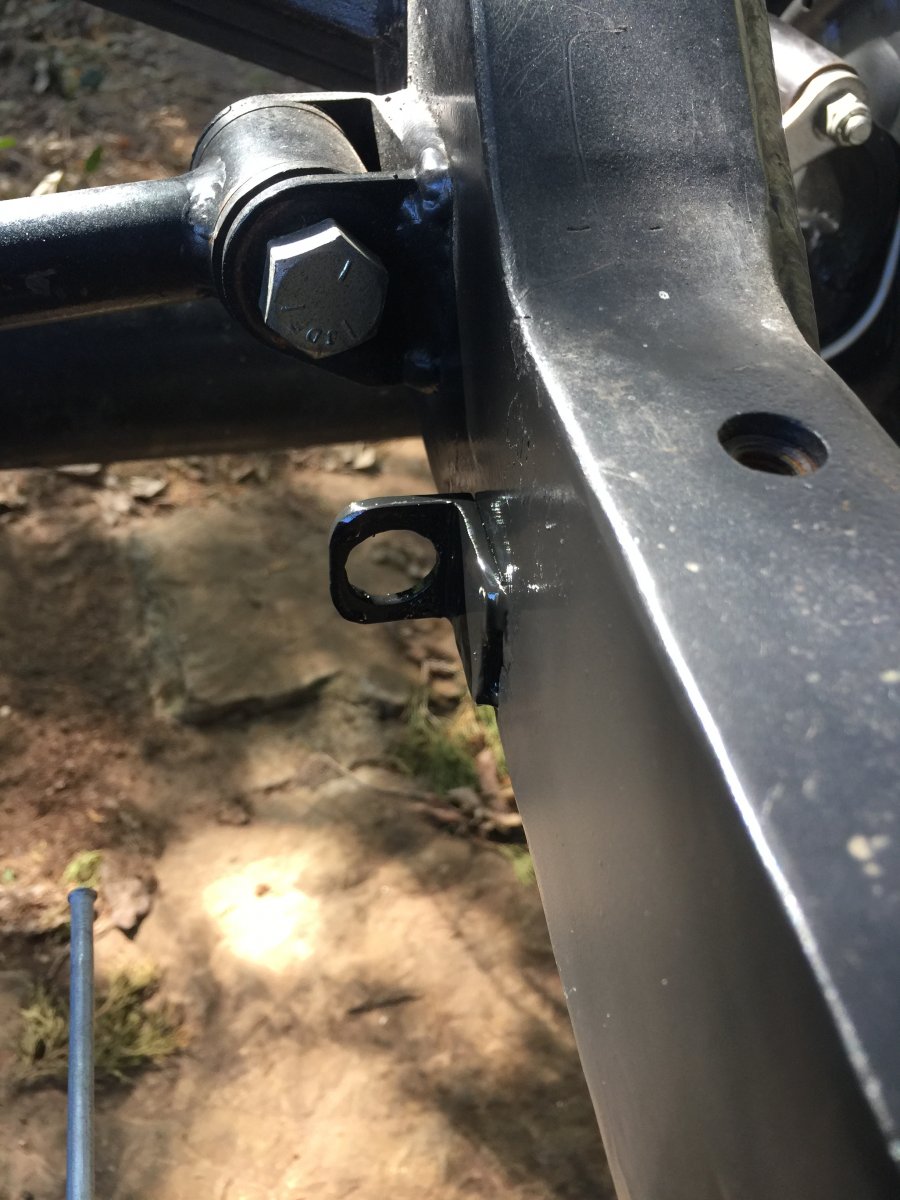

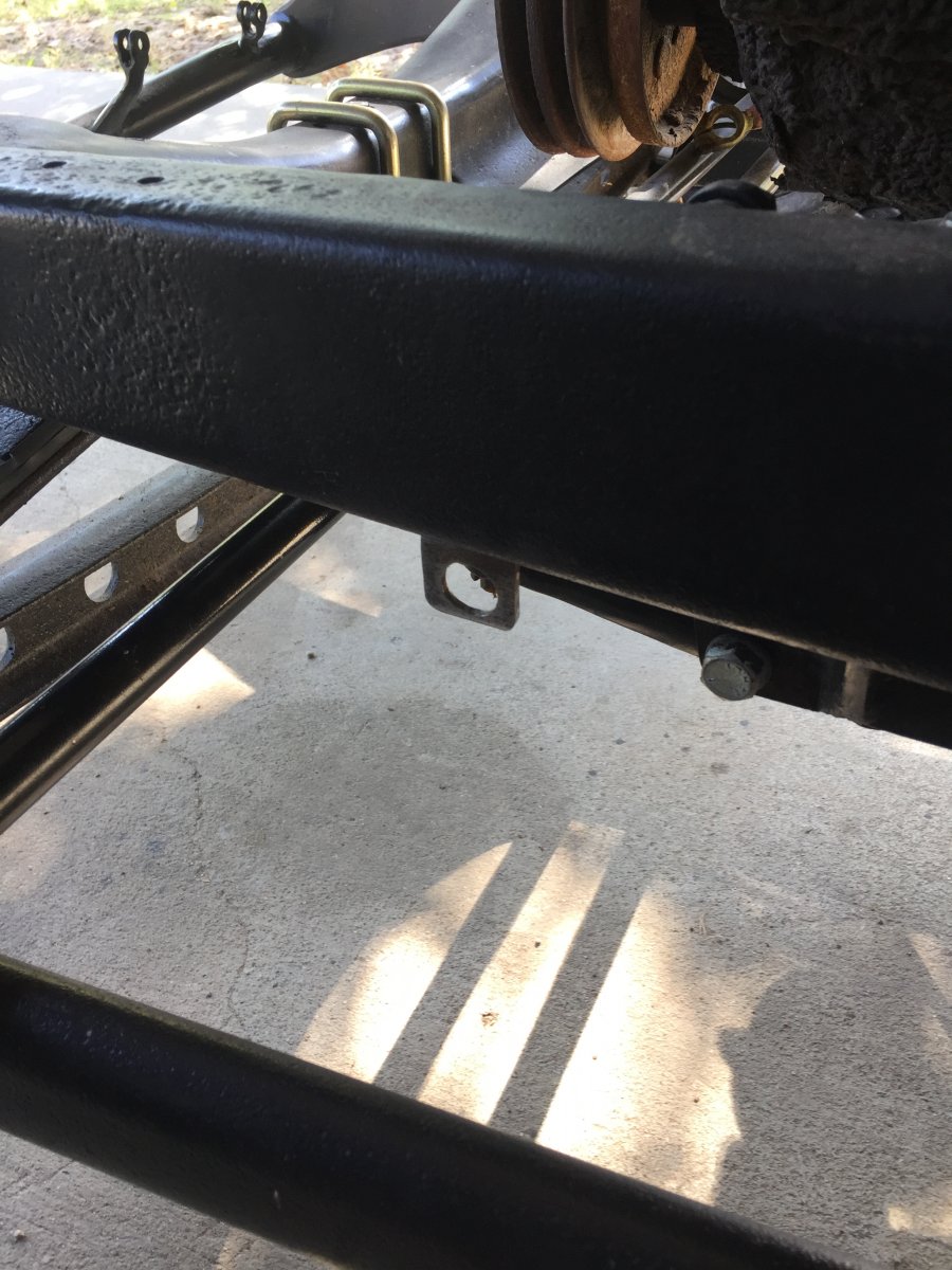

    Whacked out these weld on brackets for the flexible brake lines , I used 5/8 E clips to hold them in place. I did the easy one first. Maybe the front two before weekend is up. E02F6117-7ADF-423C-A2C0-D5866BE81732.jpeg 22BB7BE5-0480-4DE6-B89F-597120290F2C.jpeg 0594FF8D-0D91-4B93-B0B5-BAA4BC600BA3.jpeg 9A43B15A-58F1-4615-97B5-B63DAACECC38.jpeg

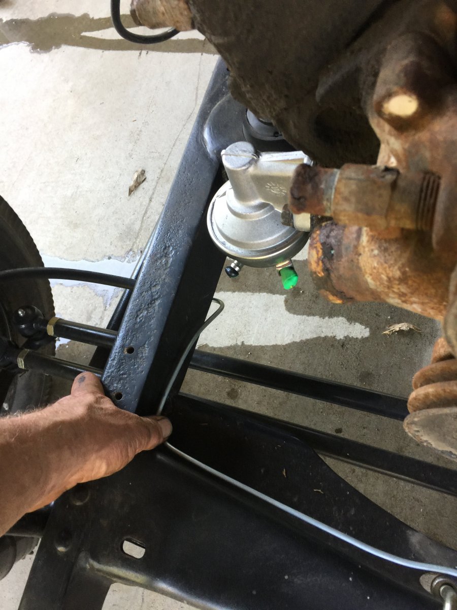

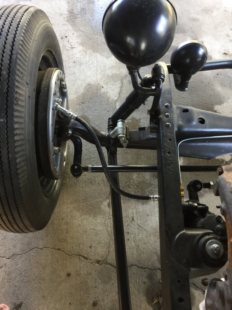

    BA6F666A-35CA-4165-AAD8-F6463A99927F.jpeg 332CB905-216A-41AC-B53C-075C757FA1D4.jpeg 257FCCD0-7656-48E7-9CB0-8A564C5FA8DC.jpeg CAA8FD58-1BBC-4D50-99DE-3D0D444349A8.jpeg Brakes are adjusted and bled with a good pedal.
