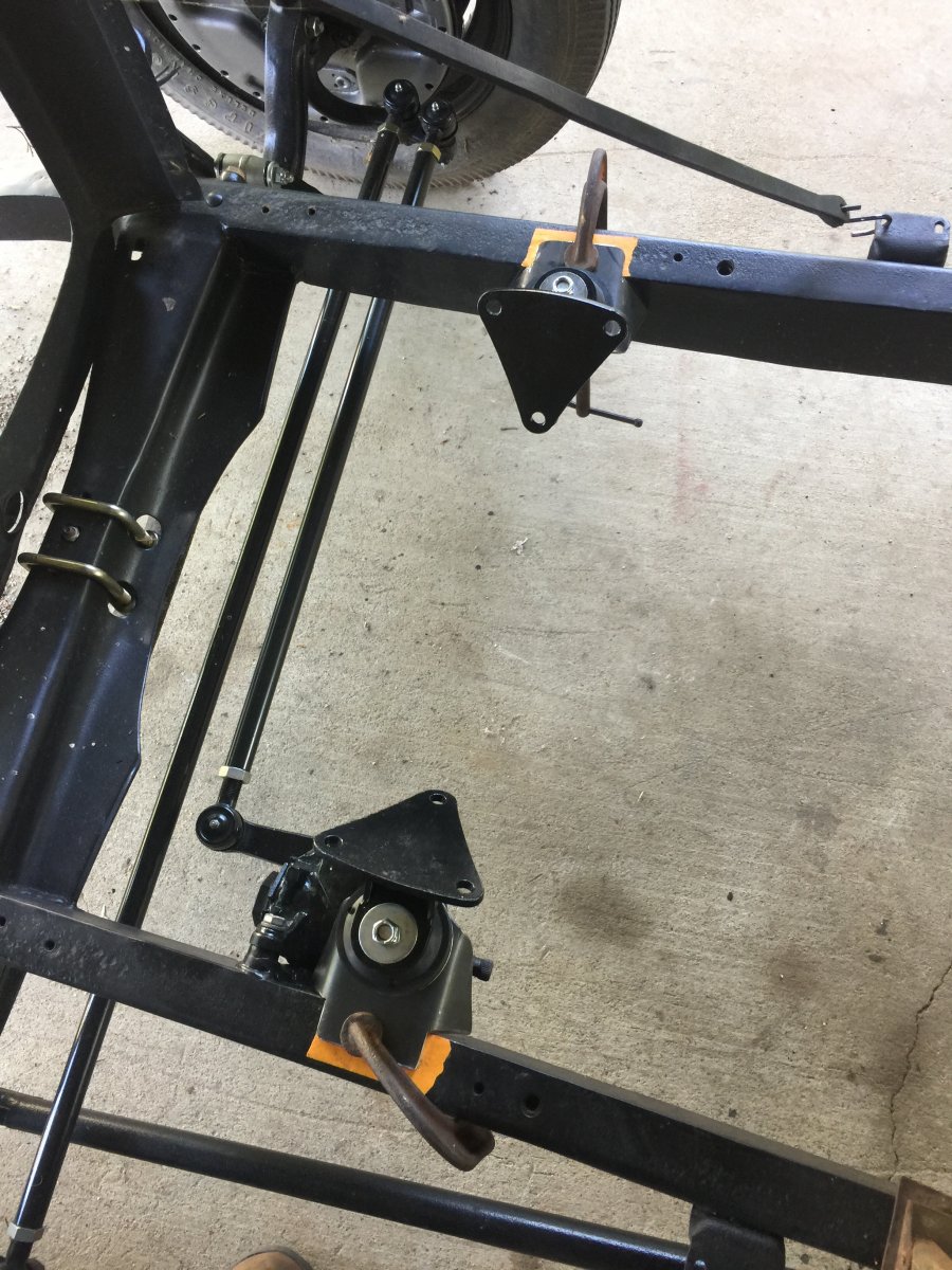

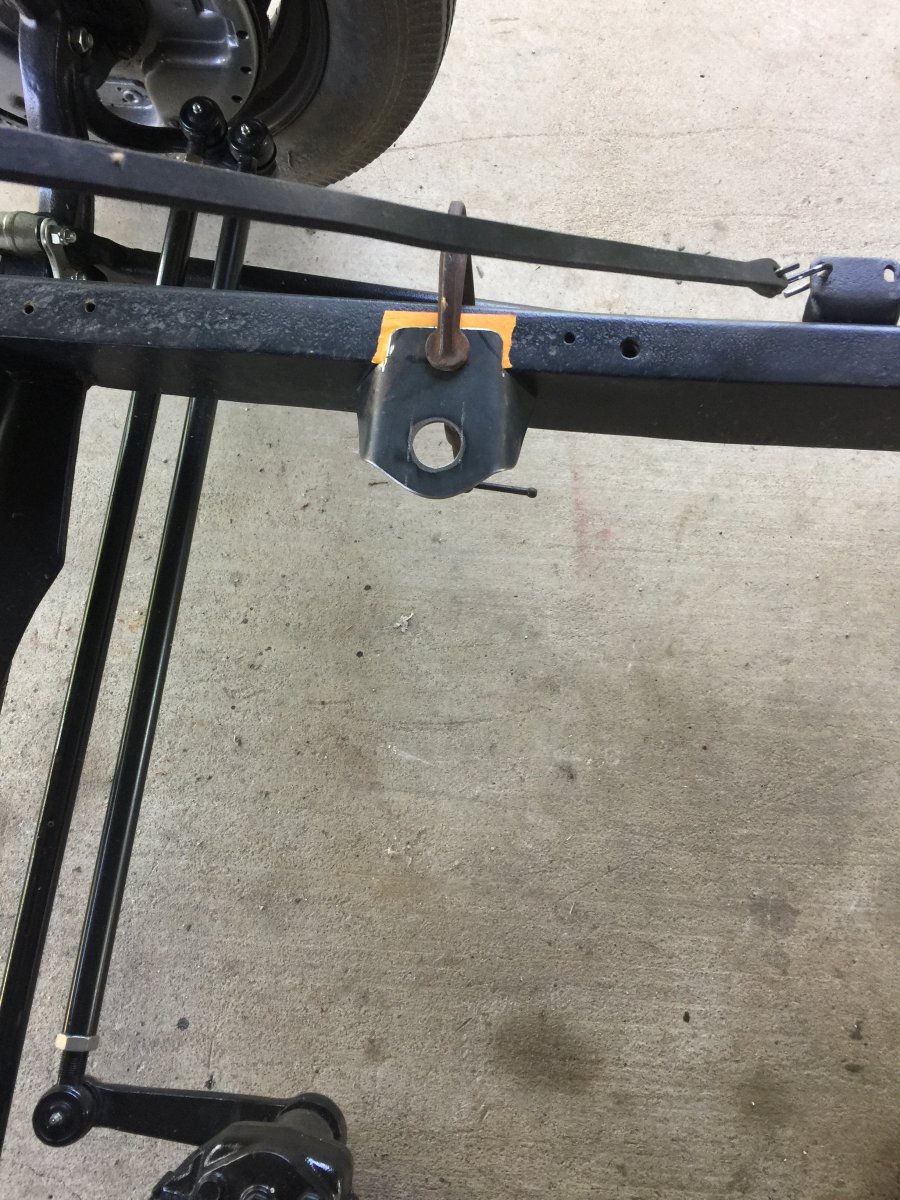

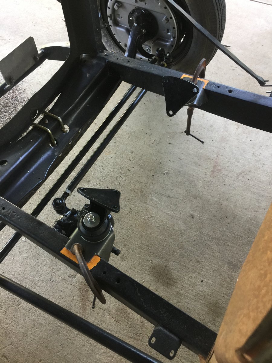

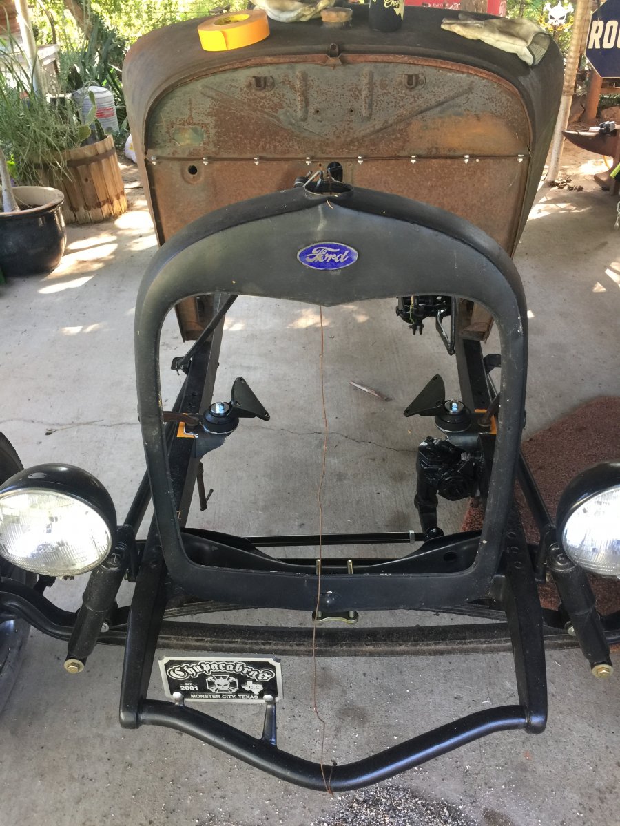

    I measured from a mark I put on frame rails back into cross member (front cross member center-line for radiator mounting slots) putting mark on top bottom mounting feet. Then after drilling undersized used a step drill to sneak up on correct size.
    Put shell on after mounting radiator, aligning shell up then marking center of mount hole onto radiator side mounting tabs.

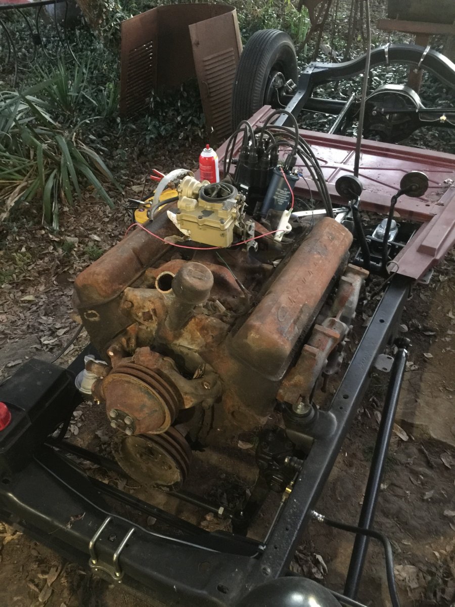

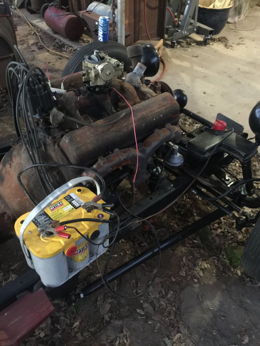

    13872BFD-62AE-4A2A-BE17-50428A2964BB.jpeg 9D8232F2-28C1-4400-9451-56CAA93F5189.jpeg So after replacing coil ,resistor, cap, rotor, points and condenser , and clamping a lawn mower tank to frame, I hot wired and cranked it . I have videos but I can’t figure out how to post.

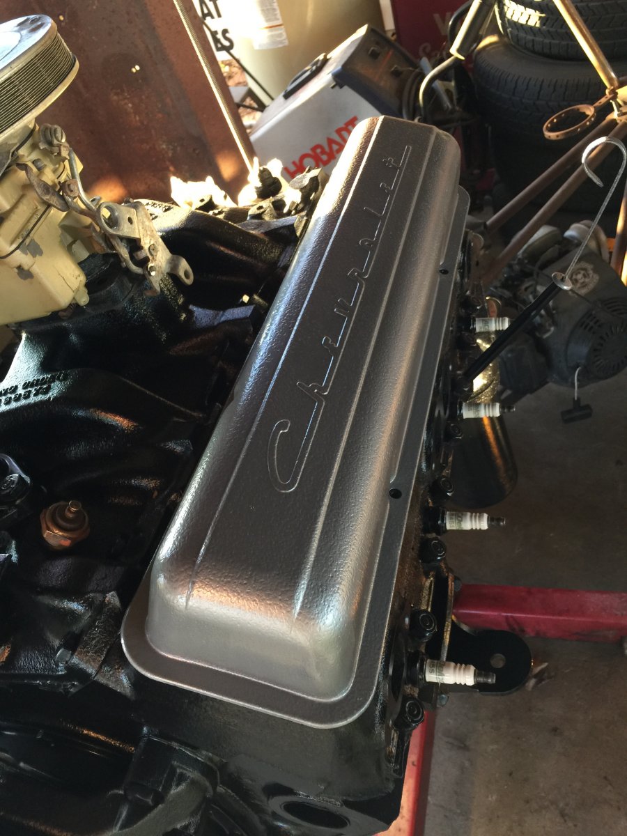

  28. What paint did you use on the valve covers?
    Stogy, loudbang and pecker head like this.

    3E2D61EC-06C6-4E2B-8DF9-132AC2CF1D99.jpeg D74FD3DD-B921-41B5-9260-EE3FD1DD80AC.jpeg I know a lot of these post are meaningless to some, but just showing that I do something everyday, to build a HOT ROD.

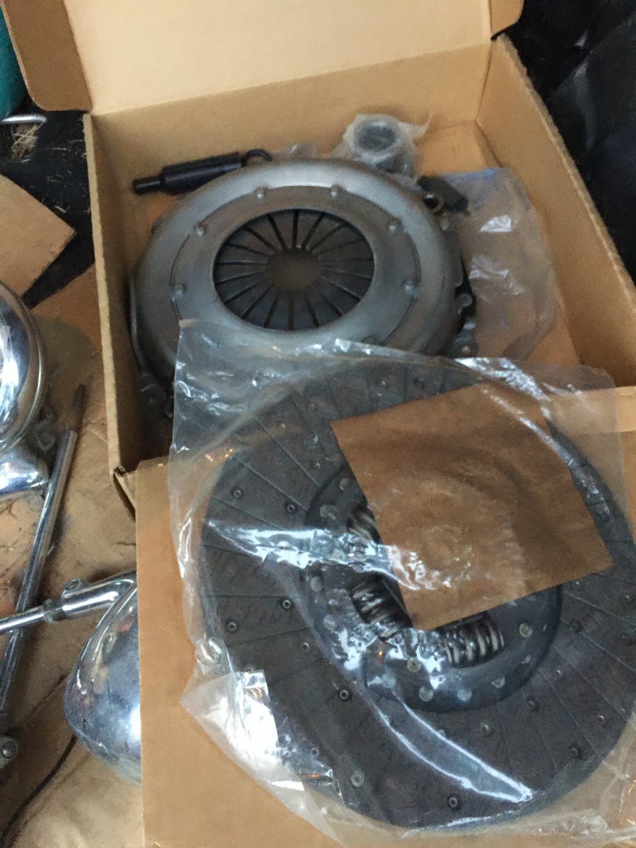

    1447C691-26D5-49AF-9613-3B7B93421E8E.jpeg C89E3C36-7966-4D7F-BBDE-C61473C05A0E.jpeg More degreaser on trans, and new 11” clutch kit. Will de using a lightened flywheel I machined like 10 years ago. I love the sound of a motor with a lightened flywheel. Can’t wait to get it all painted and back in ch***is.
