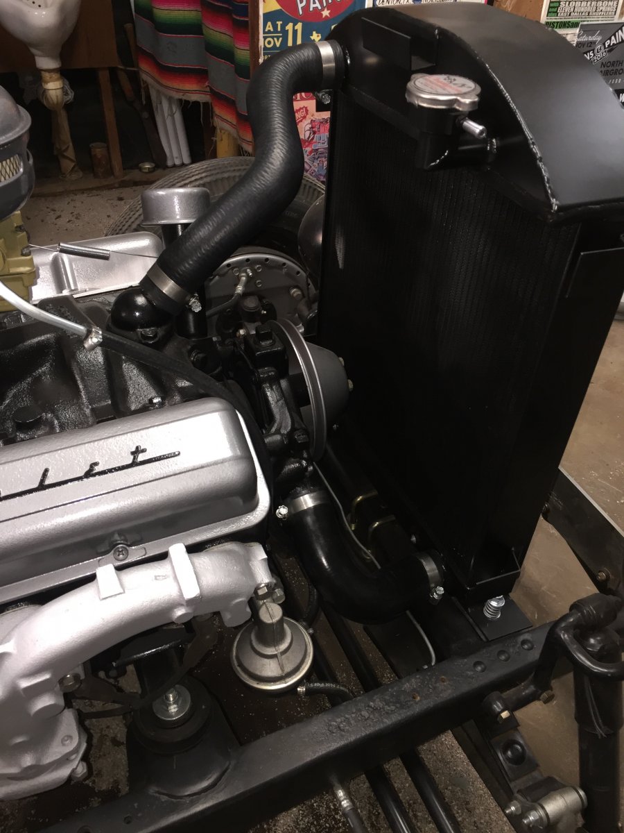

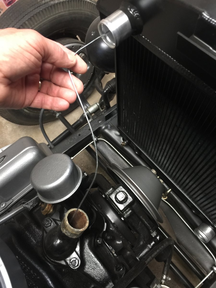

    260269BF-DCDE-4B97-8188-8BEED5437E90.jpeg E5DA8CE4-56D6-4D8A-8DC3-CE21CE3F9A02.jpeg The old coat hanger trick , before you go hunting for radiator hoses.

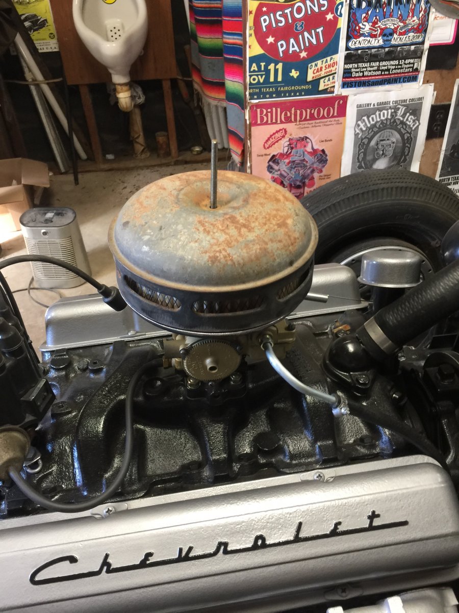

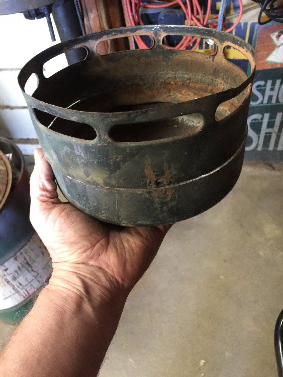

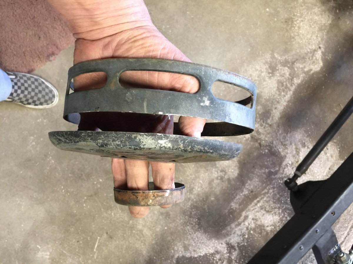

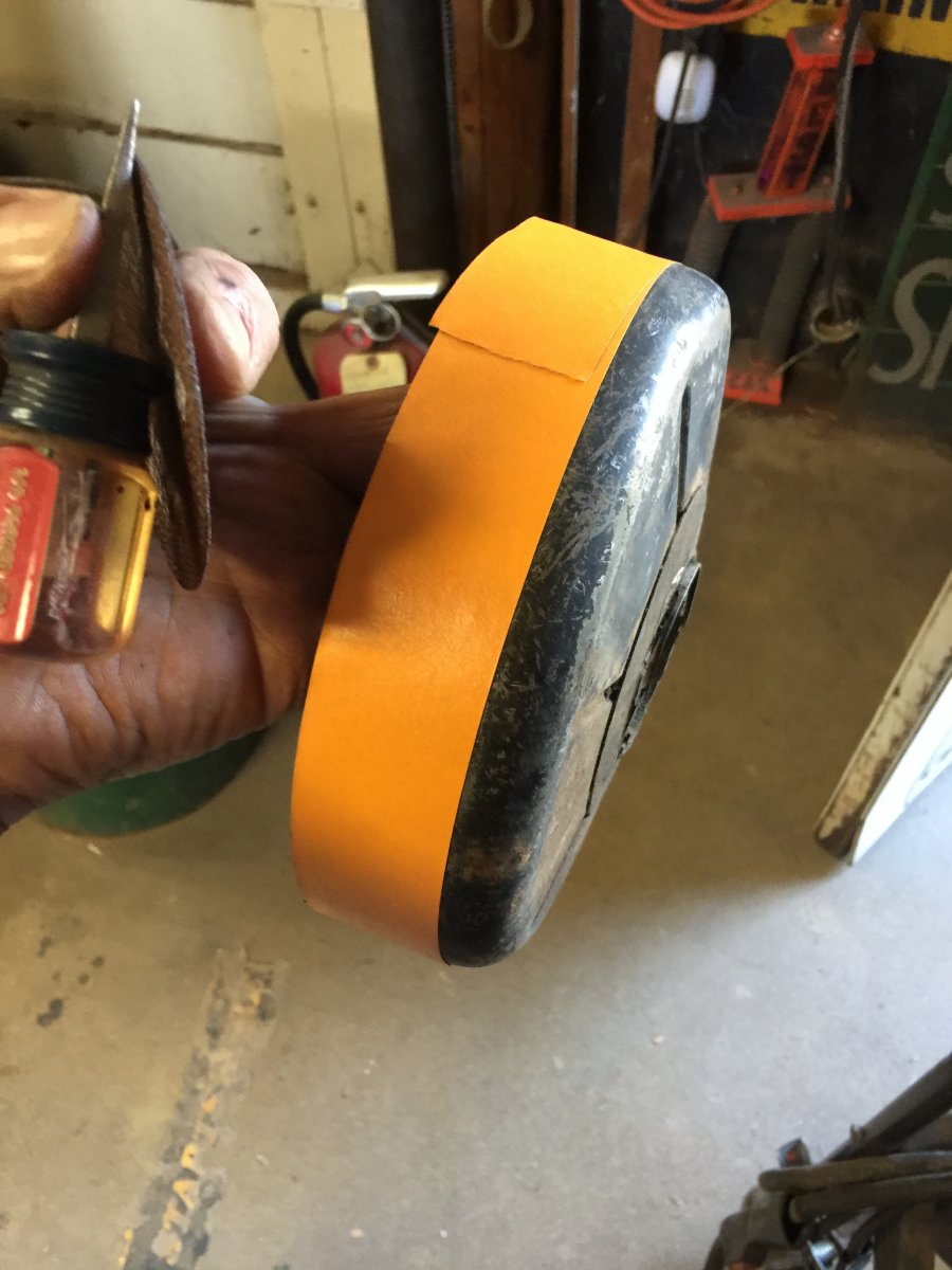

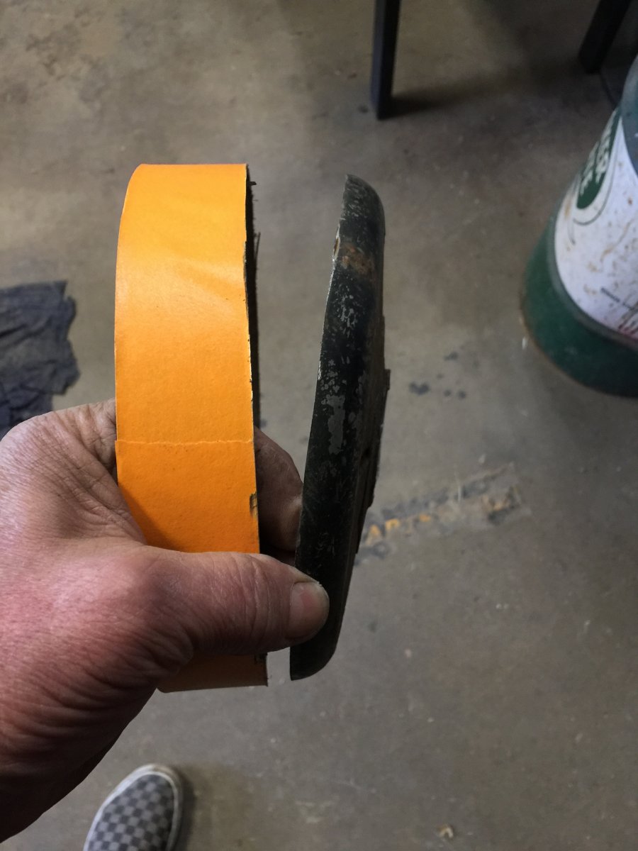

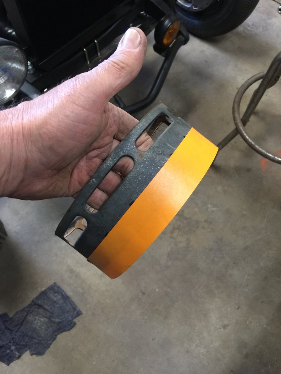

    E7C76EA1-177C-4668-8502-4E943576F82E.jpeg 950E5303-748C-4CA6-BB47-17D7555D84D8.jpeg 9BECA052-77B3-4E49-999C-7231E61A1ED3.jpeg 714F6504-BA1E-4CD9-BC0A-F393B582C8D6.jpeg D4BB8F54-D7F7-4409-BE04-C5F5605D3933.jpeg 3$ swap meet oil bath breather , cut up today.

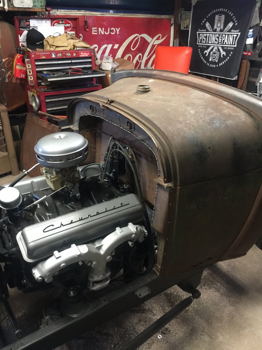

    pecker head

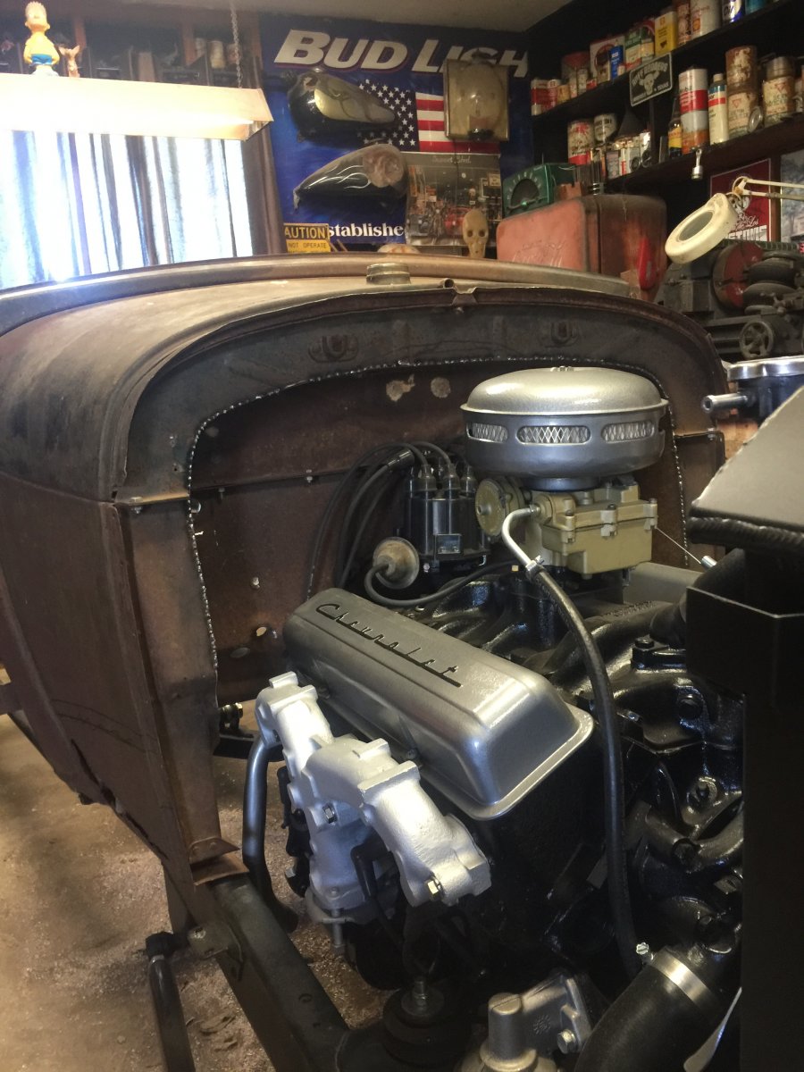

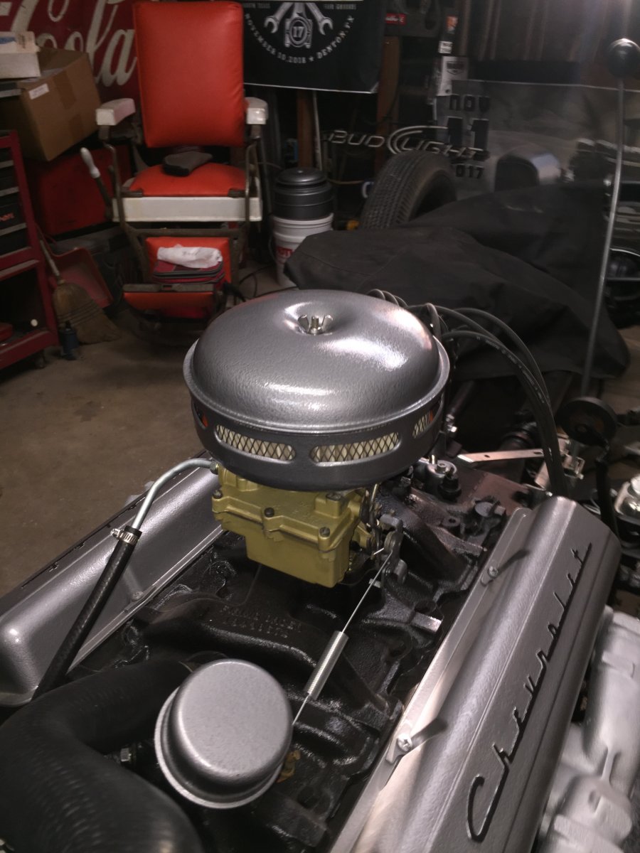

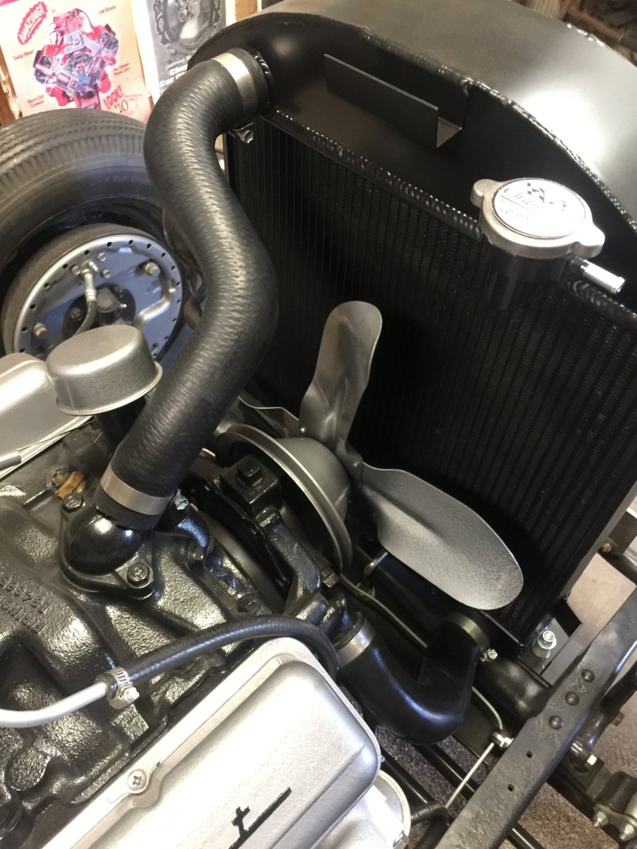

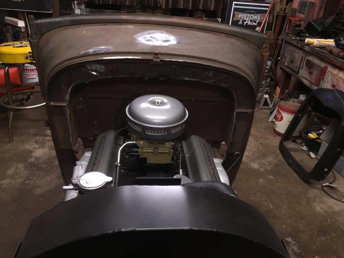

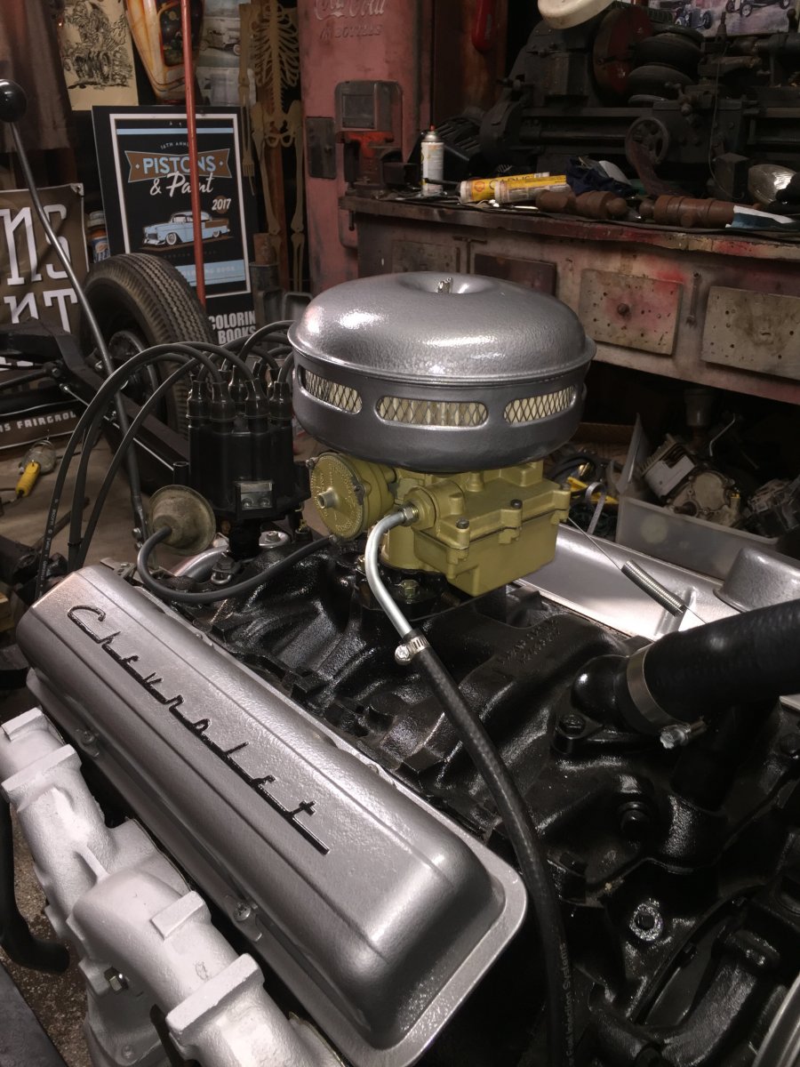

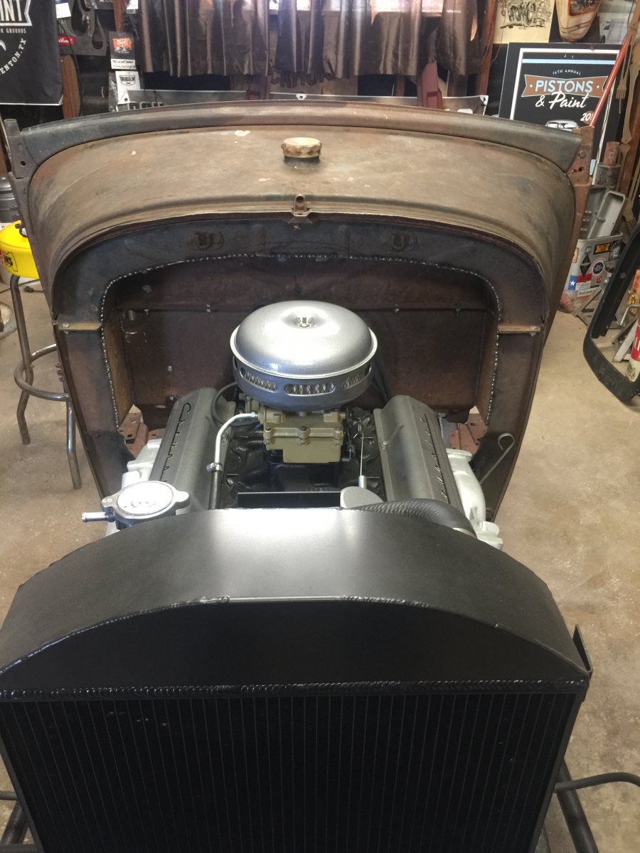

    6CA26BB7-E758-4118-A438-D2465B452E39.jpeg C744D922-28EE-4453-B518-861D369A4DC6.jpeg 98B7FBCC-A02D-46EE-93D4-EC3FD6F888CD.jpeg Welded ground and painted , I like better than big air cleaner. Making room for generator.

  5. krusty40
    Joined: Jan 10, 2006
    Posts: 872
    krusty40
    I do too. Looks like a cheap 50s sci-fi movie "alien spaceship" ( imagine lights instead of pleats behind the slots and a barely visible wire "flying" it).
    Great build.

  6. pecker head
    Joined: Nov 8, 2006
    Posts: 4,500
    pecker head
    Thank you sir , my thoughts exactly.
  7. RodStRace
    Joined: Dec 7, 2007
    Posts: 10,882
    RodStRace

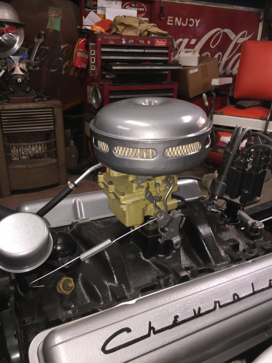

    pecker head, Really diggin' the build and the clean work you are doing. I do have a couple of suggestions, if I may:
    Tighten the throttle return spring up a bit. It should have a bit of space between the coils at full return so it still has tension.
    Bend and flare a fuel line to fit between the pump and carb. It will look better, and if you ever take the car down the strip, many places limit you to a TOTAL of 12" of rubber in the whole system. That side is also pressurized.
    P.S. Checkered Vans for the win!
    That type of choke also likes to have a metal tube running to either the exhaust crossover in the intake manifold (don't see provision for it) or the exhaust manifold itself (drill a hole in the flat D-shaped area that is not level, IIRC). It's a slip fit in the exhaust, threaded nut on the choke. Without the proper heat coming up, the choke will not open properly, and it is a vacuum leak, too.
  8. pecker head
    Joined: Nov 8, 2006
    Posts: 4,500
    pecker head
    I live in TEXAS , no choke required. Will be hard lined from pump to carb.VAN’s always ROCK.Thanks man.
  9. RodStRace
    Joined: Dec 7, 2007
    Posts: 10,882
    RodStRace
    Cool (but not cold)! :D
    Then back it off completely and plug the hole in the housing so it isn't vacuum leaking. It's a small hole that looks like it might be at 1 O'clock on yours in the pics. There is a p***age tube that does NOT have a screw going thru it to attach the choke housing to the carb main body. There is also a small gasket with 2 holes, one for the alignment bump and the other for the vacuum p***age. That's what I see in the one pic of the side of the carb.
  10. pecker head
    Joined: Nov 8, 2006
    Posts: 4,500
    pecker head
    It’s backed off completely ,and just have to cap off opening, has brand new gaskets on everything.

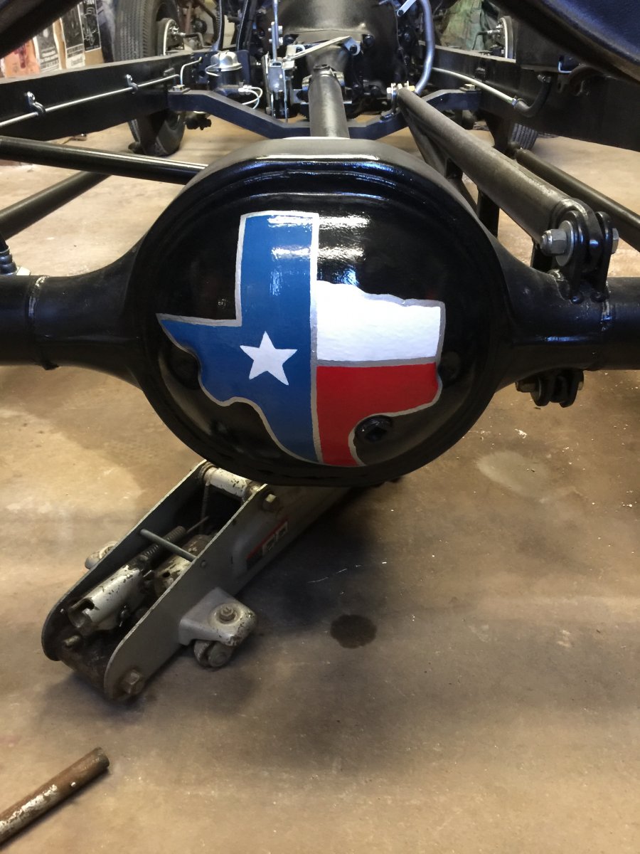

    70AA9DC9-823B-47B8-B907-738C3E3F022B.jpeg F1F1A397-4E57-4B1B-8B4D-B95DADB823AC.png 35CD7349-3607-4A7F-93CD-C4FB4A75F80B.jpeg Finally got around to redoing the rearend art that I originally did when I was 15 with Testors model paint.

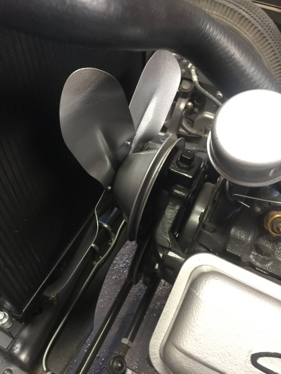

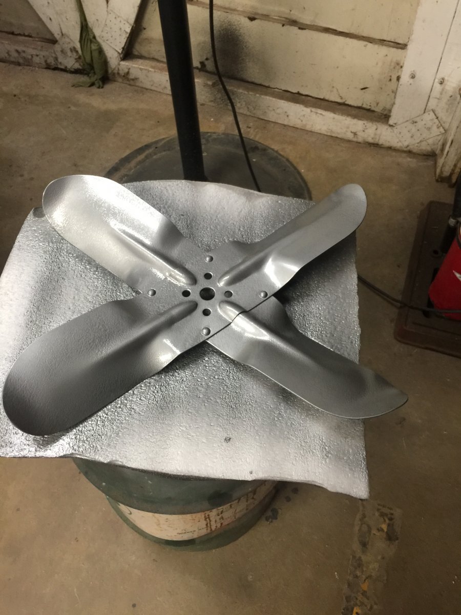

    252C0EB6-C728-411A-B02C-C6F8520AE2FE.jpeg 2FFA062C-8BA4-4EC9-91BF-BAA026AED8A7.jpeg 6F9BED55-4AB8-47EA-B21C-F7A3E5EA9F1C.jpeg I painted this 4 blade fan and installed.

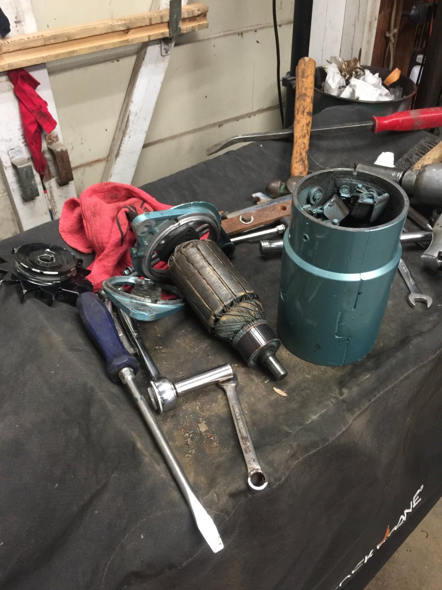

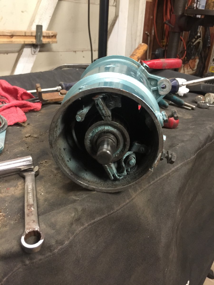

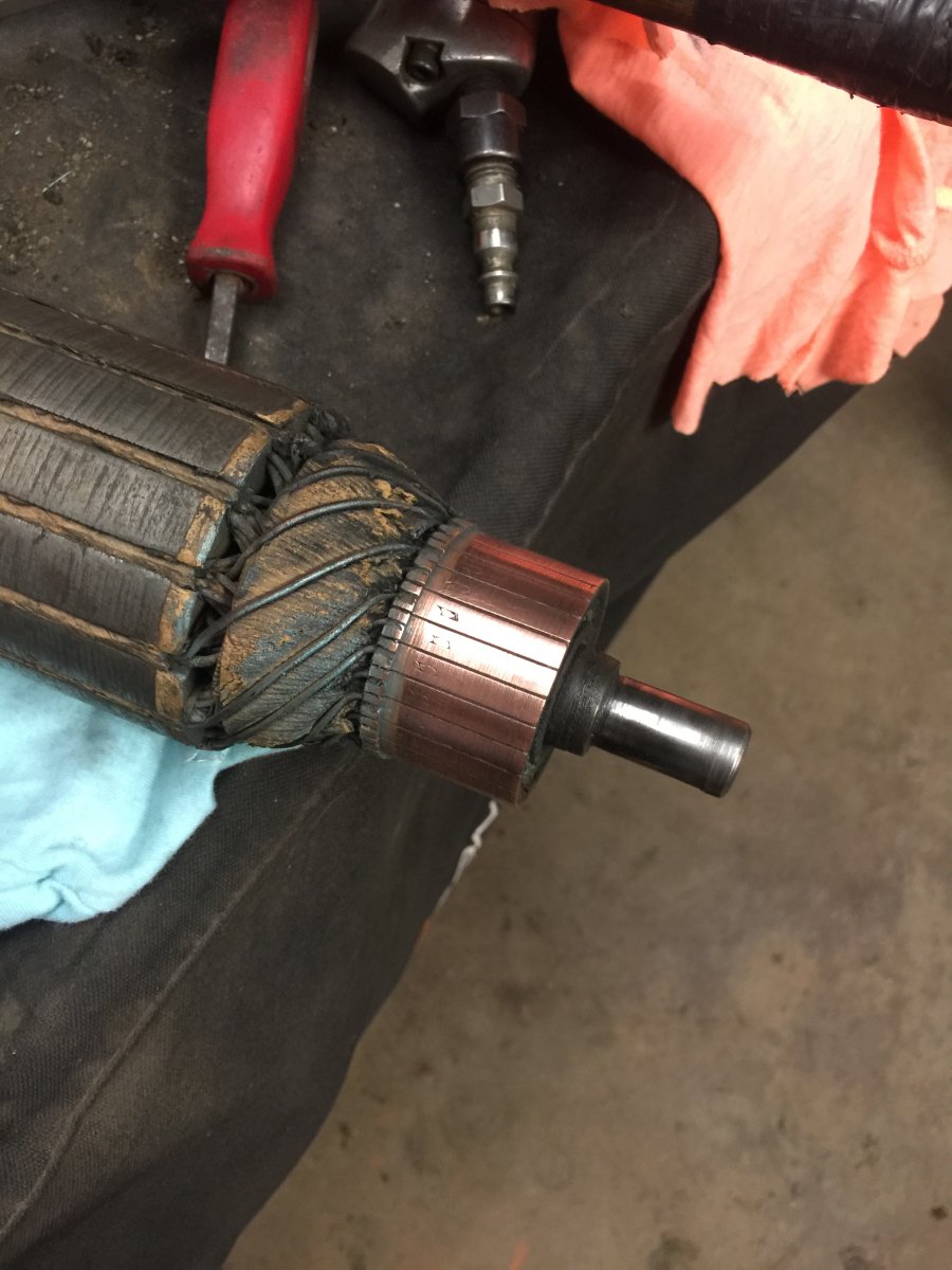

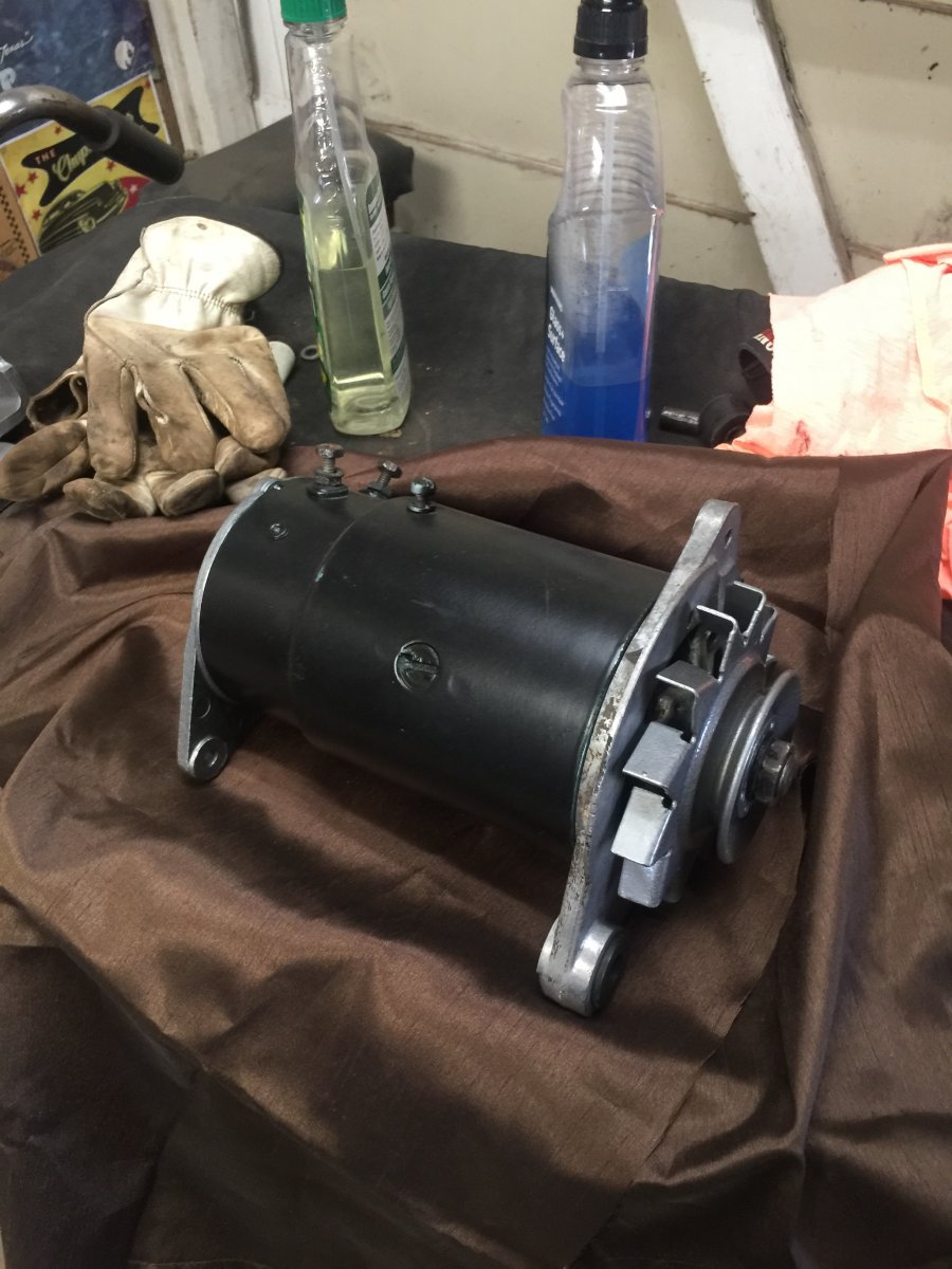

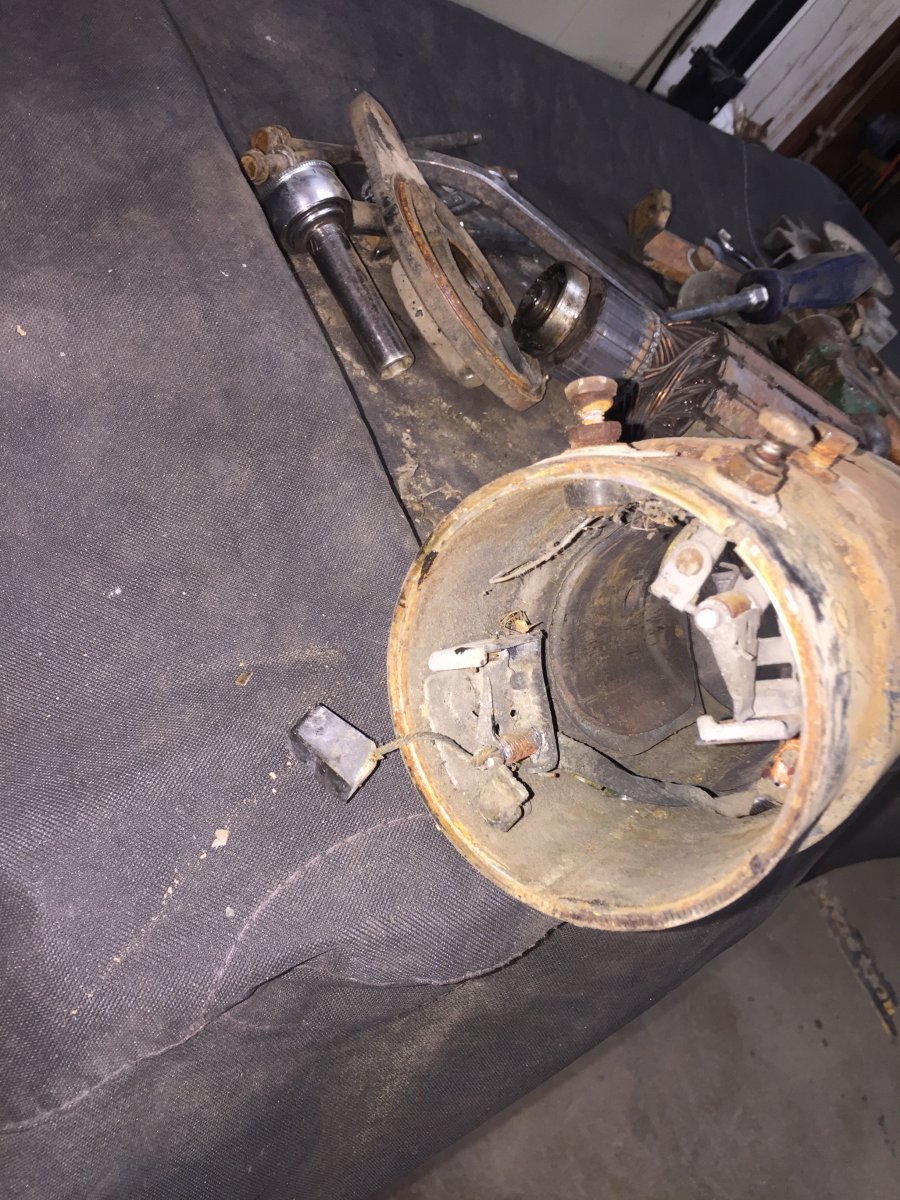

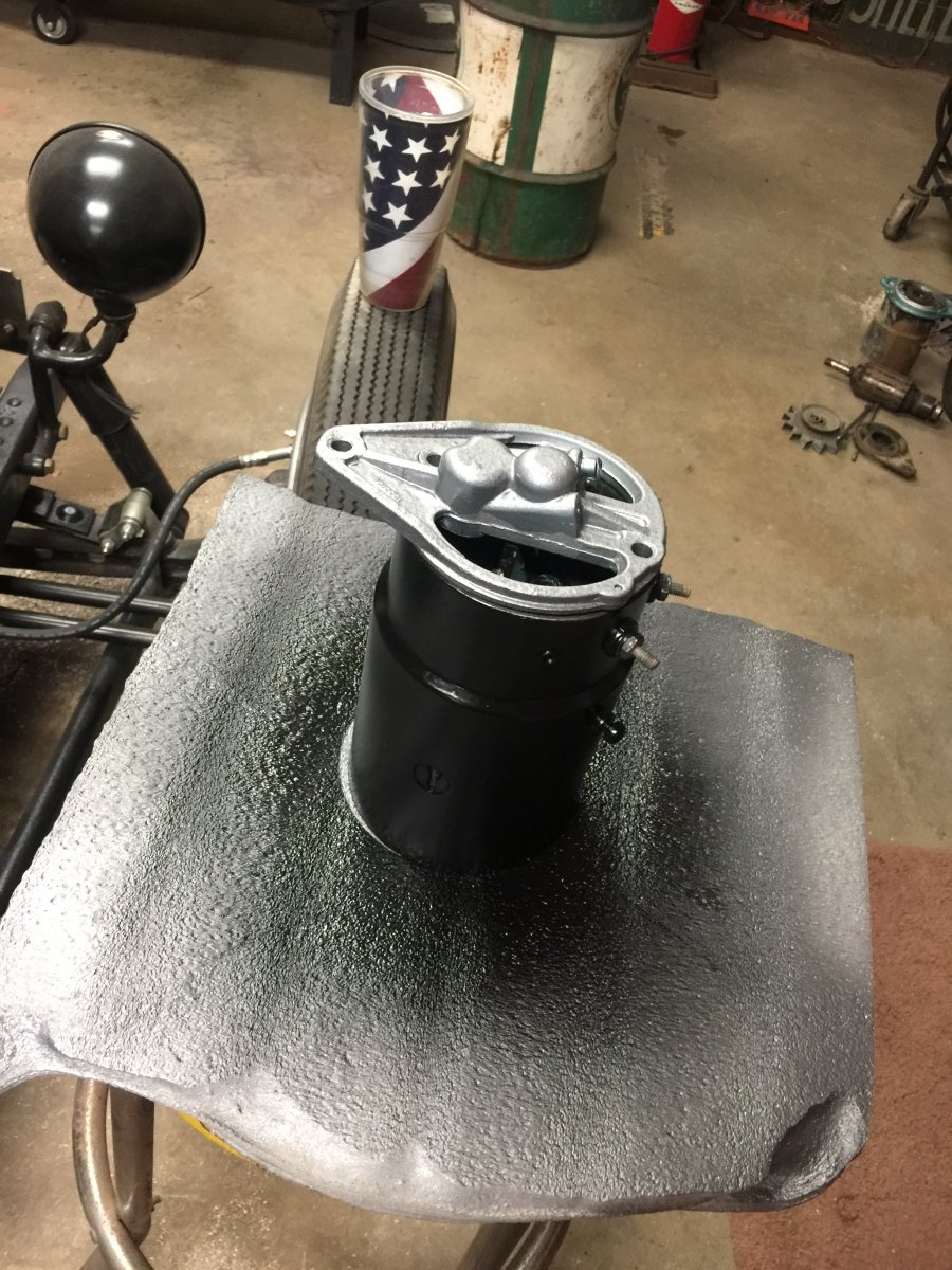

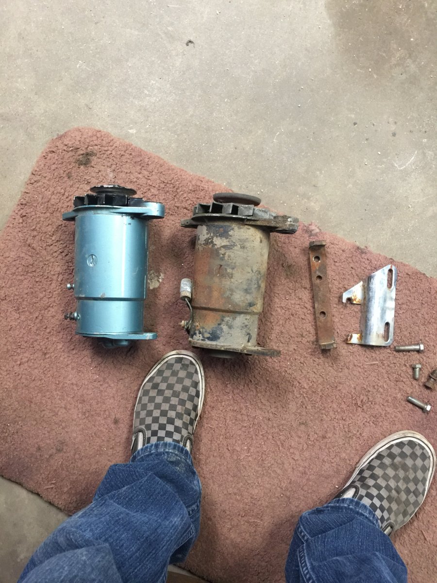

    31375874-23DF-4A4B-90B4-987C1873E56C.jpeg B93A91EA-2C3B-4CEC-AFDD-EFDF24EFA3F6.jpeg 659B9045-ECF6-440F-8406-7BB41D6B8CEA.jpeg 36C645B4-02B1-4AE9-A705-7C9F151231F8.jpeg 1B3E3460-A35D-4263-B7B3-9D00A7B28095.jpeg 9E1C3D12-CC16-4E1B-9459-41D0203CC9FB.jpeg 6BD428B5-372E-45A8-B889-1A1A71F101A0.jpeg I built a decent generator out of the original, and a $5 Pate Swap Meet find from last April. If it don’t work right, I’ll send to Dirty2 for a rebuild.

    Used to work in a shop that had a SnapOn generator checker (growler) and armature turner.
    Something tells me the warranty for that tool is not Lifetime any more!
    While trying to come up with a picture of one (no luck), I came across this. It might help ya!
    https://www.hometownbuick.com/1959-buick-generating-system/

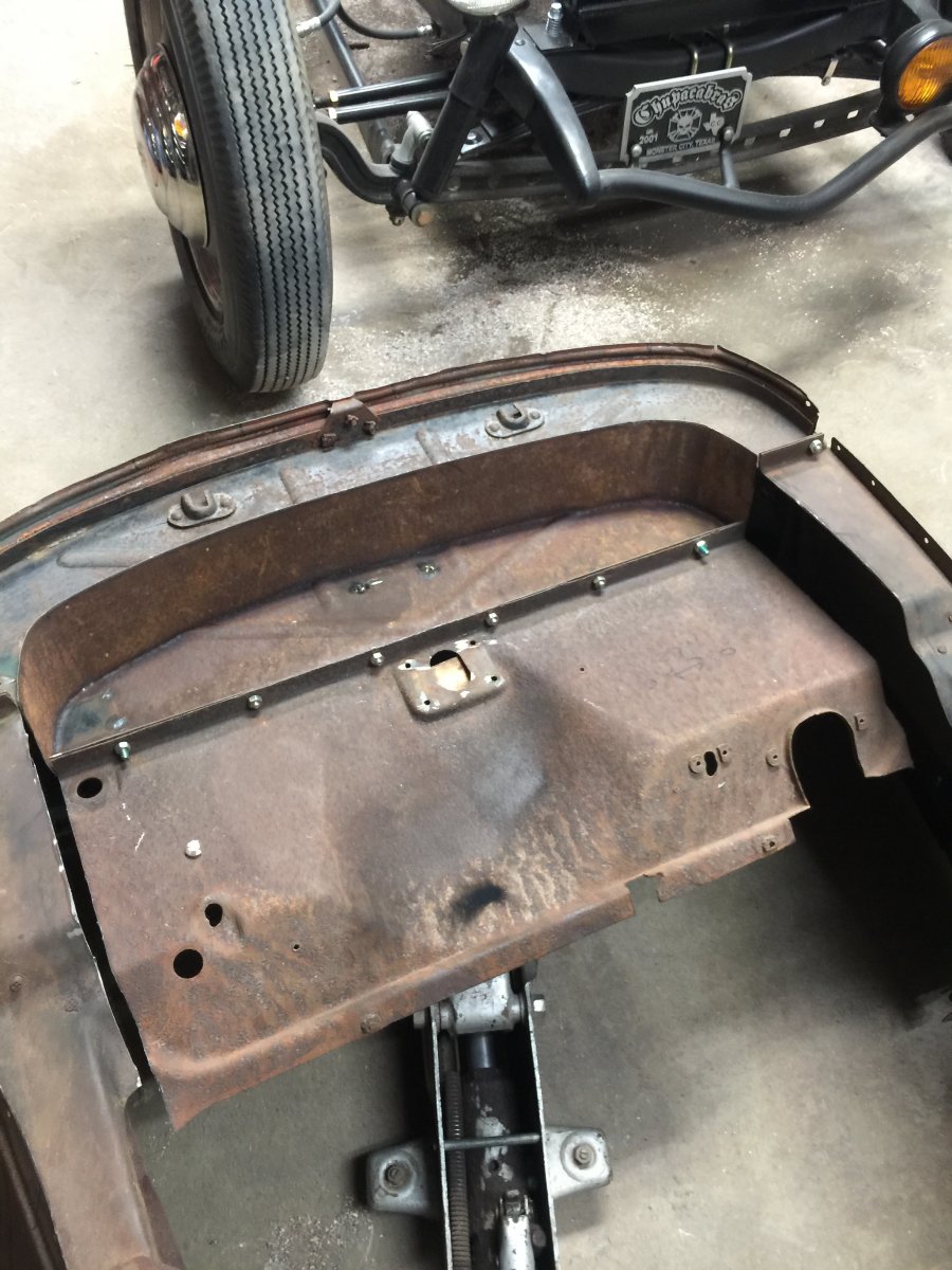

    2DFE30B4-6865-43A7-813D-B1F2ECDD8157.jpeg Started recessing firewall.

    I did one similar several years ago and reversed the seam flanges so that the firewall bolts were hidden inside the cab. The firewall looked even better with a nice smooth clean finish.
    Sorry, no close ups, but if you blow up these two attached pic's and you know what you are looking for you can just faintly see that there is no seam flange outside.

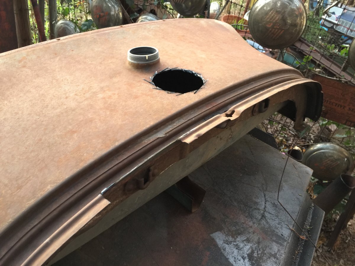

    66BB52B5-20EF-4F2D-BFF9-DC4B88744469.jpeg 52187A65-DB14-4FAF-A9D8-4D4EF6B1370D.jpeg 45697B4F-F4CB-4880-86CF-5676EF08AB7B.jpeg 43DE8F38-3948-4ECB-86EC-181199F388BA.jpeg Fixed damaged hood lip with piece of junk cowl and got gas cap filler piece .

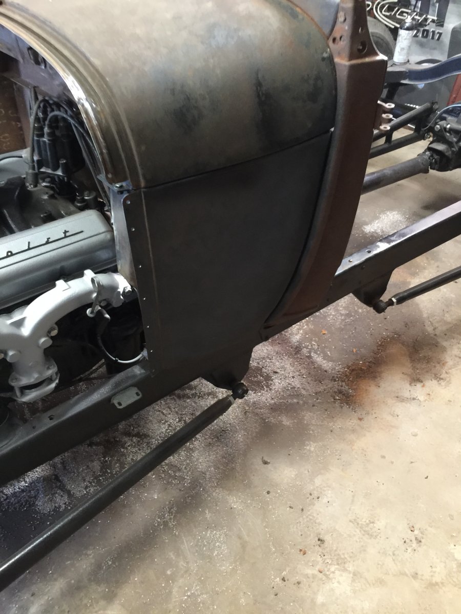

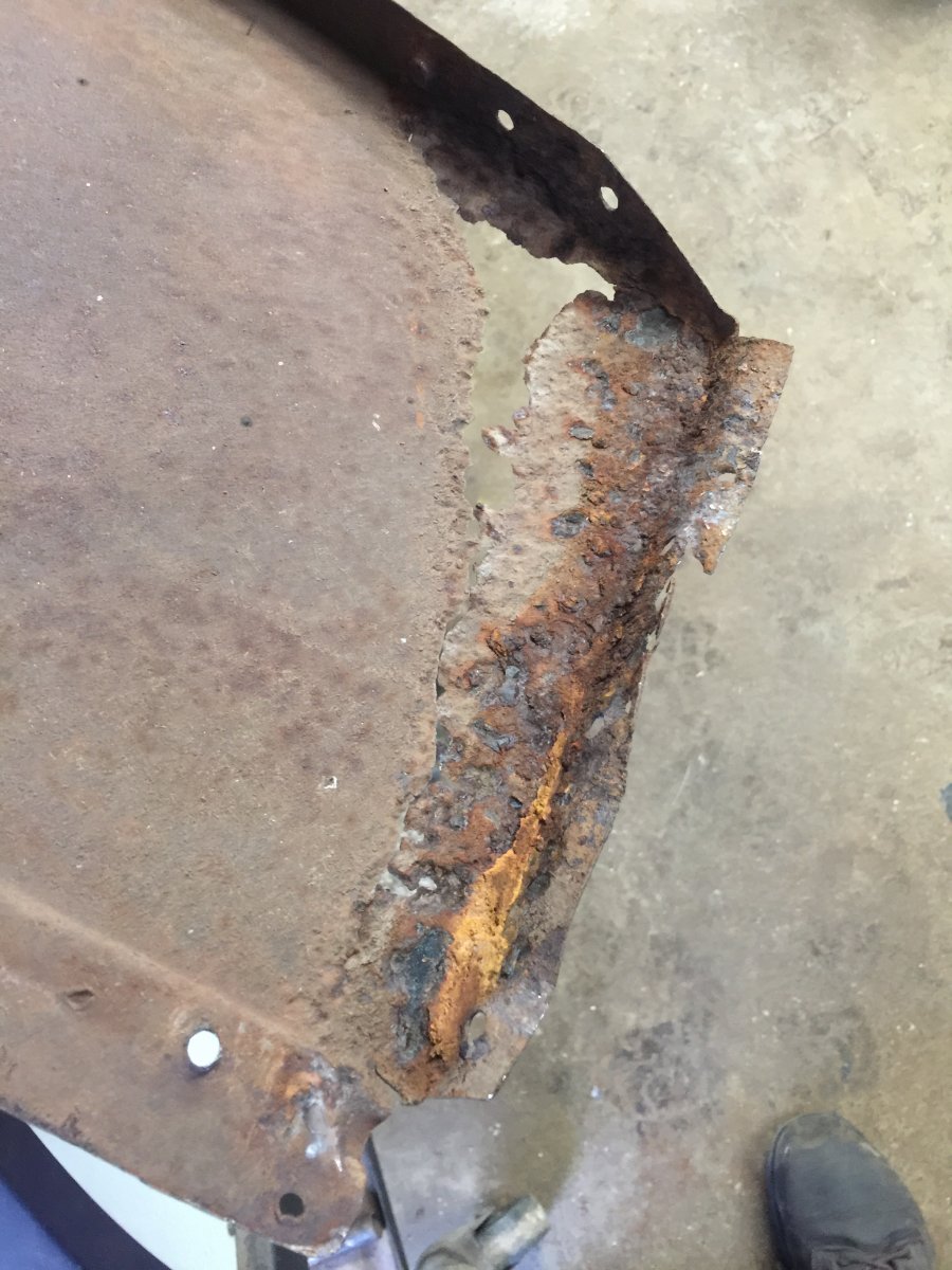

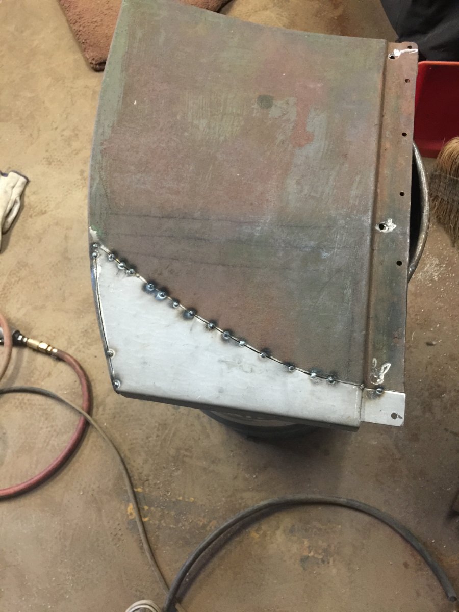

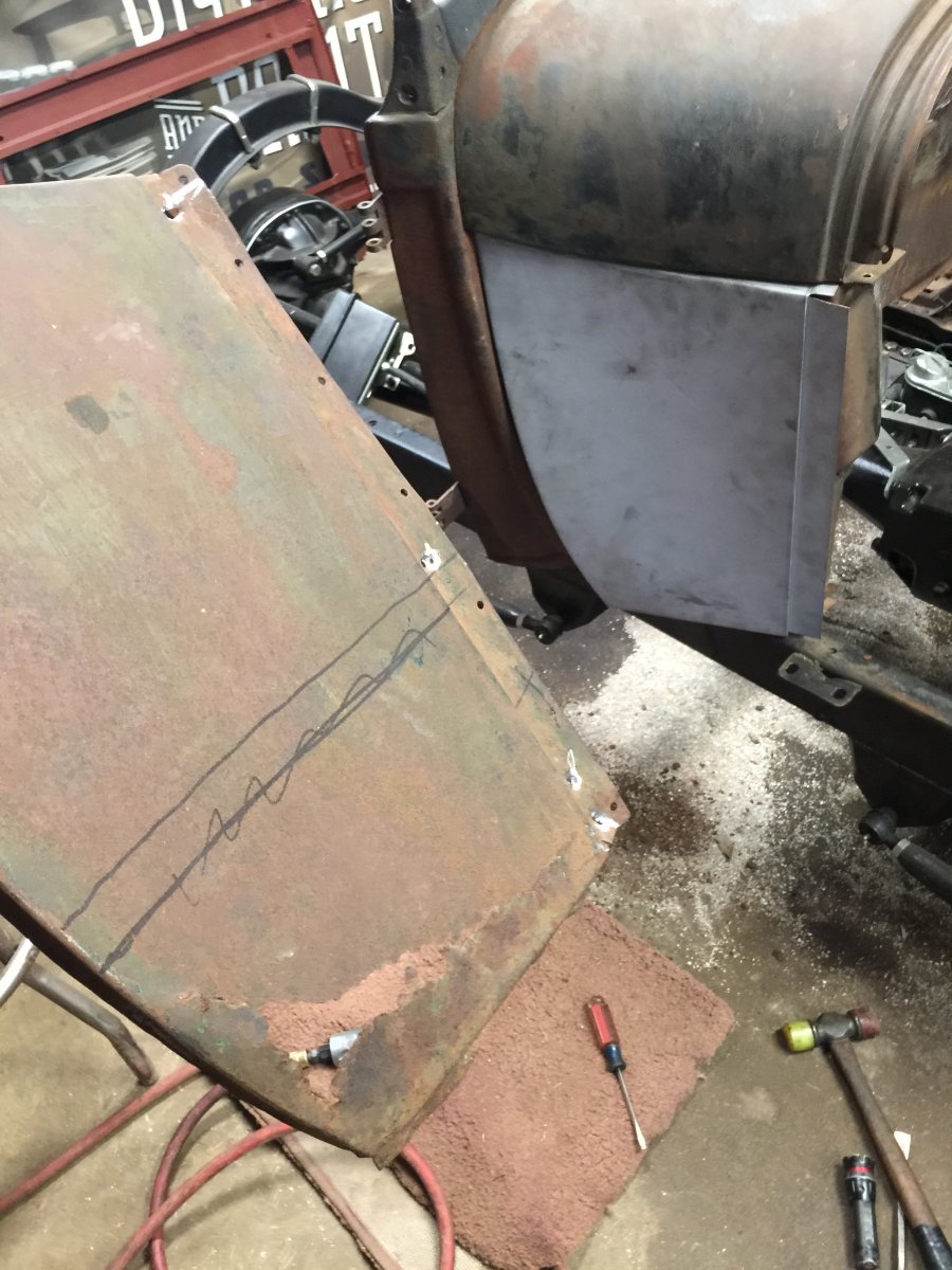

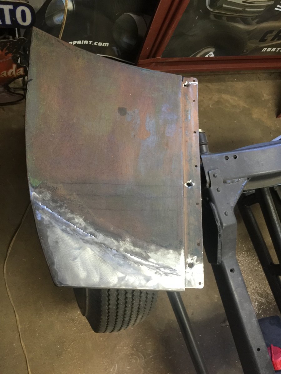

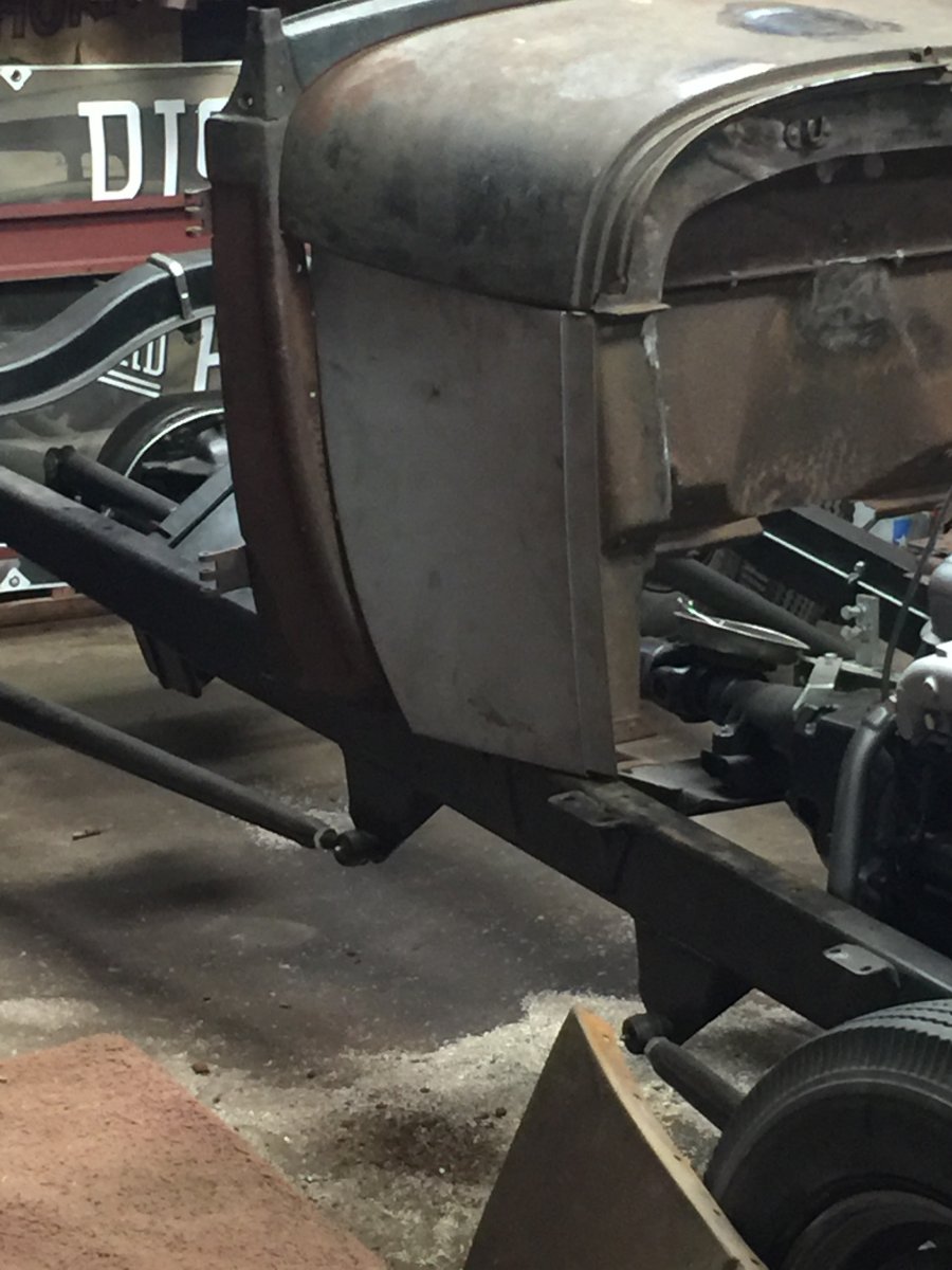

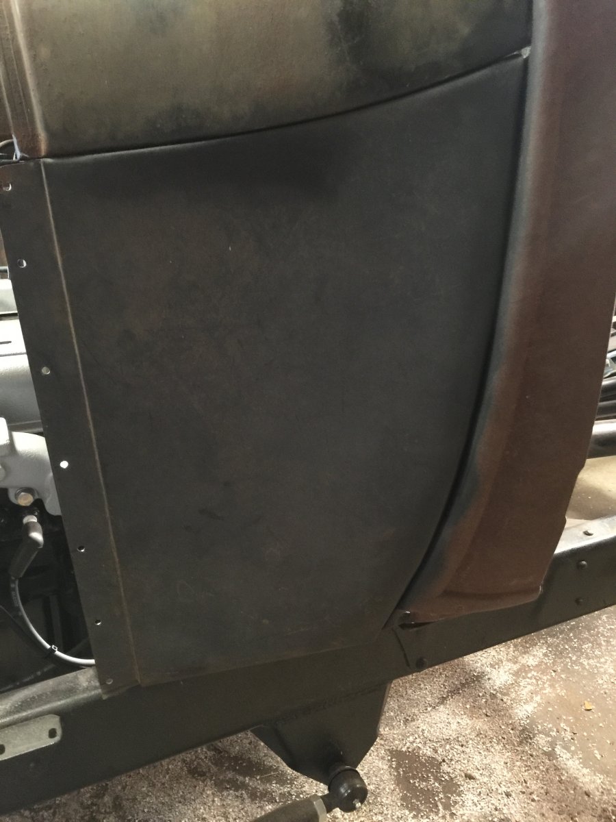

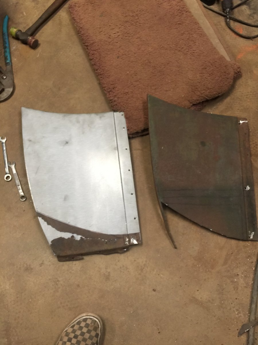

    Damn near finished with drivers side. P***enger side tomorrow, I wired brushed all the rust and sprayed rust encapsulator on it. Don't know how old this reproduction lower cowl part was, I took it in a trade but it fit good. Hope the HOWELLS SHEET METAL repop I bought at Pate Swap Meet last year fits the p***enger side as well. Drilling all the holes in the right place was very time consuming. CD4809EF-810C-4050-93B5-DE1B78CA5F87.jpeg 9093FDF6-EC6F-4F68-9A1F-9311B73F27AE.jpeg 2386D391-6ADC-49D4-B6AF-9C0B5AABB926.jpeg

    AE9C7BB3-DDA8-4A57-A19A-233BB441064C.jpeg Well Howell’s cowl piece FAILED reveal at least a 1/4” out of place.

    C9A48972-F19E-4AC7-8EB0-A5E96DC88D39.jpeg FA67974B-2B9F-4D87-96C3-4E335F959D08.jpeg 63230F46-796F-43B7-8862-EA8911196EC6.jpeg Unbelievable that these guys can’t get there **** together.
