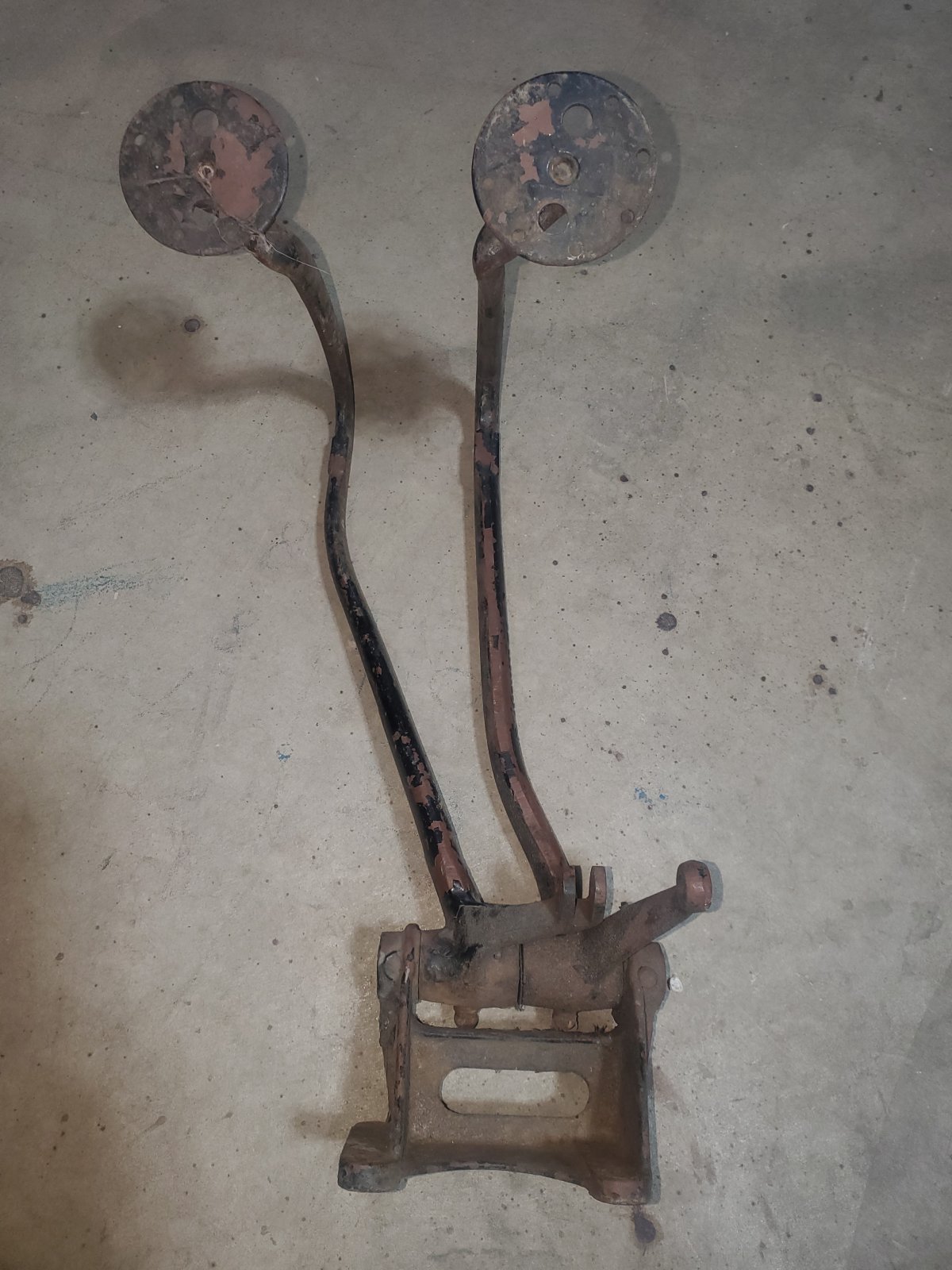

    A 2022-12-02 14.00.35.jpg A 2022-12-02 14.00.21.jpg Any help identifying these would be appreciated, thanks

    Any numbers on the pedals? Looks like a big truck Ford circa 1932.

    That similar type of mount was used on the ford big trucks for quite a few years I think, Like Alchemy says, a number would sort it out

    this help?

    i also have these which I was told are 32-34 big truck

    brake pedal pulls... mechanical brakes... pre 1939...
    part # starts with 81... memory says that is 1938...
    rusty valley likes this.
  8. 81A prefix indicates '38 car, but '38 car and pickup pedals are same as '37, so the pedals would have a 78- prefix. The '39 car and pickup pedals should have a 91A prefix. '39 big truck would have a 91T prefix.

    There you go, 1938 big truck. I knew it was before the hydraulics started, otherwise the brake master cylinder actuator arm would have pointed down.
